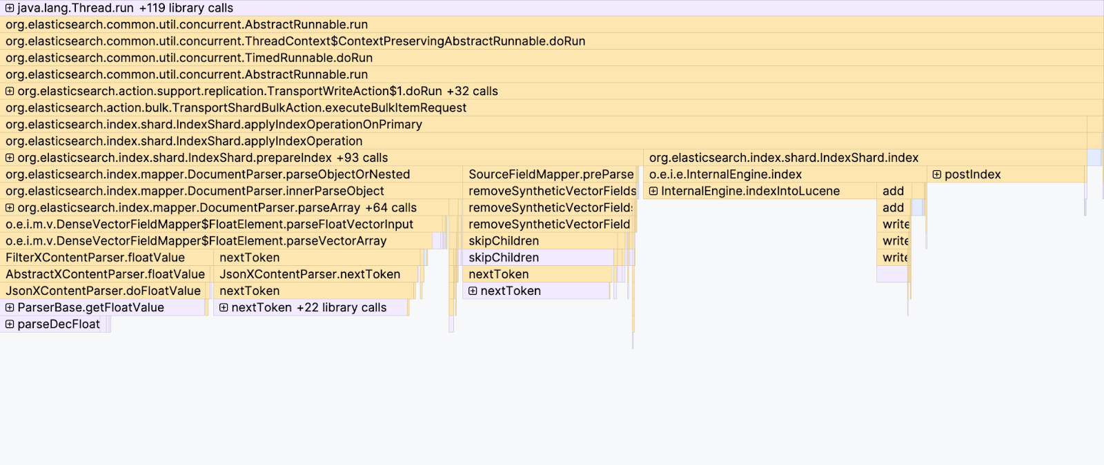

In both cases, we expected to see major gains in ingestion speed. However, once these changes were fully integrated into Elasticsearch, the improvements weren’t as large as we had hoped. A flamegraph of the ingestion process made the issue clear: JSON parsing had become one of the main bottlenecks.
Vector ingestion before using Base64-encoded strings
Parsing JSON requires walking through every element in the arrays and converting numbers from text format into 32-bit floating-point values, which is very expensive.

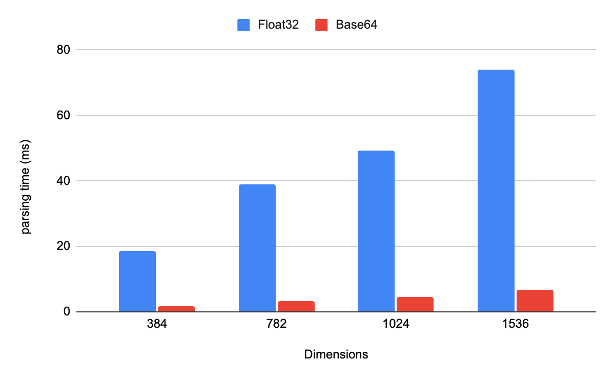

Is it worth it? Our benchmarks suggest yes. When parsing 1,000 JSON documents, using Base64 encoded strings instead of float arrays resulted in performance improvements of more than an order of magnitude, at the cost of a small encode/decode trade-off (client-side Base64 encoding and a temporary byte array on the server for decoding) in exchange for eliminating expensive per-element numeric parsing.
Base64 vs. Float32 parsing time

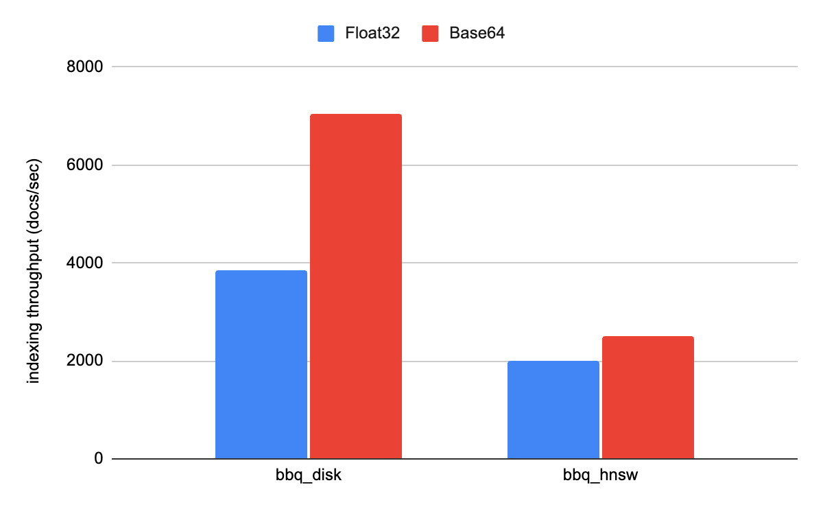

We can see these improvements in practice when running the so_vector rally track with the different approaches. The actual gains depend on how fast indexing is for each storage format. For bbq_disk, indexing throughput increases by about 100%, while for bbq_hnsw, the improvement is closer to 20%, since indexing is inherently slower there.
Base64 vs Float32 indexing throughput
