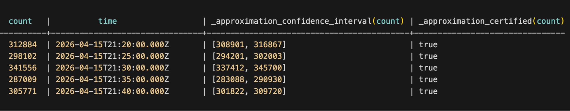

What you get back
The response includes your original aggregated values, automatically scaled to represent the full dataset; a COUNT on a 1% sample comes back as the estimated total, not the sample count. Column names and types are preserved (backwards-compatible). Plus two additional columns per approximated value:
  • Confidence interval: A range that bounds the true value at the configured confidence level (default 90%). For example, a count of 268,473 with interval [264,444–273,179] means you can be 90% confident the true count falls in that range.
  • Certified flag: A Boolean indicating whether the confidence interval for that value meets formal statistical guarantees. When certified is true, the data distribution allows us to rely on the results at face value. When false, the approximation is still often close but we can’t claim the same formal guarantees, typically because the distribution may be highly skewed or involve too few documents in a group. Think of it as the difference between "statistically proven" and "best estimate."
