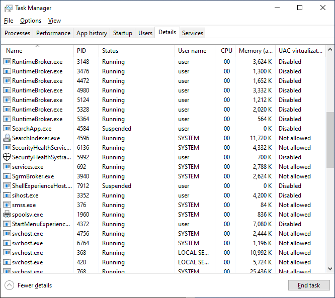

Windows Task Manager shows a list of processes running on the system. Each of these processes is associated with an executable file on disk, such as svchost.exe. This is because Windows launches processes from executable files, usually ending with an EXE file extension.
It’s important to note that processes are not executables, and executables are not processes. In the example Task Manager above, there are multiple processes launched from RuntimeBroker.exe and svchost.exe.

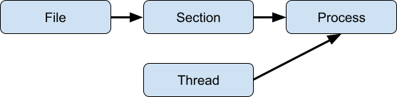

  1. Open a handle to the executable to launch. Example: hFile = CreateFile(“C:\Windows\System32\svchost.exe”)2
  2. Create an “image” section for the file. A section maps a file, or a portion of a file, into memory. An image section is a special type of section that corresponds to Portable Executable (PE) files, and can only be created from PE (EXE, DLL, etc) files. Example: hSection = NtCreateSection(hFile, SEC_IMAGE)
  3. Create a process using the image section. Example: hProcess = NtCreateProcessEx(hSection)
  4. Assign process arguments and environment variables. Example: CreateEnvironmentBlock/NtWriteVirtualMemory
  5. Create a thread to execute in the process. Example: NtCreateThreadEx

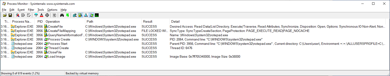

Here is what that looks like in Process Monitor:
explorer.exe launching notepad.exe, as seen in Process Monitor

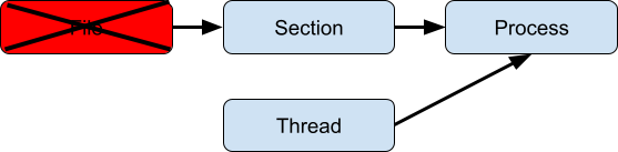

An important note, however, is that this deletion restriction only comes into effect once the executable is mapped into an image section. This means that it is possible to create a file, mark it for deletion, map it to an image section, close the file handle to complete the deletion, then create a process from the now-fileless section. This is Process Ghosting.
The attack flow is:
  1. Create a file
  2. Put the file into a delete-pending state using NtSetInformationFile(FileDispositionInformation). Note: Attempting to use FILE_DELETE_ON_CLOSE instead will not delete the file.
  3. Write the payload executable to the file. The content isn’t persisted because the file is already delete-pending. The delete-pending state also blocks external file-open attempts.
  4. Create an image section for the file.
  5. Close the delete-pending handle, deleting the file.
  6. Create a process using the image section.
  7. Assign process arguments and environment variables.
  8. Create a thread to execute in the process.
Antivirus callbacks are invoked upon thread creation, which occurs after the file is deleted. Attempts to open the file or perform I/O on the deleted file will fail with STATUS_FILE_DELETED. Attempts to open the file before deletion is complete will fail with STATUS_DELETE_PENDING.

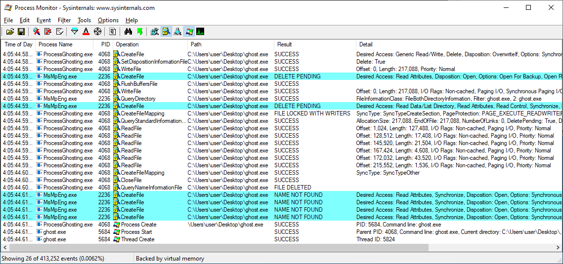

Examining system activity during the demo, we can see Defender initially attempting to open the payload executable to scan it, but failing because the file is in a delete-pending state. Later attempts to open it fail because the file has already been deleted. The payload (ghost.exe) executes without issue.

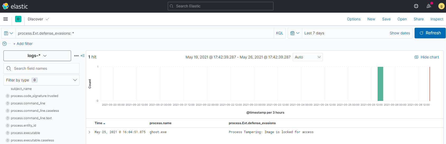

Elastic Security detects a variety of process image tampering techniques including Doppelgänging, Herpaderping, and Ghosting. It does this by checking the FILE_OBJECT for abnormalities during the process creation callback. These are reported in process creation events under process.Ext.defense_evasions.
