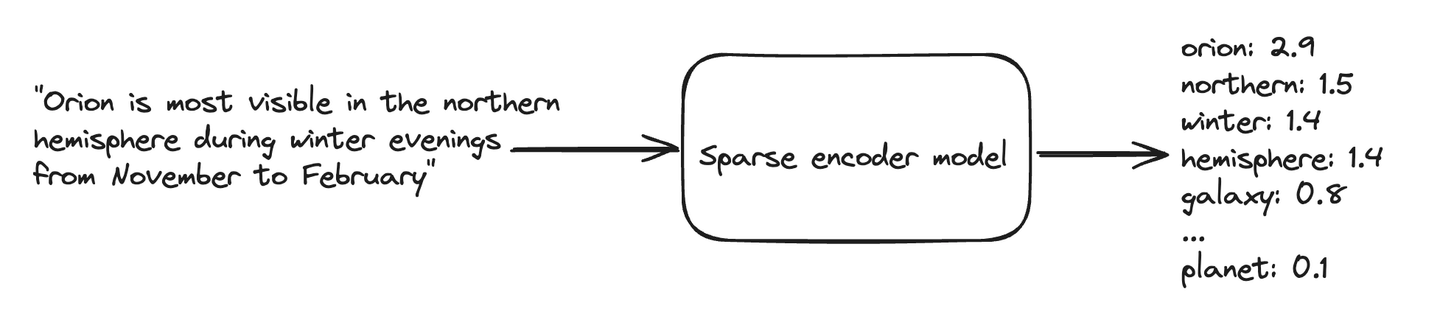

Let’s look at an example: let’s say we’ve indexed a document detailing when Orion is most visible in the night sky:
Indexing sparse vectors encoding example

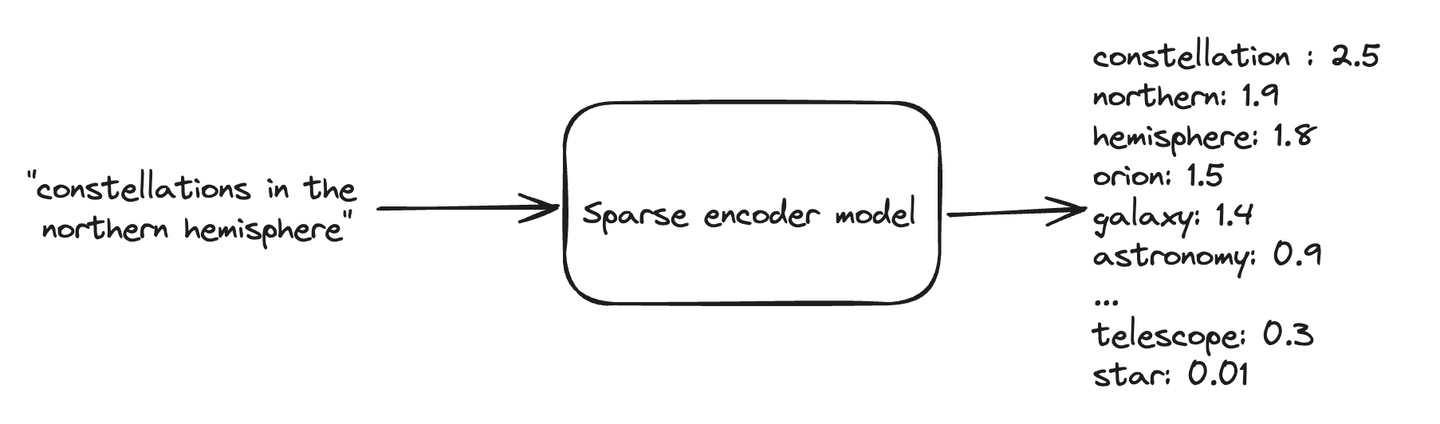

Now, assume we’re looking for constellations that are visible in the northern hemisphere, and we run this query through the same learned sparse encoder model. The output might look similar to this:
Searching sparse vectors encoding example
