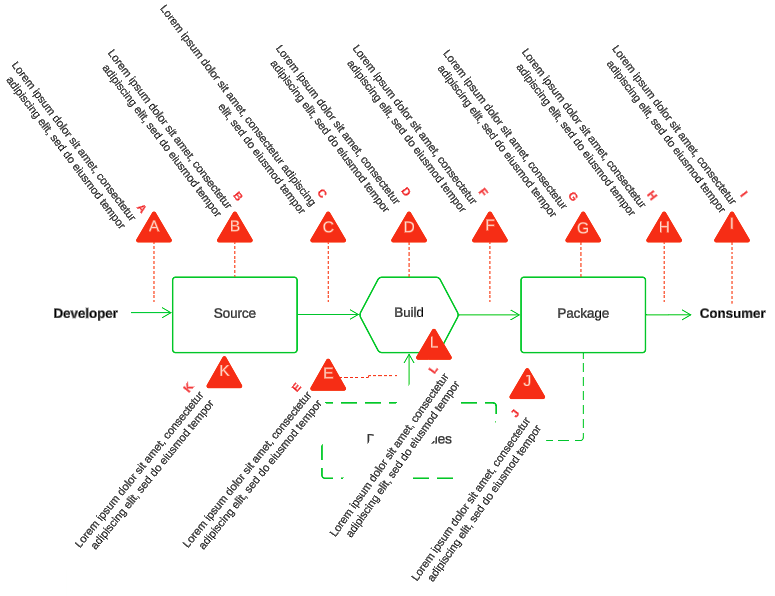

1. Lay out the infrastructure
We started with SLSA’s supply chain threats diagram and added additional specificity in a diagramming application. Each piece of infrastructure has an accompanying malicious action taken on it. If multiple malicious actions are possible, you likely need to break them into separate pieces so they can each have a discrete probability (step 2).
 Infrastructure detailing malicious action
Layer 1: Infrastructure with detailed description of malicious action being taken there
In the next steps, we’ll see that you can choose your level of detail here. You might try separating distinct options only to find they are alike enough to be rolled together, but when unsure, the exercise of factoring and enumerating options is informative.
Add a layer that just contains notes so that you capture details as you go. If you do roll options up into one step, note which steps are included so new/overlooked information is easily recognized during future analyses.

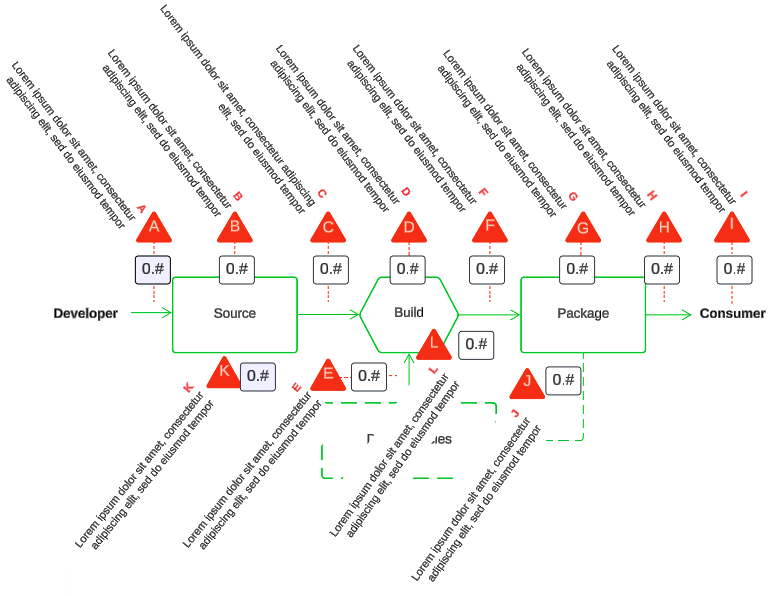

2. Add statistical probabilities for each discrete step
Assign a likelihood from 0 (impossible) to 1 (inevitable) to each step.
For entry points or attack vectors, it may be helpful to think of likelihood as “successful attack(s) per year(s),” and for lateral or escalating movements to think of likelihood as “chance of success given they’ve gotten this far.” But either mental framing ultimately produces the same results.
Statistical probabilities for each discrete step
Layer 2: Assign a probability to each malicious action

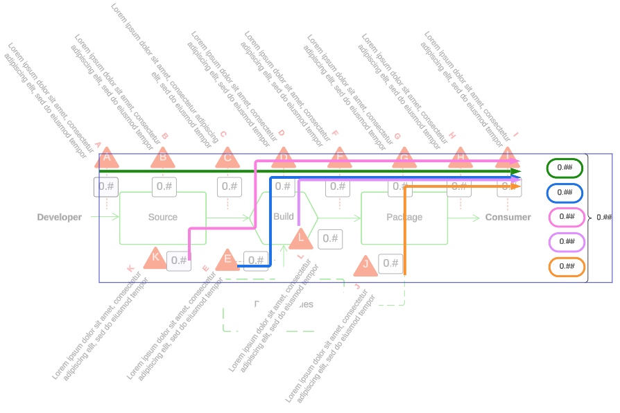

3. Map the attack routes and calculate LEF
Recall that the likelihood of a sequence of events is the product of each probability therein, so multiply each step along the attack route to get the overall likelihood for that path. The likelihood of any one of several events happening is the sum of each event, so add each path likelihood to get the overall Loss Event Frequency for this scenario.
Map attack routes
Layer 3: Map all attack routes and their likelihood
Notice the single, multifaceted, opaque Loss Event Frequency is now five separate attack paths with discrete steps and rich detail. It’s trivial to see which paths and steps are highest risk and how changes from mitigation projects will impact LEF and the overall annual risk.
