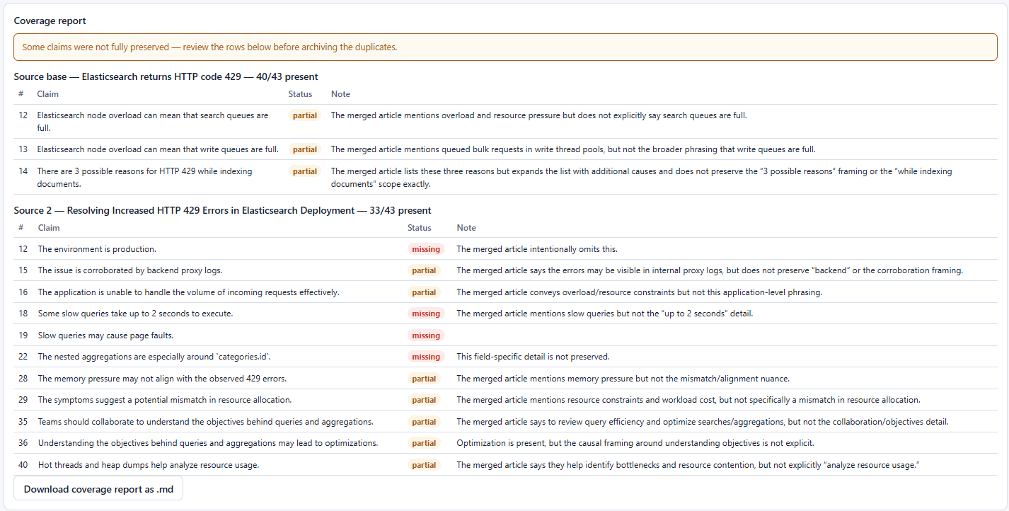

Reading the two tables
You now have two claim tables covering the same merged article from two directions. Concatenate them and you have your coverage table.
There are three states and three different jobs for the engineer:
  • Present needs nothing. This is most rows, and that's the point; the volume of the task collapses onto the exceptions.
  • Missing is usually correct. In practice, most omissions are intentional: the claim was redundant with the other source, or it didn't meet the quality bar and was dropped on purpose. What matters is that the decision is now visible and someone signed off on it instead of the claim quietly evaporating.
  • Partial is the most interesting state, and the one that justifies having three categories instead of two. The classic case is where one engineer wrote "affects 8.x" and another engineer wrote "affects 8.12.0 through 8.12.3." Both are true. One is far more useful. The model is generally good at picking the more precise wording, but partials are where the human reviewer adds the most value per minute spent, nudging granularity, restoring a caveat, and tightening a version constraint.
The last step is still a person
The engineer takes the merged article and the combined table and makes the final edits by hand. That's not a limitation of the approach; it's the intended end state. The tool's job was never to remove the human. It was to replace "reread two articles and hope you notice what's gone" with "here are the 11 rows that need a decision."
It’s the same person, same judgment, and five minutes instead of one hour.

The result
A backlog that survived four years of good intentions is being worked through at roughly five minutes of human attention per merge. The articles that come out are more complete than either input because the coverage table surfaces claims a human reviewer would have skimmed past in both directions.
But the number we care about more is this: not one merge has shipped with an undetected omission because undetected omission is no longer a state the workflow permits.
An example result where two KB articles about HTTP 429 rejections were merged looks like this.

The coverage report for this example looks like this:

Very little of this is about knowledge bases. If you are trying to put an LLM somewhere, the cost of being subtly wrong is high. The pattern generalizes:
  • Never let the generating pass certify itself: Verification must be structurally separate with its own inputs and its own success criteria.
  • Decompose the fidelity question into atoms: Holistic quality judgments cannot be verified. Atomic claims can.
  • Make omissions enumerable: Hallucination gets the attention; silent loss is the more dangerous failure, and the only defense is an explicit inventory of what must be preserved.
  • Pin the payloads: Commands, versions, identifiers, and configuration are copied, never generated. Reserve the model for prose.
  • Give the human a decision list, not a document: Review effort should scale with the number of flagged problems, not the length of the output.
The lesson we took away is not that LLMs are trustworthy. They aren't; not on their own. And designing as if they are is how you get a knowledge base full of confident fiction. The lesson is that trustworthiness can be an architectural property rather than a model property. You build a system whose output you can check cheaply and then the model's unreliability stops being a blocker and becomes a managed cost.
Hallucination is not a reason to keep AI out of your high-stakes workflows. It's a design constraint. So, design for it.
