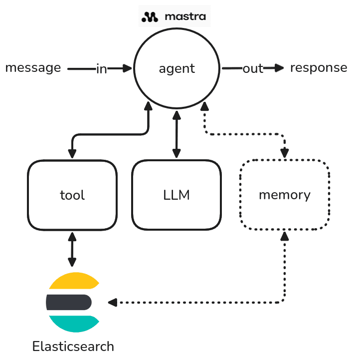

An agent is a class that accepts a message in input and produces a response as output. An agent can use tools, large language models (LLMs), and a memory (figure 1).
Figure 1: A diagram showing how an agent works in Mastra.
An agent's tools allow it to interact with the "external world," such as communicating with a web API or performing an internal operation, like querying Elasticsearch. The memory component is crucial for storing the history of conversations, including past inputs and outputs. This stored context enables the agent to provide more informed and relevant responses to future questions by using its past interactions.

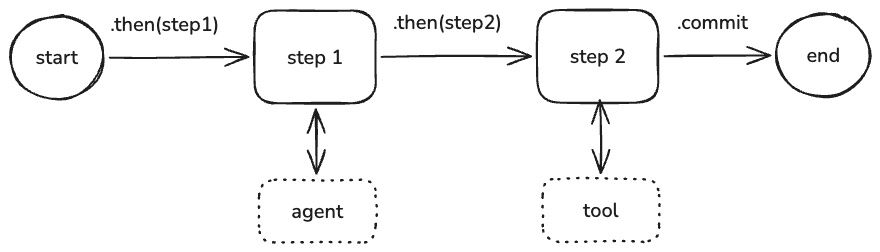

Workflows let you define complex sequences of tasks using clear, structured steps rather than relying on the reasoning of a single agent (figure 2). They give you full control over how tasks are broken down, how data moves between them, and what gets executed when. Workflows run using the built-in execution engine by default or can be deployed to workflow runners.
Figure 2: An example of workflow in Mastra.

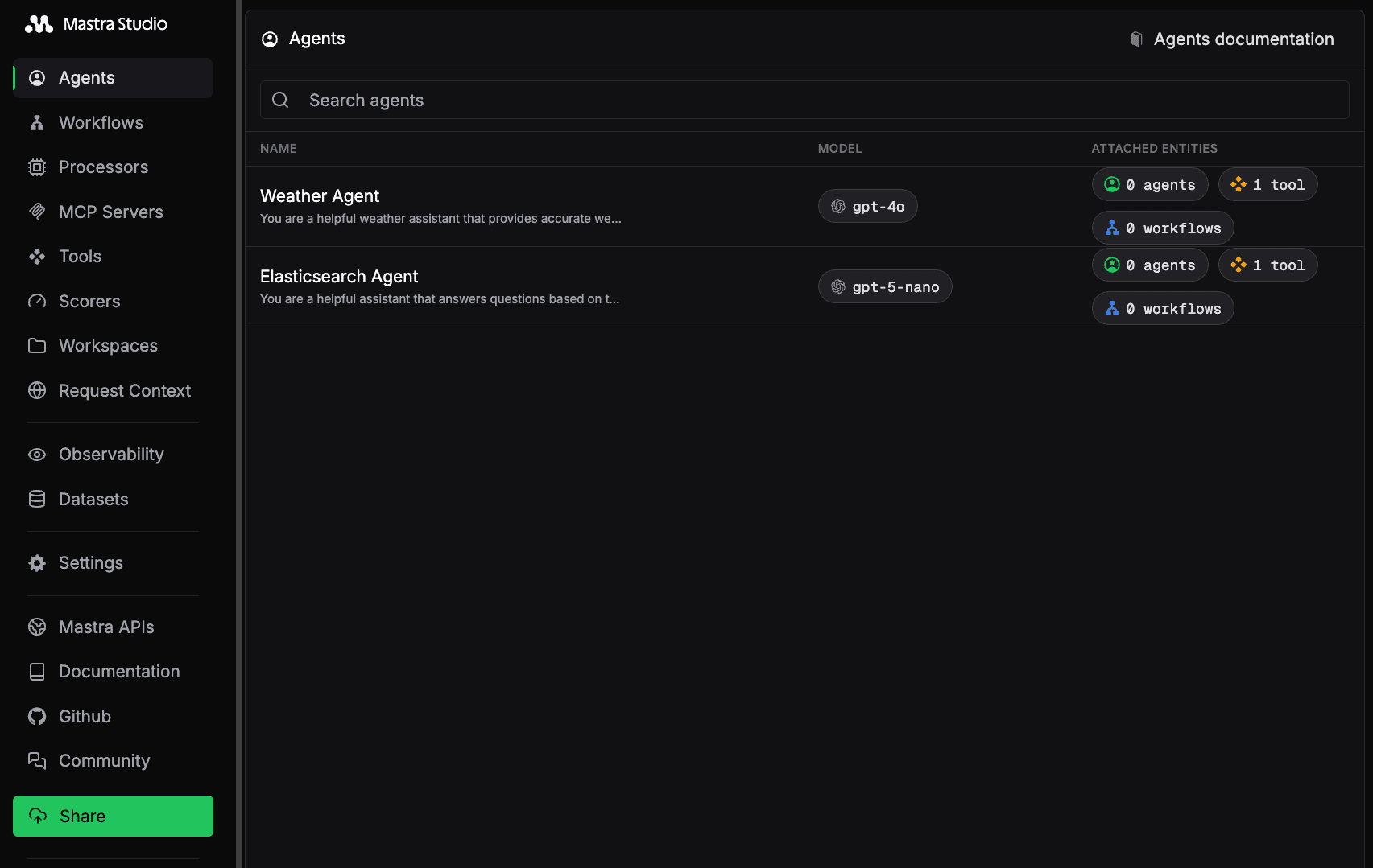

This command will start a web application at localhost:4111 to access Mastra Studio (figure 3).
Figure 3: A screenshot of Mastra Studio with the Elasticsearch Agent example.
Mastra Studio offers an interactive UI for building and testing your agents, along with a REST API that exposes your Mastra application as a local service. This lets you start building right away without worrying about integration.

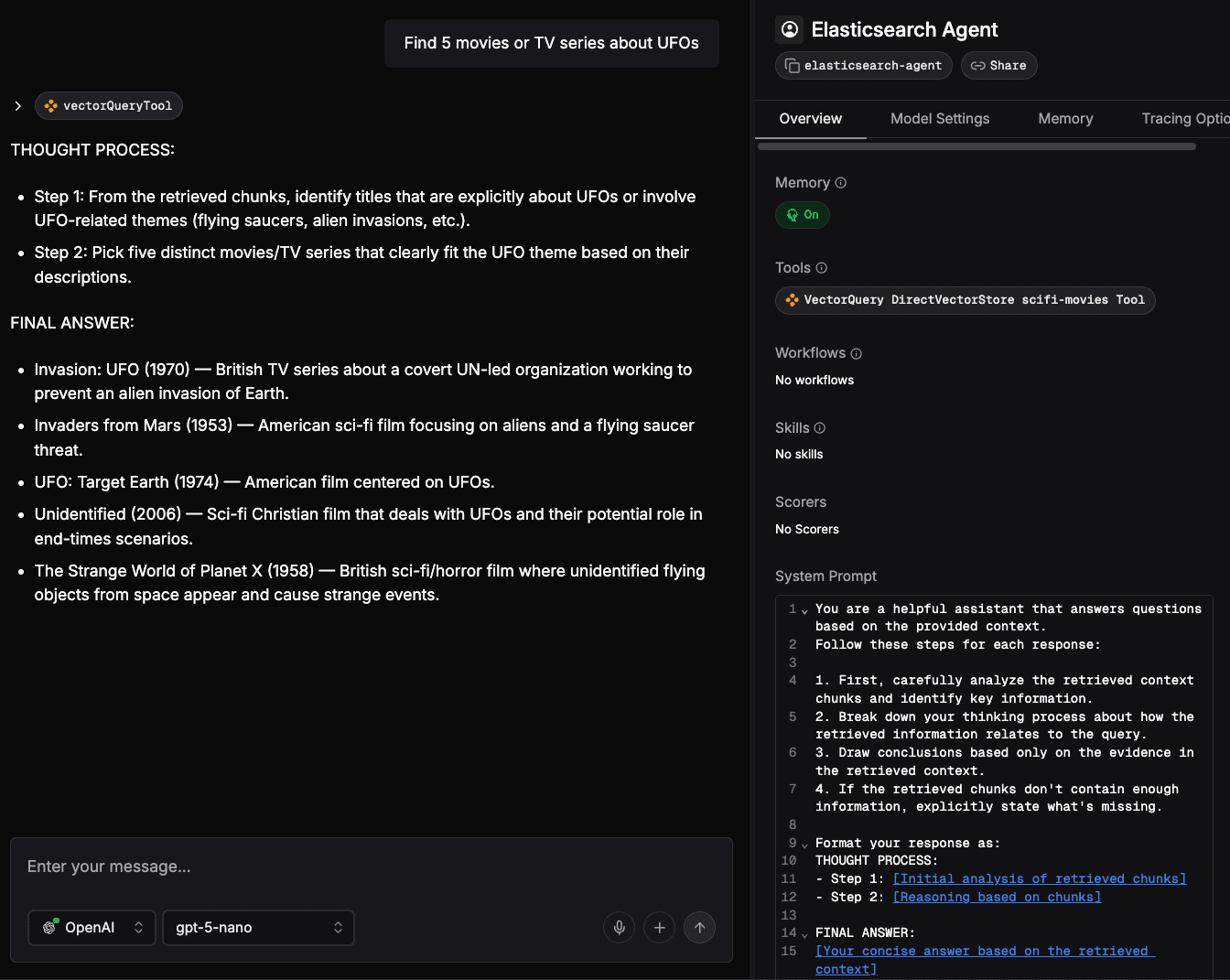

If you click on the Mastra Studio > Agents menu and select Elasticsearch Agent, you can test the agent using a chat system. For instance, you can ask information regarding sci-fi movies with a question as follows:
Find 5 movies or TV series about UFOs.
You’ll notice that the agent will execute the vectorQueryTool. You can click on the invoked tool to have a look at the input and the output. At the end of execution, the LLM will reply to your question, given the context coming from the scifi-movies index of Elasticsearch (figure 4).
Figure 4: Response from LLM using the Elasticsearch Agent.
Mastra executes the following steps internally:
  1. Vector conversion: The user's question, Find 5 movies or TV series about UFOs, is converted into a vector embedding using OpenAI's openai/text-embedding-3-small model.
  2. Vector search: This embedding is then used to query Elasticsearch via a vector search.
  3. Result retrieval: Elasticsearch returns a set of 10 movies highly relevant to the query (that is, those with vectors closest to the user's query vector).
  4. Answer generation: The retrieved movies and the original user question are sent to the LLM, specifically openai/gpt-5-nano. The LLM processes this information and generates a final answer, ensuring that the user's request for five results is met.
