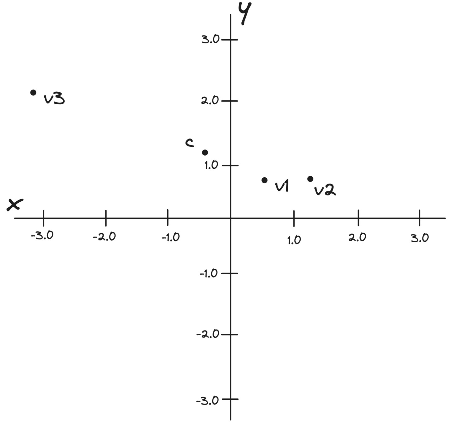

Let's continue with our vectors, v1v_1, v2v_2, and v3v_3. We pick their centroid as the pivot point.
v1=[0.56,0.82]v2=[1.23,0.71]v3=[-3.28,2.13] c=[(0.56+1.23+-3.28)/3,(0.82+0.71+2.13)/3] c=[-0.49,1.22]v_1 = [0.56, 0.82] \newline v_2 = [1.23, 0.71] \newline v_3 = [\text{-}3.28, 2.13] \newline ~\\ c = [(0.56 + 1.23 + \text{-}3.28) / 3, (0.82 + 0.71 + 2.13) / 3] \newline ~\\ c = [\text{-}0.49, 1.22]
Here's all of those points graphed together:
2D Three Vectors with Centroid Illustration
Figure 1: graph of the example vectors and the derived centroid of those three vectors.

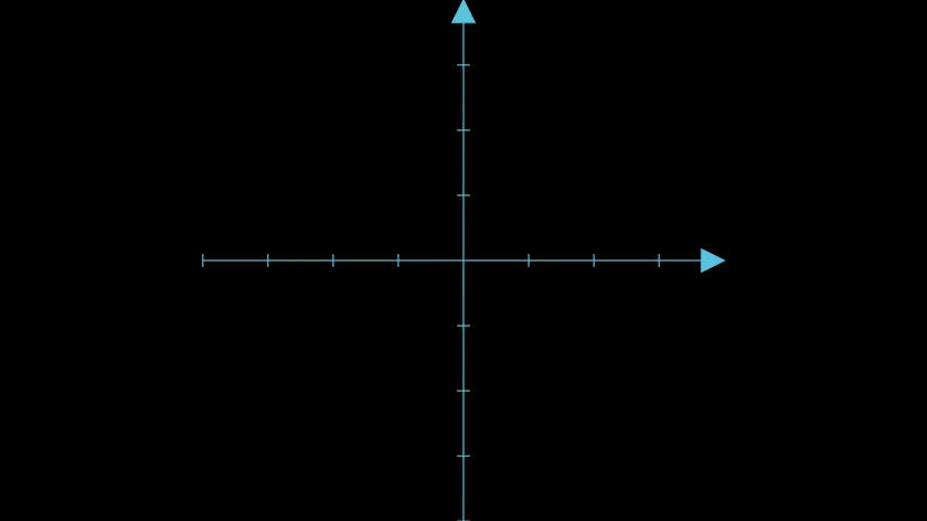

Let's see that transformation and normalization all together:
2D Three Vectors with Centroid Transformed to Unit Circle Illustration
Figure 2: Animation of the example vectors and the derived centroid transformed within the unit circle.
As you may be able to see our points now sit on the unit circle around the centroid as if we had placed the centroid at 0,0.

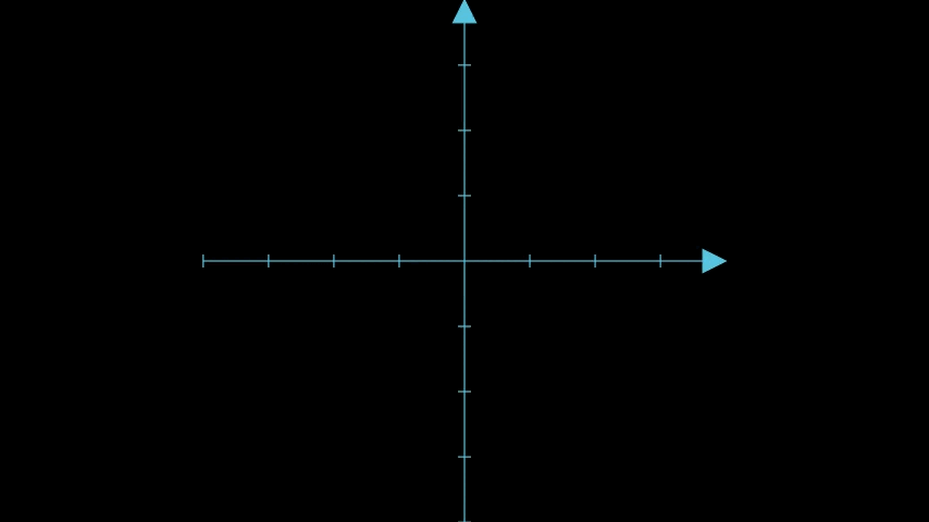

We finish quantizing each data vector by snapping it to a representative point within each region specifically picking a point equidistant from each axis on the unit circle: ±1d\pm \frac{1}{\sqrt{d}}
We'll denote each quantized vector as v1\overline{v}_1, v2\overline{v}_2, and v3\overline{v}_3.
So for instance if we snap vc1v_{c1} to its representative point within its region r1r_1 we get:
v1=1d(2r11)=12[1,1]=[12,12]\begin{align*} \overline{v}_1 &= \frac{1}{\sqrt{d}} (2 r_1 - 1) \newline &= \frac{1}{\sqrt{2}} [1, -1] \newline &= [\frac{1}{\sqrt{2}}, -\frac{1}{\sqrt{2}}] \end{align*}
And here are the quantized forms for the other data vectors, v2v_2 and v3v_3:
v2=[12,12]v3=[12,12]\overline{v}_2 = [\frac{1}{\sqrt{2}}, -\frac{1}{\sqrt{2}}] \newline \overline{v}_3 = [-\frac{1}{\sqrt{2}}, \frac{1}{\sqrt{2}}]
Picking these representative points has some nice mathematical properties as outlined in the RaBitQ paper. And are not unlike the codebooks seen in product quantization (PQ).
Binary Quantization of 2D Three Vectors Illustration
Figure 3: Binary quantized vectors within a region snapped to representative points.
At this point we now have a 1 bit approximation; albeit a somewhat fuzzy one that we can use to do distance comparisons. Clearly, v1\overline{v}_1 and v2\overline{v}_2 are now identical in this quantized state, which is not ideal and is a similar problem experienced when we discussed encoding float vectors as Bit Vectors In Elasticsearch.
