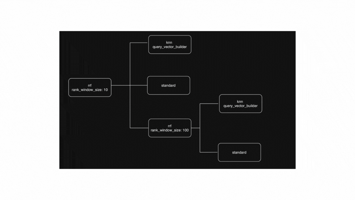

The rrf retriever above is a compound one, as it operates on the results of some other retrievers, so we'll try to rewrite it to a simpler, flattened, list of <doc, shard> tuples, where each tuple specifies a document and the shard that it was found on. This rewrite will also enforce a strict ranking, so no different sort options are currently supported.
Let's proceed now to identify all components and describe the process of how this will be evaluated:
[1] top level rrf retriever; this is the parent of all sub-retrievers which will be rewritten and evaluated last, as we'd first need to know the top 10 (based on rank_window_size) results from each of its sub-retrievers.
[2] This knn retriever is the first child of the top level rrf retriever and uses an embedding service (my-text-embedding-model) to compute the actual query vector that will be used. This will be rewritten as the usual knn query by making an async request to the embedding service to compute the vector for the given model_text.
[3] A standard retriever that is also part of the top-level's rrf retriever's children, which returns all documents matching topic: science query.
[4] Last child of the top-level rrf retriever which is also an rrf retrievers that needs to be flattened.
[5] [6] similar to [2] and [3], these are retrievers that are direct children of an rrf retriever, for which we will fetch the top 100 results (based on the rrf retriever's rank_window_size [4]) for each one, combine them using the rrf formula, and then rewrite to a flattened <doc, shard> list of the true top 100 results.
The updated execution flow for retrievers is now as follows:
  • We'll start by rewriting all leaves that we can. This means that we'll rewrite the knn retrievers [2] and [6] to compute the query vector, and once we have that we can move up one level in the tree.
  • At the next rewrite step, we are now ready to evaluate the nested rrf retriever [4], which we will eventually rewrite to a flattened RankDocsQuery query (i.e. a list of <doc, shard> tuples).
  • Finally, all inner rewritten steps for the top-level rrf retriever [1] will have taken place, so we should be ready to combine and rank the true top 10 results as requested. Even this top-level rrf retriever will rewrite itself to a flattened RankDocsQuery which will be later used to proceed with the standard linear search execution flow.
Visualizing all the above, we have:
Retrievers example
Looking at the example above, we can see how a hierarchical retriever tree is asynchronously rewritten to just a simple RankDocsQuery. This simplification gives us the nice (and desired!) side effect of eventually executing a normal request with explicit ranking, and in addition to that we can also perform any complementary operations we choose.
