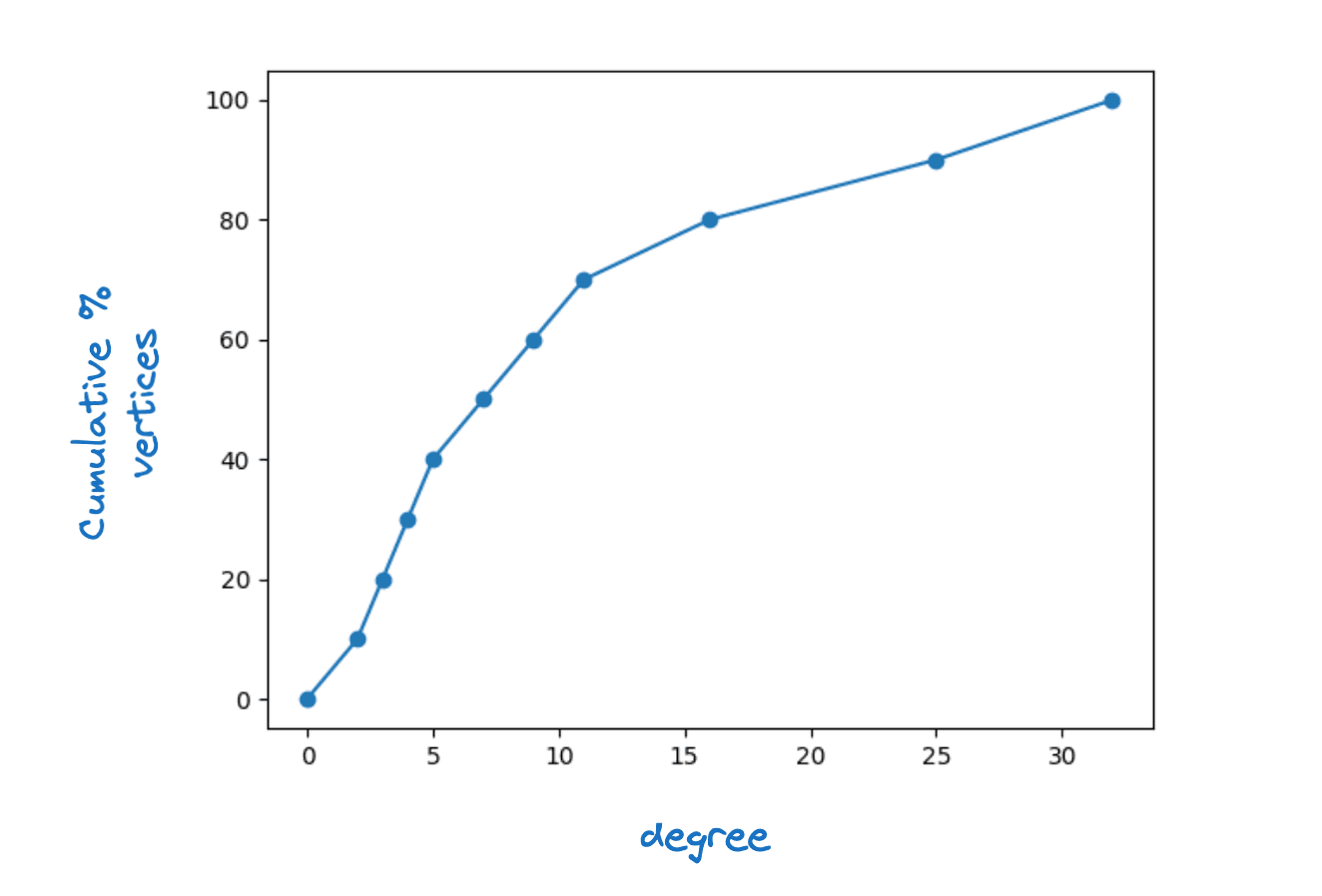

It's clear that for this to work every vertex in must have at least one neighbor in . In fact, we require that for every vertex in that for some , the maximum layer connectivity. We observe that in real HNSW graphs we see quite a spread of vertex degrees. The figure below shows a typical cumulative density function of vertex degree for the bottom layer of an Lucene HNSW graph.
Example vertex degree distribution
We explored using a fixed value for as well as making it a function of the vertex degree. This second choice leads to larger speedups with minimal impact on graph quality so went with the following
Note that | is equal to the degree of the vertex in the small graph by definition. Having a lower limit of two means that we will insert every vertex whose degree is less than two.

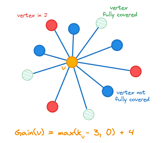

Computing the join set
Finding a good join set can be formulated as an HNSW graph covering problem. A greedy heuristic is a simple and effective heuristic for approximating optimal graph covers. The approach we take picks vertices one at a time to add to in decreasing gain order. The gain is defined as follows:
Here, denotes the count of neighbors of a vector in and is the indicator function. The gain includes the change in the count of the vertex we added to , i.e. , since we get closer to our goal by adding a less covered vertex. The gain calculation is illustrated in the figure below for the central orange vertex.
Vertex gain to add to join set J

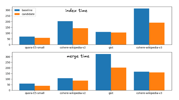

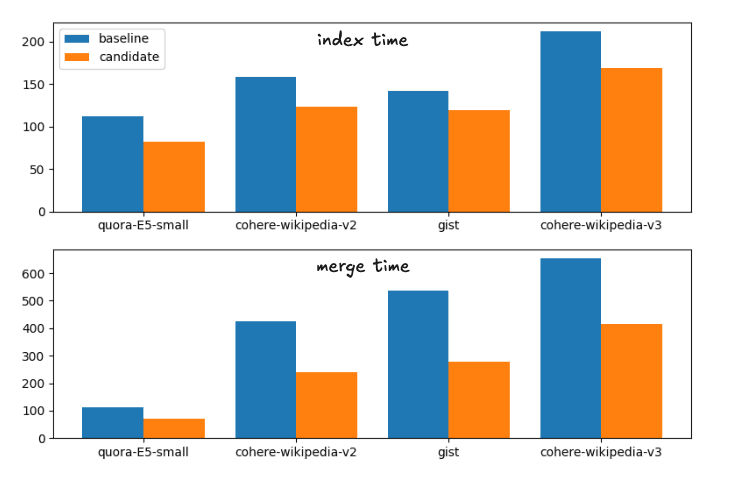

The average speedups from the baseline to the candidate, the proposed changes, are:
Index Time Speedup: 1.28
Force Merge Speedup: 1.72
This corresponds to the following breakdown in run times
Index and merge times for the baseline and candidate merge strategies
For completeness the exact times are
Index | Merge | |||
Dataset | baseline | candidate | build | candidate |
quora-E5-small | 112.41s | 81.55s | 113.81s | 70.87s |
wiki-cohere-v2 | 158.1s | 122.95s | 425.20s | 239.28s |
gist | 141.82s | 119.26s | 536.07s | 279.05s |
wiki-cohere-v3 | 211.86s | 168.22s | 654.97s | 414.12s |

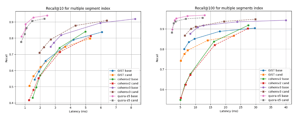

Below we show the recall vs latency graphs that compare the candidate (dashed lines) to the baseline at two retrieval depths: recall@10 and recall@100 for indices with multiple segments (the final result of our default merge strategy after indexing all vectors) and after force merging to a single segment. A curve that is higher and further to the left is better, which means higher recall at lower latency.

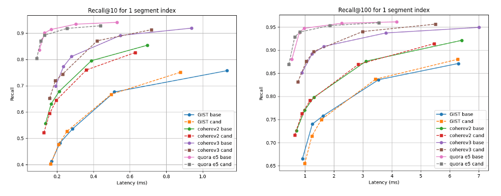

As you can see, for multiple segment indices the candidate is better for the Cohere v3 dataset and slightly worse, but almost comparable, for all other datasets. After merging to a single segment recall curves are almost identical for all cases.
Recall @10 and @100 vs latency after building the index
Recall @10 and @100 vs latency after merging to a single segment

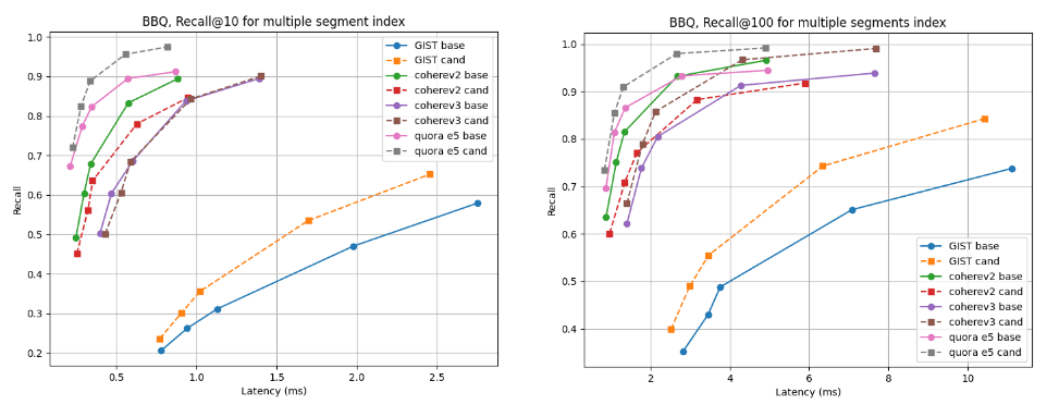

Experiment 2: BBQ quantization
The average speedups from the baseline to the candidate are:
Index Time Speedup: 1.33
Force Merge Speedup: 1.34
Index and merge time for the baseline and candidate merge strategies
Index | Merge | |||
quora-E5-small | 70.71s | 58.25s | 59.38s | 40.15s |
wiki-cohere-v2 | 203.08s | 142.27s | 107.27s | 85.68s |
gist | 110.35s | 105.52s | 323.66s | 202.2s |
wiki-cohere-v3 | 313.43s | 190.63s | 165.98s | 159.95s |

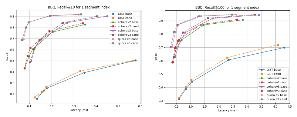

For multiple segment indices the candidate is better for almost all datasets, except cohere v2 where the baseline is slightly better. For the single segment indices recall curves are almost identical for all cases.
Recall @10 and @100 vs latency having merged to a single segment
