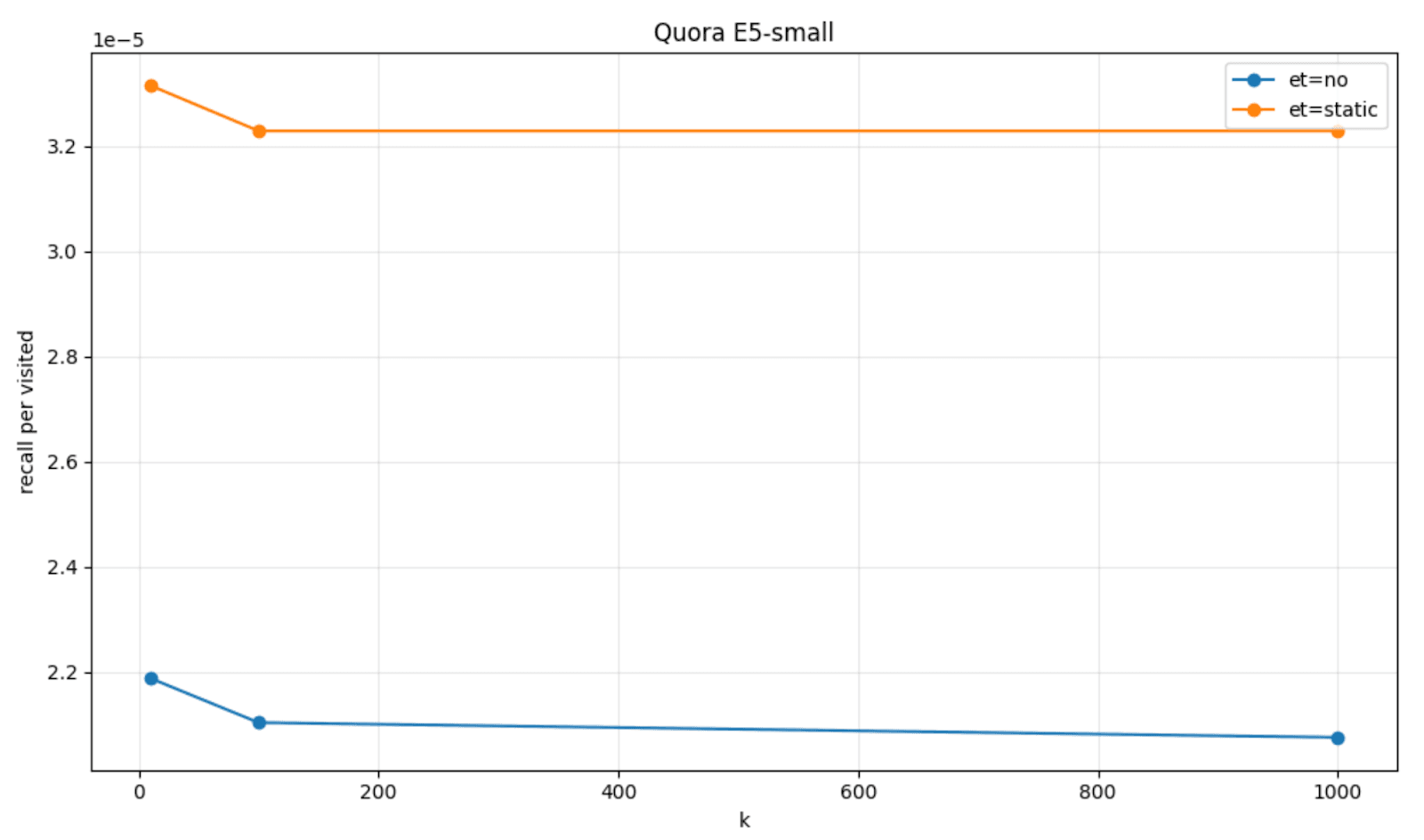

To visualize this, we can plot the amount of recall per visited node that we got with the patience based early termination (labeled as et=static), when compared to the default HNSW behavior (labeled as et=no) on a couple of datasets, FinancialQA and Quora, and models, JinaV3 and E5-small.

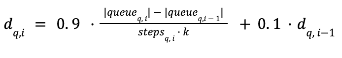

So instead of comparing the queue saturation ratio between two consecutive candidates, we decided to introduce both an instant smoothed discovery rate dq,id_{q,i} (how many new neighbors were introduced for a query q, in the last visit i) together with rolling mean μq,i\mu_{q,i} and standard deviation σq,i\sigma_{q,i} of such a discovery rate during the graph visit (using Welford’s algorithm). These statistics about the discovery rate are calculated per query, so that this information can be used to decide different degrees of patience for each query.

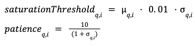

The previously static thresholds become adaptive to the discovery rate statistics: The saturation threshold becomes the rolling mean plus the standard deviation; whereas we make the patience adapt and scale inversely with the standard deviation.
The early exit rules remain the same; the saturation happens when the instant discovery rate is lower than the adaptive saturation threshold. The graph visit stops if the saturation persists for a number of consecutive candidate visits that’s larger than the adaptive patience.
