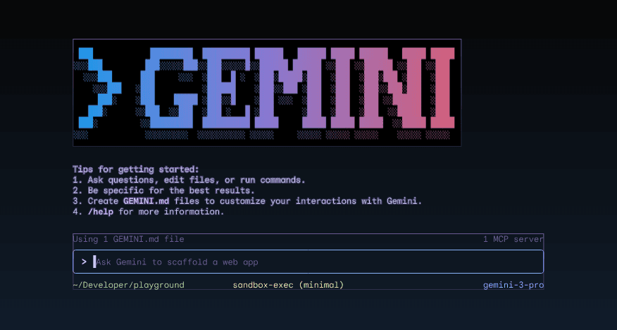

After installation, start the CLI by running:
gemini
You see a screen, as shown in Figure 1:
Figure 1: A screenshot of Gemini CLI.

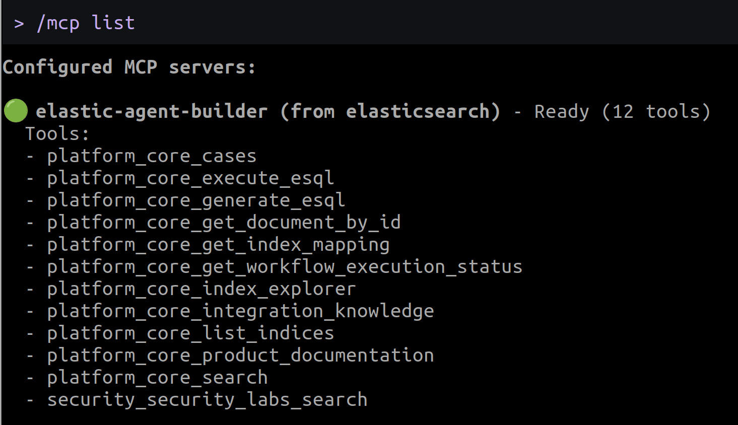

How to use the Elasticsearch MCP
You can check the connection using the following command in Gemini:
/mcp list
You should see the elastic-agent-builder enabled, as shown in Figure 2:
Figure 2: The elastic-agent-builder MCP server with the list of tools.
Elasticsearch provides a default set of tools. See the description here.

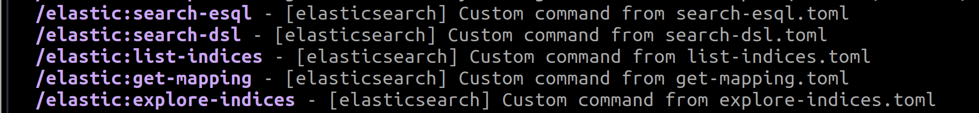

The /elastic commands
In the Elasticsearch extension for Gemini CLI, we also added /elastic commands.
If you execute the /help command, you see all the available /elastic options (Figure 3):
Figure 3: The available /elastic commands.
These commands can be useful if you want to directly execute a specific tool of the elastic-agent-builder MCP server. For instance, using the following command, you can get the mapping of the kibana_sample_data_ecommerce:
