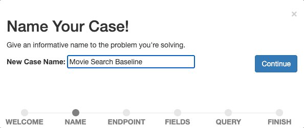

How to set up a Quepid case
Quepid is organized around "Cases." A Case stores queries together with relevance tuning settings and how to establish a connection to your search engine.
For first-time users, select Create Your First Relevancy Case.
Returning users can select Relevancy Cases from the top-level menu and click + Create a case.
Name your case descriptively, e.g., "Movie Search Baseline," as we want to start measuring and improving our baseline search.
Confirm the name by selecting Continue.

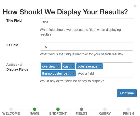

Now we define which fields we want to see displayed in the case. Select all that help our human raters later assess the relevance of a document for a given query.
Set title as the Title Field, leave _id as the ID Field, and add overview, tagline, cast, vote_average, thumb:poster_path as Additional Display Fields. The last entry displays small thumbnail images for the movies in our results to visually guide us and the human raters.
Confirm the display settings by selecting the Continue button.

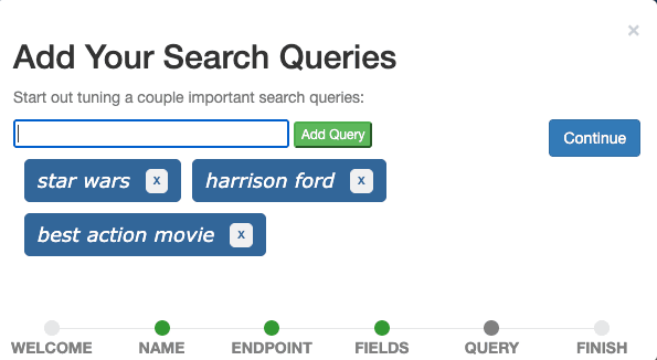

The last step is adding search queries to the case. Add the three queries star wars, harrison ford, and best action movie one by one via the input field and Continue.
Ideally, a case contains queries that represent real user queries and illustrate different types of queries. For now, we can imagine star wars being a query representing all queries for movie titles, harrison ford a query representing all queries for cast members, and best action movie a query representing all queries that search for movies in a specific genre. This is typically called a query set.
In a production scenario, we would sample queries from event tracking data by applying statistical techniques like Probability-Proportional-to-Size sampling and import these sampled queries into Quepid to include queries from the head (frequent queries) and tail (infrequent queries) relative to their frequency, which means we bias towards more frequent queries without excluding rare ones.
Finally, select Finish and you will be forwarded to the case interface where you see the three defined queries.

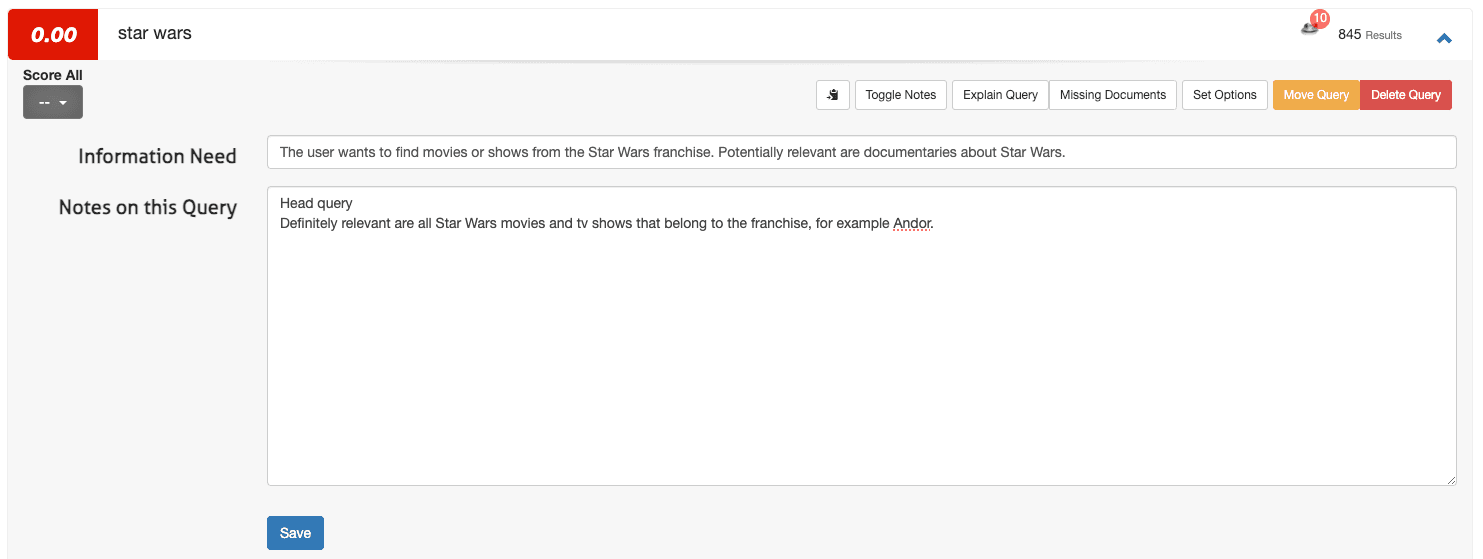

How to define information needs in Quepid
To define an information need in Quepid, access the case interface:
1. Open a query (for example star wars) and select Toggle Notes.
2. Enter the Information Need in the first field and any additional notes in the second field:
3. Click Save.

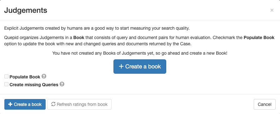

Create a book of judgements in Quepid
A Book in Quepid allows multiple raters to evaluate query/document pairs systematically. To create one:
1. Go to Judgements in the case interface and click + Create a Book.
2. Configure the book with a descriptive name, assign it to your team, select a scoring method (for example, DCG@10), and set the selection strategy (single or multiple raters). Use the following settings for the Book:
Name: “Movies Search 0-3 Scale”
Teams to Share this Book With: Check the box with the Team you created
Scorer: DCG@10
3. Click Create Book.
The name is descriptive and contains information about what is searched in (“Movies”) and also the scale of the judgements (“0-3”). The selected Scorer DCG@10 defines the way the search metric will be calculated. “DCG” is short for Discounted Cumulative Gain and“@10” is the number of results from the top taken into consideration when the metric is calculated.
In this case, we are using a metric that measures the information gain and combines it with positional weighting. There may be other search metrics that are more suitable for your use case and choosing the right one is a challenge in itself.

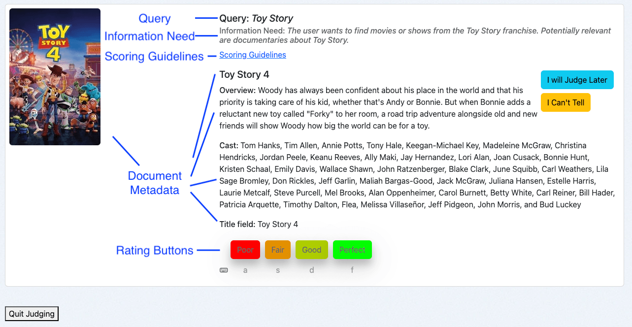

Overview of the Human Rating interface
Quepid's Human Rating interface is designed for efficient assessments:
Query: Displays the search term.
Information Need: Shows the user's intent.
Scoring Guidelines: Provides instructions for consistent evaluations.
Document Metadata: Presents relevant details about the document.
Rating Buttons: Allows raters to assign judgements with corresponding keyboard shortcuts.

Let’s walk through a couple of examples. When you are following this guide, you will most likely be presented with different movies. However, the rating principles stay the same.

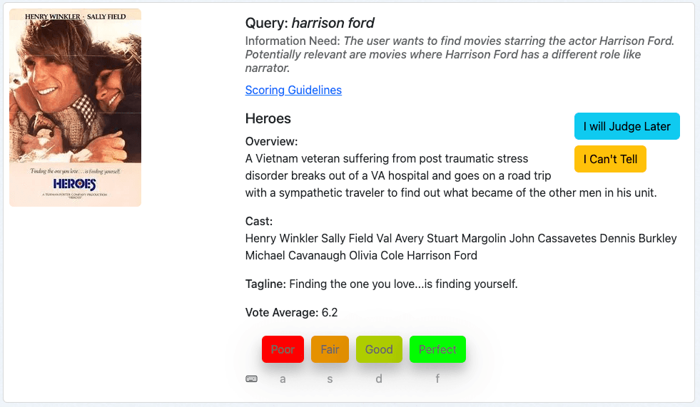

Our first example is the movie “Heroes” for the query harrison ford:
We first look at the query, followed by the information need and then judge the movie based on the metadata given.
This movie is a relevant result for our query, since Harridson Ford is in its cast. We may regard more recent movies as more relevant subjectively but this is not part of our information need. So we rate this document with “Perfect” which is a 3 in our graded scale.
Our next example is the movie “Ford v Ferrari” for the query harrison ford:
Following the same practice, we judge this query/doc by looking at the query, the information need and then how well the document’s metadata matches the information need.
This is a poor result. We probably see this result as one of our query terms, “ford”, matches in the title. But Harrison Ford plays no role in this movie, nor any other role. So we rate this document “Poor” which is a 0 in our graded scale.

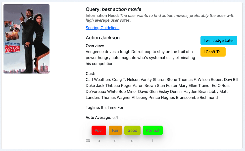

Our third example is the movie “Action Jackson” for the query best action movie:
This looks like an action movie, so the information need is at least partially met. However, the vote average is 5.4 out of 10. And that makes this movie probably not the best action movie in our collection. This would lead me as a judge to rate this document “Fair,” which is a 1 in our graded scale.
These examples illustrate the process of rating query/doc pairs with Quepid in particular, on a high level and also in general.

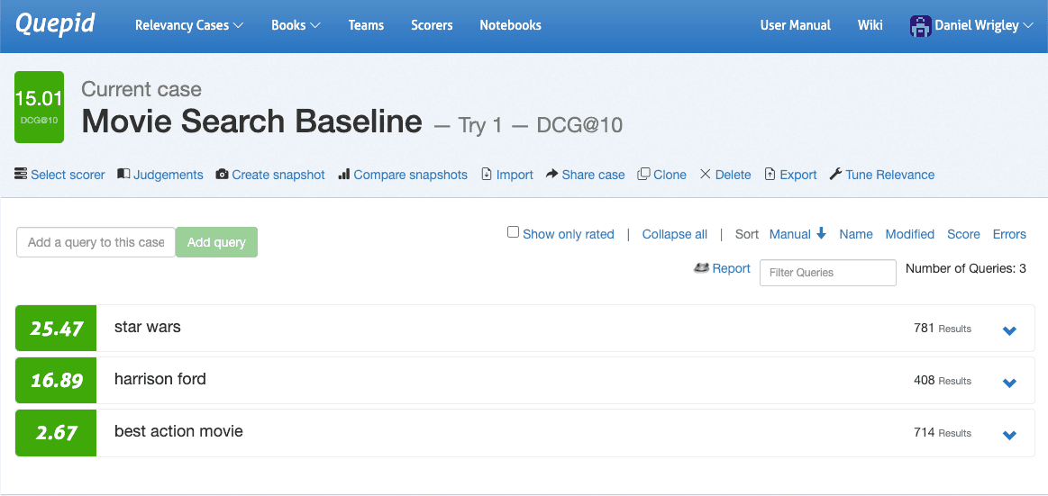

Calculate metrics and start experimenting
Once judgement lists are available, leveraging the judgements and calculating search quality metrics is a natural progression. Quepid automatically calculates the configured metric for the current case when judgements are available. Metrics are implemented as “Scorers” and you can provide your own when the supported ones do not include your favorite!
Go to the case interface, navigate to Select Scorer, choose DCG@10 and confirm by clicking on Select Scorer. Quepid will now calculate DCG@10 per query and also average overall queries to quantify the search result quality for your case.
Now that your search result quality is quantified, you can run first experiments. Experimentation starts with generating hypotheses. Looking at the three queries in the screenshot after doing some rating makes it obvious that the three queries perform very differently in terms of their search quality metric: star wars performs pretty well, harrison ford looks alright but the greatest potential lies in best action movie.
Expanding this query we see its results and can dive into the nitty gritty details and explore why documents matched and what influences their scores:
By clicking on “Explain Query” and entering the “Parsing” tab we see that the query is a DisjunctionMaxxQuery searching across three fields: cast, overview and title:
