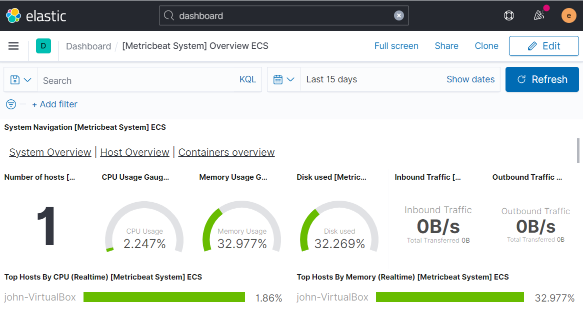

Load the Metricbeat Kibana dashboards
Metricbeat comes packaged with example dashboards, visualizations, and searches for visualizing Metricbeat data in Kibana. Before you can use the dashboards, you need to create the data view (formerly index pattern) metricbeat-*, and load the dashboards into Kibana. This needs to be done from a local Beats machine that has access to the Elastic Cloud Enterprise deployment.
Beginning with Elastic Stack version 8.0, Kibana index patterns have been renamed to data views. To learn more, check the Kibana What’s new in 8.0 page.
  1. Open a command line instance and then go to <localpath>/metricbeat-<version>/
  2. Run the following command:
sudo ./metricbeat setup \
  -E cloud.id=<cloudID> \
  -E cloud.auth=<username>:<password>
  -E setup.kibana.ssl.certificate_authorities=['/path/to/the/elastic-ece-ca-cert.pem'] \
  -E setup.kibana.ssl.verification_mode='certificate' \
  -E output.elasticsearch.ssl.certificate_authorities=['/path/to/the/elastic-ece-ca-cert.pem'] \
  -E output.elasticsearch.ssl.verification_mode='certificate'
Specify the Cloud ID of your Elastic Cloud Enterprise deployment. You can include or omit the <Deploymentname>: prefix at the beginning of the Cloud ID. Both versions work fine. Find your Cloud ID by going to the Kibana main menu and selecting Management > Integrations, and then selecting View deployment details.
Specify the username and password provided to you when creating the deployment. Make sure to keep the colon between <username> and <password>.
The four lines related to ssl are only used when you have a self signed certificate for your Elastic Cloud Enterprise proxy. If needed, specify the full path to the PEM formatted root cetificate (Root CA) used for the Elastic Cloud Enterprise proxy. You can retrieve the certificate chain from your ECE system by following the instructions in Get existing ECE security certificates. Save the final certificate in the chain to a file. In this command example, the file is named elastic-ece-ca-cert.pem.
Depending on variables including the installation location, environment and local permissions, you might need to change the ownership of the metricbeat.yml.
You might encounter similar permissions hurdles as you work through multiple sections of this document. These permission requirements are there for a good reason, a security safeguard to prevent unauthorized access and modification of key Elastic files.
If this isn’t a production environment and you want a fast-pass with less permissions hassles, then you can disable strict permission checks from the command line by using --strict.perms=false when executing Beats (for example, ./metricbeat --strict.perms=false).
Depending on your system, you may also find that some commands need to be run as root, by prefixing sudo to the command.
Your results should be similar to the following:
Index setup finished.
Loading dashboards (Kibana must be running and reachable)
Loaded dashboards

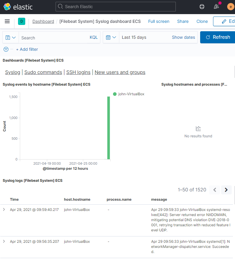

Load the Filebeat Kibana dashboards
Filebeat comes packaged with example Kibana dashboards, visualizations, and searches for visualizing Filebeat data in Kibana. Before you can use the dashboards, you need to create the data view filebeat-*, and load the dashboards into Kibana. This needs to be done from a Beats machine that has access to the Internet.
  1. Open a command line instance and then go to <localpath>/filebeat-<version>/
sudo ./filebeat setup \
The four lines related to ssl are only needed if you are using self-signed certificates.
Depending on variables including the installation location, environment, and local permissions, you might need to change the ownership of the filebeat.yml.
Loaded dashboards
Setting up ML using setup --machine-learning is going to be removed in 8.0.0. Please use the ML app instead.
See more: https://www.elastic.co/guide/en/machine-learning/current/index.html
Loaded machine learning job configurations
Loaded Ingest pipelines
  1. Exit the CLI.
The data views for filebeat-* and metricbeat-* are now available in Elasticsearch. To verify:

View the Metricbeat dashboard
  1. Login to Kibana.
  2. Open the Kibana main menu and select Analytics, then Dashboard.
  3. In the search box, search for metricbeat system. The search results show several dashboards available for you to explore.
  4. In the search results, choose [Metricbeat System] Overview ECS. A Metricbeat dashboard opens:
A screencapture of the Kibana dashboard named Metricbeat System Overview ECS
View the Filebeat dashboard
  1. Open the Kibana main menu and select Analytics, then Dashboard.
  2. In the search box, search for filebeat system.
  3. In the search results, choose [Filebeat System] Syslog dashboard ECS. A Filebeat dashboard displaying your Filebeat data:
A screencapture of the Kibana dashboard named Filebeat System ECS
