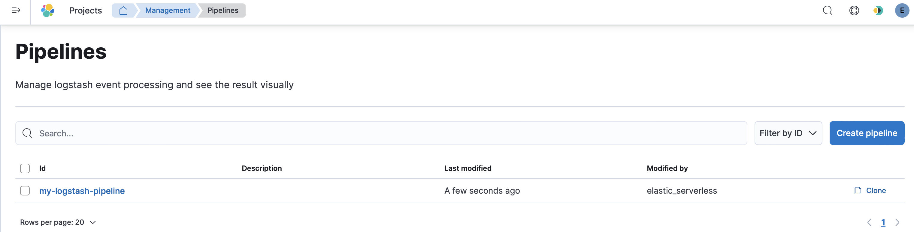

  2. To add a new pipeline, go to the Logstash Pipelines management page using the navigation menu or the global search field.
  3. Click Create pipeline.
  4. Provide the following details, then click Create and deploy.
