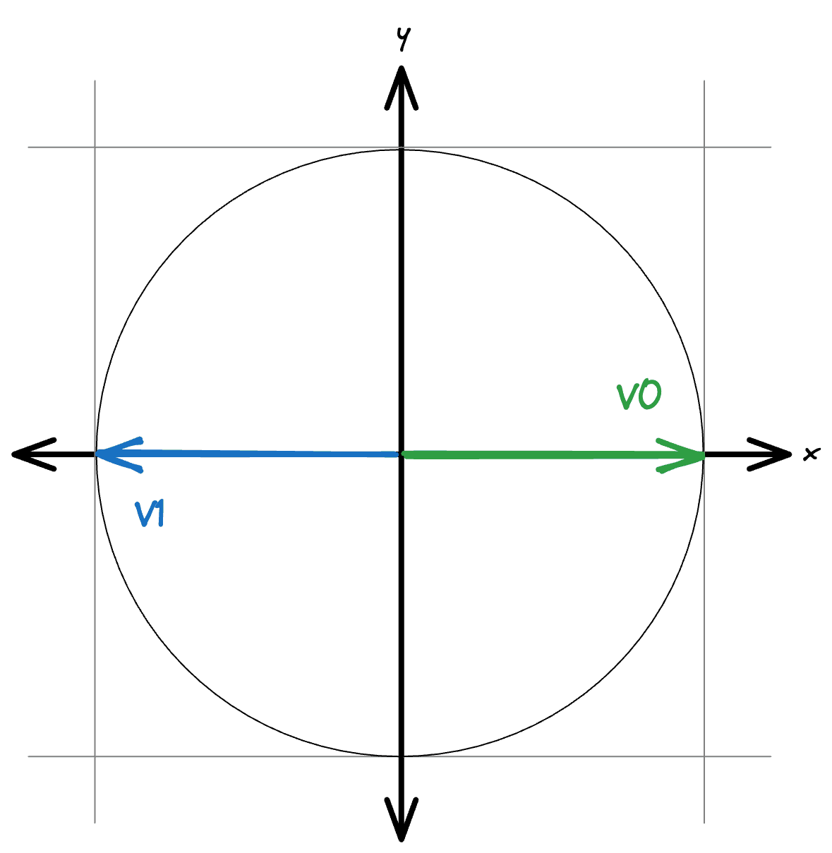

In the normalized case, all vectors are on a unit sphere. This allows handling negative scores to be simple scaling.
Figure 1: Two opposite, two dimensional vectors in a 2d unit sphere (e.g. a unit circle). When calculating the dot-product here, the worst it can be is -1 = [1, 0] * [-1, 0]. Lucene accounts for this by adding 1 to the result.

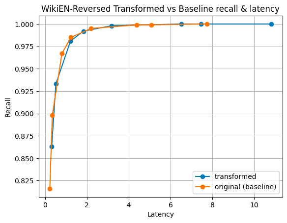

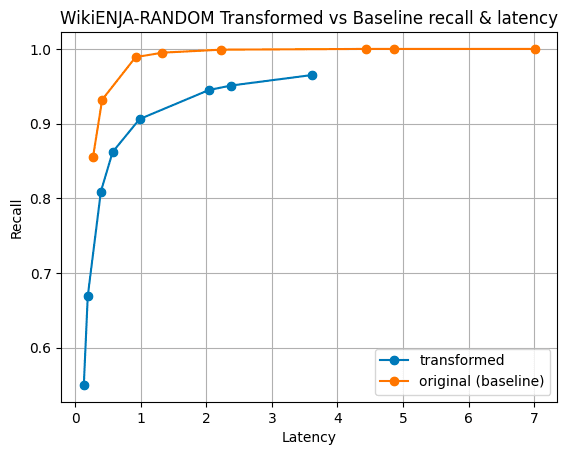

Figure 4: This is a mixture of Cohere’s English and Japanese embeddings over wikipedia. Both datasets are available on HuggingFace.

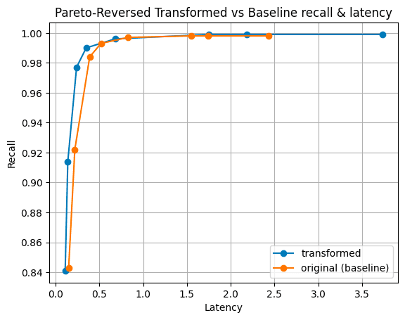

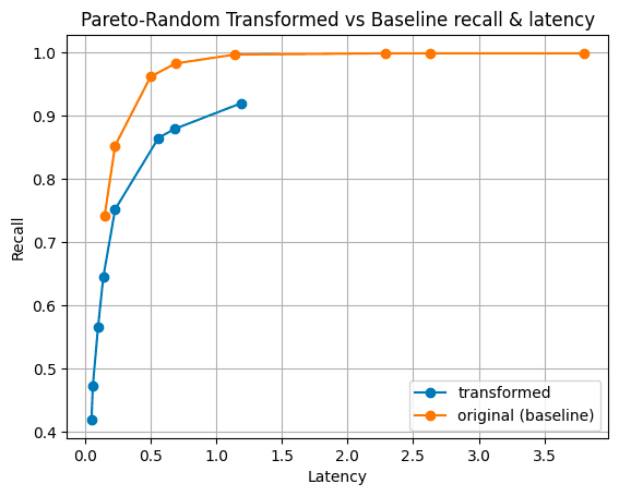

Figure 5: Pareto distribution of magnitudes. A pareto distribution has a “fat tail” meaning there is a portion of the distribution with a much larger magnitude than others.

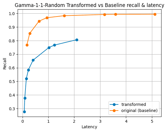

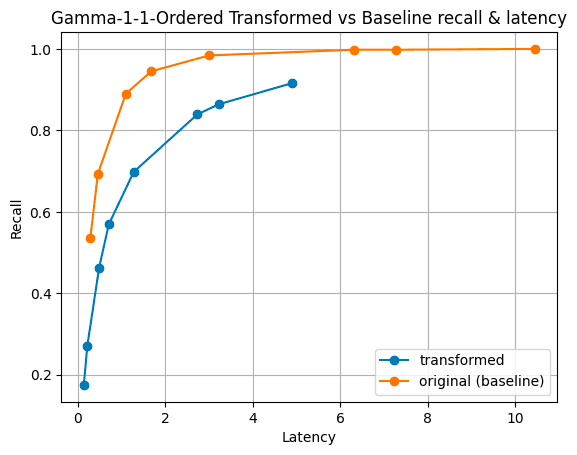

Figure 6: Gamma distribution of magnitudes. This distribution can have high variance and makes it unique in our experiments.
In all our experiments, the only time where the transformation seemed warranted was the synthetic dataset created with the gamma distribution. Even then, the vectors must be inserted in reverse order, largest magnitudes first, to justify the transformation. These are exceptional cases.
