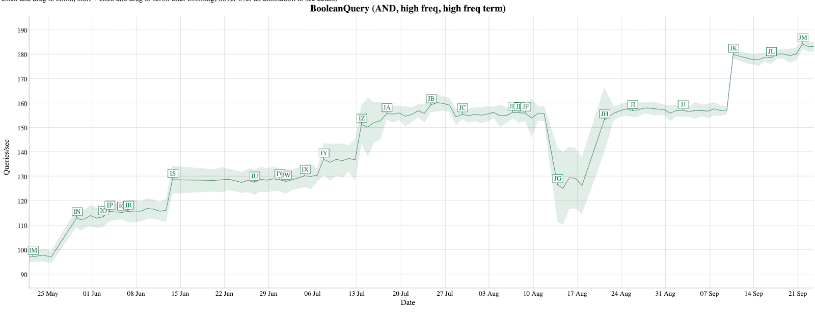

In many ways, 2025 was the year Apache Lucene embraced better auto-vectorization, manual SIMD optimizations, and overall making things go faster. Lucene community member Adrien Grand goes into great detail in this blog, and below are links and summaries for the biggest jumps. As always, a huge shout-out to Mike McCandless for maintaining the Apache Lucene Benchmarks for years.
Discounting the hardware change [IS], this is almost a 60% increase in query speed in 2025, going from <100 queries per second (qps) to >170 qps.
