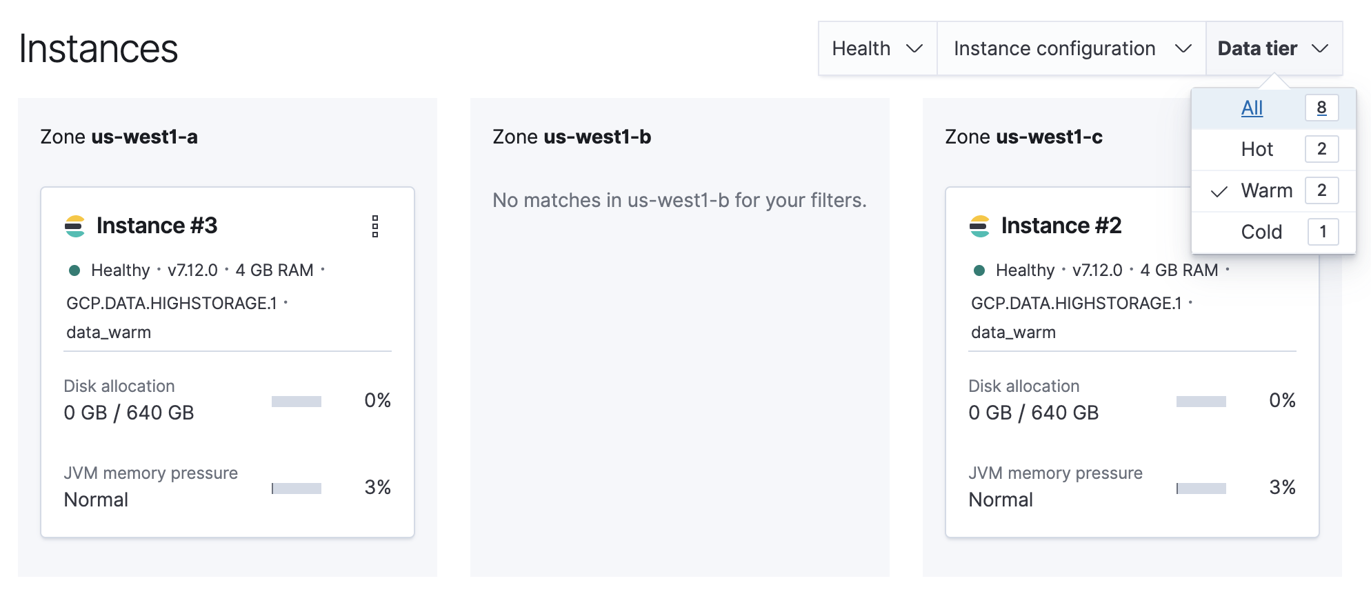

Determine which nodes will be removed from the cluster.
- Log into the Cloud UI.
From the Deployments page, select your deployment.
Narrow the list by name, ID, or choose from several other filters. To further define the list, use a combination of filters.
Filter the list of instances by the Data tier you want to disable.
Note the listed instance IDs. In this example, it would be Instance 2 and Instance 3.

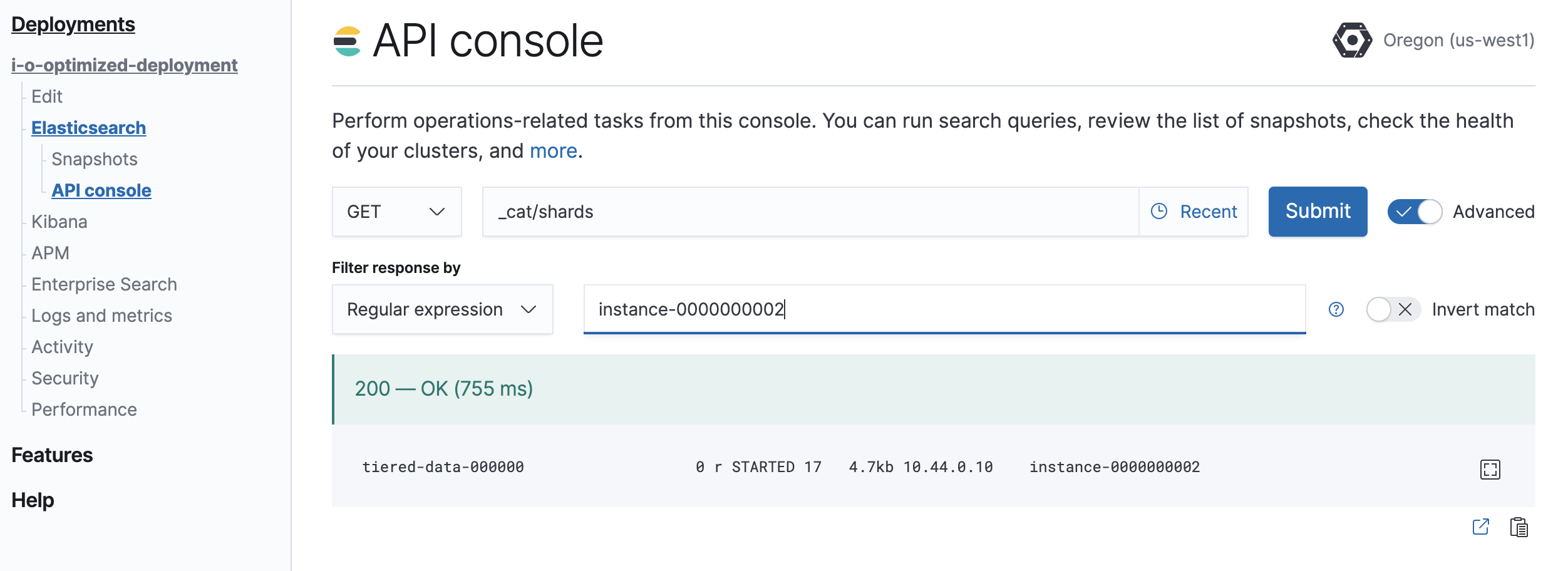

Determine which shards need to be moved.
GET /_cat/shards
Parse the output, looking for shards allocated to the nodes to be removed from the cluster. Note that
Instance #2
is shown asinstance-0000000002
in the output. -

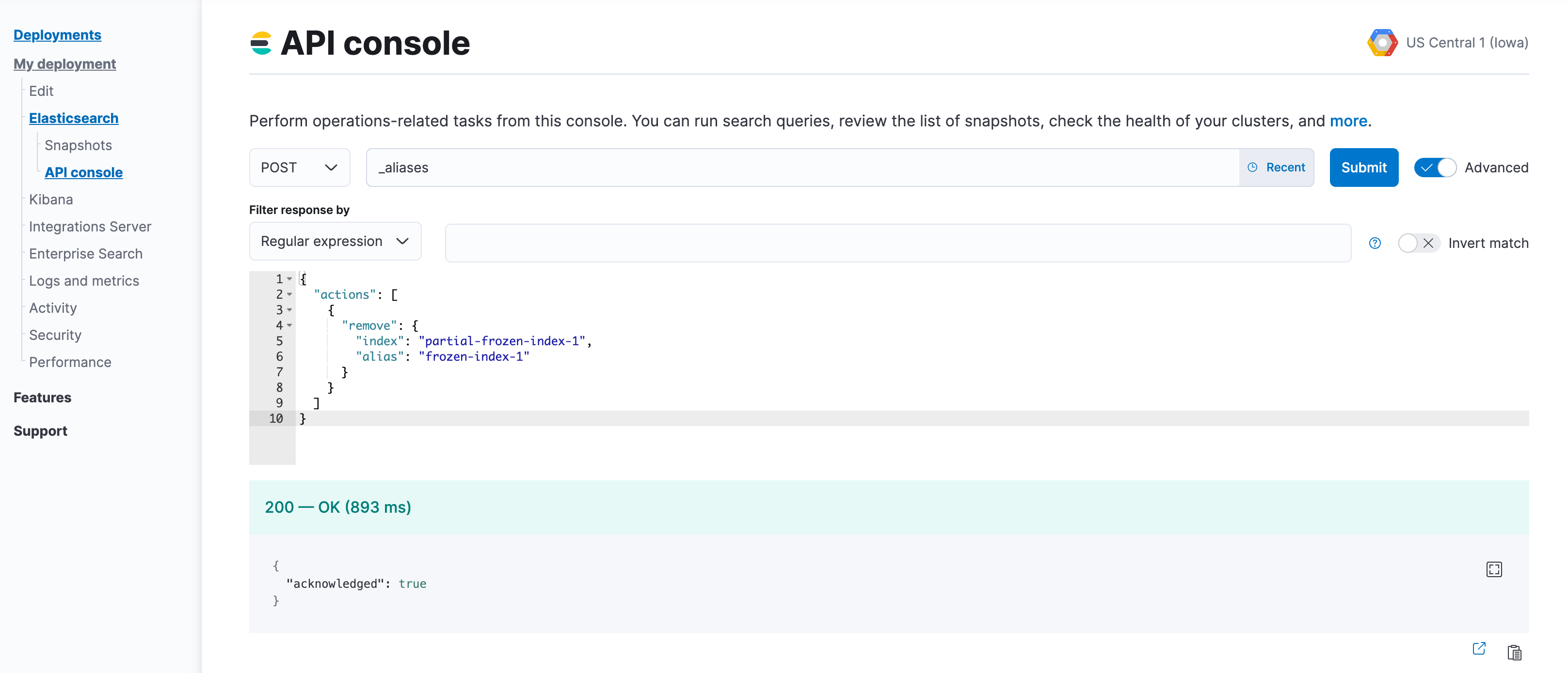

Remove the aliases that were applied to searchable snapshots indices. Use the index prefix from step 2.
POST _aliases { "actions": [ { "remove": { "index": "<searchable-snapshot-index-prefix>-<index_name>", "alias": "<index_name>" } } ] }
If you use data stream, you can skip this step.
In the example we are removing the alias for the
frozen-index-1
index. -

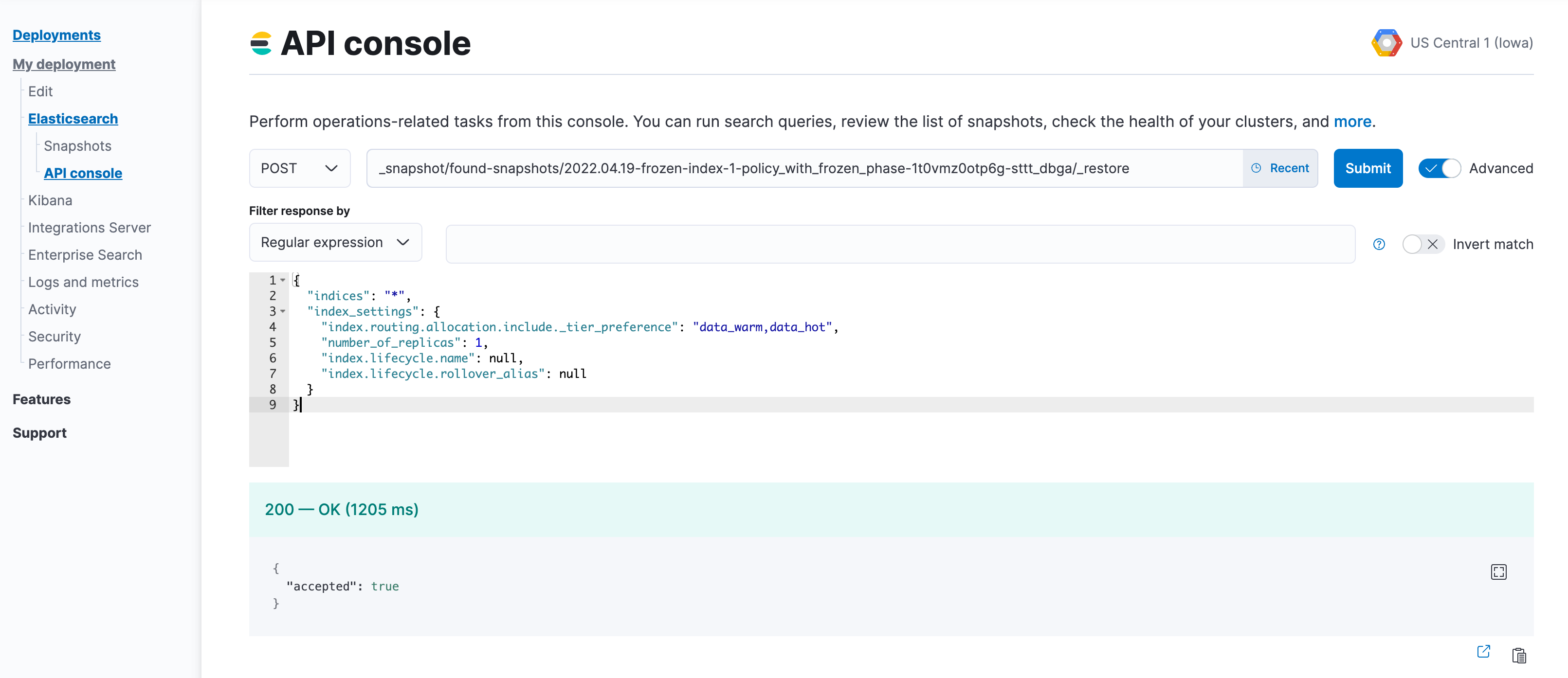

Restore indices from the searchable snapshots.
- Follow the steps to specify the data tier based allocation inclusion rules.
Remove the associated ILM policy (set it to
null
). If you want to apply a different ILM policy, follow the steps to Switch lifecycle policies. -
If needed, specify the alias for rollover, otherwise set it to
null
Optionally, specify the desired number of replica shards.
POST _snapshot/found-snapshots/<searchable_snapshot_name>/_restore { "indices": "*", "index_settings": { "index.routing.allocation.include._tier_preference": "<data_tiers>", "number_of_replicas": X, "index.lifecycle.name": "<new-policy-name>", "index.lifecycle.rollover_alias": "<alias-for-rollover>" } }
The
refers to the above-mentioned step: "Capture a comprehensive list of index and searchable snapshot names".In the example we are restoring
frozen-index-1
from the snapshot infound-snapshots
(default snapshot repository) and placing it in the warm tier.

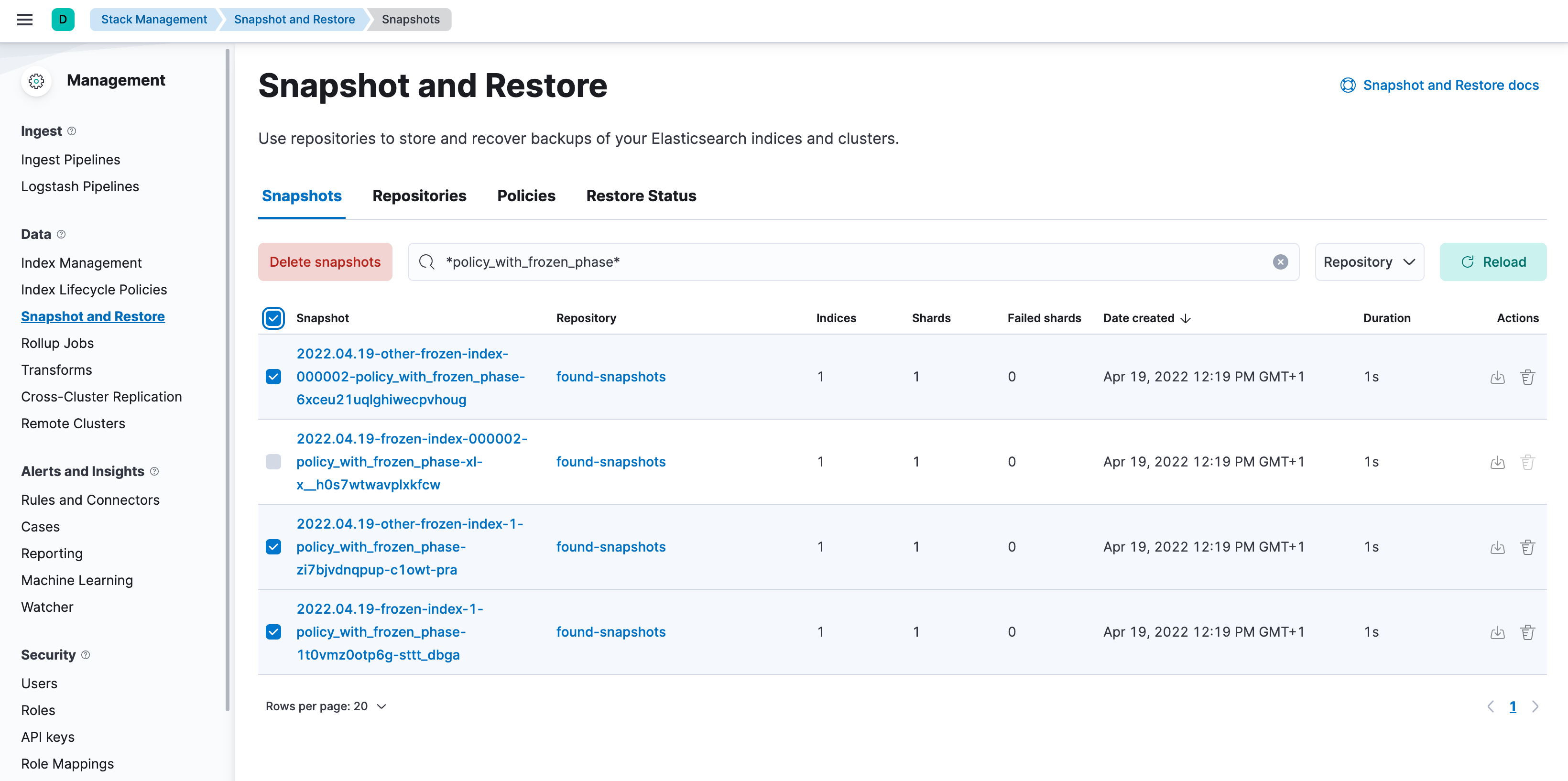

Delete the searchable snapshots by following these steps:
Open Kibana and navigate to Management > Data > Snapshot and Restore > Snapshots (or go to
<kibana-endpoint>/app/management/data/snapshot_restore/snapshots
Search for
*<ilm-policy-name>*
Bulk select the snapshots and delete them
In the example we are deleting the snapshots associated with the
policy_with_frozen_phase
