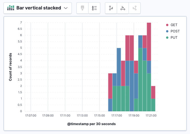

  4. In the CHART TYPE dropdown box, select Bar vertical stacked, if it isn’t already selected.
  5. Check that the time filter is set to Last 15 minutes.
  6. From the Available fields list, drag and drop the @timestamp field onto the visualization builder.
  7. Drag and drop the http.request.method field onto the visualization builder.
  8. A stacked bar chart now shows the relative frequency of each of the three request methods used in our example, measured over time.
    A screen capture of the Kibana "Bar vertical stacked" visualization with several bars. The X axis shows "Count of records" and the Y axis shows "@timestamp per 30 seconds". Each bar is divided into three HTTP request methods: GET
  9. Select Save and return to add this visualization to your dashboard.

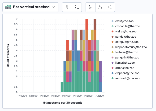

  1. Select Create visualization.
  2. Again, make sure that CHART TYPE is set to Bar vertical stacked.
  3. From the Available fields list, drag and drop the @timestamp field onto the visualization builder.
  4. Drag and drop the http.request.headers.from field onto the visualization builder.
  5. In the chart settings area, under Break down by, select Top values of http.request.headers.from and set Number of values to 12. In this example there are twelve different email addresses used in the HTTP from header, so this parameter sets all of them to appear in the chart legend.
  6. Select Refresh. A stacked bar chart now shows the relative frequency of each of the HTTP from headers over time.
    A screen capture of the visualization builder
  7. Select Save and return to add this visualization to your dashboard.

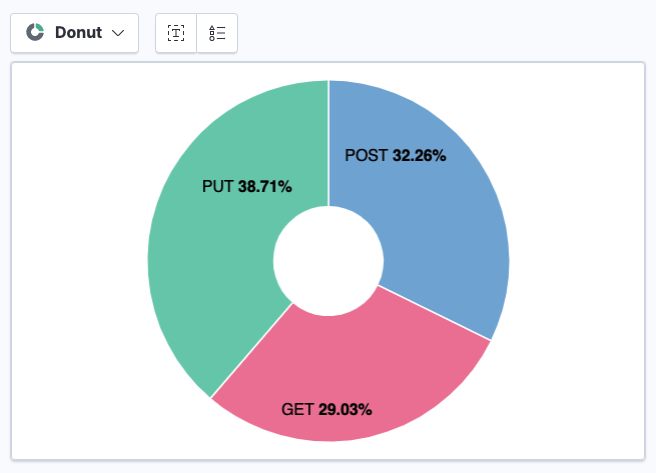

  2. In the CHART TYPE dropdown box, select Donut.
  3. From the list of available fields, drag and drop the http.request.method field onto the visualization builder. A donut chart appears.
    A screen capture of a donut chart divided into three sections
  4. Select Save and return to add this visualization to your dashboard.

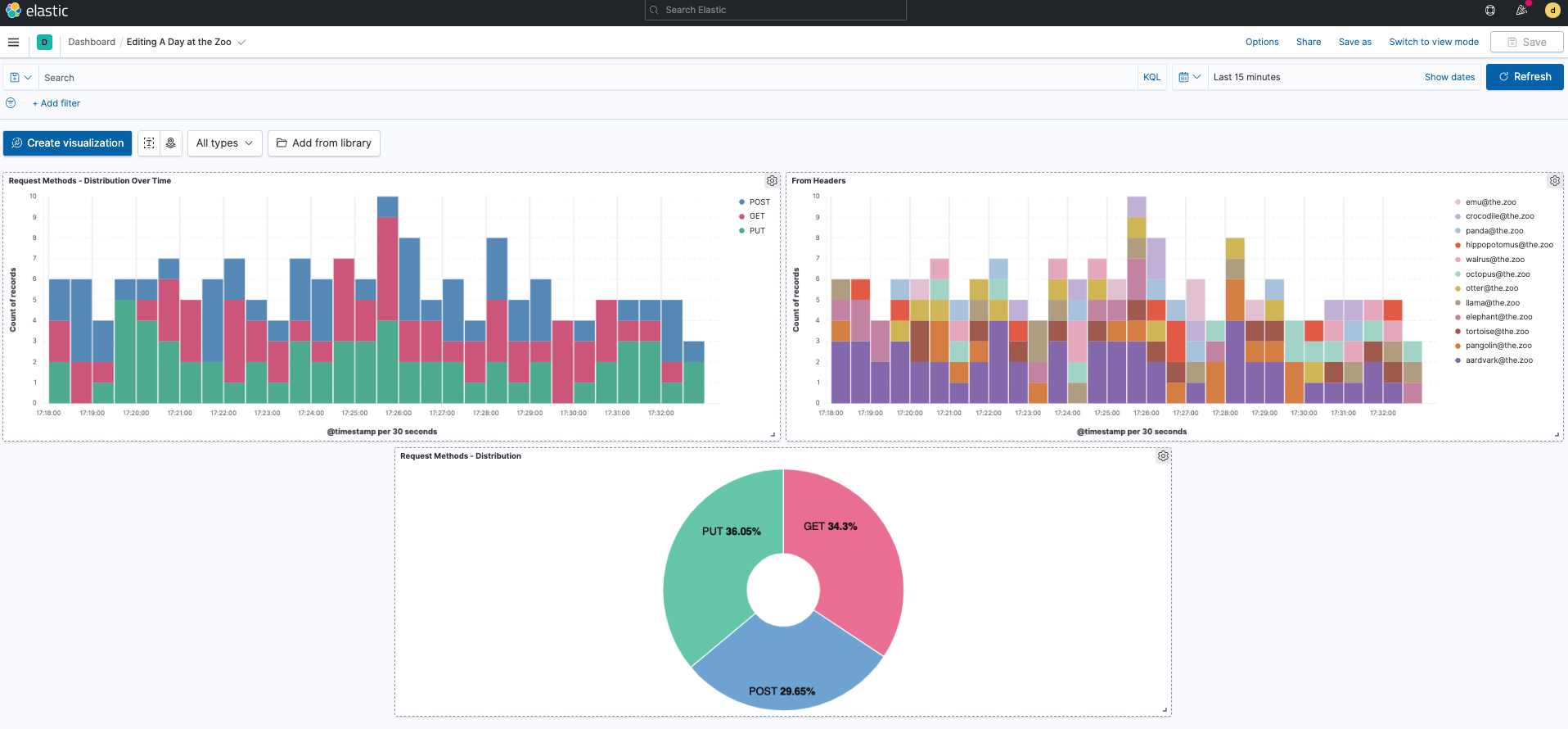

  5. Select Save and add a title to save your new dashboard.
You now have a Kibana dashboard with three visualizations: a stacked bar chart showing the frequency of each HTTP request method over time, another stacked bar chart showing the frequency of various HTTP from headers over time, and a donut chart showing the relative frequency of each HTTP request method type.
You can add titles to the visualizations, resize and position them as you like, and then save your changes.
View log data updates in real time
  1. Select Refresh on the Kibana dashboard. Since the application webrequests.js continues to run and send HTTP requests to the Node.js server, webserver.js continues to generate log data, and your Kibana visualizations update with that data with each page refresh.
    A screen capture of the completed Kibana dashboard
