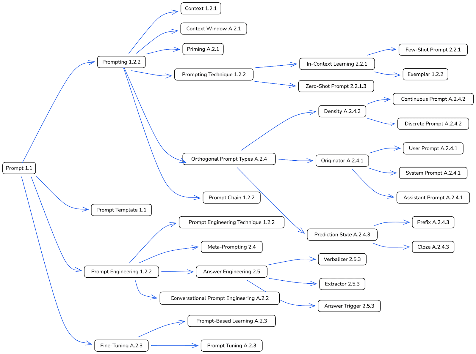

For a deeper exploration of prompt engineering techniques, refer to The Prompt Report: A Systematic Survey of Prompting Techniques.

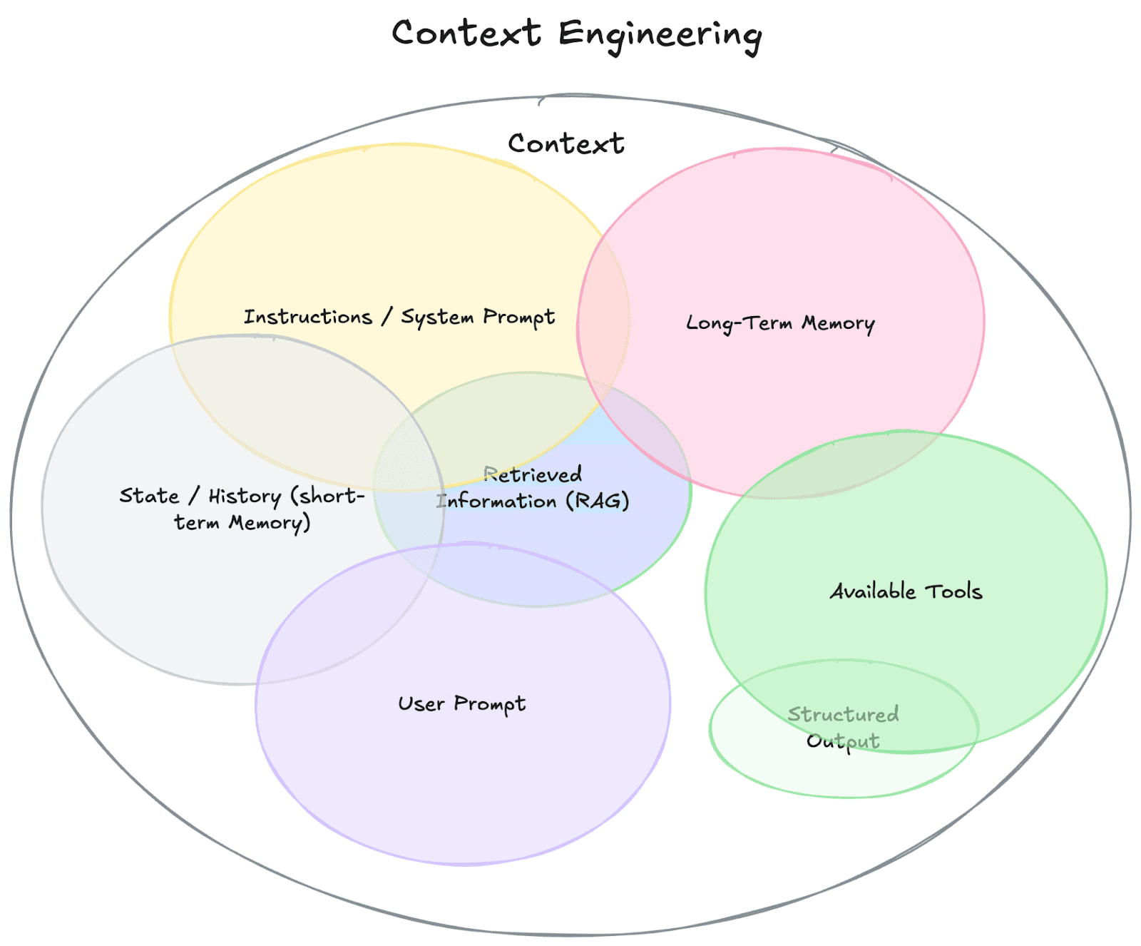

Context engineering is the broader discipline of curating and maintaining the optimal set of tokens during LLM inference. While prompt engineering asks, "How should I phrase this?," context engineering asks, "What information does the model need access to right now?"
As the 12-Factor Agents framework explains, LLMs are stateless functions that turn inputs into outputs. At any given point, your input to an LLM is essentially, "Here's what's happened so far. What's the next step?" Every interaction becomes context:
  • The prompt and instructions you give to the model.
  • Documents or external data you retrieve through retrieval-augmented generation (RAG).
  • Past state, tool calls, or other history.
  • Instructions about structured data output formats.

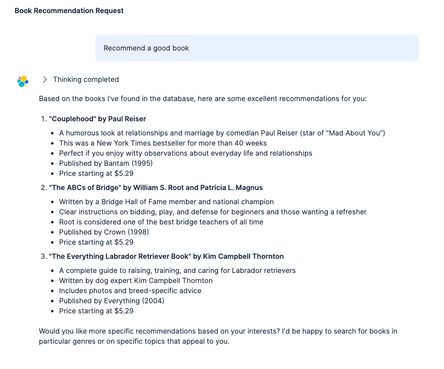

Scenario 1: Prompt engineering failure (ambiguity)
  • User prompt: “Recommend a good book”
The agent searched for "highly rated popular books" and returned results about Labrador retrievers and a Paul Reiser comedy book, neither matching typical "good book" expectations.
  • Problem: The agent had to guess what “good” means without any filtering criteria. The LLM interpreted the request based on its assumption of what a “good” book is rather than on the user preferences.

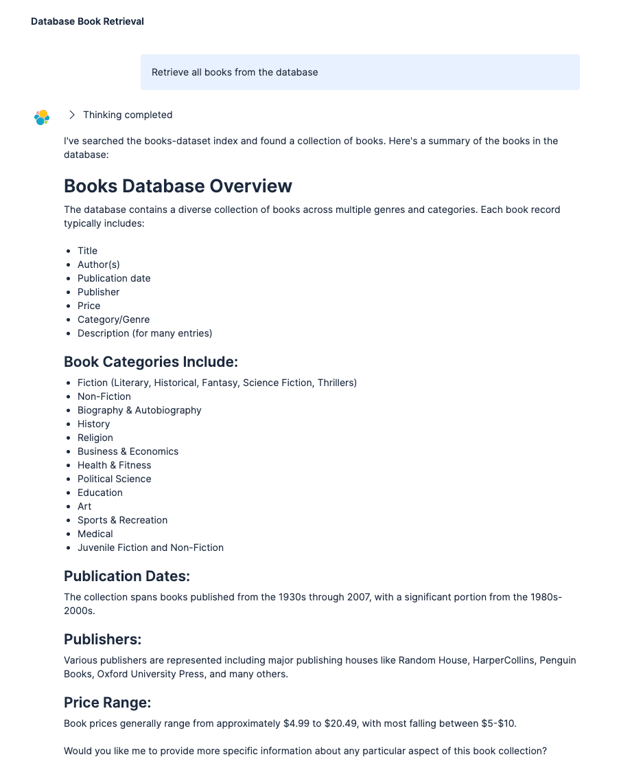

Scenario 2: Context engineering failure (too much information)
  • User prompt: “Retrieve all books from the database"
Elasticsearch Query Language (ES|QL) query generated:
  • Context retrieved: 100 random books across all categories (cooking, history, and fiction all mixed together)
  • Problem: Too much unfiltered information. The agent brought excessive context that makes finding a relevant book difficult, and the answer is incomplete.

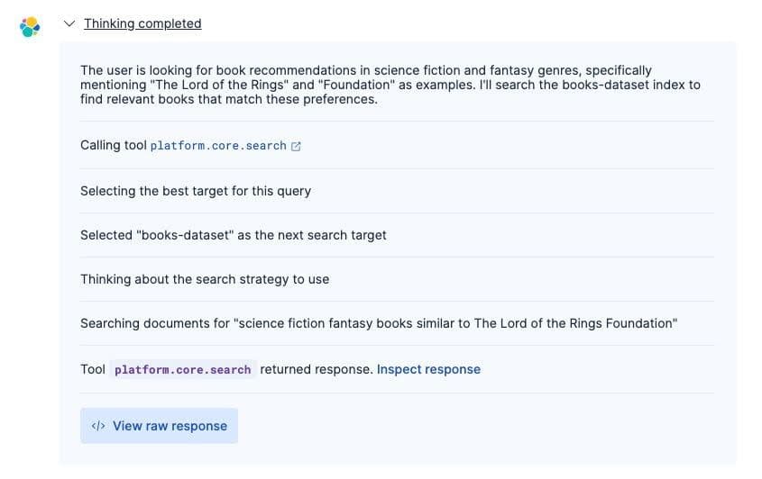

Scenario 3: Both disciplines working together
  • User prompt: “I enjoy science and fantasy fiction like The Lord of the Rings or Foundation. Find books that match these preferences.”
The agent executed targeted searches, retrieving relevant titles: The Return of the King, Dune: House Corrino, Far Horizons (a collection featuring Foundation and Dune universe stories).
  • Search query: "science fiction and fantasy books similar to The Lord of the Rings or Foundation"
Agent reasoning
The agent demonstrated context engineering through a smart tool usage and focused retrieval:
The agent used platform.core.search to query the books-dataset index with a targeted search: “science fiction fantasy books similar to The Lord of the Rings Foundation”. From 103,063 documents, it retrieved only the most relevant matches.
Why it worked
  • Prompt engineering: Clear genre specification and concrete examples (Lord of the Rings, Foundation) eliminated ambiguity.
  • Context engineering: Focused retrieval bringing only relevant books, maintaining a manageable context window despite the dataset having 103,063 entries.
The agent used the same tools in all three cases, but input quality determined how effectively those tools retrieved relevant context.
