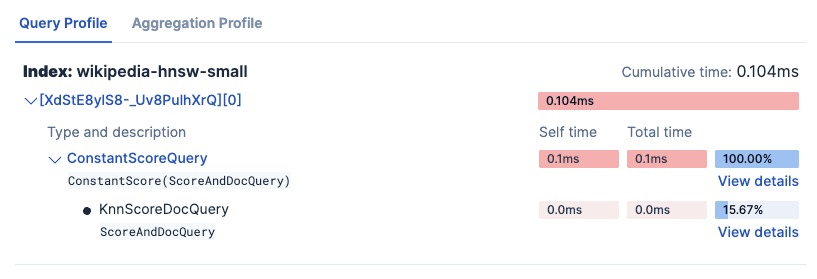

Kibana profiler
In the DevTools app in Kibana we can find a search profiler feature that makes reading the metrics a lot easier. The search profiler in Kibana uses the same profile API seen above but providing a friendlier visual representation of the profiler output.
You can see how the total query time is being spent:
And you can see details on each part of the query.
The profiler feature can help in comparing different queries and index configurations quickly.

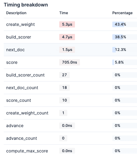

Collection time
The time spent collecting and ranking results:
The time_in_nanos for collectors breaks down into:
TopScoreDocCollector
  • Collects top hits from the query results.

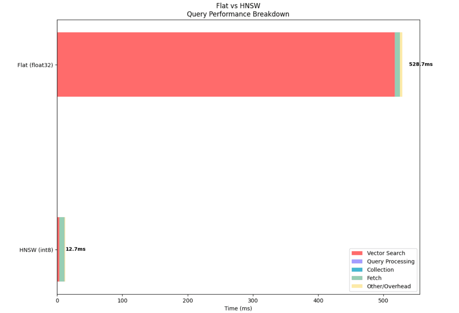

Experiment 1: Flat vs int 8 HNSW dense vector
Objective: Compare the performance of a flat dense vector against a vector using HNSW.
Indices to use:
  • wikipedia-brute-force-1shard
  • wikipedia-int8-hnsw
Hypothesis: The HNSW index will have significantly lower query latency, especially on larger datasets, as it reduces memory usage by 75% and it avoids comparing the query vector with each vector in the dataset.

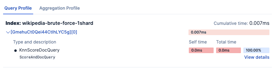

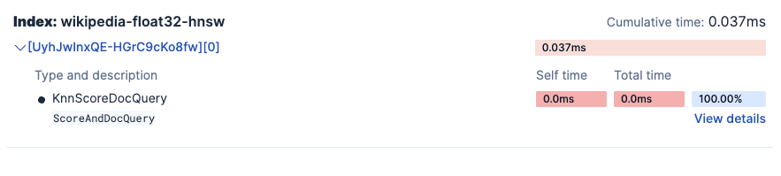

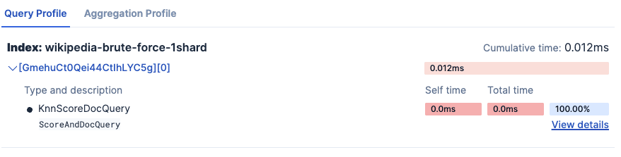

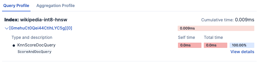

Kibana Search Profiler results:
Experiment results:
We can see from the metrics that the float approach did 50000 vector operations, which means it compared the query vector with each vector in the dataset, which resulted in ~140 times increase in the vector search time when compared with the HNSW vector.
From the graph below, we can visualize that even if other metrics are similar, the Vector search takes much longer with a float-type dense vector. That being said, it is worth noting that BBQ quantization reduces the recall when compared with a non-quantized vector.

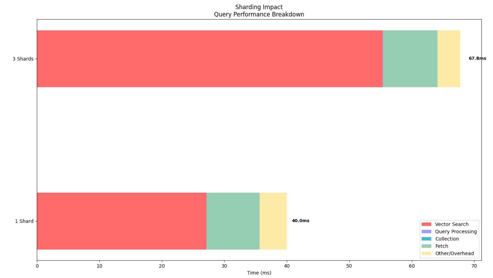

Objective: Understand how excessive sharding on a single-node Elasticsearch deployment negatively impacts vector search query performance
Indices to use:
  • wikipedia-brute-force-1shard: The single-shard baseline.
  • wikipedia-brute-force-3shards: The multi-shard version.
Hypothesis: On a single-node deployment, increasing the number of shards will degrade query performance rather than improve it. The 3-shard index will exhibit higher total query latency compared to the 1-shard index. This can be extrapolated to having an inadequate number of shards for our infrastructure.

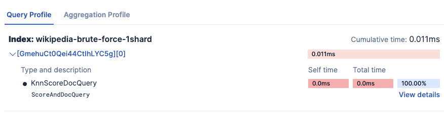

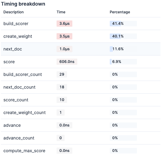

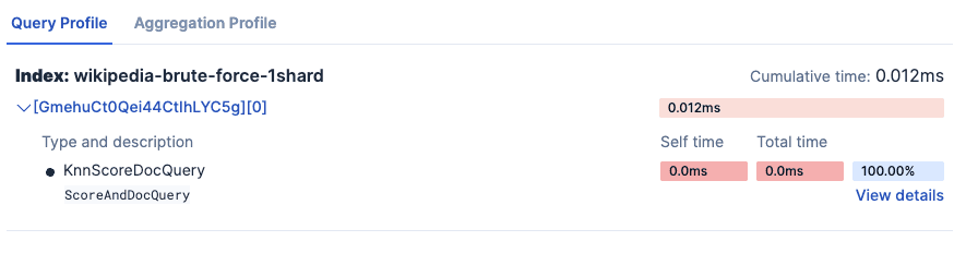

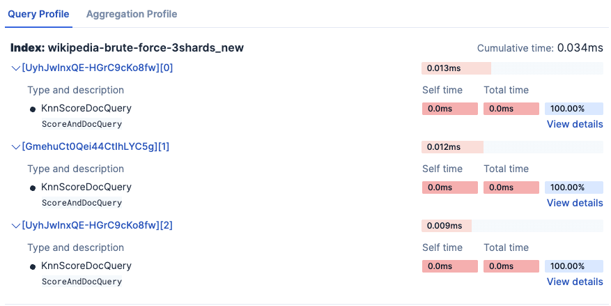

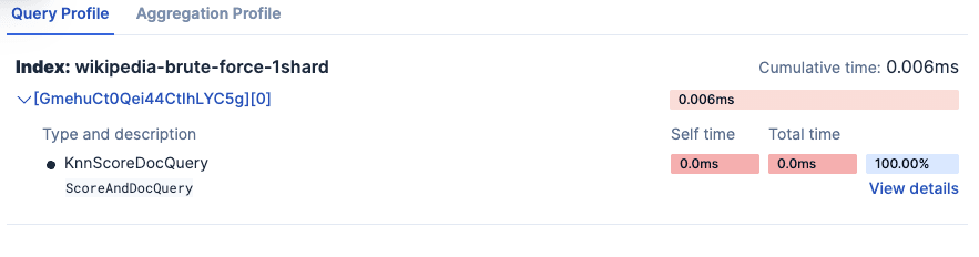

Notice time is more than 3 times here because it runs in 3 separate shards.
Experiment results:
We can see that even when executing the exact same number of vector operations, having too many shards for this specific dataset added more vector search time, overall making the query slower. This demonstrates how our sharding strategy must go hand in hand with our cluster architecture.

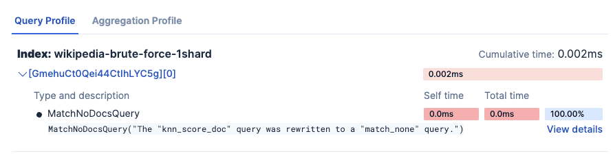

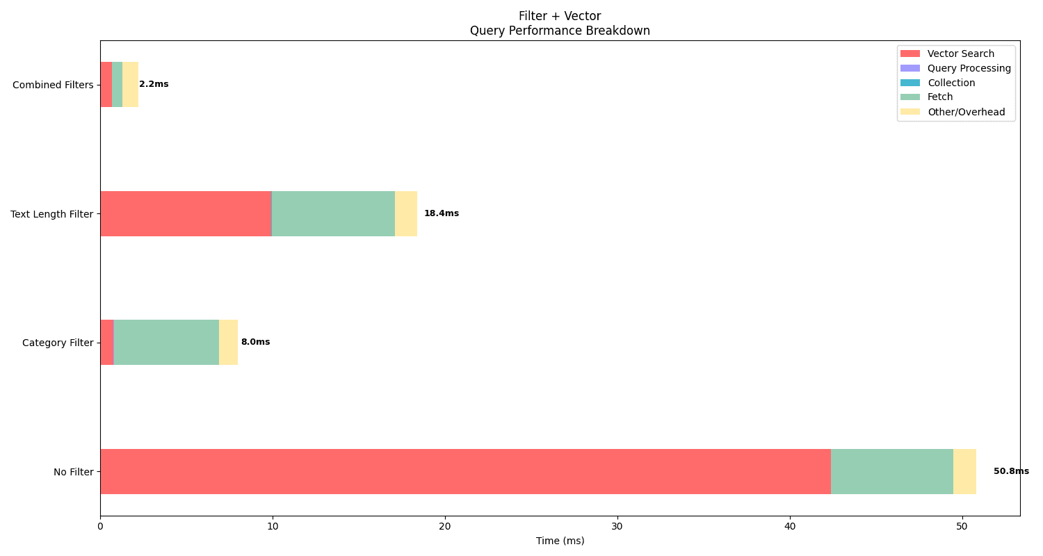

Objective: Demonstrate how Elasticsearch efficiently handles pre-filtering before a vector search.
Indices to use:
Note: This experiment is only applicable to hosted deployments, since we can't control the number of shards on serverless. It will be automatically skipped in a serverless project.
Setup: Construct a query that combines a KNN query for a vector search with a filter.
Hypothesis: When a filter is applied, Elasticsearch first prunes the documents that don't match the filter before performing the expensive vector search on the matching documents. The Profile API will show that the number of documents searched by the vector search operation is significantly lower than the total number of documents in the index, leading to a faster query.We will run the query with 4 configurations:
  • A combined filter: term filter on the category field + range filter on the text_length field
Results:
We can see that applying filters adds fetch time to our search, but in exchange, it reduces the vector search time dramatically because it executes less vector operations. This shows how Elastic handles filtering before vector search to improve performance and avoid wasting resources by running the vector search before filtering out irrelevant documents.
Even if the results are constrained to a maximum (k=10), underneath, more vector operations are being executed if we don't filter out some documents before. This effect is more notorious with a flat dense vector, of course, but even in quantized vectors, we can still reduce execution time by applying filters before the vector search.
In the graph, we can see how the query time increased with the filters, but the vector search time is much lower, resulting in lower times overall. We can also see that having more filters impacted the time positively (meaning it lowered the total time), so actually applying the filters is worth it, as the overall time decreases.
The results highlight how filtering improves efficiency and is a key benefit of using a hybrid search engine like Elasticsearch.

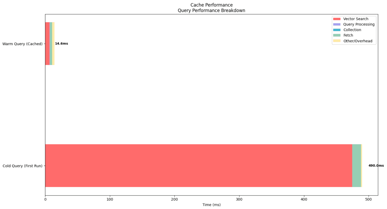

Experiment 4: Compare cold vs cached query performance
Objective: Demonstrate how Elasticsearch's caching mechanisms significantly improve query performance when the same vector search is executed multiple times.
Indices to use:
  • wikipedia-float32-hnsw
Setup:
First, clear the Elasticsearch cache
Execute the same vector search query twice:
  • Cold query: First execution after cache clearing
  • Cached Query: Second execution with caches populated
Hypothesis:The cached (warm) query will execute significantly faster than the cold query. The Profile API will show reduced times across all query phases, with the most dramatic improvements in vector search operations and data retrieval phases.
Results:
This experiment shows the impact of Elasticsearch's cache on vector search performance. Elastic keeps the embedding data in memory, so it executes faster. On the other hand, if the data isn’t in memory and Elastic has to read from disk often, searches become slower.
In this case, the cold query, executed after clearing all caches, took 490ms total time with vector search operations consuming 474.77ms. This shows the "first-time" cost of loading index segments and vector data structures into memory. In contrast, the warm queries averaged just 14.6ms total time with vector search dropping to 6.99ms, demonstrating a remarkable 33x overall speedup and 68x improvement in vector search operations.
In the graph, we can see the huge difference between the cached and cold queries. This result highlights why vector search systems benefit from an initial warm-up period.

  2. Having an appropriate sharding strategy can lead to better performance
  3. Combining vector search + filters is a powerful tool to improve performance in our queries
