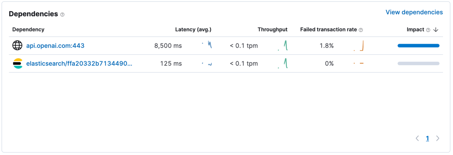

Analyzing the APM data — Elasticsearch vs. OpenAI performance
After instrumenting the application, a quick look at the “Dependencies” gives us a better understanding of what’s going on. It looks like our requests to Elasticsearch return within 125ms on average, while OpenAI takes 8,500ms to complete a request. (This screenshot was taken on a version of the application that does not use streaming. If you use streaming, the default instrumentation only considers the initial POST request in the dependency response time and not the time it takes to stream the full response.)

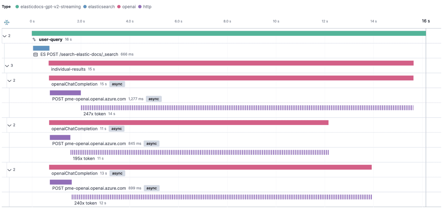

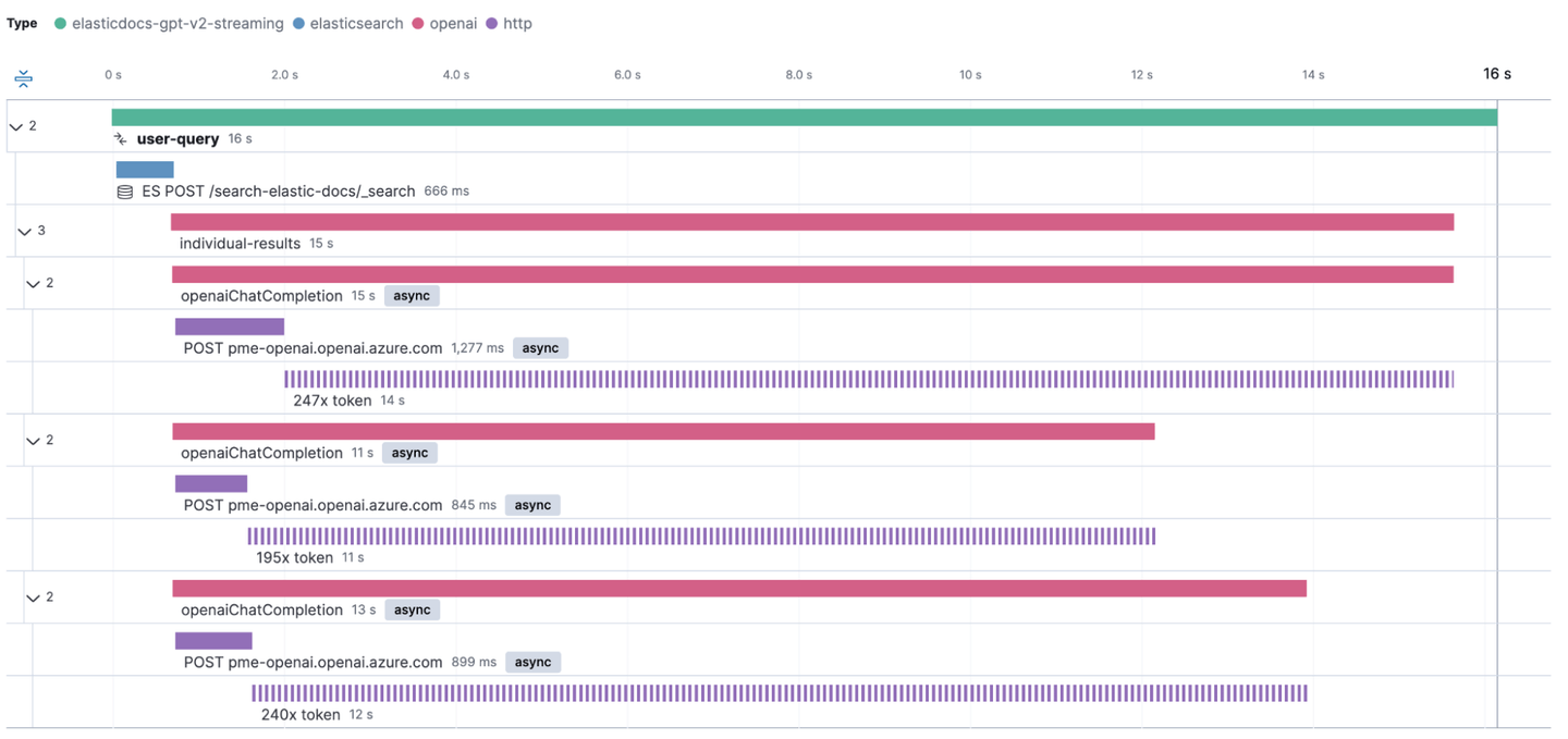

As mentioned previously, we added a bit more custom instrumentation than just the bare minimum. This allows us to get detailed information on where our time is spent. Let’s take a look at a full trace and see this streaming in action.
Our application is configured to fetch the top three hits from Elasticsearch, and then run one ChatCompletion request against OpenAI in parallel.
As we can see in the screenshot, loading the individual results takes about 15s. We can also see that requests to OpenAI that return a larger response take longer to return. But this is only a single request. Does this behavior happen for all requests? Is there a clear correlation between response time and number of tokens to back up our claims from earlier?

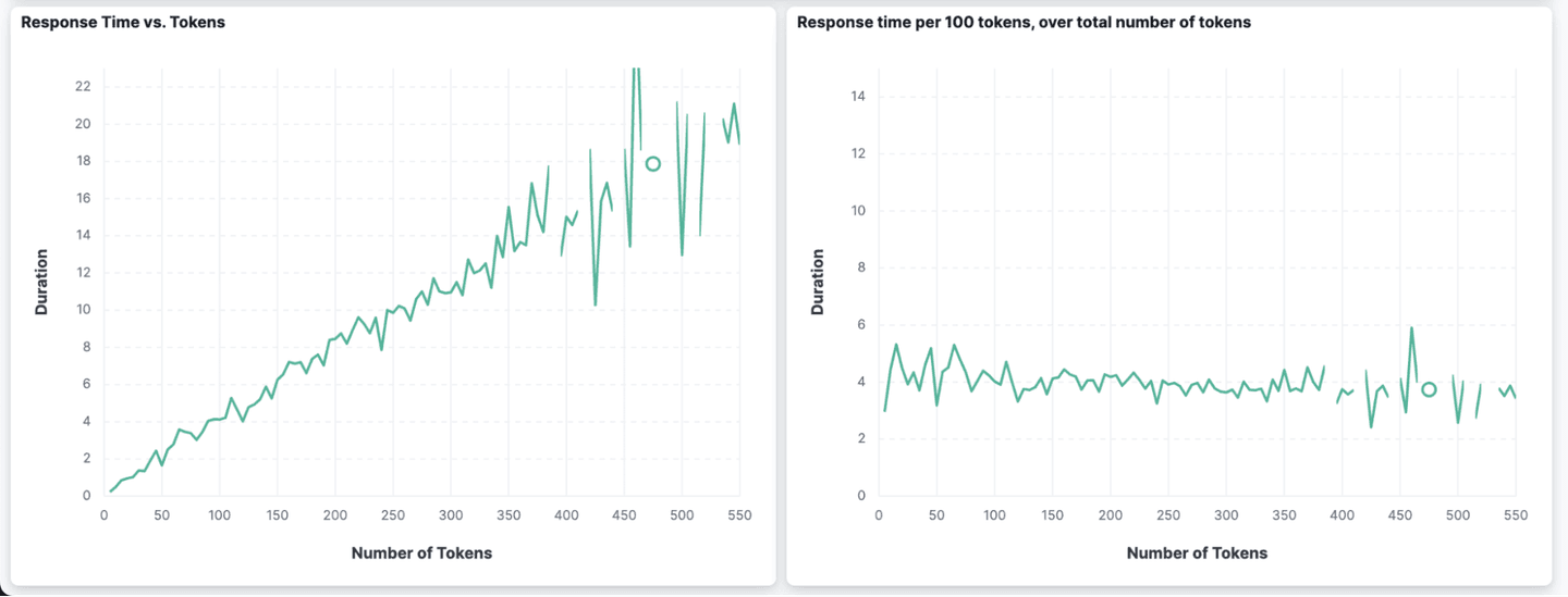

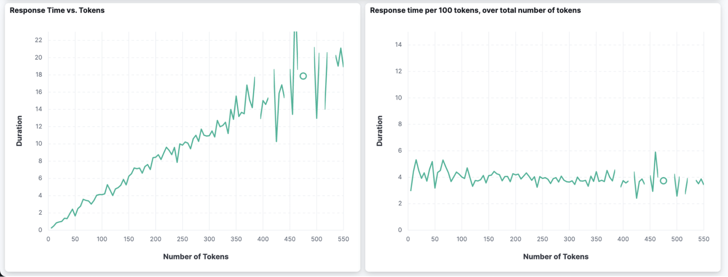

Instead of visualizing the data using Elastic APM, we can also use custom dashboards and create visualizations from our APM data. Two interesting charts that we can build show the relationship between the number of tokens in a response and the duration of the request.
We can see that the more tokens get returned (x-axis in the first chart), the higher the duration (y-axis in the first chart). In the chart to the right, we can also see that the duration per 100 tokens returned stays almost flat at around 4s, no matter the number of tokens returned in total (x-axis).
If you want to improve the responsiveness of your application that uses OpenAI models, it might be a good idea to tell the model to keep the response short.

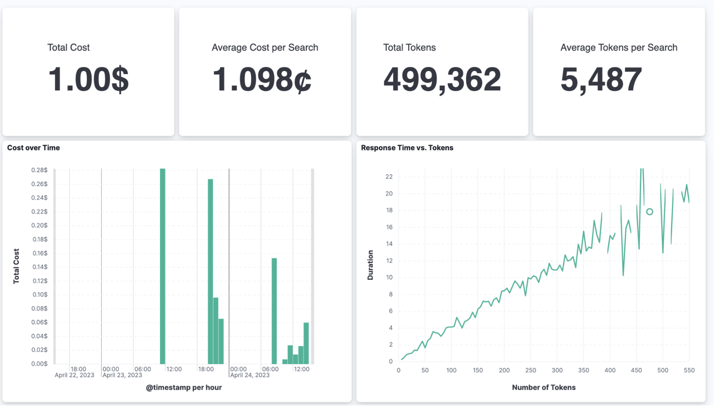

In addition to this, we can also track our total spend and the average cost per page load, as well as other statistics.
With our sample application, the cost for a single search is around 1.1¢. This number does not sound high, but it’s likely not something that you will have on your public website as a search alternative anytime soon. For company internal data and a search interface that’s only used occasionally, this cost is negligible.

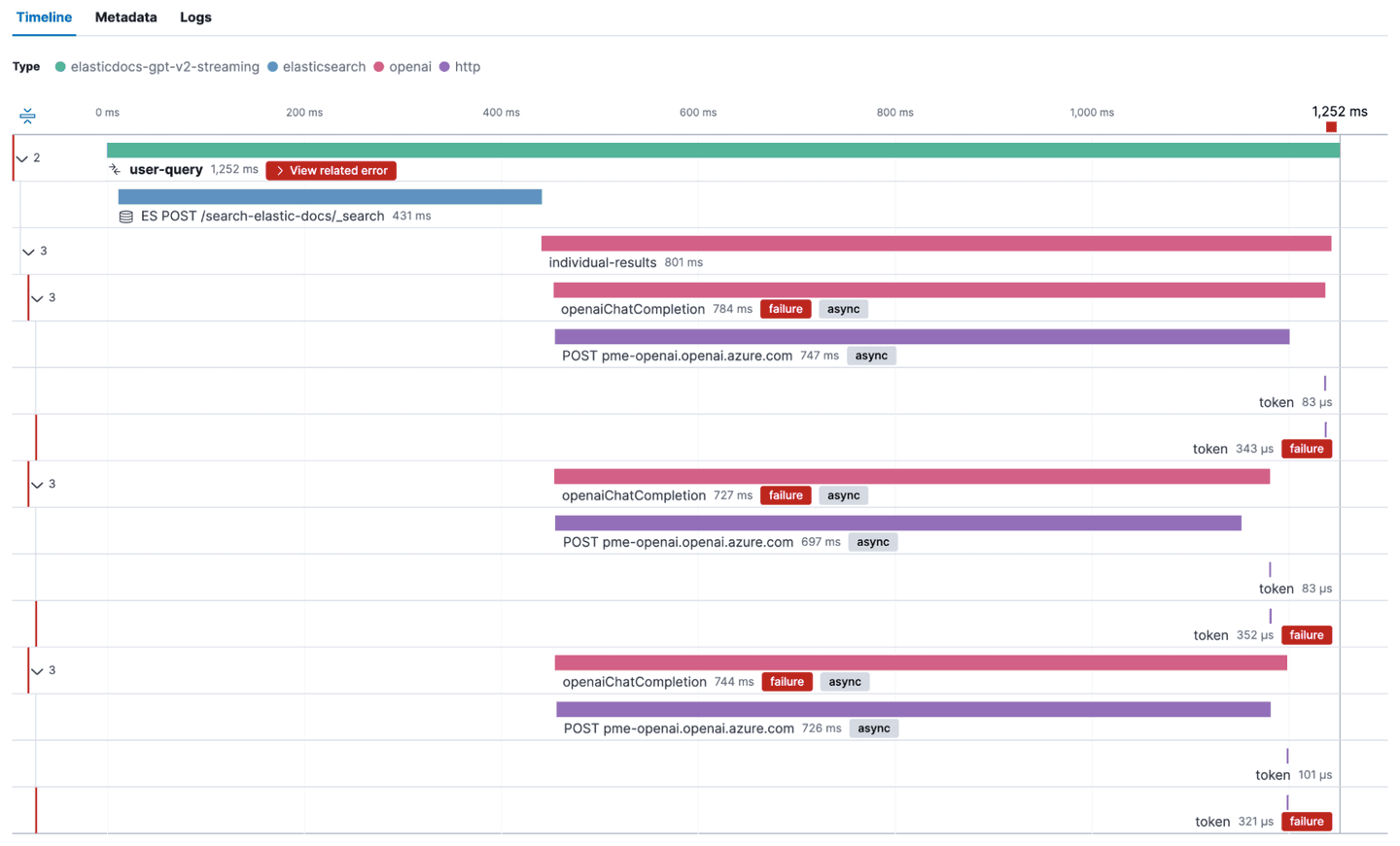

In our testing, we’ve also hit frequent errors when using the OpenAI API in Azure, which eventually made us add a retry loop to the sample app with an exponential backoff. We can also capture these errors using Elastic APM.

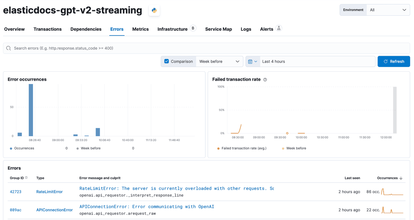

Any captured errors are then visible in the waterfall charts as part of the span where the failure happened.
In addition, Elastic APM also provides an overview of all the errors. In the screenshot below, you can see the occasional RateLimitError and APIConnectionError that we’ve encountered. Using our crude exponential retry mechanism, we can mitigate most of these problems.

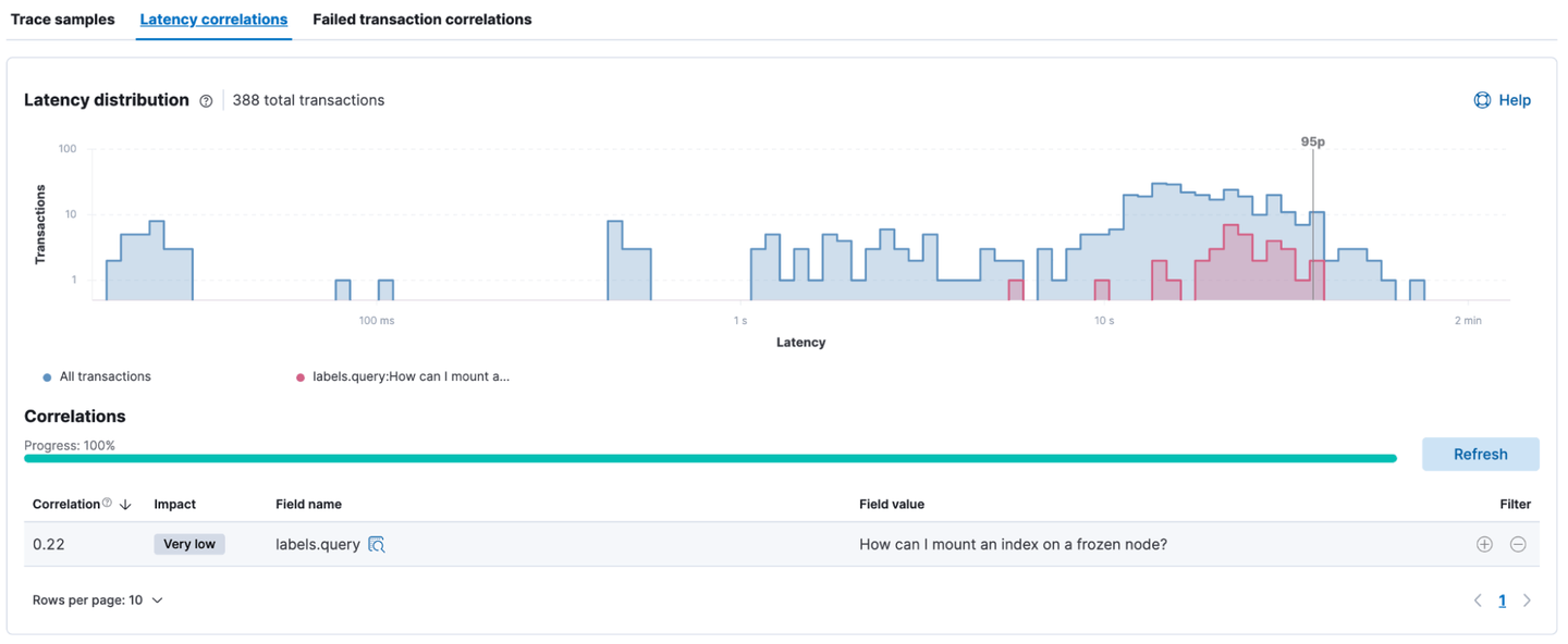

With all the built-in metadata that the Elastic APM agent capture, as well as the custom labels we added, we can easily analyze if there’s any correlation between the performance and any of the metadata (like services version, user query, etc.)
As we can see below, there’s a small correlation between the query “How can I mount and index on a frozen node?” and a slower response time.

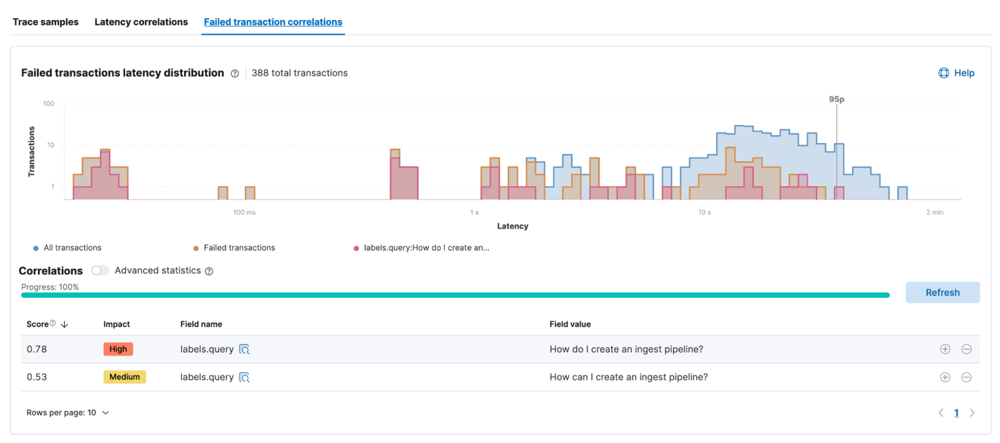

Similar analysis can be done on any transaction that resulted in an error. In this example, the two queries “How do I create an ingest pipeline” and “How can I create an ingest pipeline” fail more often than other queries, causing them to bubble up in this correlation analysis.
