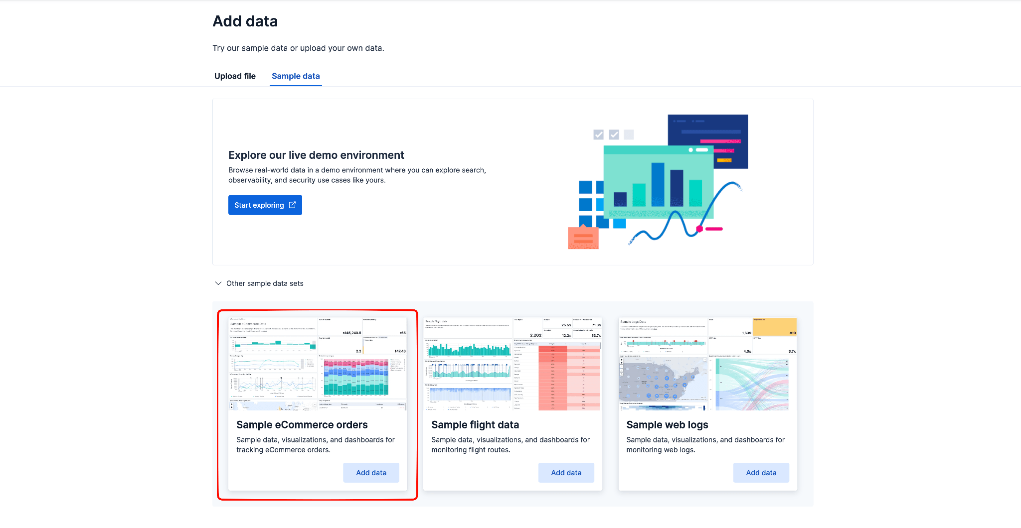

  • Kibana's built-in sample eCommerce orders dataset (Add data > Sample data > Sample eCommerce orders)

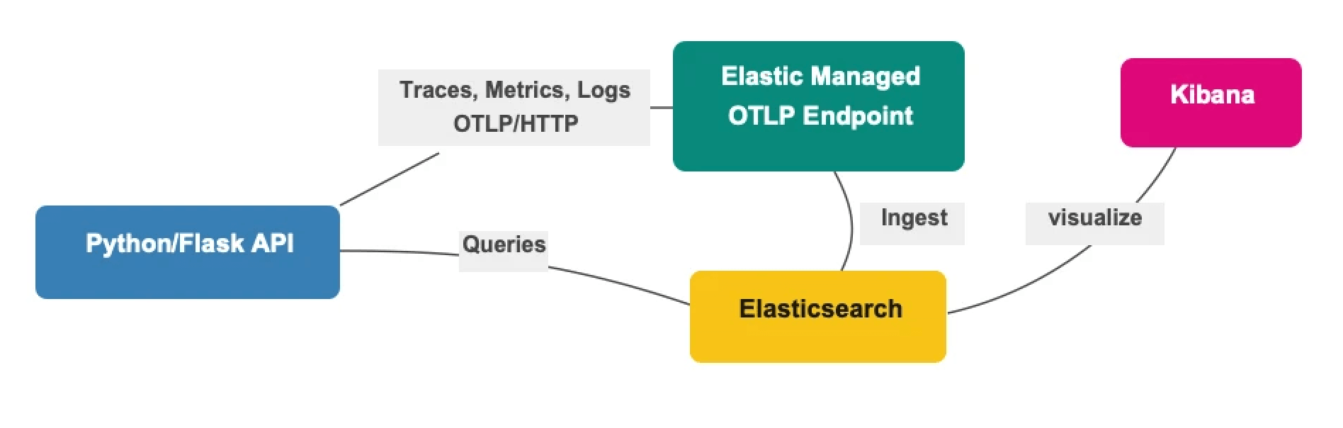

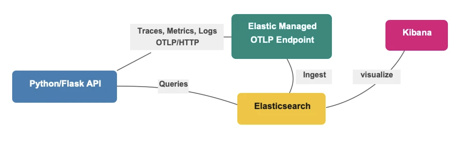

What is the Elastic managed OTLP endpoint?
The Elastic Managed OTLP Endpoint is a hosted ingestion layer that accepts standard OTLP over HTTP or gRPC directly from your application, with no collector required.
OpenTelemetry uses OTLP (OpenTelemetry Protocol) to transport telemetry data.
In a traditional setup, your application sends data to an OpenTelemetry Collector, which then forwards it to a backend like Elasticsearch.
The Collector handles batching, retries, and routing, but it also means one more component to deploy, configure, and maintain.
Elastic's managed OTLP endpoint, recently GA, removes that step.
Your application sends OTLP data directly to an endpoint that Elastic operates for you.
The endpoint accepts standard OTLP over HTTP or gRPC, backed by a managed ingestion layer that handles scaling, buffering, and durability.
You use the same opentelemetry-exporter-otlp packages you would use with any backend.

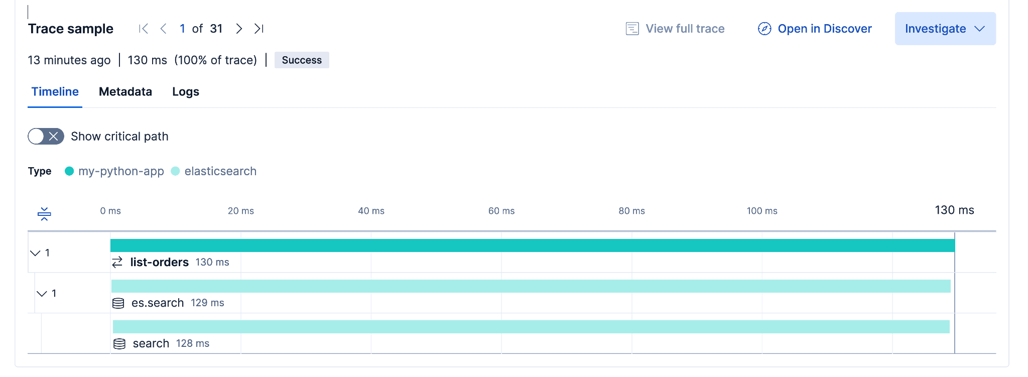

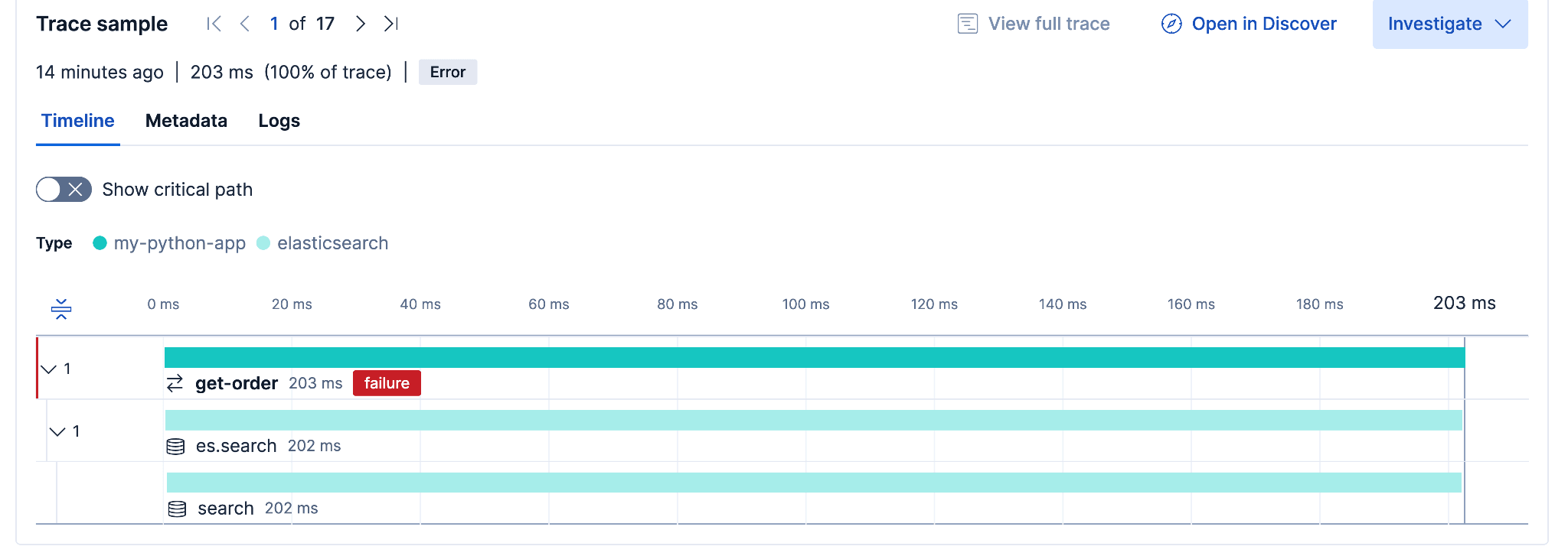

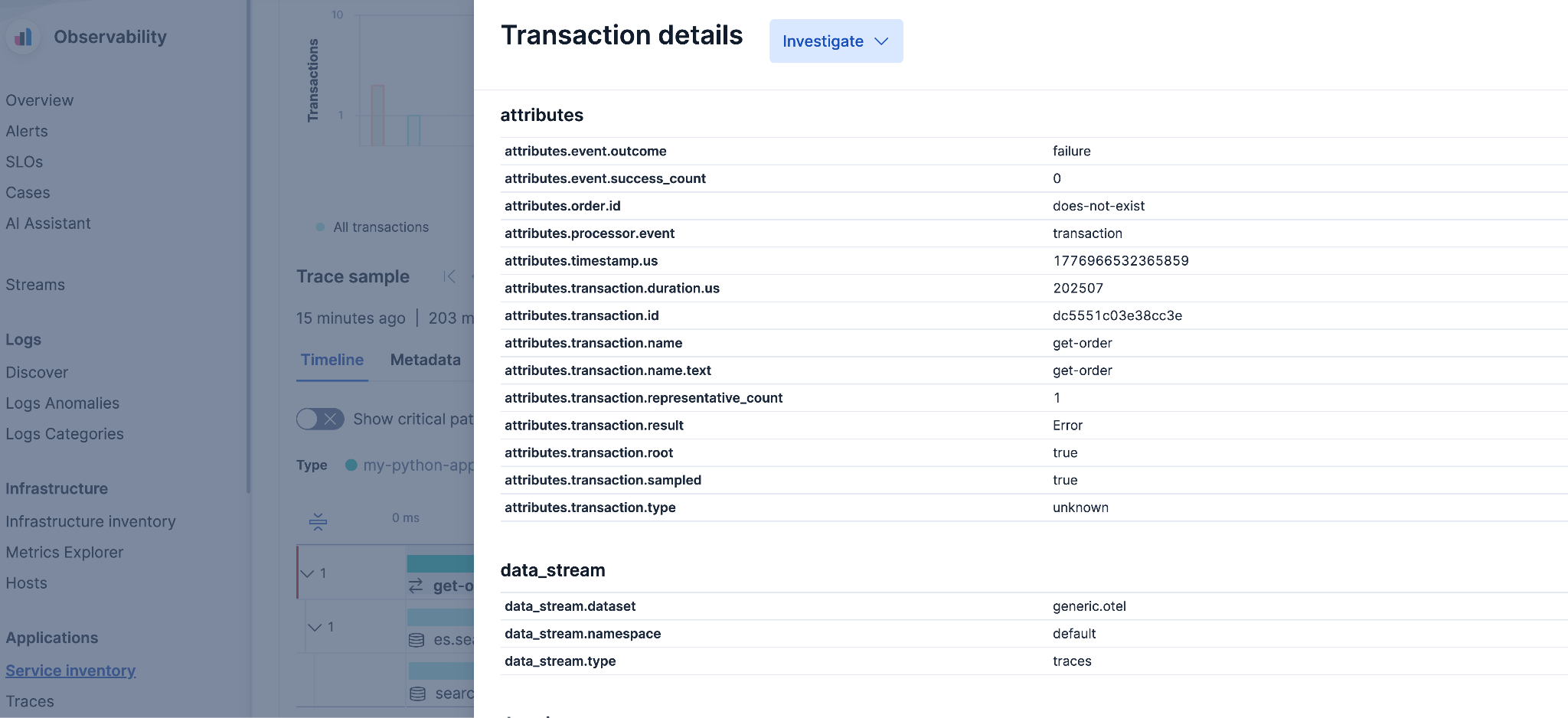

Add spans to your endpoints
Now wrap each route handler in a parent span and nest a child span around the Elasticsearch call. This gives you a two-level trace: one span for the HTTP request and one for the database query inside it.
@app.route("/orders")
def list_orders():
    with tracer.start_as_current_span("list-orders") as span:
        with tracer.start_as_current_span("es.search") as es_span:
            es_span.set_attribute("db.system", "elasticsearch")
            es_span.set_attribute("db.elasticsearch.index", INDEX)
            response = es.search(
                index=INDEX,
                size=10,
                sort=[{"order_date": "desc"}],
                aggs={"total_revenue": {"sum": {"field": "taxful_total_price"}}},
        hits = response["hits"]["hits"]
        total_revenue = response["aggregations"]["total_revenue"]["value"]
        orders = [
                "order_id": h["_source"]["order_id"],
                "customer": h["_source"]["customer_full_name"],
                "total": h["_source"]["taxful_total_price"],
                "date": h["_source"]["order_date"],
            for h in hits
        span.set_attribute("orders.returned", len(orders))
        return jsonify({"orders": orders, "total_revenue": total_revenue})

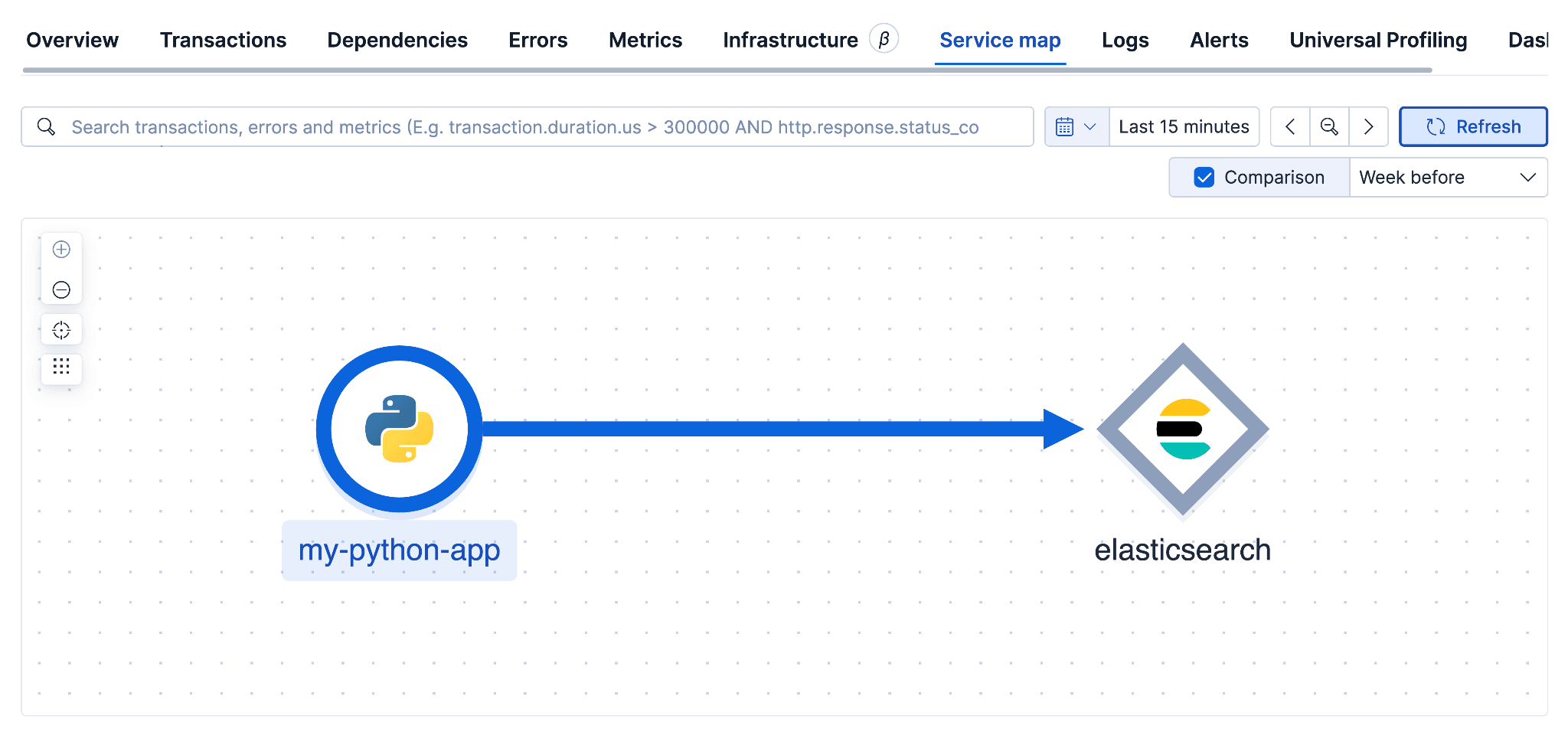

Each request creates a parent span (list-orders) with a child span (es.search) wrapping the Elasticsearch call.
The db.system and db.elasticsearch.index attributes are what Kibana uses to recognize the call as an Elasticsearch query in the trace waterfall.

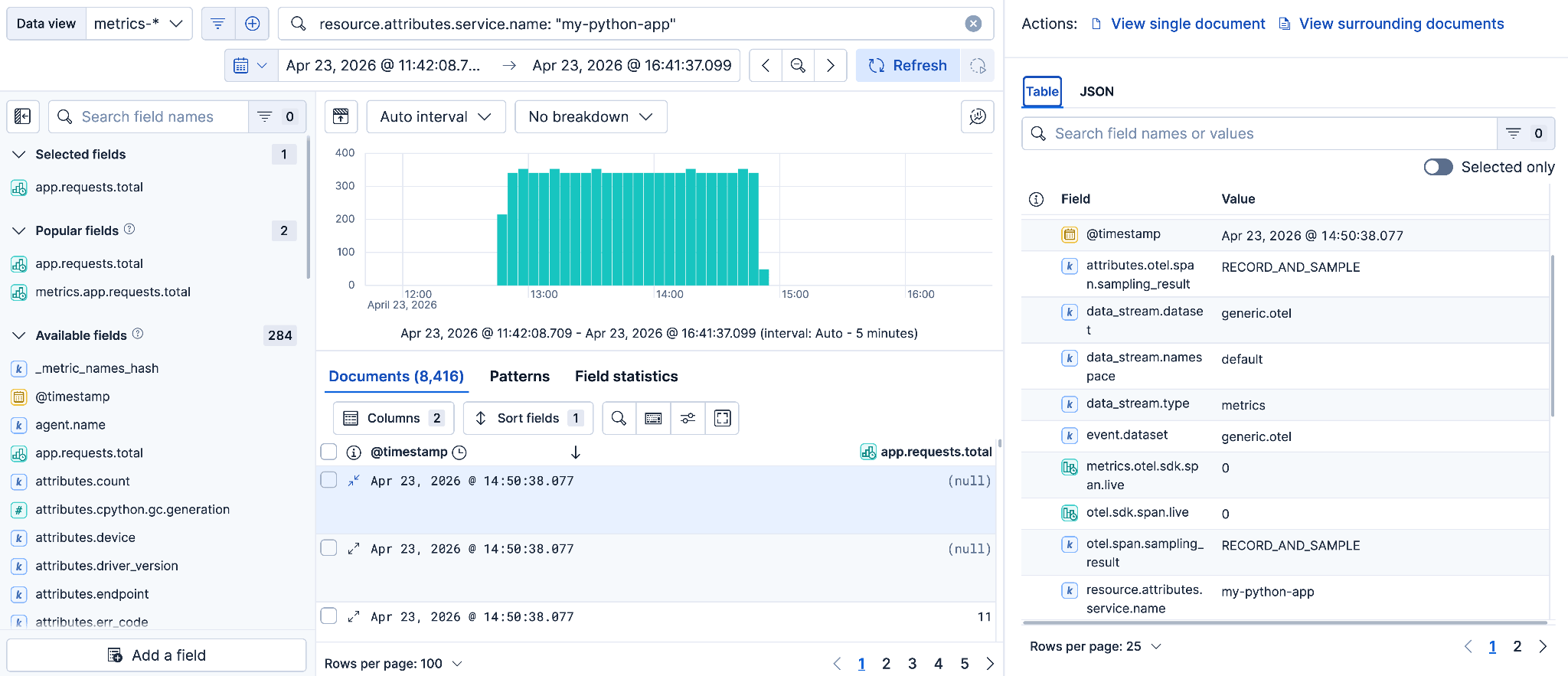

Sending metrics from Python
Metrics reveal patterns across all requests: how many calls hit each endpoint, how response times trend over time. Let's add a counter and a histogram to capture that.
Set up the meter
Add the following to app.py:
from opentelemetry import metrics
from opentelemetry.sdk.metrics import MeterProvider
from opentelemetry.sdk.metrics.export import PeriodicExportingMetricReader
from opentelemetry.exporter.otlp.proto.http.metric_exporter import OTLPMetricExporter
# Set up the metric reader and provider
metric_reader = PeriodicExportingMetricReader(
    OTLPMetricExporter(),
    export_interval_millis=10000  # Export every 10 seconds
meter_provider = MeterProvider(
    resource=resource,
    metric_readers=[metric_reader]
metrics.set_meter_provider(meter_provider)
meter = metrics.get_meter(__name__)

Record metrics in your endpoints
Update the route handler to record metrics:
import time
def list_orders():
    start_time = time.time()
                index=INDEX,
                size=10,
        orders = [
            for h in hits
        duration = time.time() - start_time
        request_counter.add(1, {"endpoint": "/orders", "status": "200"})
        request_duration.record(duration, {"endpoint": "/orders"})

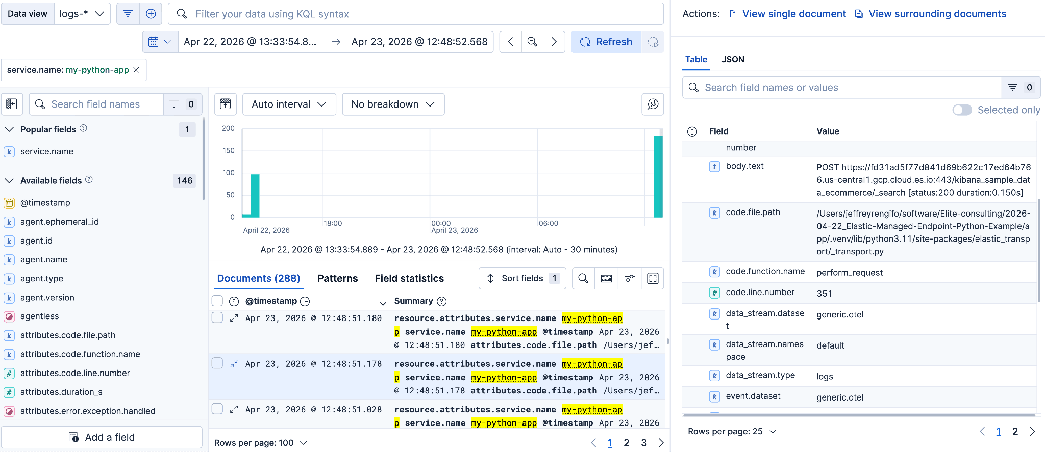

Sending logs from Python
Traces and metrics tell you what happened and how often. Logs capture the details: error messages, parameter values, and debug context. OpenTelemetry bridges Python's standard logging module so your existing log statements are exported as OTLP data alongside traces and metrics.
When you emit a log inside a span context, the SDK automatically attaches the trace and span IDs, so you can jump from a log line to the exact trace that produced it.
Set up the log provider
import logging
from opentelemetry._logs import set_logger_provider
from opentelemetry.sdk._logs import LoggerProvider, LoggingHandler
from opentelemetry.sdk._logs.export import BatchLogRecordProcessor
from opentelemetry.exporter.otlp.proto.http._log_exporter import OTLPLogExporter
# Set up the logger provider
logger_provider = LoggerProvider(resource=resource)
logger_provider.add_log_record_processor(
    BatchLogRecordProcessor(OTLPLogExporter())
set_logger_provider(logger_provider)
# Bridge Python's logging to OTel
handler = LoggingHandler(
    level=logging.INFO,
    logger_provider=logger_provider
logging.getLogger().addHandler(handler)
logging.getLogger().addHandler(logging.StreamHandler())  # Also print to terminal
logging.getLogger().setLevel(logging.INFO)
logger = logging.getLogger(__name__)
The StreamHandler() ensures logs also appear in your terminal while developing.
Without it, logs only go to Elastic and the terminal stays silent, which can be confusing during testing.

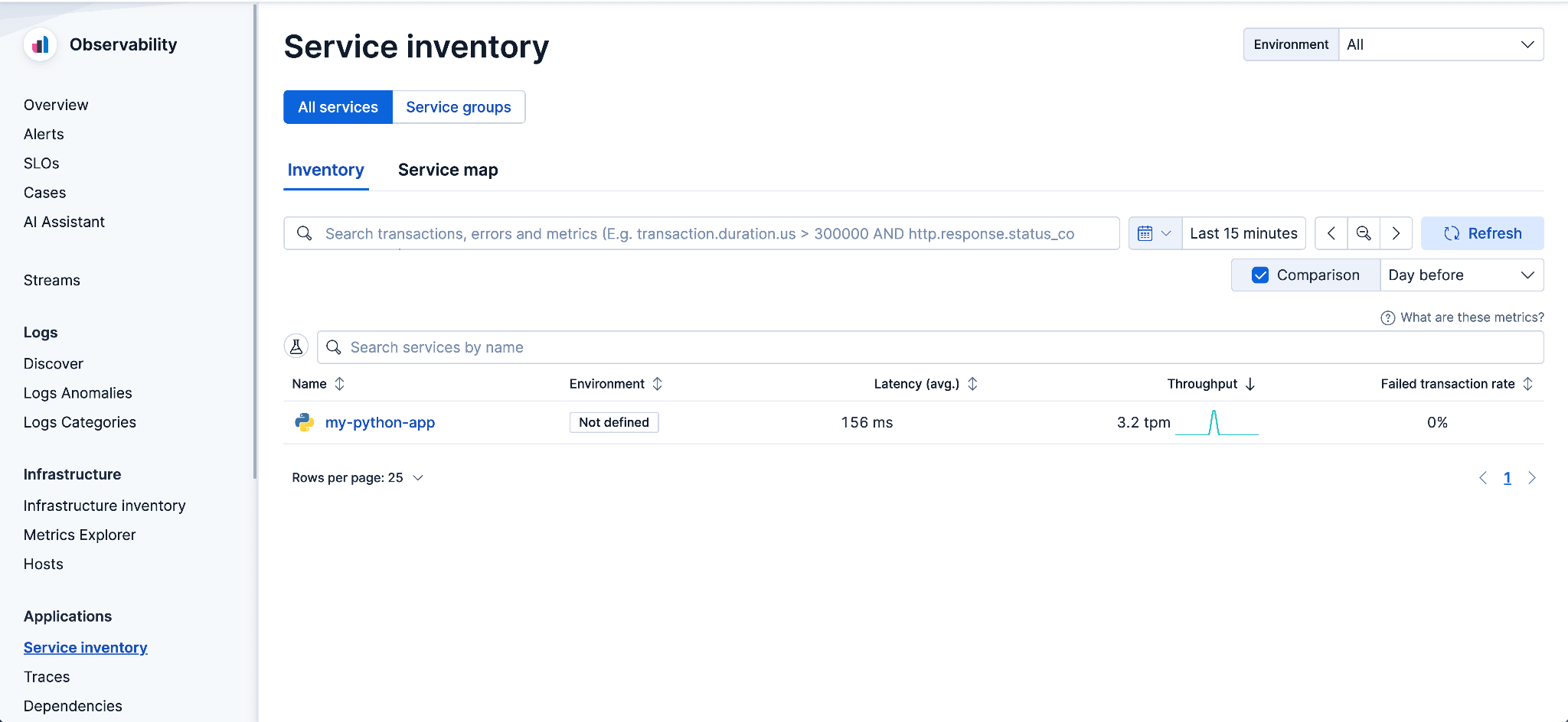

After a few seconds, open Kibana and go to Observability > APM > Services.
You should see my-python-app listed.

Traces
Go to APM > Services > my-python-app > Transactions. Click on a list-orders transaction to open the trace waterfall.
You should see the parent span list-orders with a child span es.search.
The db.system and db.elasticsearch.index attributes we set earlier appear in the span details, and Kibana recognizes the child as an Elasticsearch query.
Failed transactions
For error visibility, open a get-order transaction for the /orders/does-not-exist request.
The transaction details show event.outcome: failure along with the order.id: does-not-exist attribute we attached.
This confirms that error status and custom attributes propagate correctly through the managed endpoint.
Correlated logs
Go to Discover and filter by service.name: my-python-app.
Expand a log document to see the body.text, trace_id, and span_id fields.
Because we emitted logs inside a span context, every log record carries the trace ID.
You can copy the trace_id value and go to APM to jump directly to the trace that produced that log.
Metrics
In Discover, switch to the metrics-* data view.
You should see the app.requests.total counter and app.request.duration histogram arriving at regular intervals.
You can also create a Lens visualization with app.requests.total on the Y axis and @timestamp on the X axis to see request volume over time.
Service map
Kibana builds the service map automatically from the span attributes we set earlier.
Because we tagged our Elasticsearch spans with db.system: elasticsearch, Kibana draws the dependency between my-python-app and elasticsearch, giving you a visual overview of your service and its backends.
