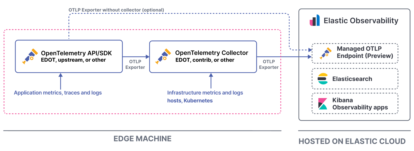

The managed endpoint receives OTLP data through an OpenTelemetry Collector layer that buffers to a managed Kafka cluster before indexing into Elasticsearch. Kafka absorbs bursts, decouples ingestion from indexing, and provides durability guarantees that in-memory queues can't. If Elasticsearch is temporarily under pressure, data sits in Kafka rather than getting dropped. When pressure subsides, the buffer drains and everything catches up. This is the same resilience pattern you'd build yourself with a Kafka exporter and Kafka receiver in a self-managed collector pipeline, except Elastic operates it for you.
This makes the entire path OpenTelemetry end-to-end:
  1. Your applications produce telemetry with OTel SDKs.
  2. Your collectors (or SDKs directly) export over OTLP.
  3. The managed endpoint receives that OTLP through an OTel Collector-based layer, buffers it through Kafka, and stores it natively in Elasticsearch using the OpenTelemetry data model.
No proprietary protocols, no schema translation, no format conversion at any stage of the pipeline. Just pure OTel.

The endpoint accepts standard OTLP over HTTP and gRPC. Any tool that speaks OTLP can send data to it.
This means you can send data from:
  • OpenTelemetry SDKs (upstream, EDOT, or any distribution) exporting directly from your application.
  • OpenTelemetry Collectors (Contrib, EDOT, or custom builds) running as agents, gateways, or sidecars.
  • EDOT Cloud Forwarder forwarding cloud provider logs and metrics.
  • Any OTLP-compliant forwarder you've built or adopted.

This doesn't mean you should remove all collectors from your architecture. Edge collectors (DaemonSet agents, sidecars, host agents) still serve a purpose: collecting infrastructure telemetry via pull-based receivers like filelog and hostmetrics, applying local transformations, and batching data before export. What changes is that the destination is now a managed endpoint rather than a self-operated gateway.
