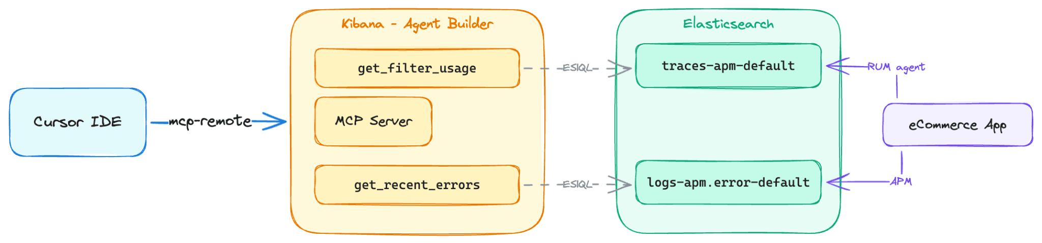

To bring that data into Cursor, we'll build two Agent Builder tools in Kibana and connect them via the Elastic Agent Builder MCP Server:
  • get_filter_usage: queries traces-apm-default for filter click events and returns a usage breakdown by filter name
  • get_recent_errors: queries logs-apm.error-default for the most recent error groups for a given service, including the exception message and stack trace culprit

Setting up the Elastic MCP Server

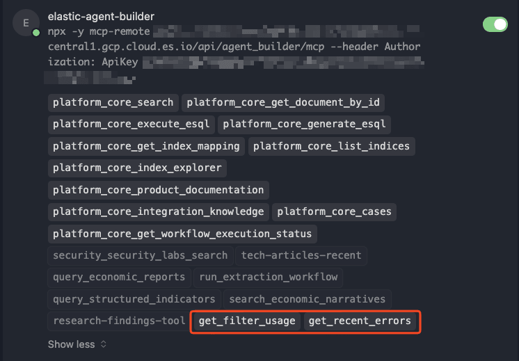

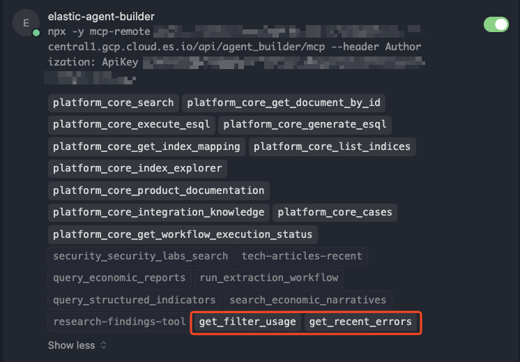

Restart Cursor, open the Agent panel, and confirm that get_filter_usage and get_recent_errors appear in the available tools list.

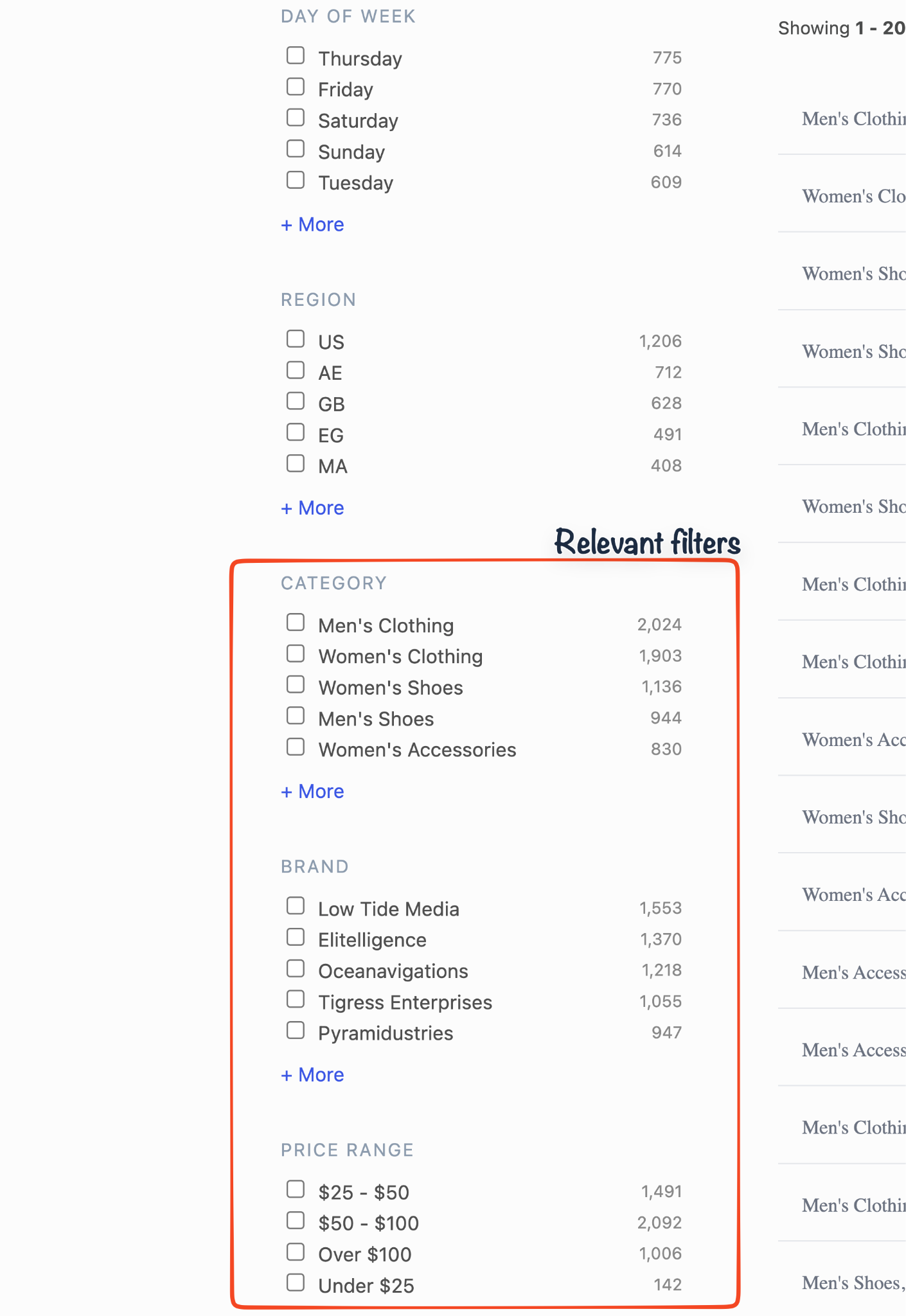

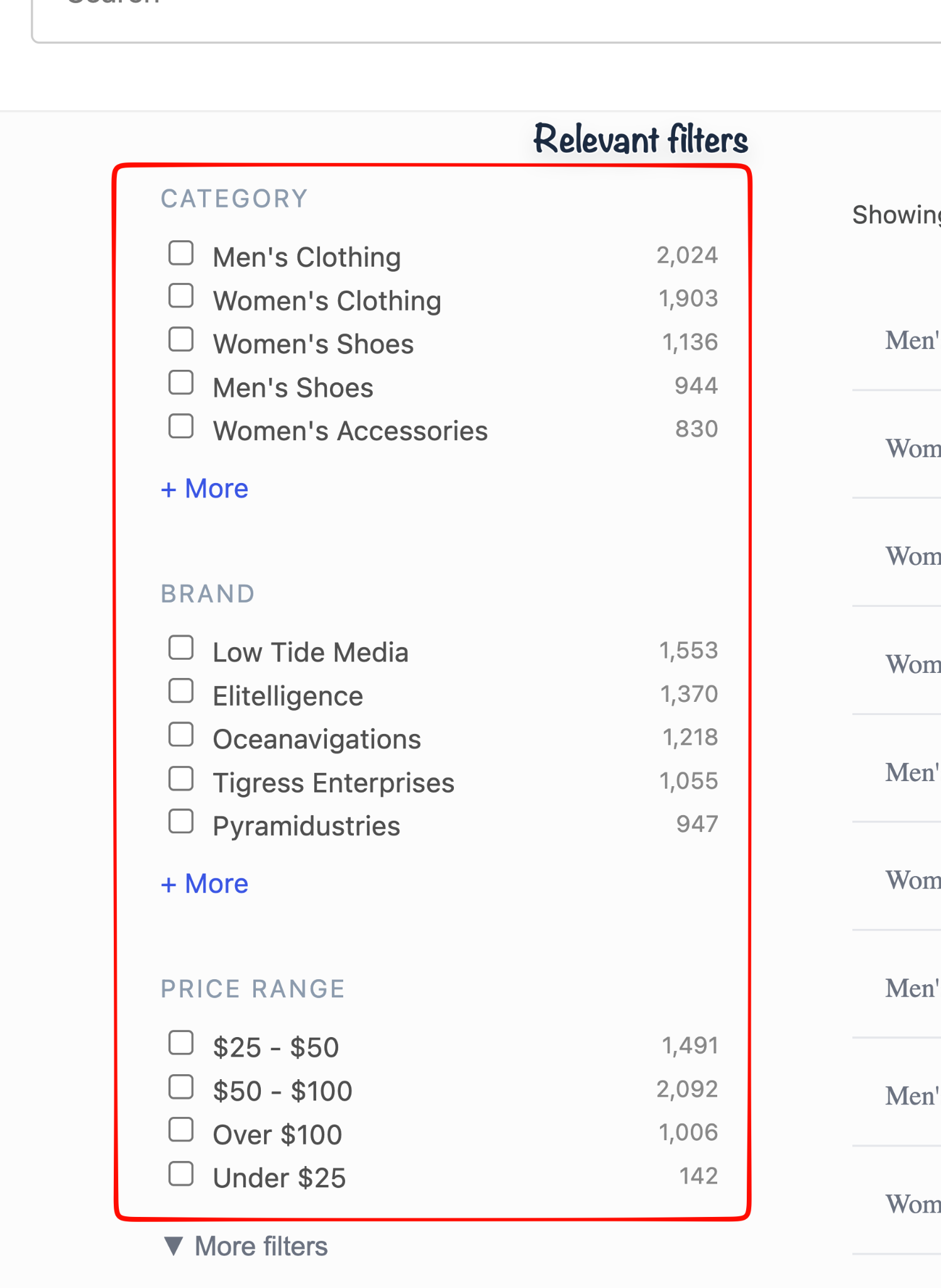

The eCommerce search page has six filters: category, manufacturer, price range, customer gender, day of week, and region. The product team wants to simplify the UI by removing filters that users don't use as much. Rather than guessing, we ask Cursor to check.

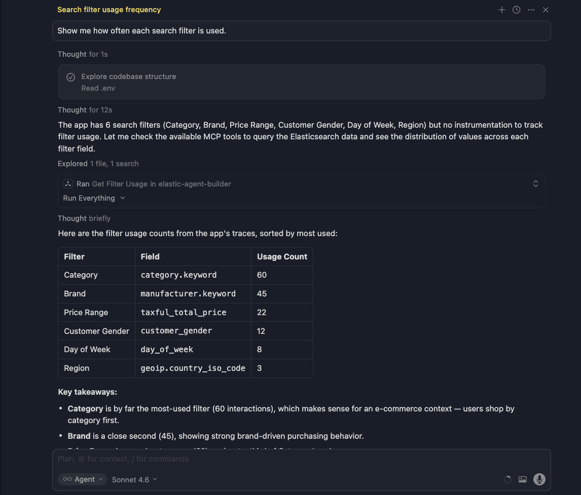

When you type a prompt in Cursor's Agent panel, the model sees the name and description of every connected MCP tool. It matches your intent to the best-fitting tool and calls it automatically. This is why the description field we set in Step 1 matters: it's what the model reads to decide which tool answers your question. If you are interested in learning more about Cursor’s MCP tools management, read the following documentation.
Open a Cursor chat and ask: "Show me how often each search filter is used." Cursor calls the tool and returns something like:
The category and manufacturer filters get most of the clicks. The bottom three filters (customer_gender, day_of_week, region) are rarely used.
Ask Cursor to act on this: "Based on this data, simplify the SearchFilters component. Keep the top 3 filters visible, collapse the others under a 'More filters' toggle."
Cursor opens src/components/SearchFilters.jsx, reads the current implementation, and proposes the change.
Before:
After:
The entire loop took one chat prompt. The decision was backed by production data, not a team discussion about what users probably care about.

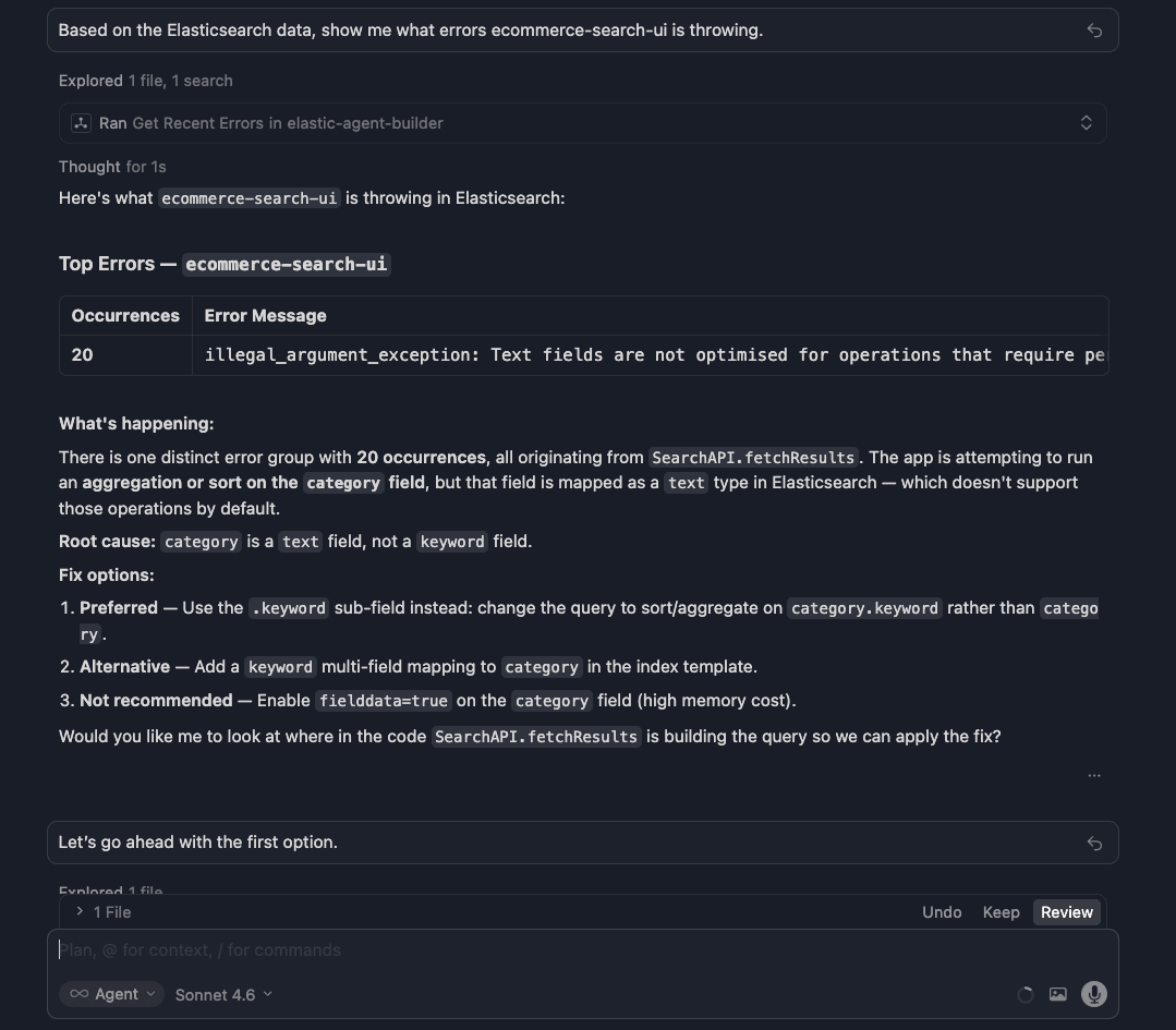

A bug report comes in: intermittent 500 errors on the search endpoint. The errors started appearing two days ago but they're not constant. The developer opens Cursor and asks: "Show me what errors ecommerce-search-ui is throwing."
Cursor calls the tool and returns the error groups:

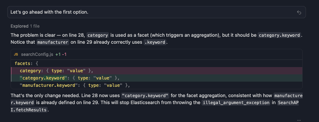

The error message is explicit: category is a text field and can't be used in terms of aggregation. The correct field is category.keyword.
With APM data available alongside your code, the debugging session becomes a conversation: you describe the symptom, the agent pulls the relevant logs, and you work through what's happening together. You can ask follow-up questions, check whether the error correlates with a recent deployment, or ask which endpoints are most affected, all within the same context where you'll make the fix. If you want to go further, Elastic also provides pre-built observability tools in Agent Builder that you can use alongside custom tools like the ones we created here. For a complementary approach to AI-driven observability, see how to monitor web AI agents with OpenLIT and Elastic.

  • Debugging a production error from the same window where you fix it
