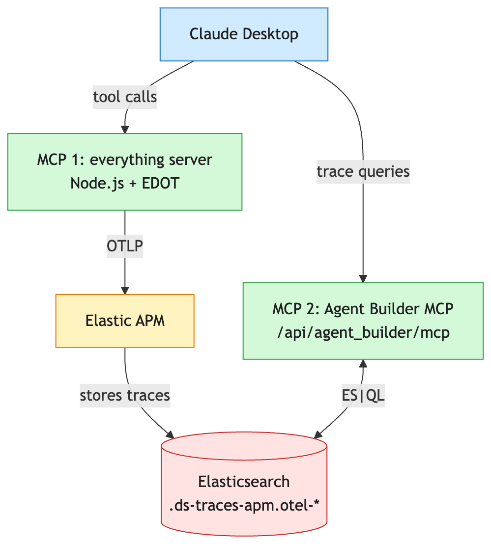

The architecture looks like this:
This is the loop: Claude executes tools, generates telemetry, and then uses a second MCP to analyze that telemetry. The observability data becomes something the AI can reason about, not just something that sits in a dashboard waiting for a human to check it.
Both MCP servers are active simultaneously in Claude Desktop. The instrumented MCP generates telemetry. The Agent Builder MCP lets us query it.

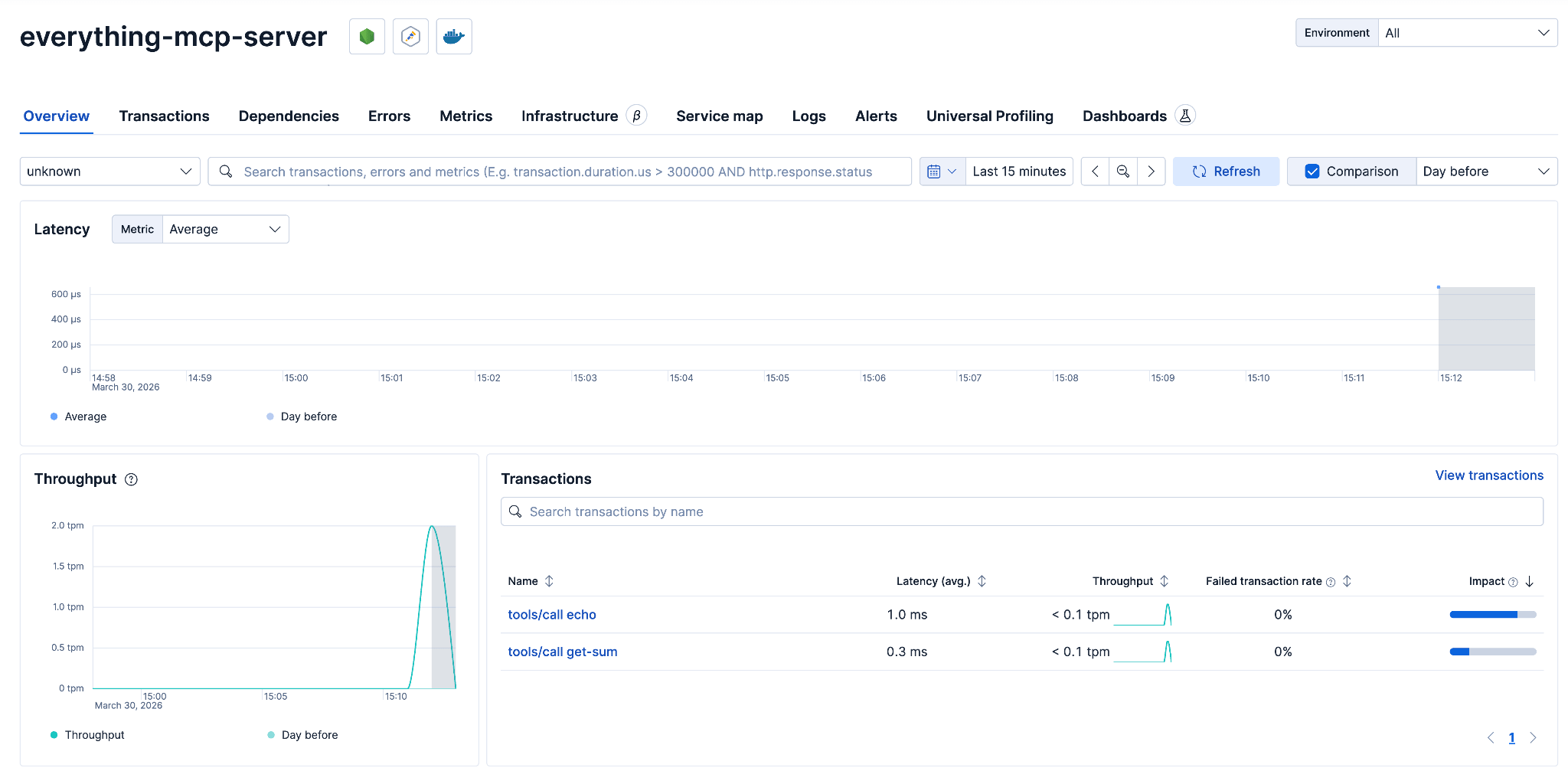

After starting Claude Desktop with both MCPs configured and triggering a few tool calls, the everything-mcp-server service appears in Kibana under Observability > Applications > Services Inventory:
Transactions view
Kibana groups traces by transaction name. Because we follow the semantic conventions, each tool gets its own row: tools/call echo, tools/call get-sum, tools/call trigger-long-running-operation. You can immediately see latency, throughput, and error rate per tool without any configuration.
This is where the value of consistent span naming becomes concrete. If you have five different developers adding tools to an MCP server and everyone follows tools/call {toolName}, the APM UI stays organized automatically.
Trace waterfall
Clicking on a specific trace shows the waterfall view. For a single tool call, the waterfall is straightforward: one span covering the full execution. If your tool handler makes downstream HTTP requests or database queries that are auto-instrumented, those appear as child spans. You can see exactly how much time was spent in business logic versus waiting for external calls.
Latency distribution
The latency chart shows p50, p95, and p99 distribution across all executions of a given tool. This makes it easy to distinguish between tools that are consistently fast and those that have occasional outliers. The trigger-long-running-operation tool, for example, shows a wide distribution depending on how many steps were requested: a useful baseline for understanding expected execution time ranges before setting alerts.
Error tracking
Failed tool calls appear in the Errors panel with their full stack trace, the span attributes attached at the time of failure, and a count of how many times the error has occurred. If you record the exception with span.recordException(err), Kibana links the error directly to the trace that produced it.

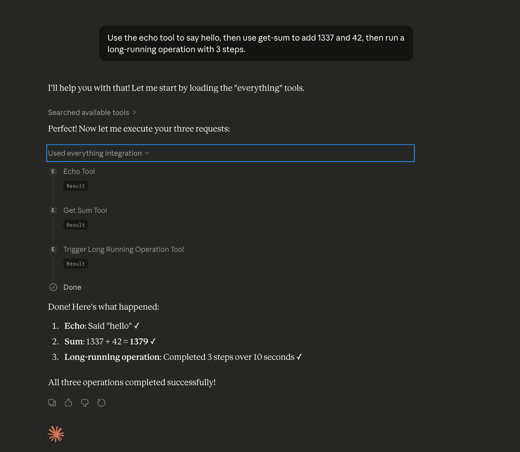

Here is what this looks like in practice. To generate traces, let's ask in Claude Desktop: "Use the echo tool to say hello, then use get-sum to add 1337 and 42, then run a long-running operation with 3 steps."
Claude executes three tool calls on the instrumented MCP. Three spans land in Elastic APM.

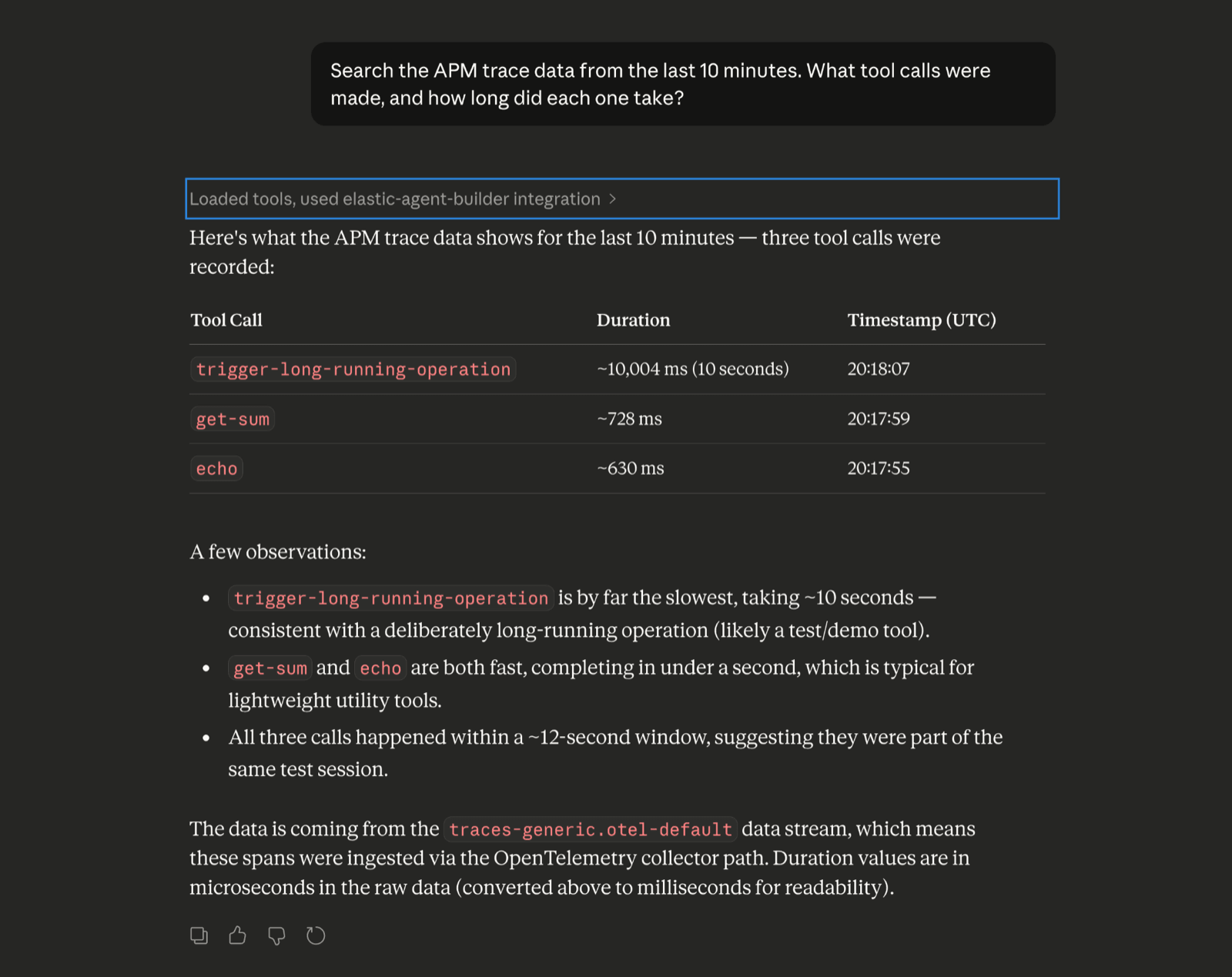

Now, without leaving the chat, let's try querying the traces by asking: "Search the APM trace data from the last 10 minutes. What tool calls were made, and how long did each one take?"
We can confirm the information against the services data:
Claude uses the Agent Builder MCP to run a query against the traces index. It returns the tool names, durations, and status from the actual trace data, then synthesizes an answer in natural language.
