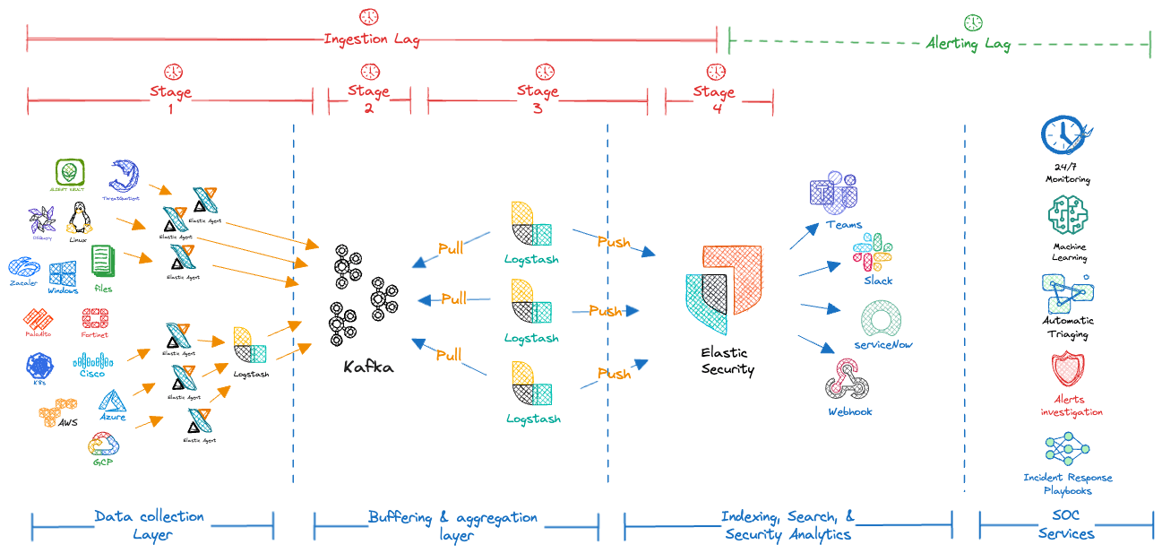

Consider the below Security Operations Center (SOC) platform, where data is ingested from various sources via Elastic Agent. The data is queued and pre-processed in a Kafka cluster before being pulled by Logstash and forwarded to Elastic Security. In this environment, delays at any stage of the pipeline can result in critical security events going undetected by Elastic Security, emphasizing the importance of a well-optimized data pipeline.

End-to-end lag monitoring can be broken down into the various stages of the pipeline. The incremental improvements across those stages would collectively contribute to a significant reduction in the end-to-end lag:
A) Ingest lag between the source and Kafka: This lag is the time difference between the real event-time, which is typically extracted from the event itself or added by the event producer (Elastic Agent for example), and the Kafka record timestamp, which can be added to the Logstash events via event decoration in the Kafka input plugin.
In most cases, this lag is influenced by the write performance of the Kafka cluster and network latency between the event source and Kafka. In some cases, the lag may also appear due to time configuration mismatches that make it look like there's a lag when there really isn't.
B) Ingest lag between Kafka and Logstash: This lag is the time difference between the Kafka record's timestamp and the execution timestamp of the first filter in the Logstash pipeline. If your pipelines are using a persistent queue, note that this duration also includes the time spent in the PQ.

C) Ingest lag in the Logstash processing: This lag is the time difference between the first and last Logstash filters. To calculate this lag, an additional filter can be added at the end of the pipeline to record the `logstash.end` timestamp in the same way the `logstash.start` field was added before. The primary factors contributing to this lag are the filters efficiency of processing, which is primarily affected by the complexity and optimization of the transformations they perform, access to external services for data loading which might require network, limited number of the pipeline’s workers and small batch size, and the amount of resources available for Logstash – particularly when running on virtual environments with resources contention.
D) Ingest lag between Logstash and Elasticsearch: This lag is the time difference between the last applied Logstash filter in the pipeline, and the timestamp when the event is ingested in Elasticsearch. The ECS field `event.ingested` is automatically added by the Elastic integrations to record this value. For custom sources, the field should be added via an ingest pipeline:

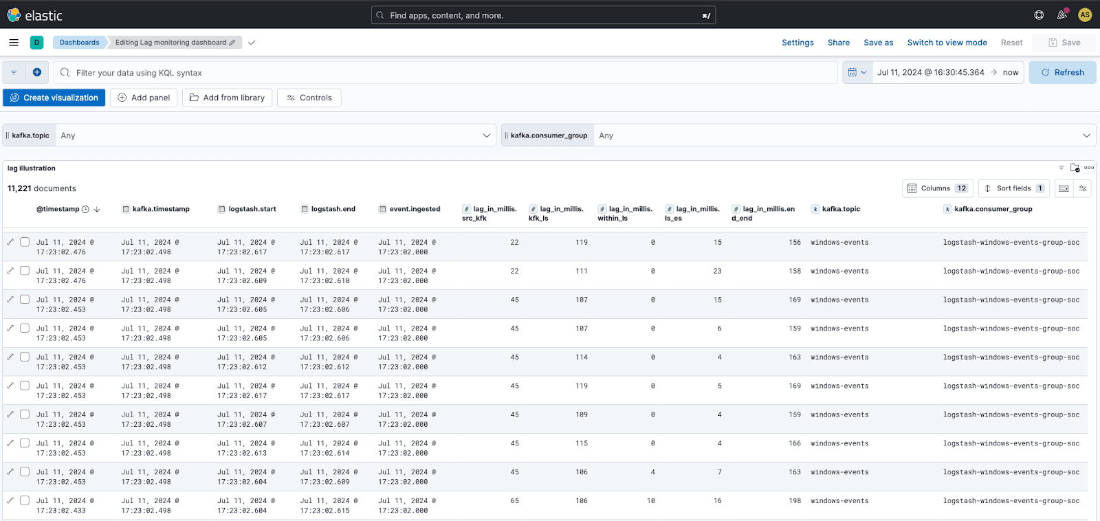

Visualizing these stages in Kibana helps identify the most throttled areas and analyze the impact of various parameter adjustments across the entire data pipeline during the tuning process.

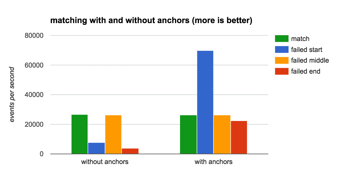

Optimizing the pipeline filters is the most effective approach to resolving this bottleneck. It can significantly reduce latency and increase the throughput regardless of the pipeline input configuration and Logstash resources. The per-plugin worker_utilization and worker_millis_per_event flow metrics are very useful in identifying where most of the resources are being spent, and consequently, where these improvements should focus first.
Optimizing pipeline filters is the most effective way to address this bottleneck. it can significantly reduce latency and boost throughput, regardless of the pipeline's input configuration or available resources. The per-plugin worker_utilization and worker_millis_per_event flow metrics are useful for finding which plugins are spending the most resources, and the optimization efforts should focus on those plugins first. Some general best practices that can usually make improvements are utilizing anchors for Grok plugins, switching to faster plugins like dissect whenever possible, optimizing Ruby filters code, eliminating unnecessary parsing, and improving the network-based enrichments.
Source: do you grok

Create an ingest pipeline for lag calculation. Note that when using Elastic integrations, the ECS fields: \ \*.end\, \ \*.start\, \ \*.timestamp\ are automatically mapped as a date.
PUT _ingest/pipeline/calculate_ingest_lag
  "processors": [
      "set": {
        "field": "event.ingested",
        "value": "{{_ingest.timestamp}}",
        "ignore_failure": true
      "script": {
        "lang": "painless",
        "if": "ctx['@timestamp'] != null && ctx?.kafka?.timestamp != null && ctx?.logstash?.start != null && ctx?.logstash?.end != null && ctx?.event?.ingested != null",
        "source": """
  ctx.lag_in_millis = [:];
              ctx.lag_in_millis.src_kfk = Duration.between(ZonedDateTime.parse(ctx['@timestamp']), ZonedDateTime.parse(ctx['kafka']['timestamp'])).toMillis();
              ctx.lag_in_millis.kfk_ls = Duration.between(ZonedDateTime.parse(ctx['kafka']['timestamp']), ZonedDateTime.parse(ctx['logstash']['start'])).toMillis();
              ctx.lag_in_millis.within_ls  = Duration.between(ZonedDateTime.parse(ctx['logstash']['start']), ZonedDateTime.parse(ctx['logstash']['end'])).toMillis();
              ctx.lag_in_millis.ls_es = Duration.between(ZonedDateTime.parse(ctx['logstash']['end']), ZonedDateTime.parse(ctx['event']['ingested'])).toMillis();
              ctx.lag_in_millis.end_end = Duration.between(ZonedDateTime.parse(ctx['@timestamp']), ZonedDateTime.parse(ctx['event']['ingested'])).toMillis();
Use the pipeline to add the lag calculation to your Elastic integrations
