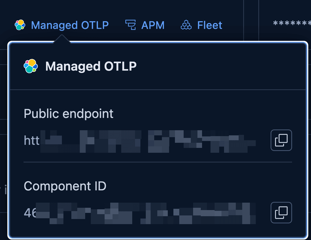

  3. The Managed OTLP endpoint URL and an API key. Open Cloud Console > Manage > Application endpoints > Ingest. Copy the Managed OTLP endpoint URL and generate an API key from that same panel.
Once these are ready, open Observability > Streams and confirm a logs.otel wired stream is listed. That stream is the parent we will partition.

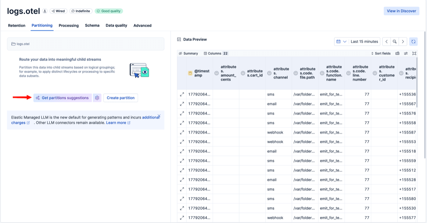

Run the notebook to emit 115 records with an uneven split across teams.
Open Observability > Streams > logs.otel and switch to the Partitioning tab. You should see the ingested data in the preview panel, with attributes like team, service.name, and the team-specific fields visible in the columns.

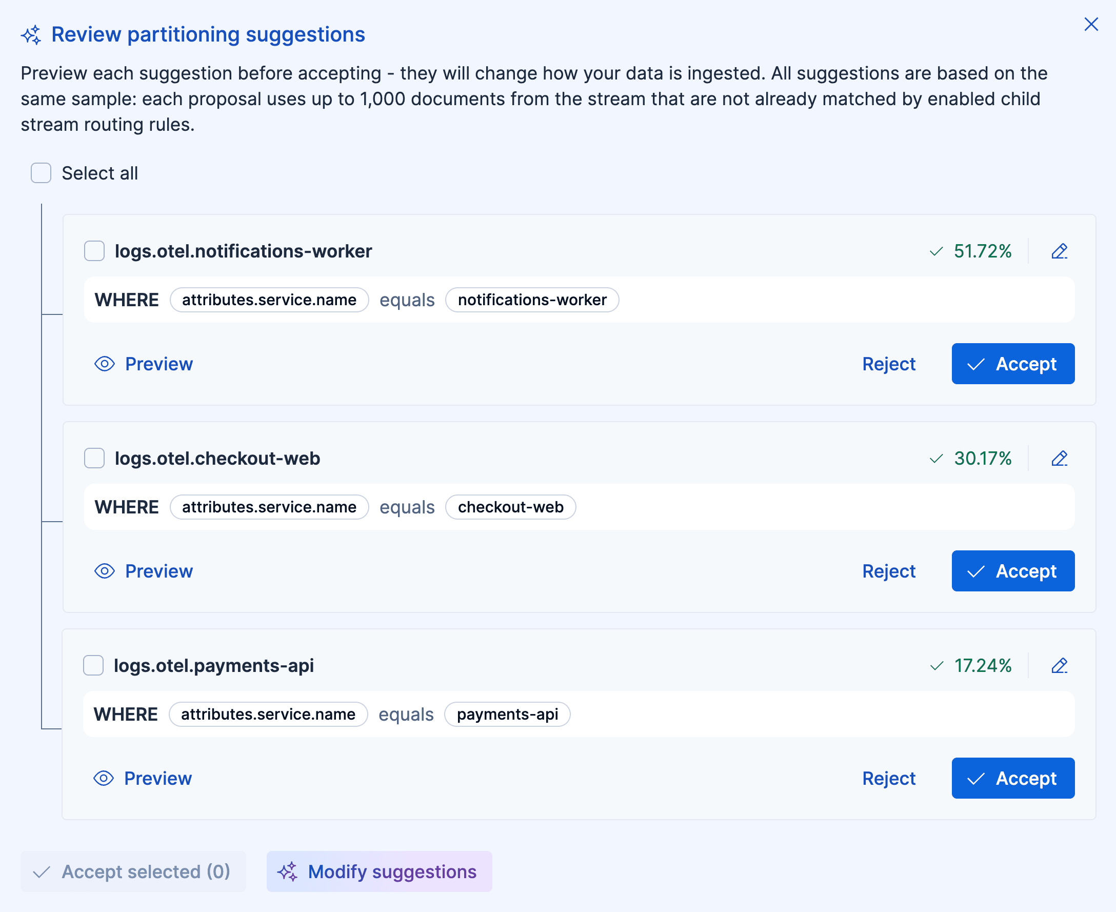

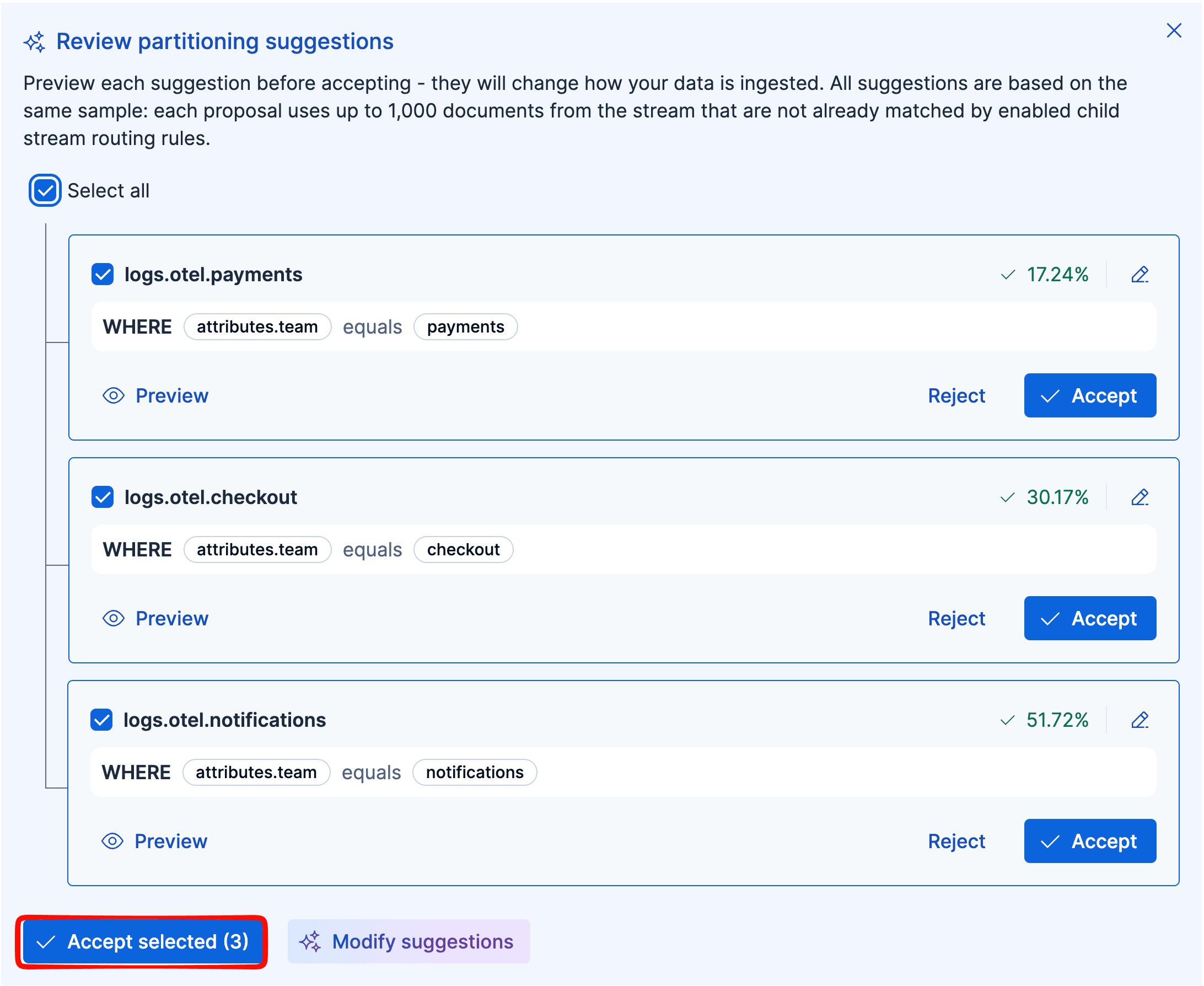

Streams AI Partitioning analyzes up to 1,000 documents from the parent stream, identifies attribute clustering and cardinality distribution, then proposes child streams, keyed on whichever field best separates the data logically (the ML approach behind this analysis is detailed in automated log parsing in Streams).
For the data we just emitted, the AI proposed three child streams keyed on attributes.service.name:
Each suggestion shows a Streamlang condition and the percentage of sampled documents that would match. The AI picked service.name because it is a standard OpenTelemetry attribute and a natural identifier for any single workload.
This is a reasonable first proposal, but it is worth thinking about what happens as the deployment grows. Right now there are three services because there are three teams. Tomorrow, Payments might add a refunds-api and a fraud-detector. Each new service would mechanically create another child stream, and over time you would end up with dozens of partitions for what is really just three organizational boundaries.
Elastic's partitioning recommendations prefer logical groupings like team or technology type, and aim for tens of partitions rather than hundreds. A team-keyed partitioning is more stable because Payments stays one child stream no matter how many services that team operates.

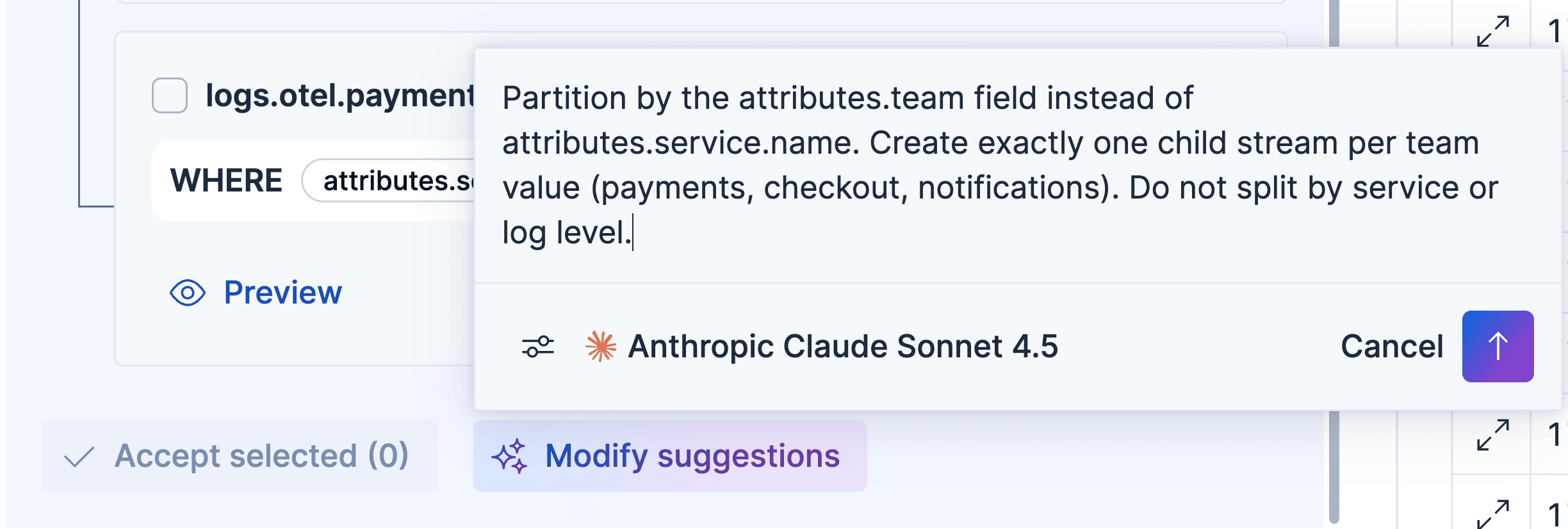

Refining Streams AI Partitioning suggestions in natural language
After reviewing the AI's initial suggestions in Streams AI Partitioning, click Modify suggestions to open a free-text prompt.
After submitting, the AI regenerates the suggestions. Now the three cards are keyed on attributes.team instead of service.name:

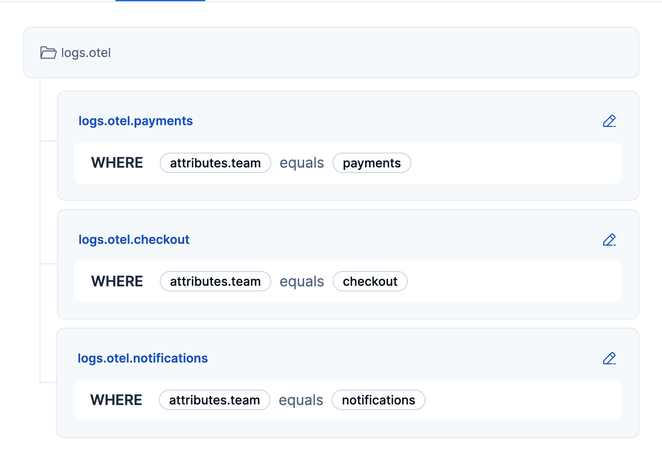

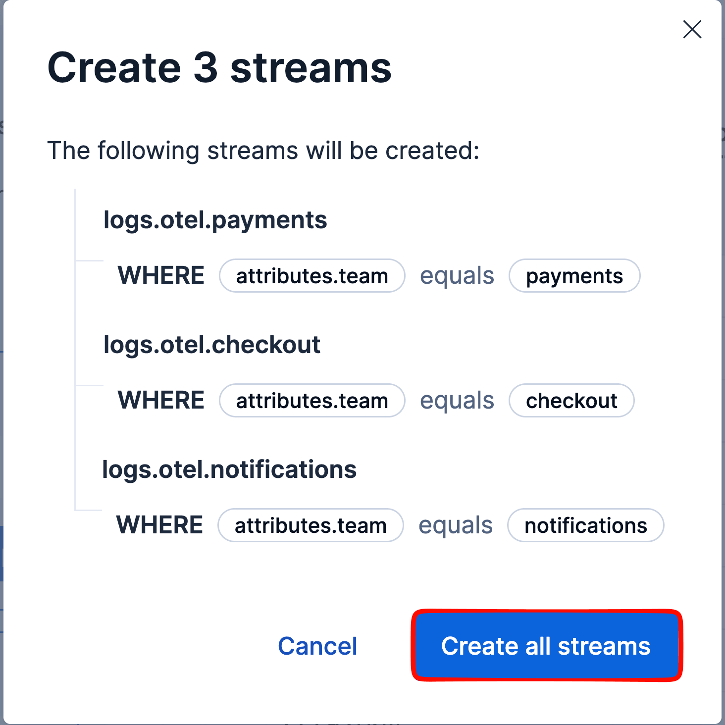

Select all three and click Accept selected. A confirmation dialog shows the streams that will be created, each with its WHERE attributes.team equals <team> condition.
Click Create all streams. The Partitioning tab now shows the three child streams as part of the logs.otel parent:

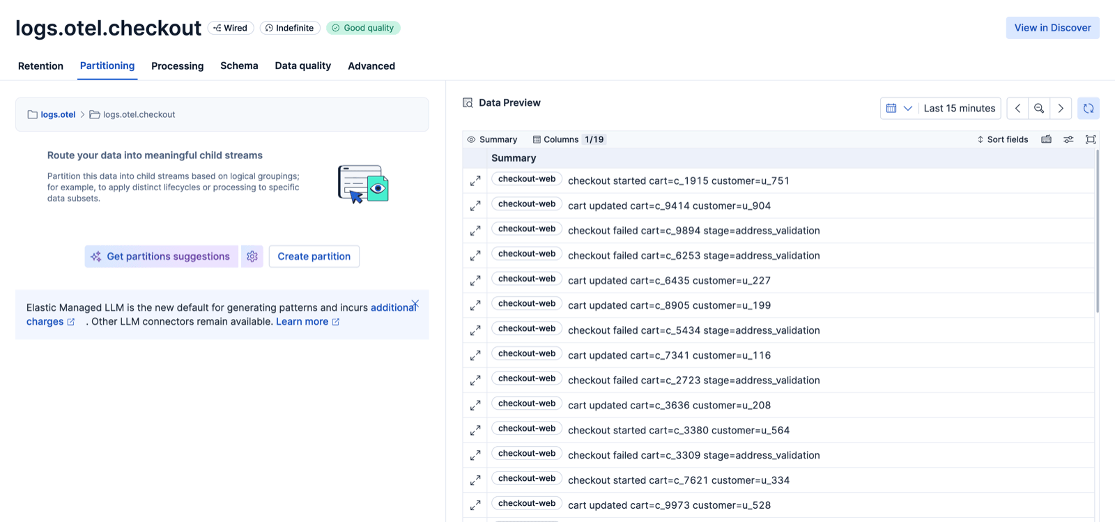

Every new document arriving at the OTLP endpoint will be routed into the correct child according to these conditions. You can open any child stream to verify its data. For example, logs.otel.checkout shows only checkout logs:

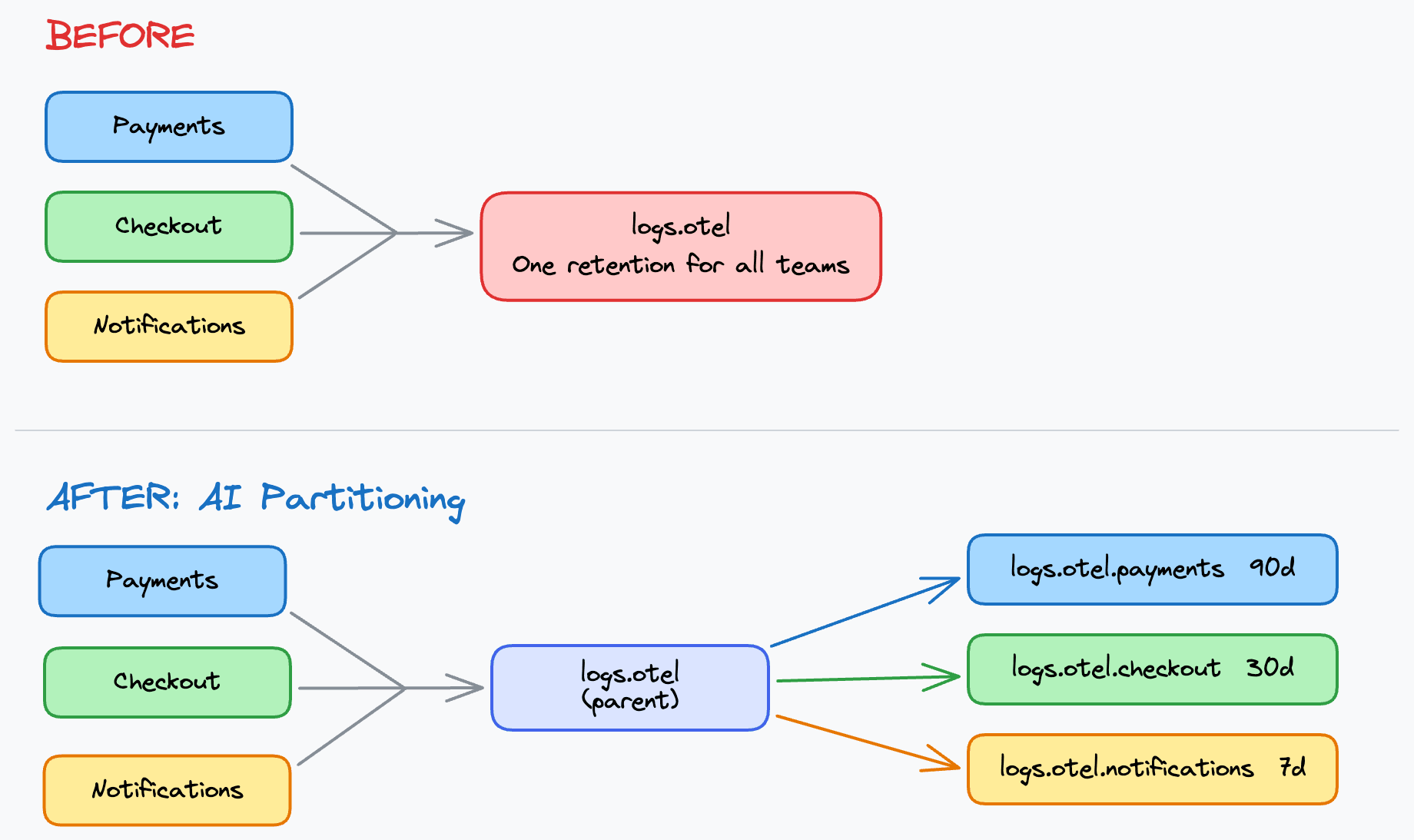

How do you set per-team log retention in Elasticsearch Streams?

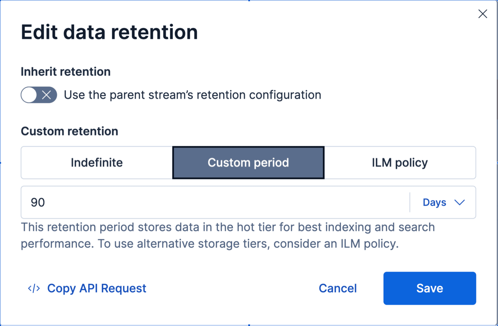

After Streams AI Partitioning creates child streams, each one can have its own lifecycle configuration independently of the parent. Because wired streams use a parent-child hierarchy, every child inherits retention, processors, and schema from the parent by default. You only need to override the partitions you need to change.
Open the child stream logs.otel.payments and go to the Retention tab. Click Edit retention method, select Custom period, and set it to 90 days.
Do the same for the other teams with the retention that fits their needs:
StreamRetentionRationale
logs.otel.payments90 daysSensitive financial data, compliance requirements
logs.otel.checkout30 daysUseful for debugging, no long-term need
logs.otel.notifications7 daysHigh volume, low value after delivery confirmation
