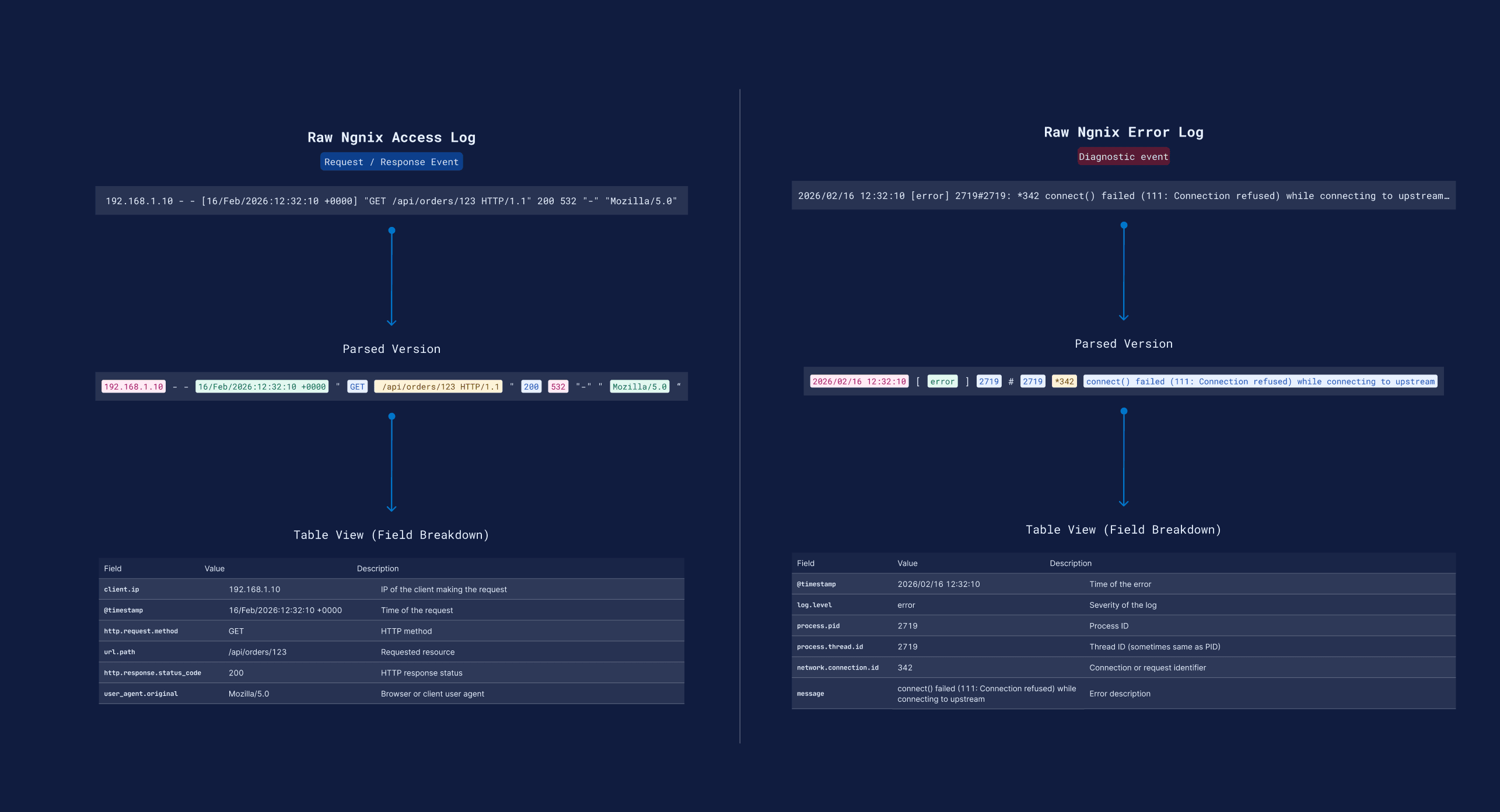

Why Does Data Consistency Matter?
We started with an example to test our thinking. Take Nginx access and error logs.
Access logs describe request/response events:
192.168.1.10 - - [16/Feb/2026:12:32:10 +0000] "GET /api/orders/123 HTTP/1.1" 200 532 "-" "Mozilla/5.0"
Error logs describe diagnostic events:
2026/02/16 12:32:10 [error] 2719#2719: *342 connect() failed (111: Connection refused) while connecting to upstream…
If both live in the same Streams that might cause:
- Processing logic conflicts
- Field divergence
- Mapping conflicts
- Investigations would be fundamentally harder
That insight clarified something critical:
“Processing isn’t just about extracting fields. It’s about protecting consistency.”

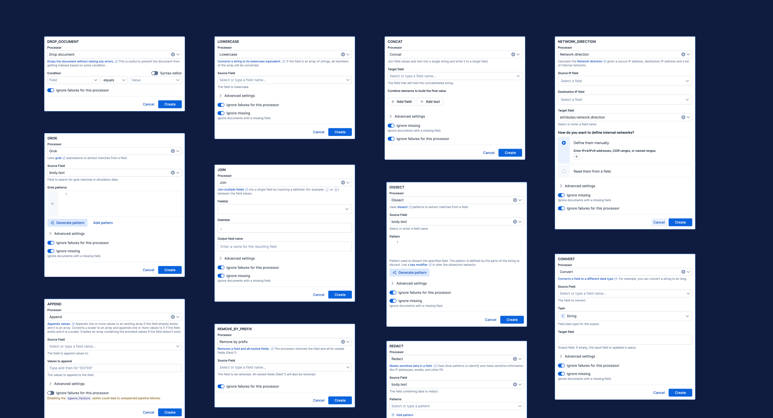

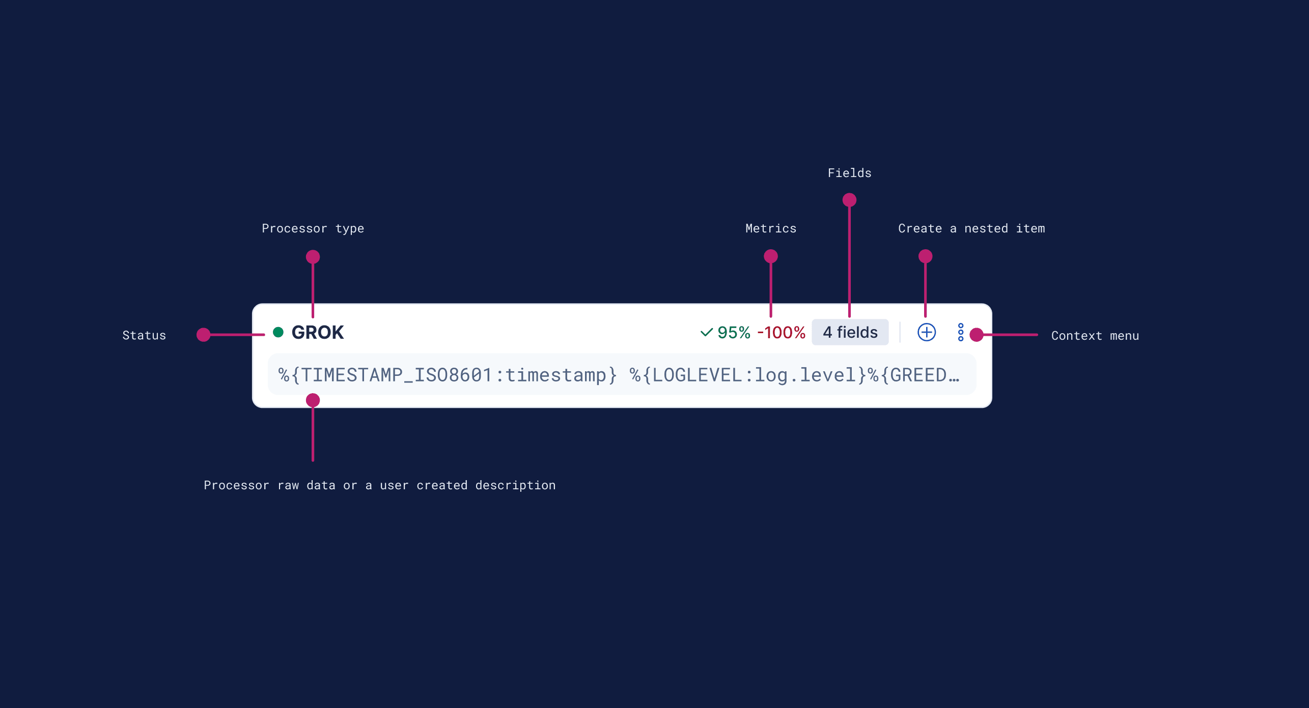

The ingest ecosystem isn’t small, simple, or hypothetical. Real pipelines use dozens of processors — from common ones like rename, set, convert, and append, to niche types like urldecode and network_direction.
The UI had to support both high-frequency actions and long-tail edge cases without losing structure. Currently Elasticsearch supports over 40 different ingest processors. We had to make sure our interface could handle the different types.
We introduced a clear, nested structure for pipeline steps. Users could create, reorder, edit, or remove individual steps or grouped ones with confidence. The nested drag and drop capability was also added as a pattern in our EUI library.
This gave us the context and foundation to work on integrating those concepts into a model that would be definitive for everything in Streams.

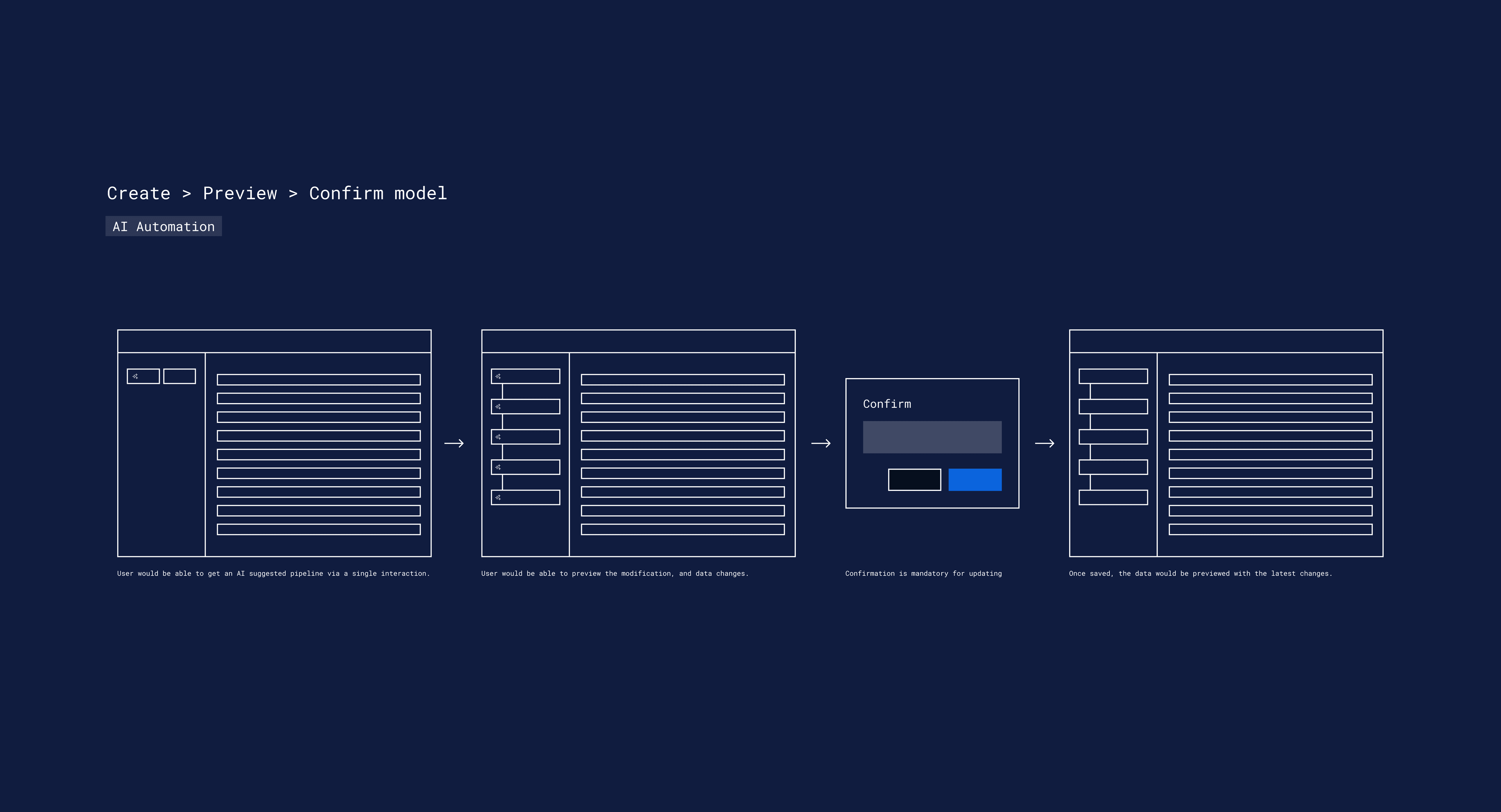

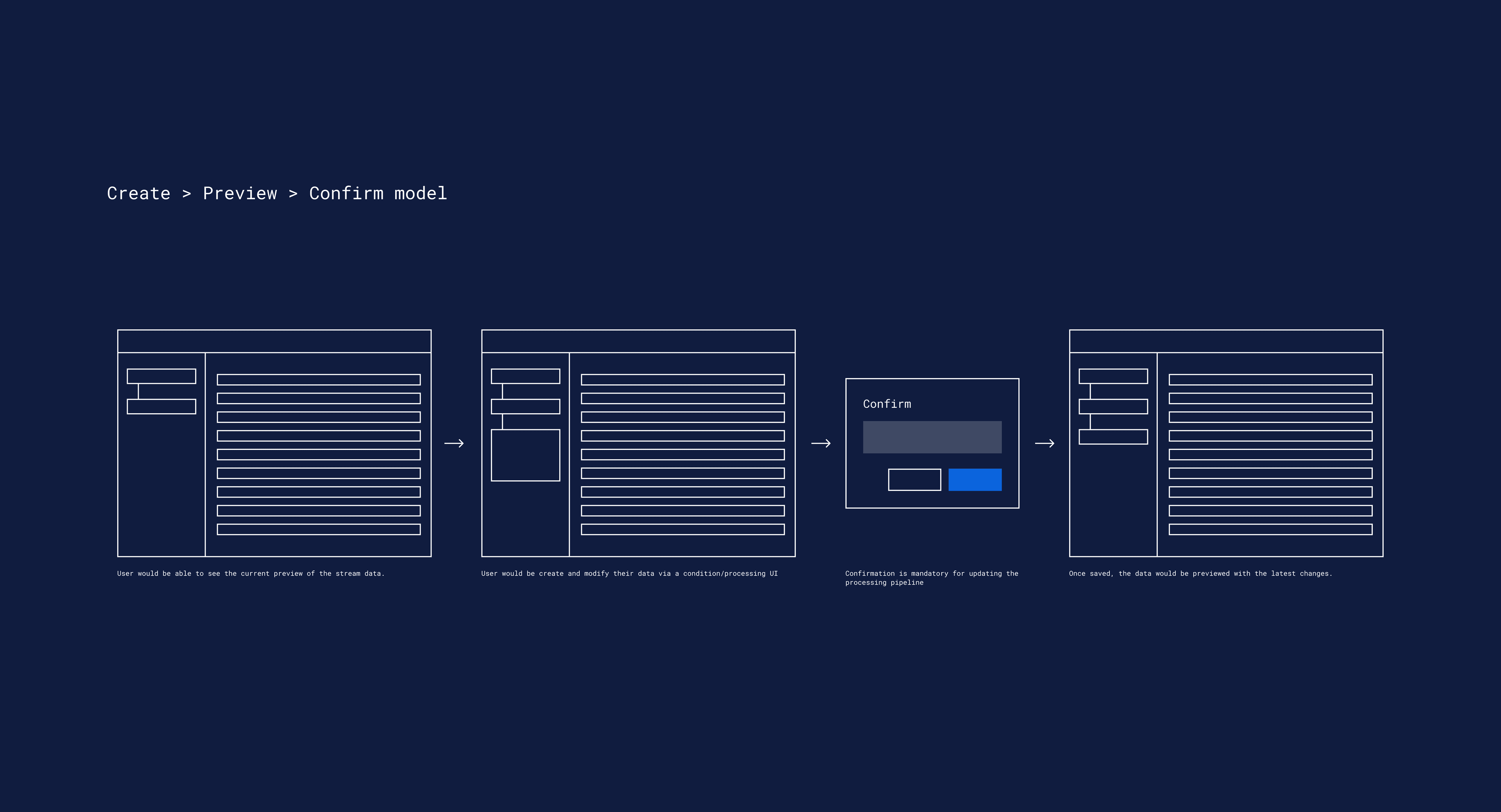

So we asked ourselves how do we make something so powerful and important, safe for the user? The answer led to a core page archetype:
Create > Preview > Confirm
This wasn’t a UI pattern added later. It emerged directly from our concept work and understanding what users would have to deal with.

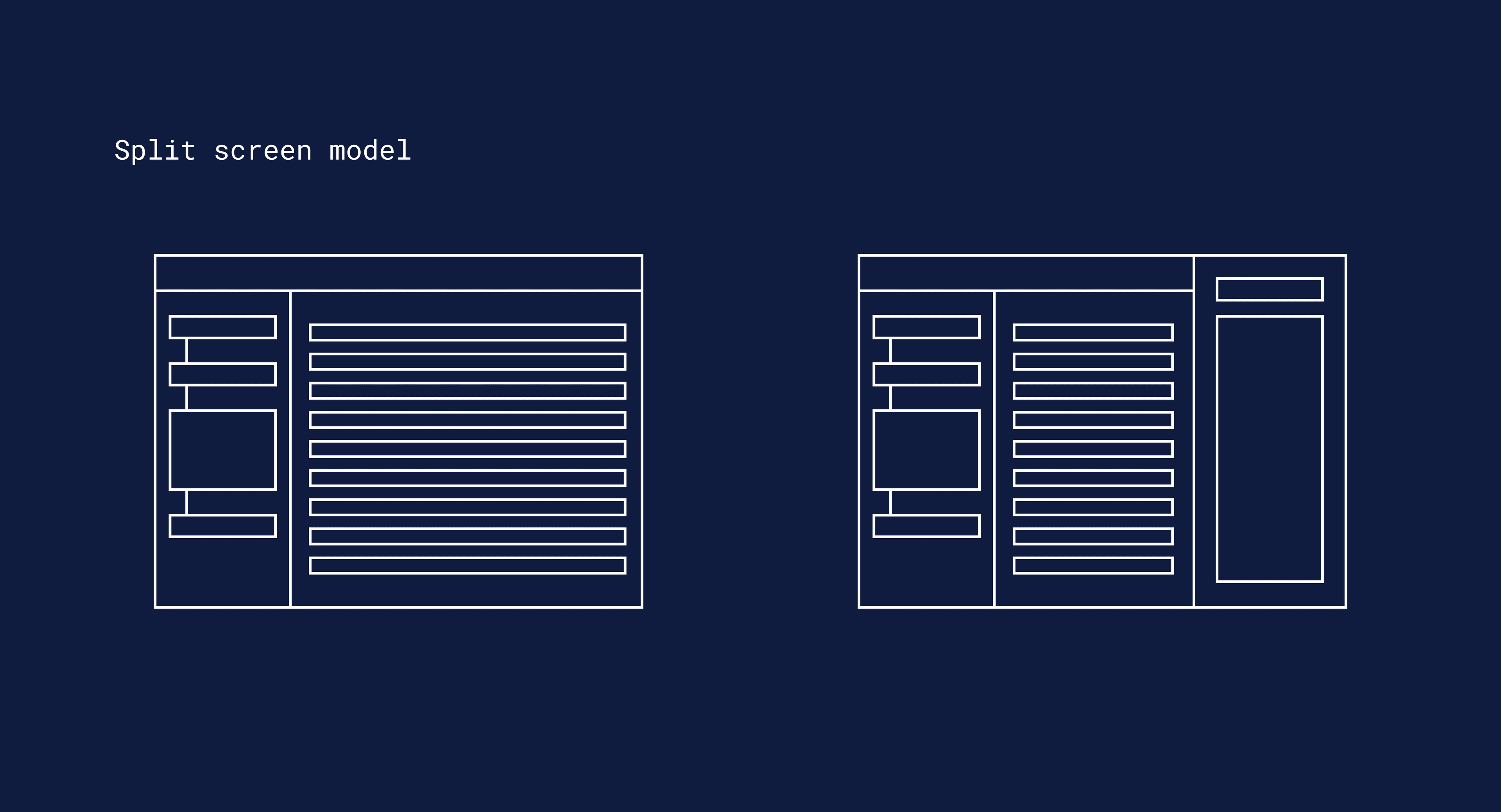

To support this archetype and core idea, we also introduced a split-screen structure.
Left: Build
This is where users would:
- Add processing steps
- Define conditions
- Apply rules
- Leverage AI suggestions both as a whole pipeline creation or individual steps like a GROK processor
It remained focused, intentional and structured.
Right Preview
- See real life log samples
- See extracted fields in context
- Immediate feedback on changes, with insights about the matched and unmatched percentage of documents
- Optional drilldown side panel on the right
The preview panel became the anchor of confidence. This was not about visual symmetry, but to reinforce experimentation, control over errors and decrease the level of mistakes. Knowing that users might want to switch their focus from interaction to detailed preview, we introduced the resizeable function to both panels, and unlocked more flexiblity and control over the use cases.
AI Automation
Streams is agentic and AI powered. That added another layer of complexity for the design, but also another opportunity to unlock even more power and insights from users' log data.
AI introduced a new tension: how do you accelerate processing without turning it into a black box?
We established a few guardrails:
- Clear, concise suggestions
- Visible impact through matched document metrics
- Inspectability
- Alignment with the Create → Preview → Confirm model
Processing UX became the bridge between automation and human in the loop. Log data is one of the most powerful investigation signals. Every design decision reinforced that belief.
