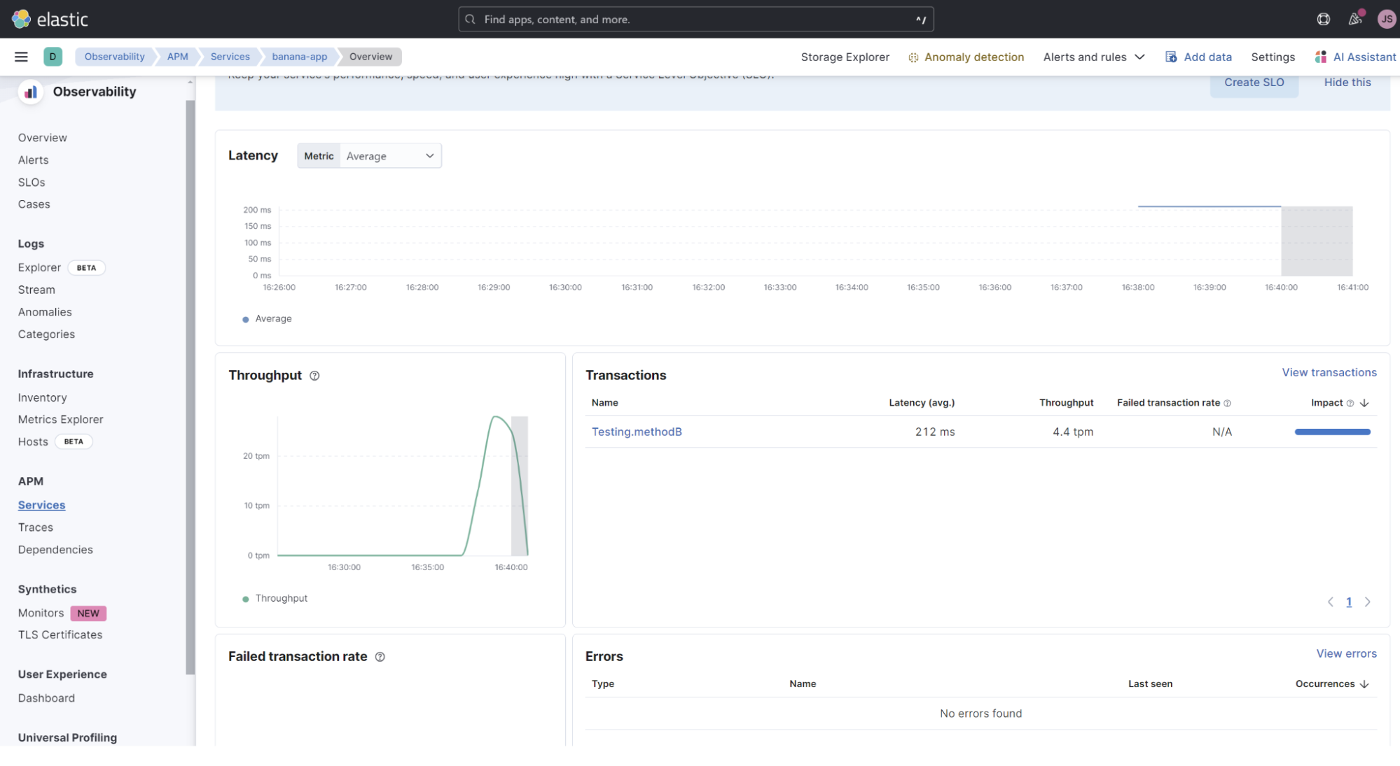

results in the app being auto-instrumented with no configuration changes! The resulting app shows up in any APM UI, such as Elastic APM
As you can see, for this example I also added this env var to the pod yaml, OTEL_INSTRUMENTATION_METHODS_INCLUDE="test.Testing[methodB]" so that there were traces showing from methodB.
