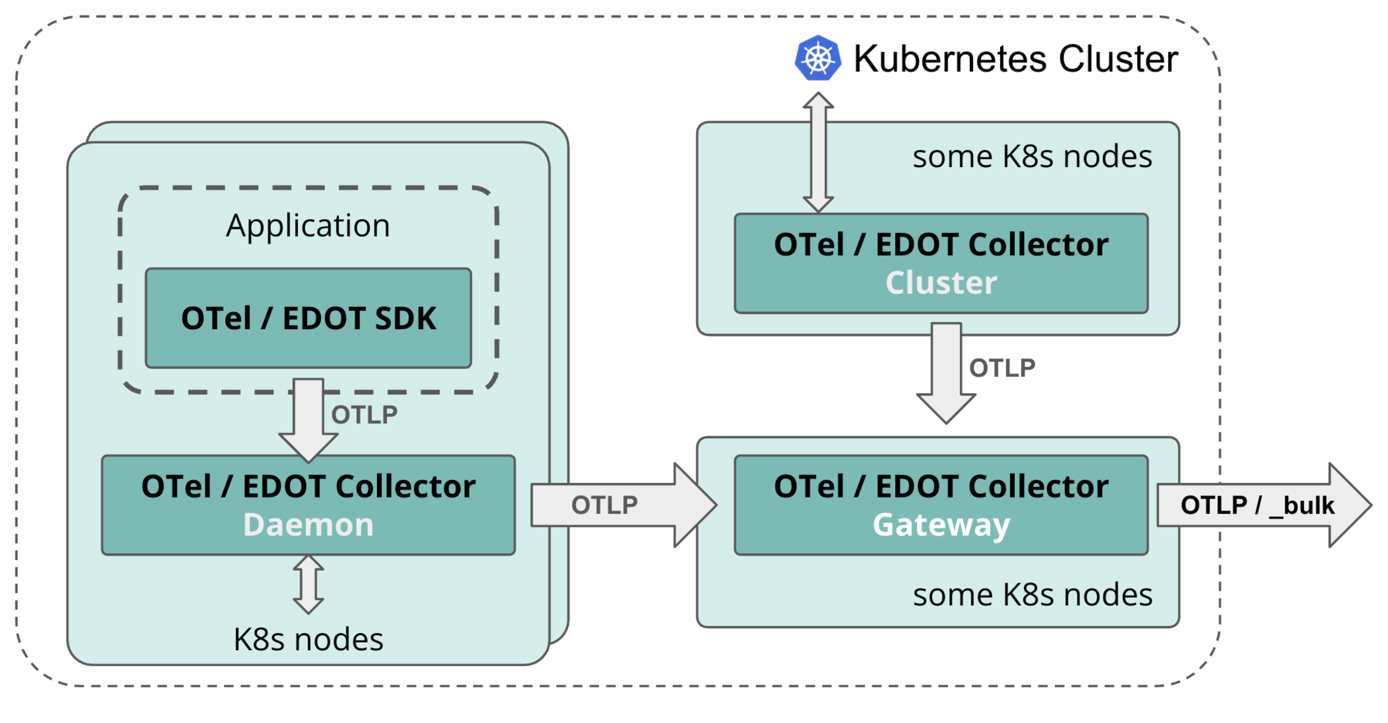

In a Kubernetes environment, EDOT components are typically installed via an OTel Operator and HELM chart. The main components are:
  • EDOT Collector Cluster: deployment used to collect cluster-wide metrics.
  • EDOT Collector Daemon: daemonset used to collect node metrics, logs, and application telemetry data.
  • EDOT Collector Gateway: performs pre-processing, aggregation, and ingestion of data into Elastic.
Elastic provides a curated configuration file for all the EDOT components available as part of the the OpenTelemetry Operator using the opentelemetry-kube-stack Helm chart. Downloadable from here.

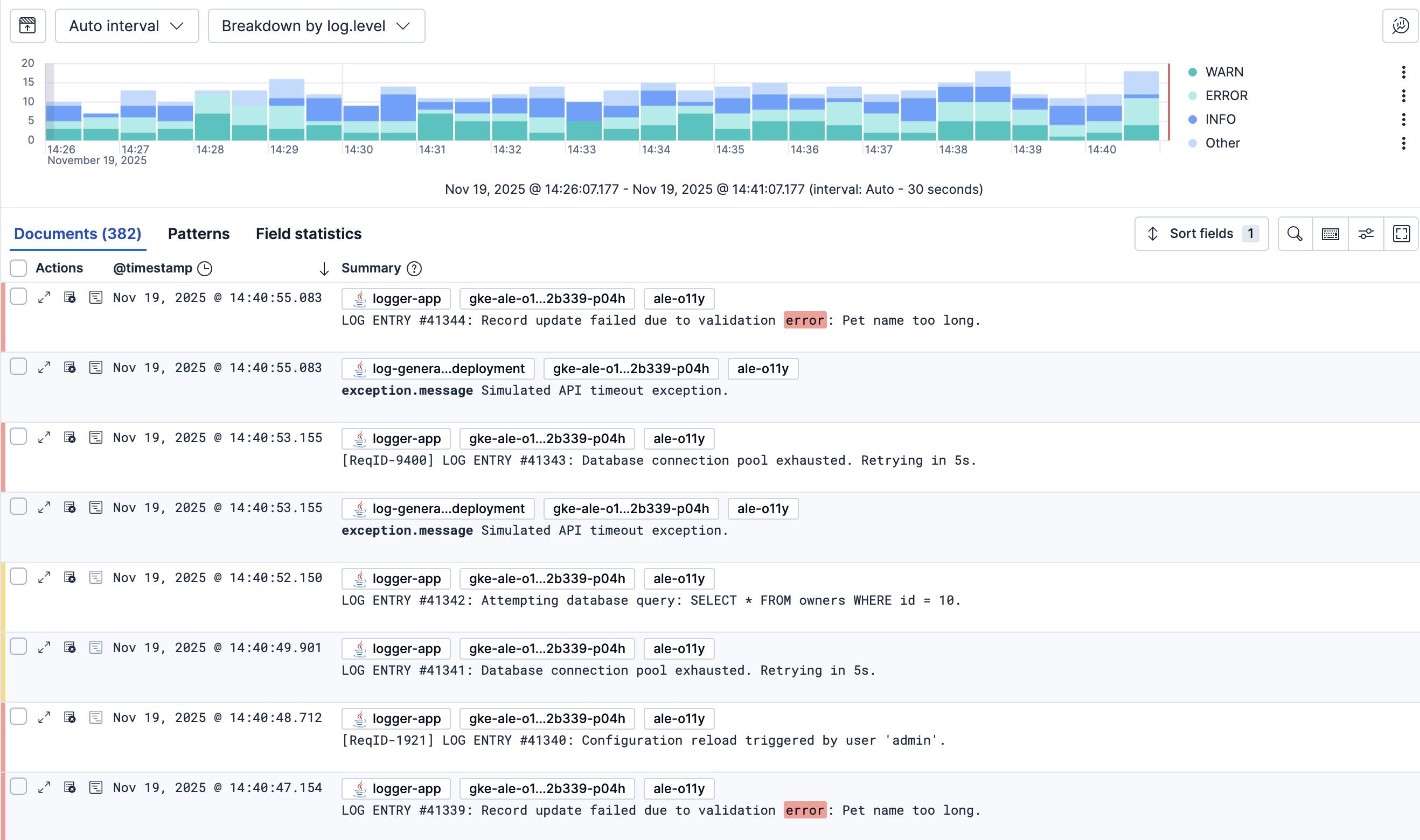

Sending data to Elasticsearch
If you are running Elastic Serverless or the latest Elastic Cloud Hosted (ECH) v9.2+, you now have access to a managed OTLP endpoint. This native functionality allows you to route telemetry directly from your Collector Gateway to Elasticsearch using the OTLP protocol.
Because we mapped our ECS fields to the OTel model in the collector, Elasticsearch recognizes the correlation immediately. You get the best of both worlds: Legacy Compatibility: Your old ECS-based dashboards still work (with minor tweaks). Modern Power: You can now click "View Trace" directly from a log entry in Kibana's Observability UI.
