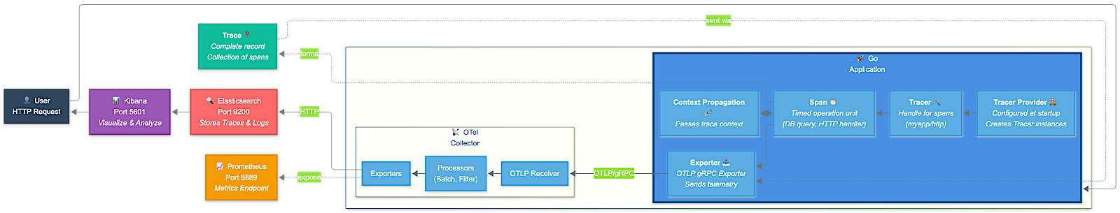

Understanding the OpenTelemetry Flow
Below, you will see the basic flow of your data when implementing observability with OTel in your system. Before we dive in, let’s explain some of the key terms within OTel. Let’s go over these base key players that we need to implement observability solutions with OTel:
  • Span: This is a single, timed unit of a distributed trace that can represent a specific operation, such as a database query or an HTTP handler.
  • Trace: This is a detailed record of a single request’s journey through your system, AKA a hierarchy of your spans.
  • Tracer: This is the handle for generating spans. You will typically have one per instrumentation library, for example myapp/http.
  • Tracer Provider: This is the cornerstone of the SDK. This creates Tracer instances, and you can configure it on application start up.
  • Context Propagation: The mechanism for passing trace context between operations and services, maintaining the relationship between parent and child spans.
  • Exporter: This is the part that is responsible for sending your telemetry data to a vendor backend, and you can decide if you are sending it to the OTel Collector, EDOT Collector or an OTLP Endpoint.

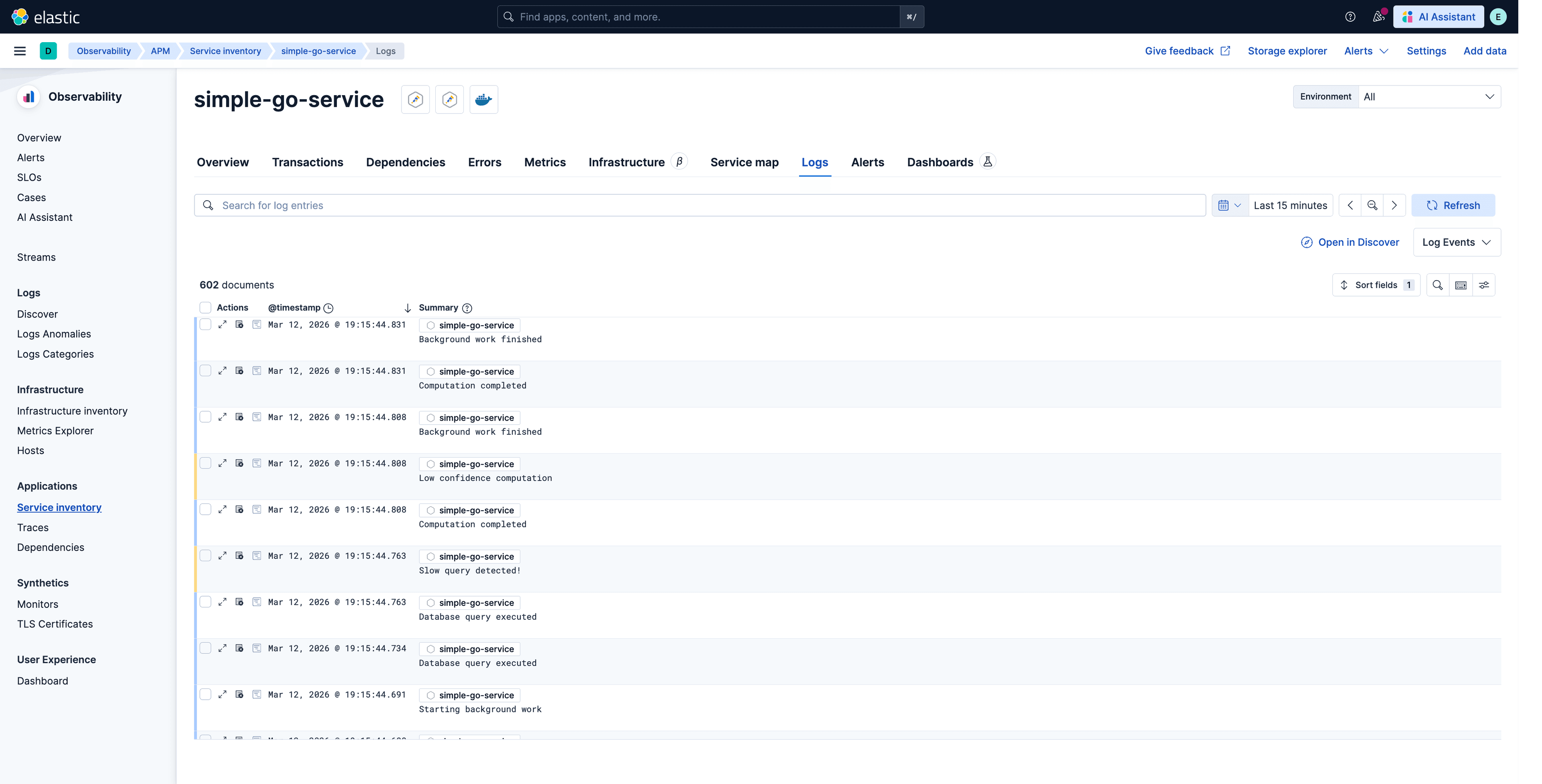

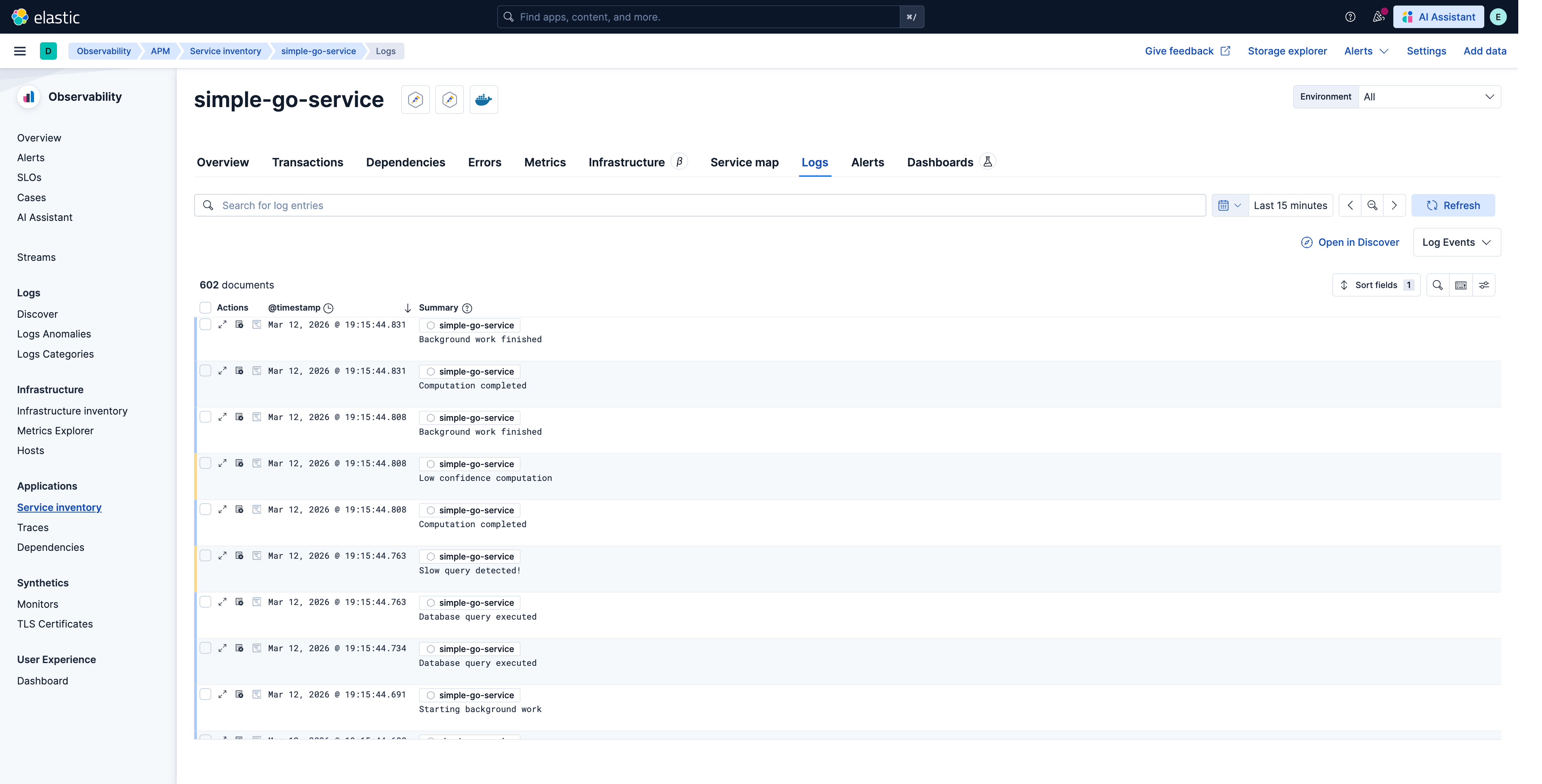

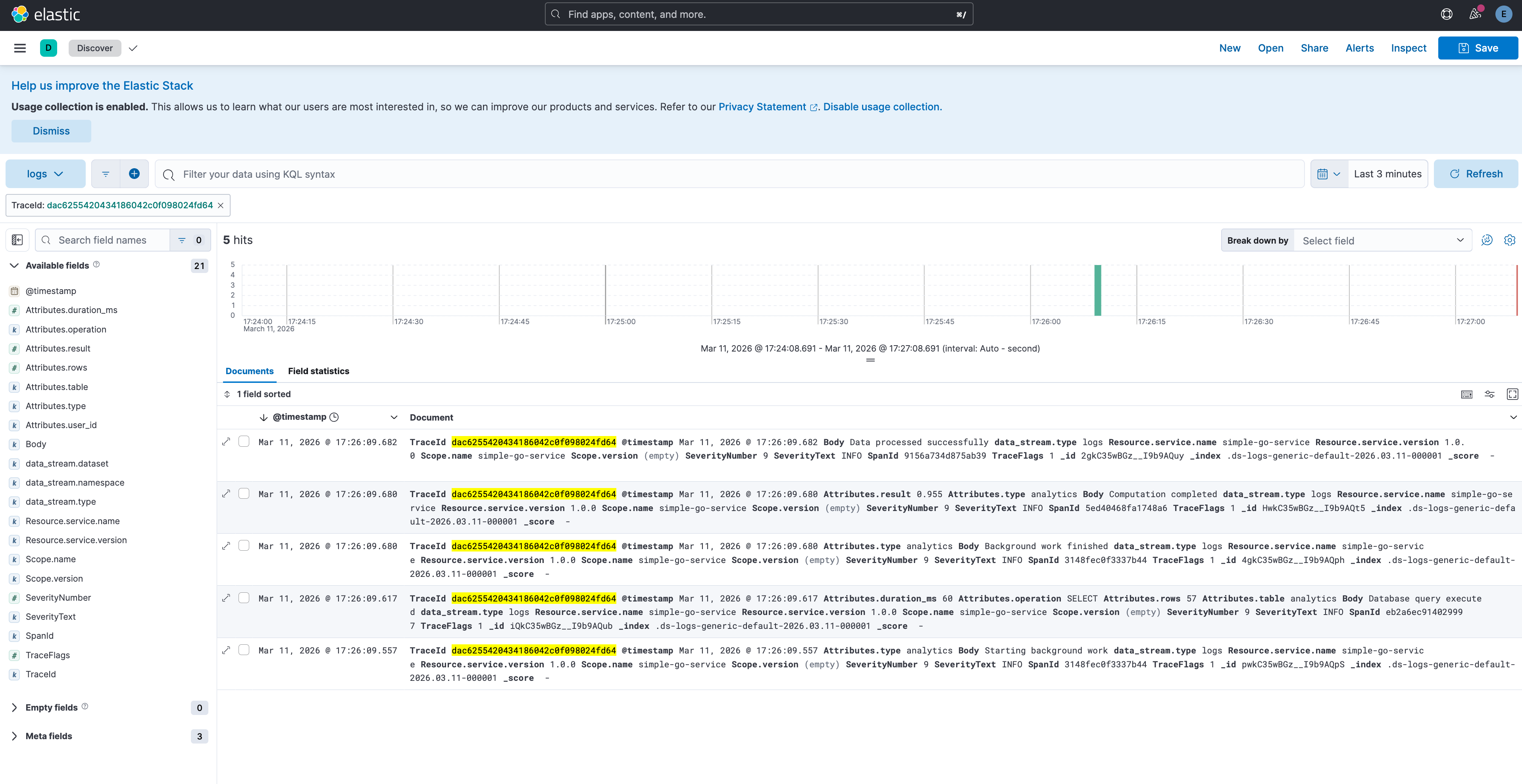

Below you can see how you can view your logs through Kibana in the APM UI. These logs are also color - coordinated; Coded warnings are in yellow, errors are in red, and regular logs are in green.

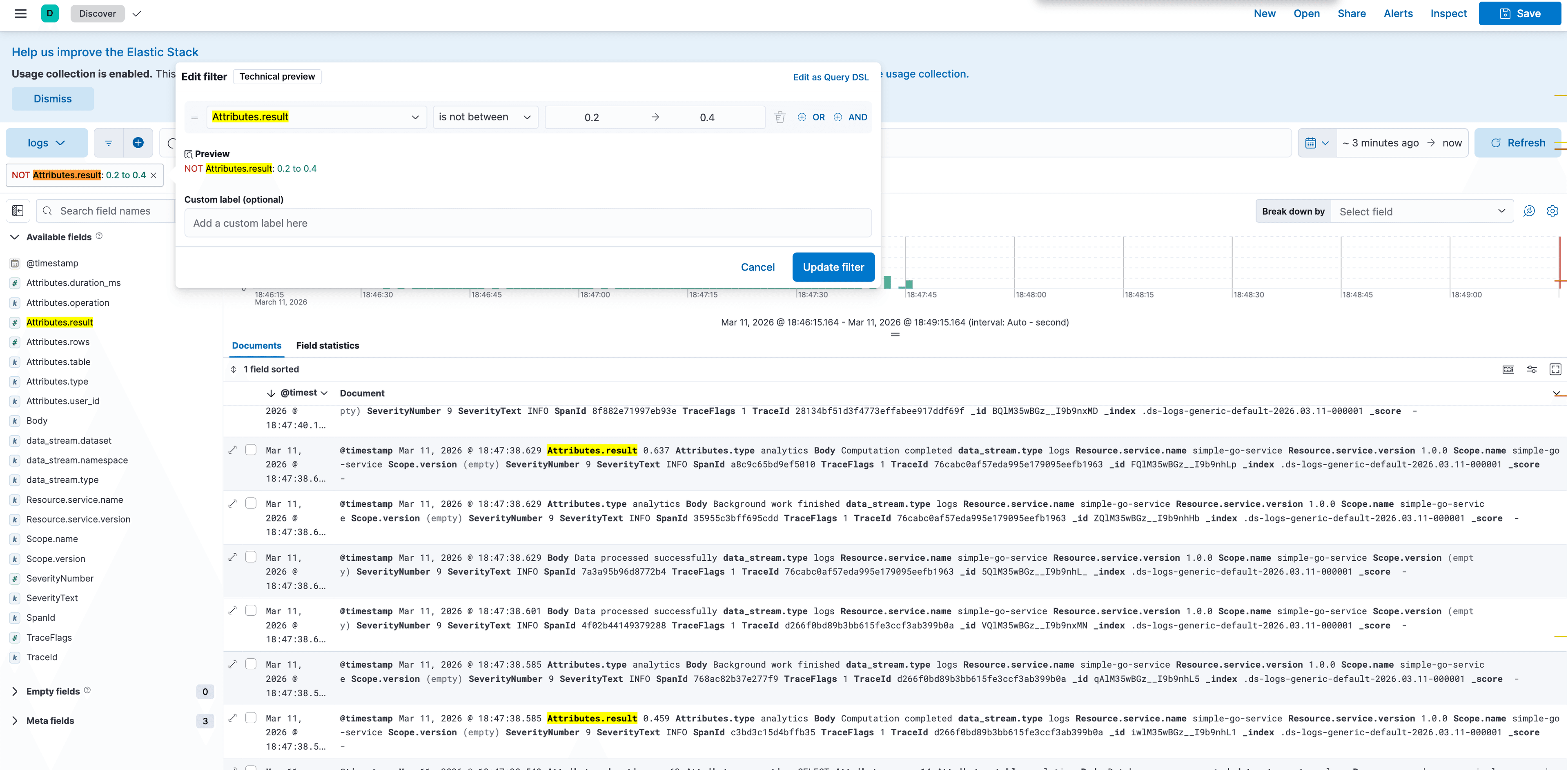

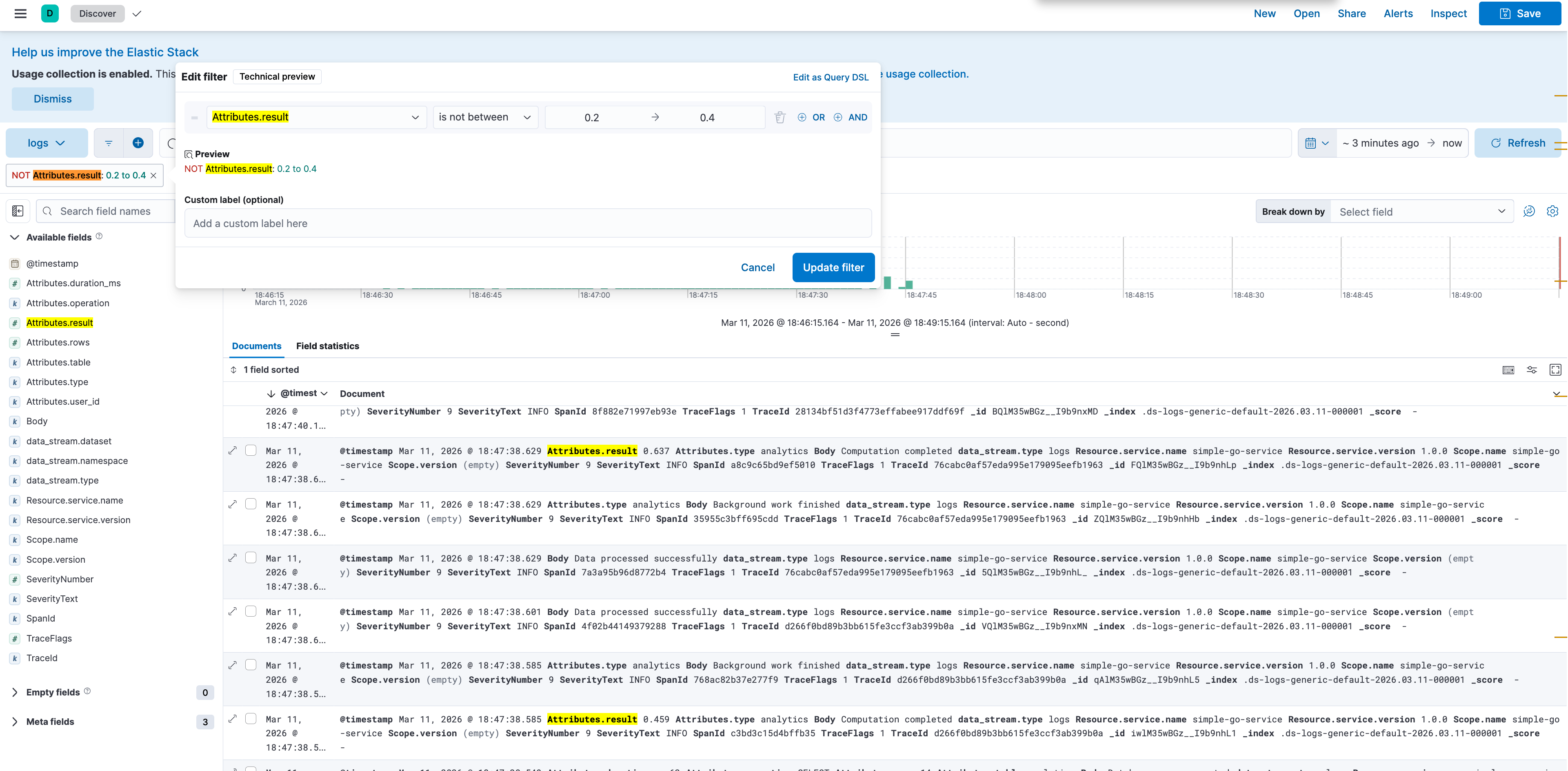

The attributes set above become searchable and filterable in our Elastic Observability backend, allowing for attribute filtering by attribute.result and attribute.compType. If you query your data with “show me all computations where results are less than 0.3,” then you will notice the span event span.AddEvent(“Low confidence result”) tacked on with a timestamped marker. This appears on your trace timeline as well, adding even more visibility to any unusual events. Below is a small example of the filtering that Kibana can accomplish from custom spans.

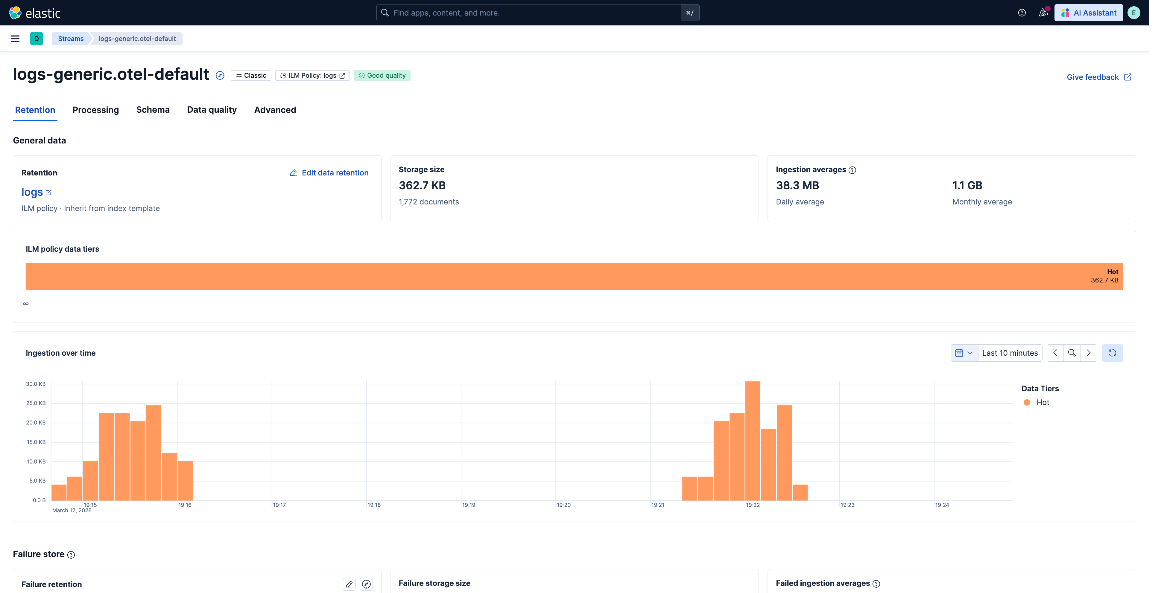

Elastic Observability, utilizing Kibana and Streams, has native support for the OTLP Endpoint through the EDOT Collector, which was used in this project. Below, you can see that your data is automatically connected to Streams from the beginning, requiring no extra leg work! You can add conditions or any Grok processors as your data is streaming in, and you'll be able to instantly see your data's schema and data quality.
Elastic also provides the Elastic Cloud Managed Endpoint for even easier storage, data-processing, and scaling. If you use this Managed Endpoint, it means that you can configure OpenTelemetry to send data directly to Elasticsearch, without ANY specialized Collectors. Any way you choose, once your traces are flowing, Kibana’s APM UI provides powerful visualization and analysis capabilities will be everything you need to debug your code. You are able to drill down into individual requests, identify bottlenecks, find anomalies and troubleshoot any issues that arise with confidence.

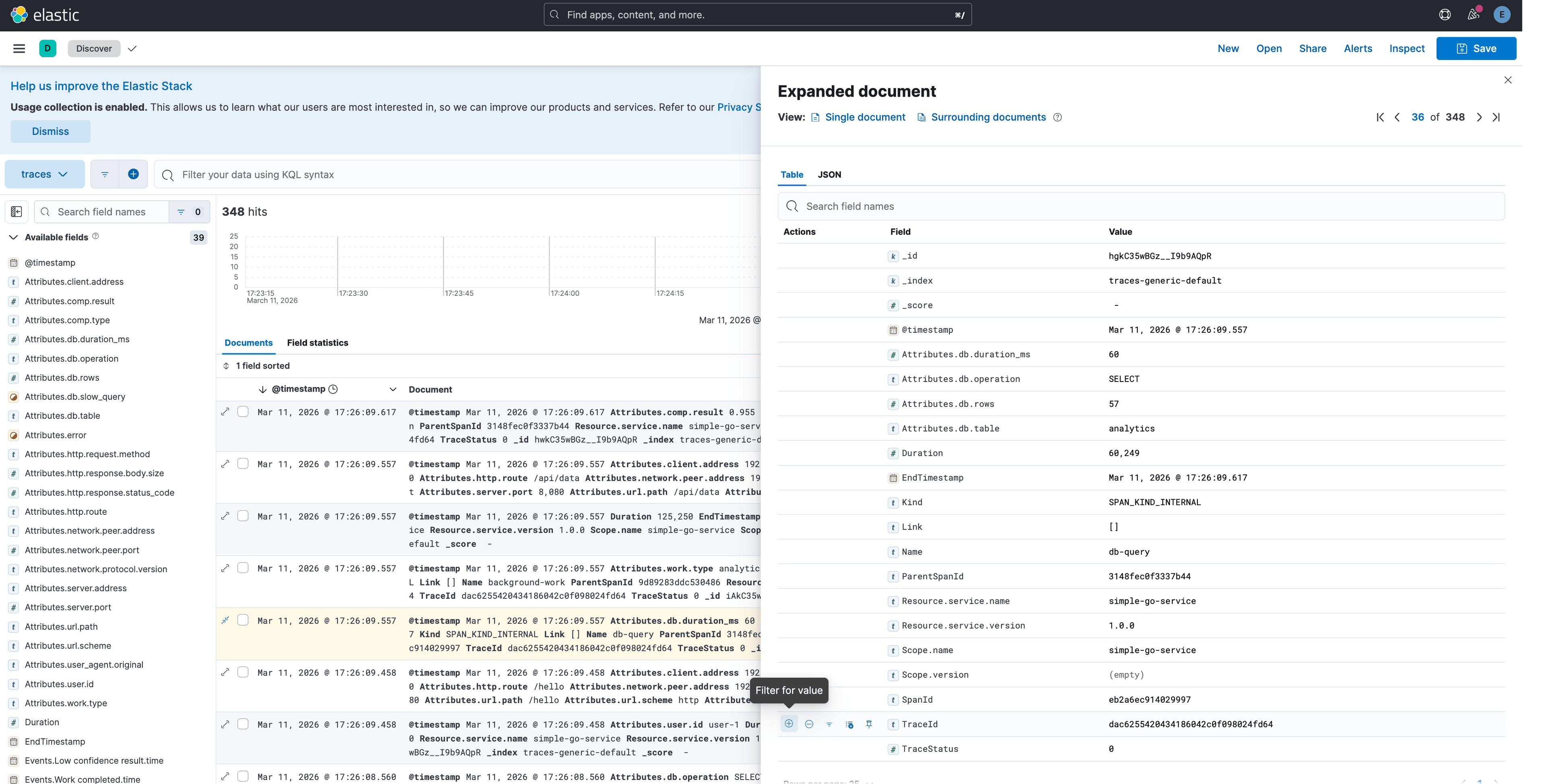

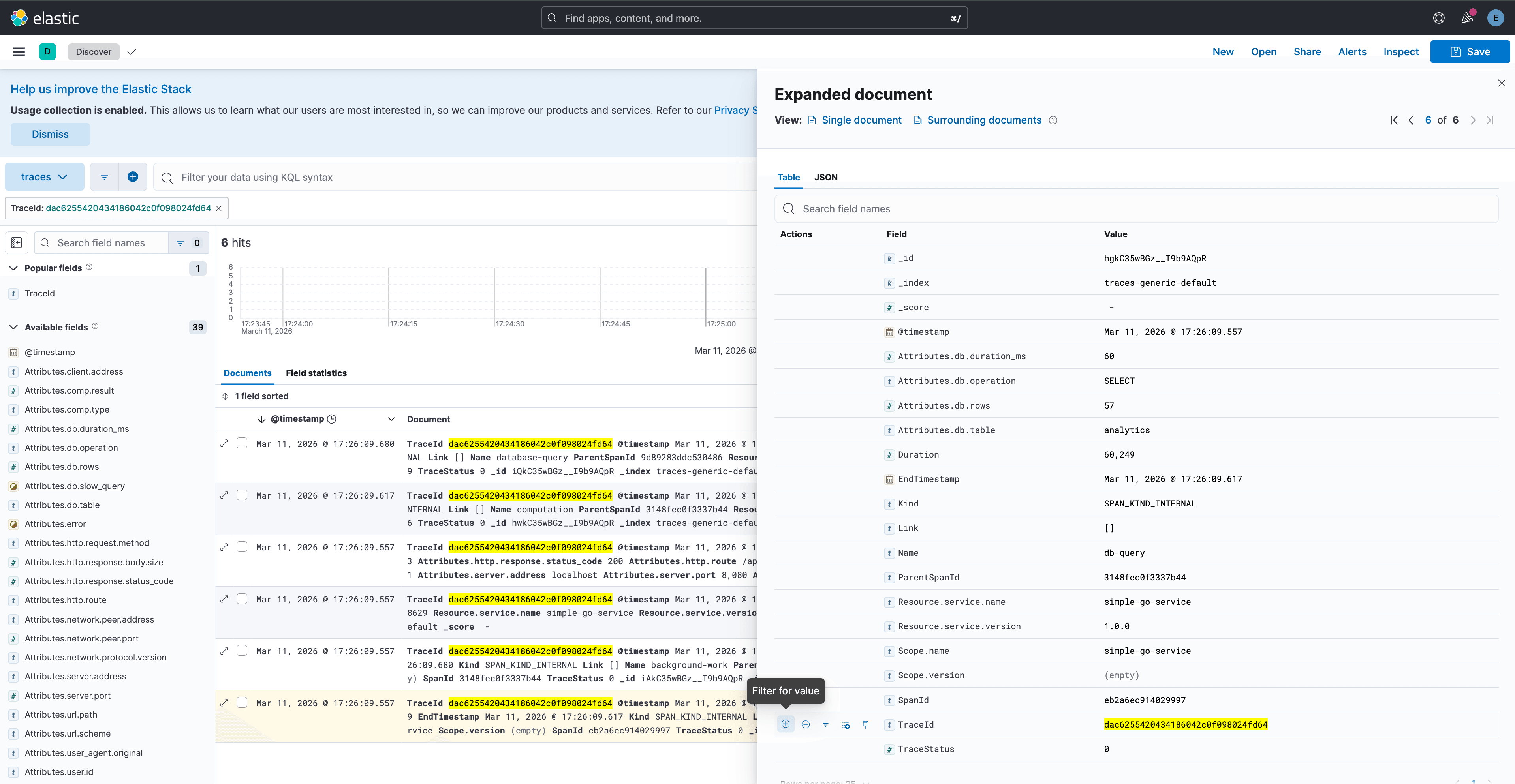

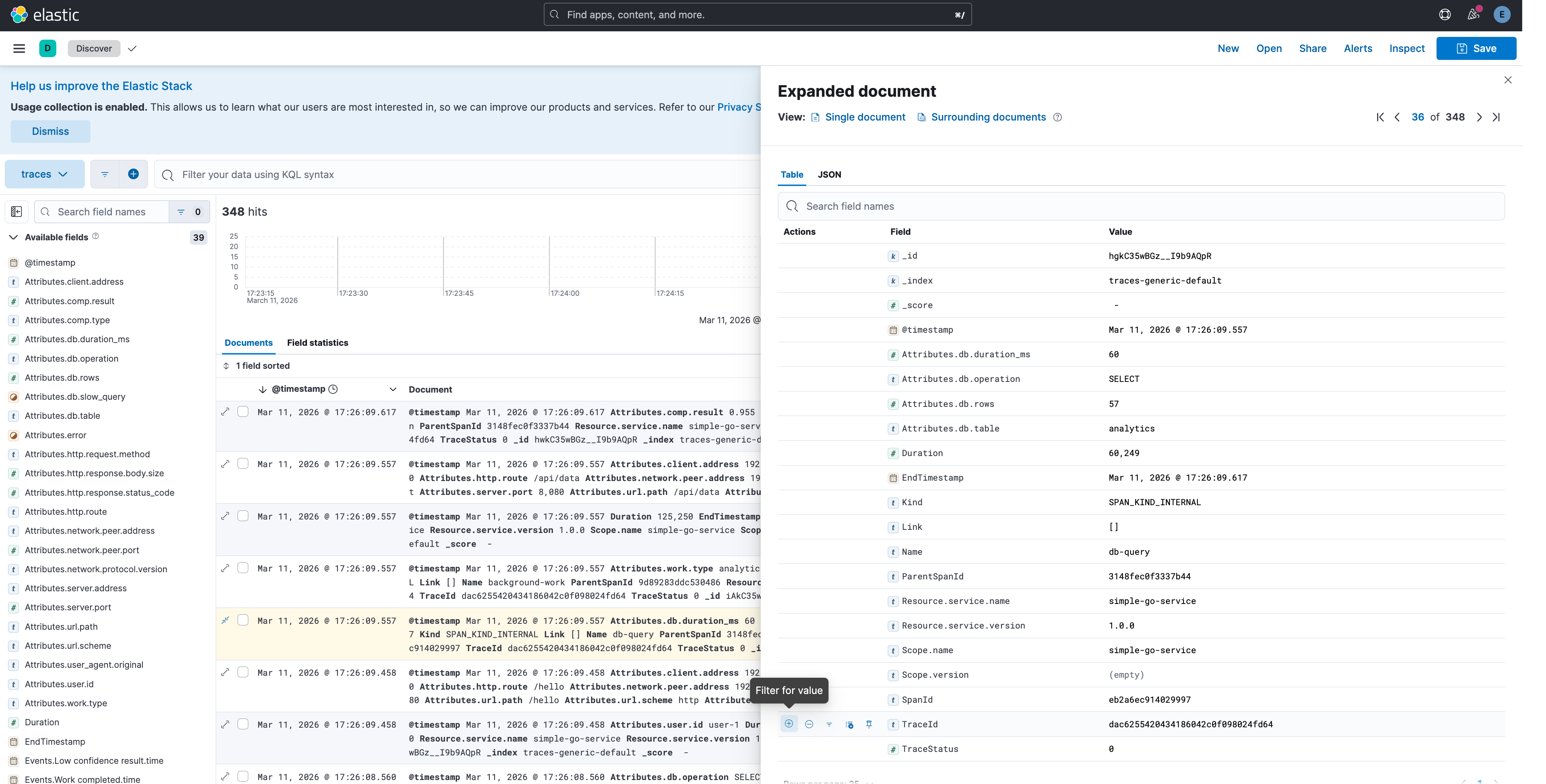

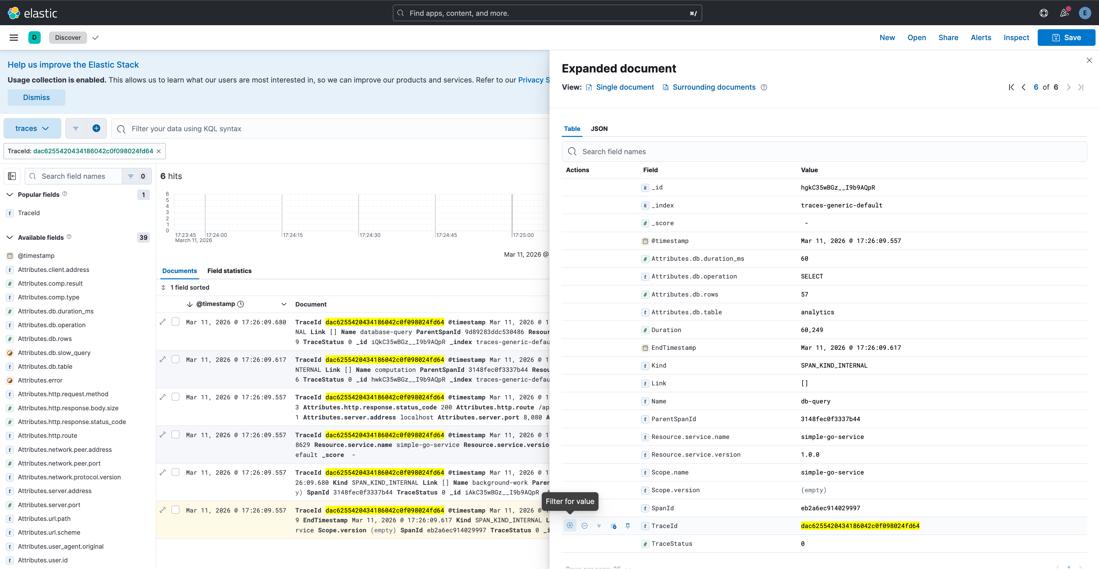

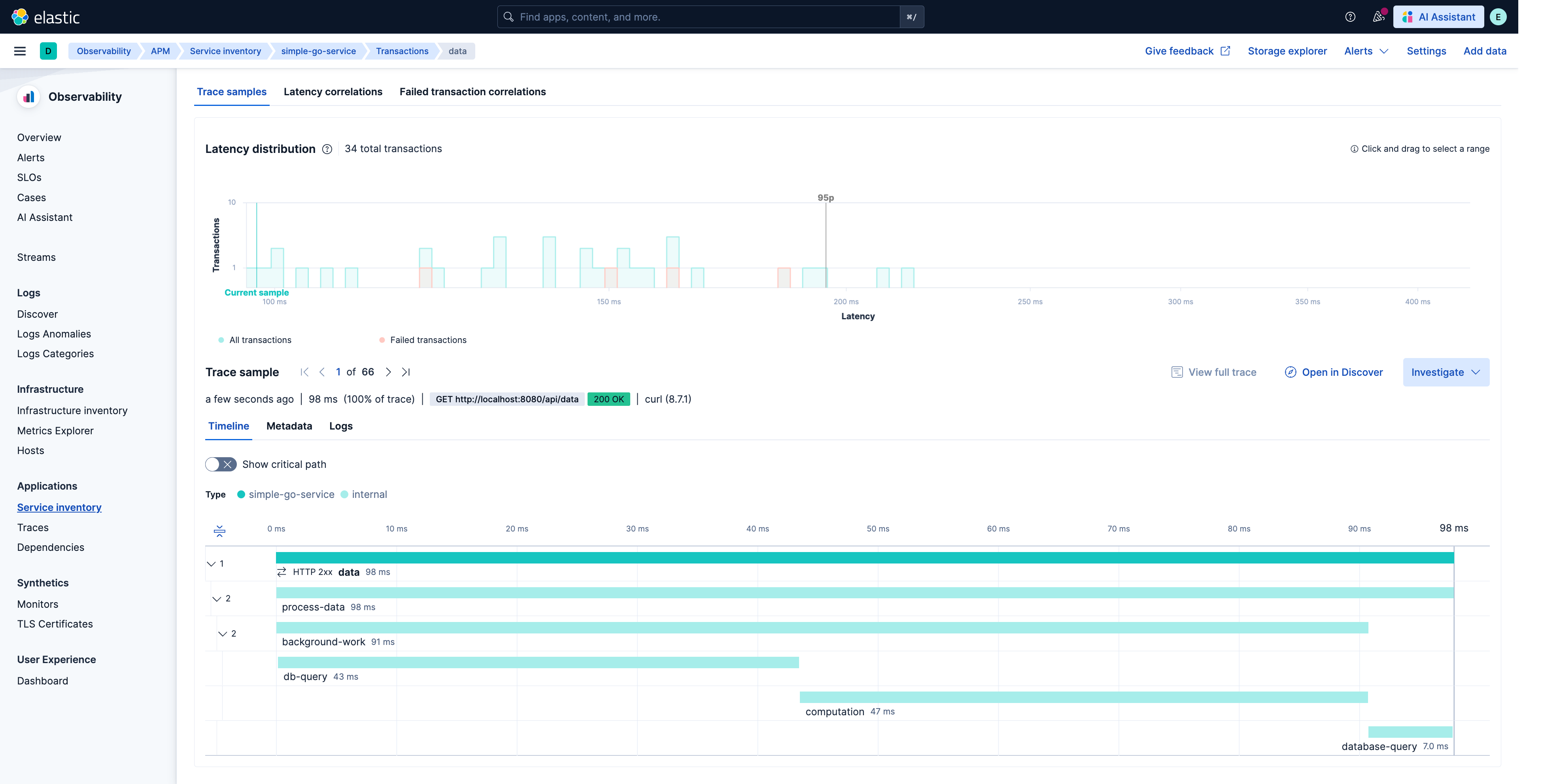

Here is one span of interest from this repository. Within Kibana, you can immediately filter by the Trace ID, finding other spans with the same Trace ID to visually see the entire trace.
Kibana Discover also allows you to switch indices instantly without losing your filters, ensuring that you can also see the logs that correspond with the same Trace ID.
In addition to the manually checking your traces, you can automatically check them within the APM UI (shown below). This is easy trace visualization using the Kibana APM UI is readily available while using the elasticapm connector. Below is a visualization of a trace comprised of spans within our project. Knowing both methods of correlating spans is beneficial to build the foundation of utilizing Kibana and the APM UI for observability.

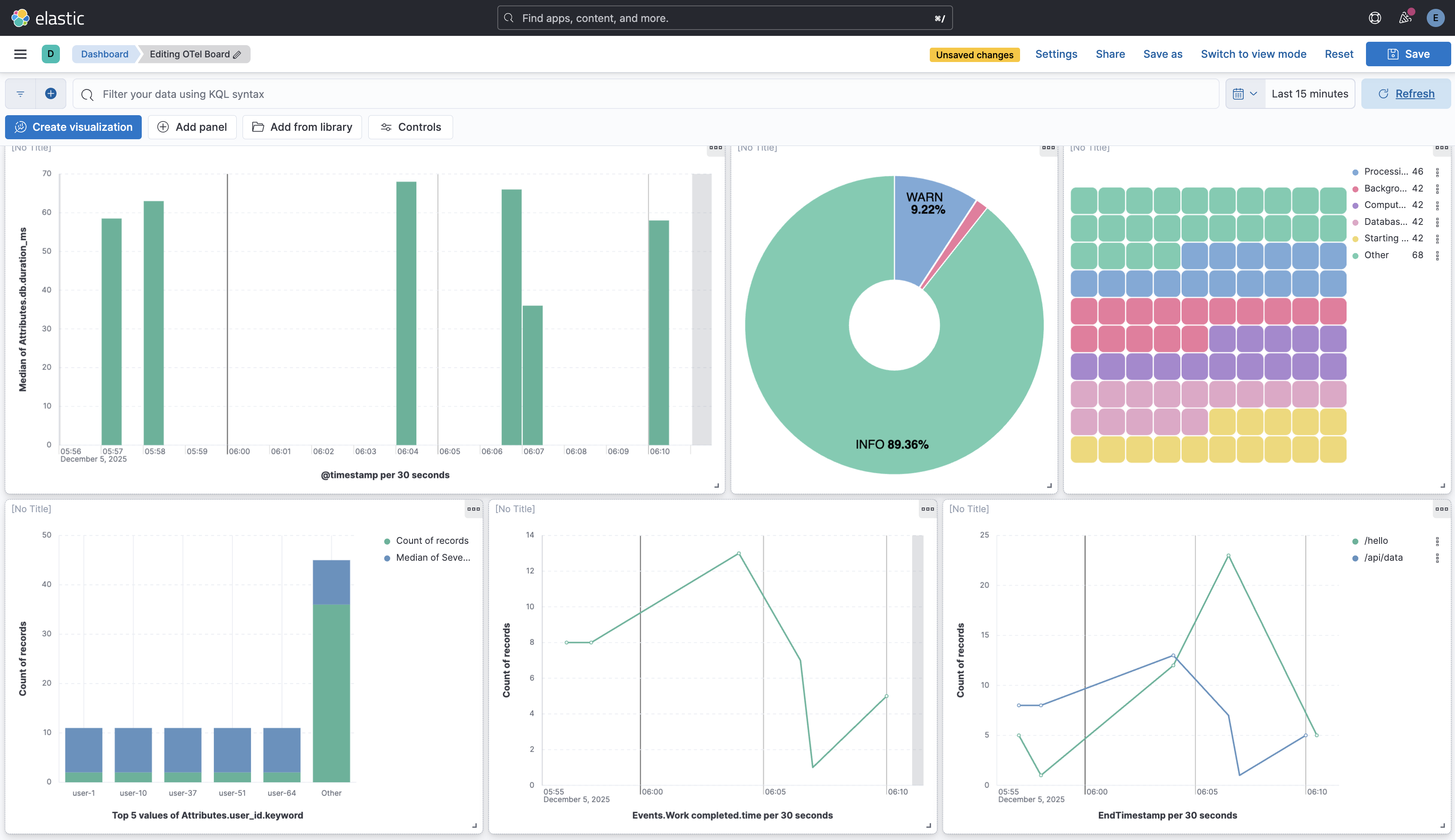

Here is a fully built out dashboard built from the repository featured in this article. The possibilities with Elastic Observability are endless!
