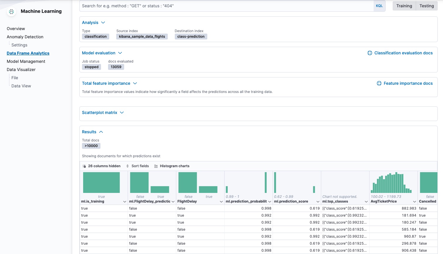

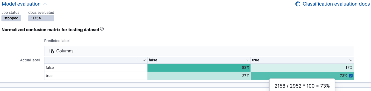

6. Evaluate and interpret the resultedit
Using the data frame analytics features to gain insights from a data set is an iterative process. After you defined the problem you want to solve, and chose the analytics type that can help you to do so, you need to produce a high-quality data set and create the appropriate data frame analytics job. You might need to experiment with different configurations, parameters, and ways to transform data before you arrive at a result that satisfies your use case. A valuable companion to this process is the evaluate data frame analytics API, which enables you to evaluate the data frame analytics performance. It helps you understand error distributions and identifies the points where the data frame analytics model performs well or less trustworthily.
To evaluate the analysis with this API, you need to annotate your index that contains the results of the analysis with a field that marks each document with the ground truth. The evaluate data frame analytics API evaluates the performance of the data frame analytics against this manually provided ground truth.
You can measure how well the model has performed on your training data set by using the classification evaluation type of the evaluate data frame analytics API or by viewing the job results in Kibana. The classification evaluation offers the following metrics to evaluate the model performance:

Multiclass confusion matrixedit
The multiclass confusion matrix provides a summary of the performance of the classification analysis. It contains the number of occurrences where the analysis classified data points correctly with their actual class as well as the number of occurrences where it misclassified them.
This is an example of a confusion matrix for a binary problem:
Confusion matrix of a binary problem
It is a two by two matrix because there are only two classes (true and false). It shows the proportion of data points that is correctly identified as members of a each class and the proportion that is misidentified.

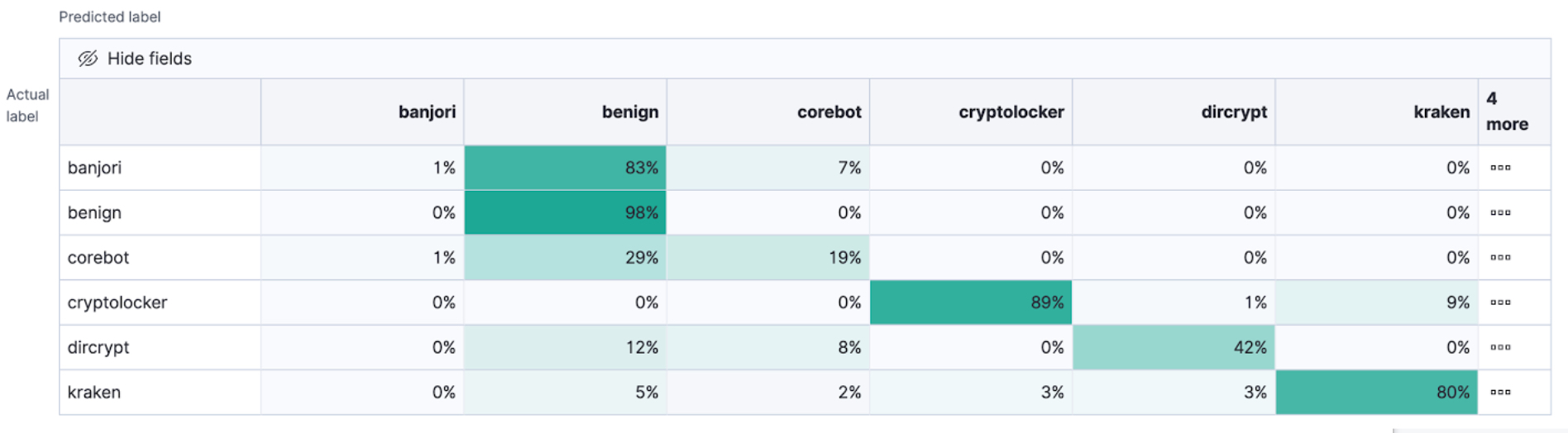

As the number of classes increases, the confusion matrix becomes more complex:
Confusion matrix of a multiclass problem
This matrix contains the actual labels on the left side while the predicted labels are on the top. The proportion of correct and incorrect predictions is broken down for each class. This enables you to examine how the classification analysis confused the different classes while it made its predictions.

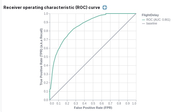

Area under the curve of receiver operating characteristic (AUC ROC)edit
The receiver operating characteristic (ROC) curve is a plot that represents the performance of the classification process at different predicted probability thresholds. It compares the true positive rate for a specific class against the rate of all the other classes combined ("one versus all" strategy) at the different threshold levels to create the curve.
For example, there are three classes: A, B, and C, and AUC ROC is calculated for A. In this case, the number of correctly classified As (true positives) are compared to the number of Bs and Cs that are misclassified as As (false positives).
From this plot, you can compute the area under the curve (AUC) value, which is a number between 0 and 1. The higher the AUC, the better the model is at predicting As as As, in this case.
To use this evaluation method, you must set num_top_classes to -1 or a value greater than or equal to the total number of classes when you create the data frame analytics job.

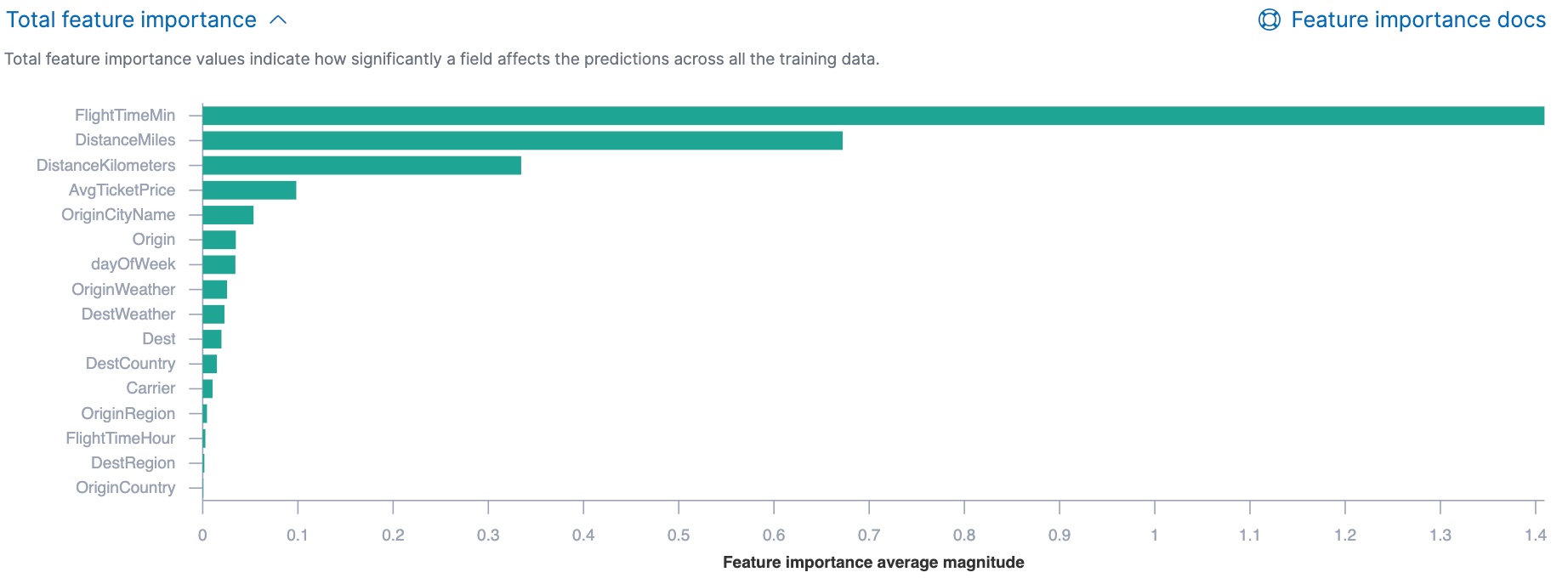

Feature importanceedit

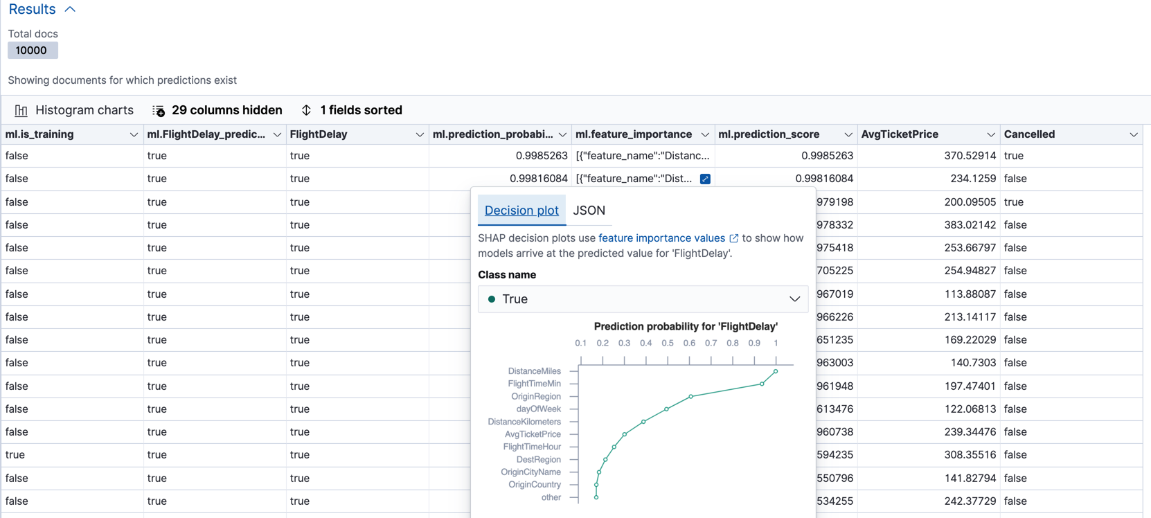

Feature importance provides further information about the results of an analysis and helps to interpret the results in a more subtle way. If you want to learn more about feature importance, refer to Feature importance.

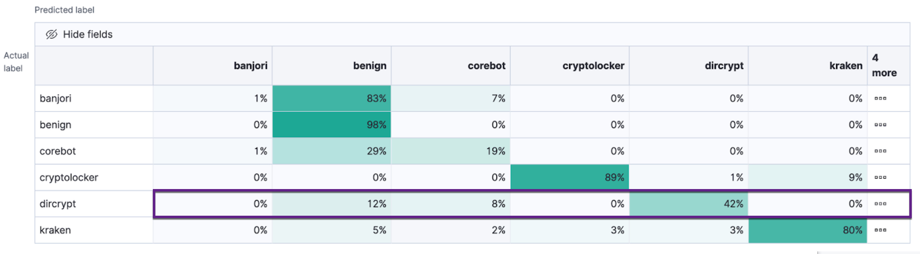

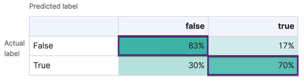

If your objective is to maximize accuracy, the scores are weighted to maximize the proportion of correct predictions in the training data set.
A confusion matrix with the correct predictions highlighted

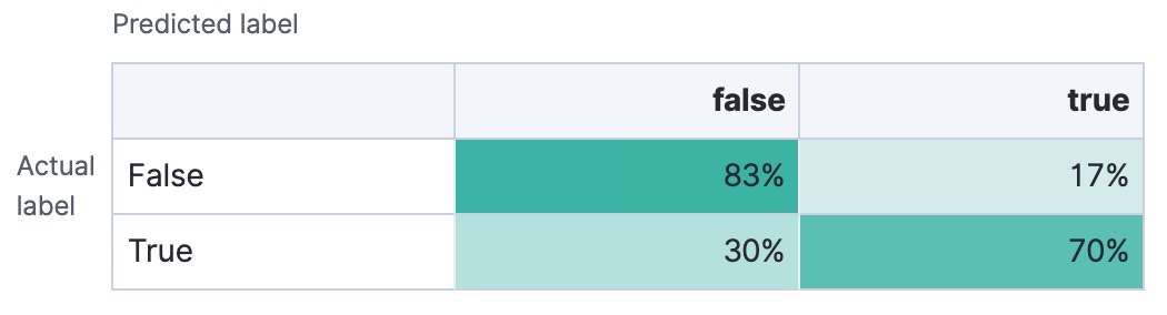

If there is an imbalanced class distribution in your training data, focusing on accuracy can decrease your model’s sensitivity to incorrect predictions in the under-represented classes.
By default, classification analysis jobs accept a slight degradation of the overall accuracy in return for greater sensitivity to classes that are predicted incorrectly. That is to say, their objective is to maximize the minimum recall. For example, in the context of a multi-class confusion matrix, the predictions of interest are in each row:
A confusion matrix with a row highlighted
For each class, the recall is calculated as the number of correct predictions divided by the sum of all the other predicted labels in that row. This value is represented as a percentage in each cell of the confusion matrix. The class scores are then weighted to favor predictions that result in the highest recall values across the training data. This objective typically performs better than accuracy when you have highly imbalanced data.

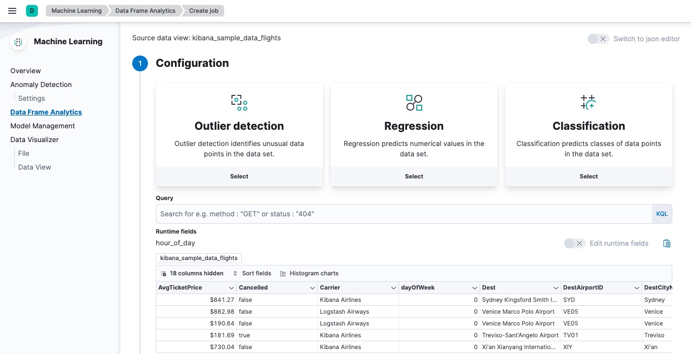

  1. Create a data frame analytics job.
    You can use the wizard on the Machine Learning > Data Frame Analytics tab in Kibana or the create data frame analytics jobs API.
    Creating a data frame analytics job in Kibana
    1. Choose kibana_sample_data_flights as the source index.
    2. Choose classification as the job type.

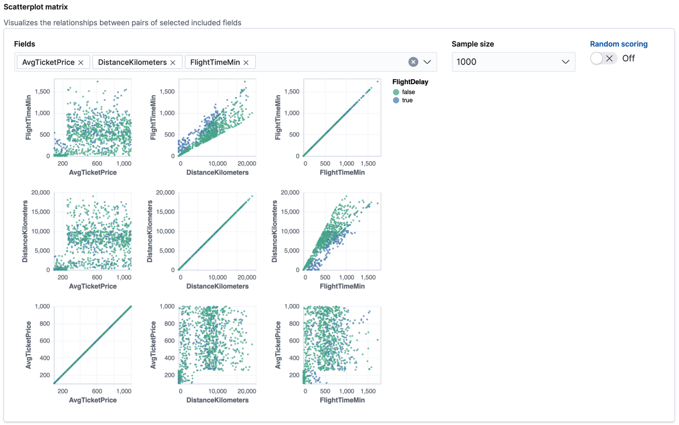

      The wizard includes a scatterplot matrix, which enables you to explore the relationships between the numeric fields. The color of each point is affected by the value of the dependent variable for that document, as shown in the legend. You can use this matrix to help you decide which fields to include or exclude.
      A scatterplot matrix for three fields in Kibana
      If you want these charts to represent data from a larger sample size or from a randomized selection of documents, you can change the default behavior. However, a larger sample size might slow down the performance of the matrix and a randomized selection might put more load on the cluster due to the more intensive query.

    6. If you want to experiment with feature importance, specify a value in the advanced configuration options. In this example, a maximum of 10 feature importance values per document will return. This option affects the speed of the analysis, so by default it is disabled.

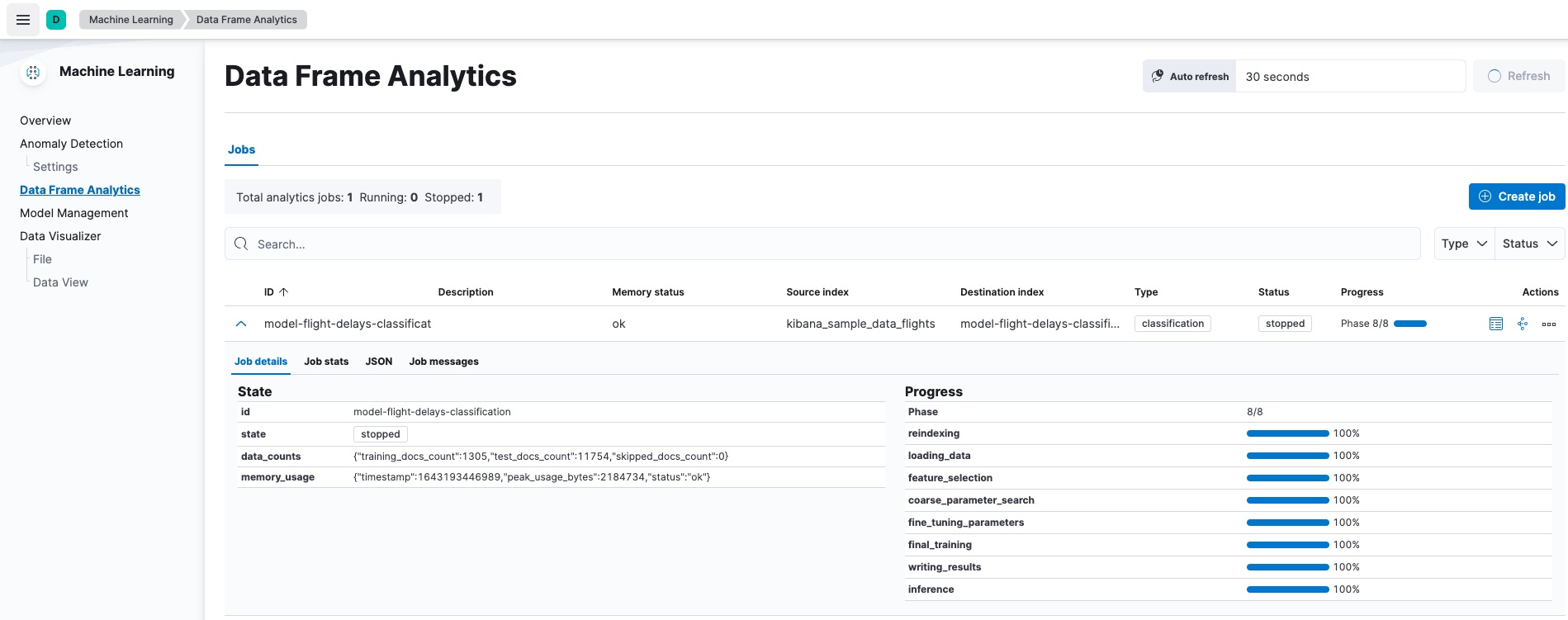

  3. Check the job stats to follow the progress in Kibana or use the get data frame analytics jobs statistics API.
    Statistics for a data frame analytics job in Kibana
    When the job stops, the results are ready to view and evaluate. To learn more about the job phases, see How data frame analytics jobs work.

Viewing classification resultsedit
Now you have a new index that contains a copy of your source data with predictions for your dependent variable.
When you view the classification results in Kibana, it shows the contents of the destination index in a tabular format. It also provides information about the analysis details, model evaluation metrics, total feature importance values, and a scatterplot matrix.
Destination index table for a classification job in Kibana
The table shows a column for the dependent variable (FlightDelay), which contains the ground truth values that you are trying to predict. It also shows a column for the predicted values (ml.FlightDelay_prediction), which were generated by the classification analysis. The ml.is_training column indicates whether the document was used in the training or testing data set. You can use the Training and Testing filter options to refine the contents of the results table. You can also enable histogram charts to get a better understanding of the distribution of values.
If you want to understand how certain the model is about each prediction, you can examine its probability and score (ml.prediction_probability and ml.prediction_score). The higher these values are, the more confident the model is that the data point belongs to the named class. If you examine the destination index more closely in the Discover app in Kibana or use the standard Elasticsearch search command, you can see that the analysis predicts the probability of all possible classes for the dependent variable. The top_classes object contains the predicted classes with the highest scores.
If you have a large number of classes, your destination index contains a large number of predicted probabilities for each document. When you create the classification job, you can use the num_top_classes option to modify this behavior.
API example
GET model-flight-delays-classification/_search
The snippet below shows the probability and score details for a document in the destination index:
          "FlightDelay" : false,
          "ml" : {
            "FlightDelay_prediction" : false,
            "top_classes" : [
                "class_name" : false,
                "class_probability" : 0.9427605087816684,
                "class_score" : 0.3462468700158476
                "class_name" : true,
                "class_probability" : 0.057239491218331606,
                "class_score" : 0.057239491218331606
            "prediction_probability" : 0.9427605087816684,
            "prediction_score" : 0.3462468700158476,
An array of values specifying the probability of the prediction and the score for each class.
The class with the highest score is the prediction. In this example, false has a class_score of 0.35 while true has only 0.06, so the prediction will be false. For more details about these values, see class_score.
If you chose to calculate feature importance, the destination index also contains ml.feature_importance objects. Every field that is included in the analysis (known as a feature of the data point) is assigned a feature importance value. It has both a magnitude and a direction (positive or negative), which indicates how each field affects a particular prediction. Only the most significant values (in this case, the top 10) are stored in the index. However, the trained model metadata also contains the average magnitude of the feature importance values for each field across all the training data. You can view this summarized information in Kibana:
Total feature importance values in Kibana
You can also see the feature importance values for each individual prediction in the form of a decision plot:
A decision plot for feature importance values in Kibana
In Kibana, the decision path shows the relative impact of each feature on the probability of the prediction. The features with the most significant positive or negative impact appear at the top of the decision plot. Thus in this example, the features related to flight time and distance had the most significant influence on the probability value for this prediction. This type of information can help you to understand how models arrive at their predictions. It can also indicate which aspects of your data set are most influential or least useful when you are training and tuning your model.
If you do not use Kibana, you can see the summarized feature importance values by using the get trained model API and the individual values by searching the destination index.

Lastly, Kibana provides a scatterplot matrix in the results. It has the same functionality as the matrix that you saw in the job wizard. Its purpose is to help you visualize and explore the relationships between the numeric fields and the dependent variable.
Evaluating classification resultsedit
Though you can look at individual results and compare the predicted value (ml.FlightDelay_prediction) to the actual value (FlightDelay), you typically need to evaluate the success of your classification model as a whole.
Kibana provides a normalized confusion matrix that contains the percentage of occurrences where the analysis classified data points correctly with their actual class and the percentage of occurrences where it misclassified them.
Evaluation of a classification job in Kibana
As the sample data may change when it is loaded into Kibana, the results of the analysis can vary even if you use the same configuration as the example. Therefore, use this information as a guideline for interpreting your own results.
If you want to see the exact number of occurrences, select a quadrant in the matrix. You can also use the Training and Testing filter options to refine the contents of the matrix. Thus you can see how well the model performs on previously unseen data. You can check how many documents are true in the testing data, how many of them are identified correctly (true positives) and how many of them are identified incorrectly as false (false negatives).
Likewise if you select other quadrants in the matrix, it shows the number of documents that have the false class as their actual value in the testing data. The matrix shows the number of documents that are correctly identified as false (true negatives) and the number of documents that are incorrectly predicted as true (false positives). When you perform classification analysis on your own data, it might take multiple iterations before you are satisfied with the results and ready to deploy the model.
Kibana also provides the receiver operating characteristic (ROC) curve as part of the model evaluation. The plot compares the true positive rate (y-axis) to the false positive rate (x-axis) for each class; in this example, true and false. From this plot, the area under the curve (AUC) value is computed. It is a number between 0 and 1. The higher the AUC, the better the model is at predicting the classes correctly.
Evaluation of a classification job in Kibana – ROC curve
You can also generate these metrics with the data frame analytics evaluate API. For more information about interpreting the evaluation metrics, see 6. Evaluate and interpret the result.
