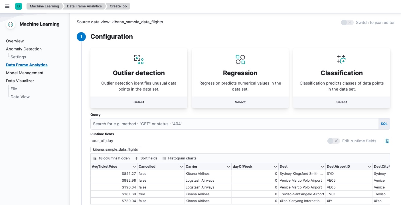

  1. Create a data frame analytics job.
    You can use the wizard on the Machine Learning > Data Frame Analytics tab in Kibana or the create data frame analytics jobs API.
    Creating a data frame analytics job in Kibana
    1. Choose kibana_sample_data_flights as the source index.
    2. Choose classification as the job type.

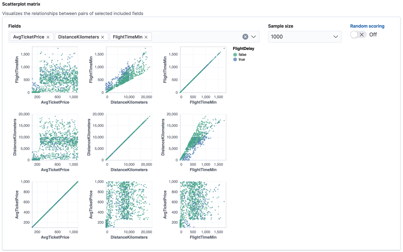

      The wizard includes a scatterplot matrix, which enables you to explore the relationships between the numeric fields. The color of each point is affected by the value of the dependent variable for that document, as shown in the legend. You can use this matrix to help you decide which fields to include or exclude.
      A scatterplot matrix for three fields in Kibana
      If you want these charts to represent data from a larger sample size or from a randomized selection of documents, you can change the default behavior. However, a larger sample size might slow down the performance of the matrix and a randomized selection might put more load on the cluster due to the more intensive query.

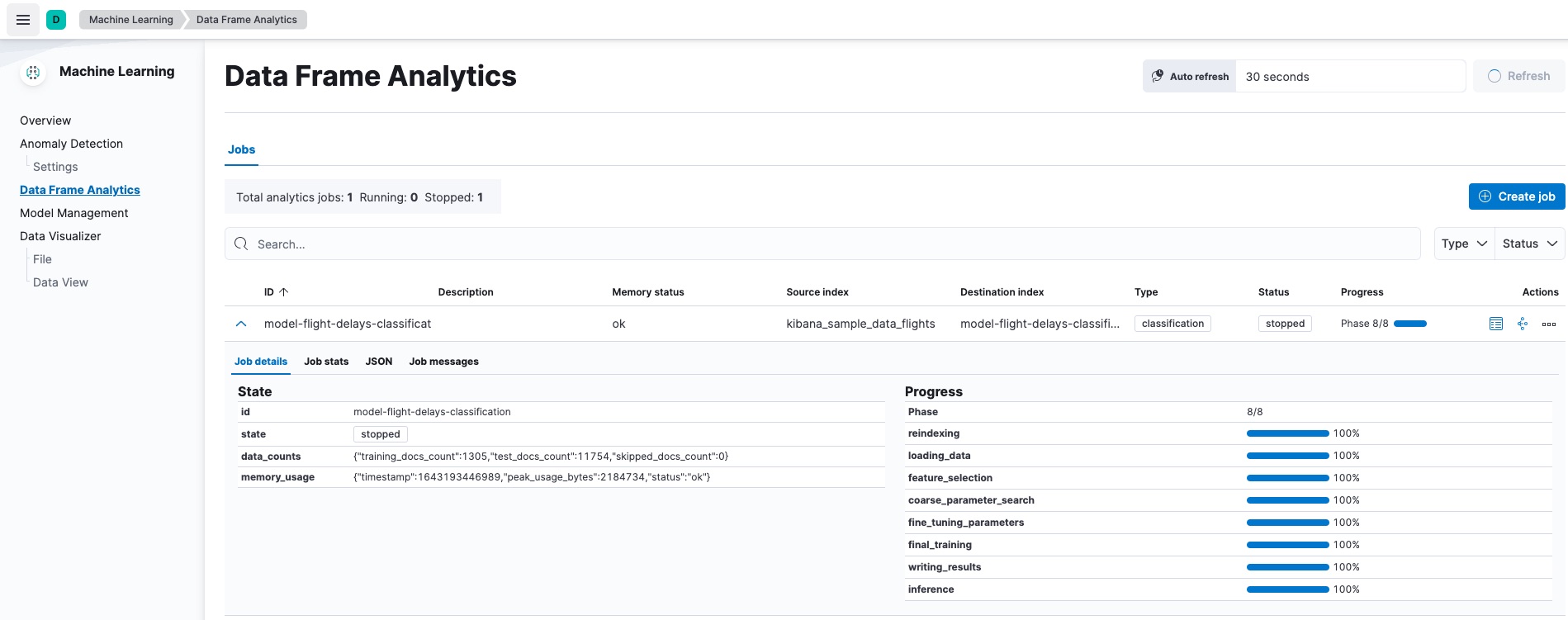

  2. Start the job in Kibana or use the start data frame analytics jobs API.
    The job takes a few minutes to run. Runtime depends on the local hardware and also on the number of documents and fields that are analyzed. The more fields and documents, the longer the job runs. It stops automatically when the analysis is complete.
    API example
    POST _ml/data_frame/analytics/model-flight-delays-classification/_start
  3. Check the job stats to follow the progress in Kibana or use the get data frame analytics jobs statistics API.
    Statistics for a data frame analytics job in Kibana
    When the job stops, the results are ready to view and evaluate. To learn more about the job phases, see How data frame analytics jobs work.

          "memory_usage" : {
            "timestamp" : 1597182490577,
            "peak_usage_bytes" : 316613,
            "status" : "ok"
          "analysis_stats" : {
            "classification_stats" : {
              "timestamp" : 1601405047110,
              "iteration" : 18,
              "hyperparameters" : {
                "class_assignment_objective" : "maximize_minimum_recall",
                "alpha" : 0.7633136599817167,
                "downsample_factor" : 0.9473152348018332,
                "eta" : 0.02331774683318904,
                "eta_growth_rate_per_tree" : 1.0143154178910303,
                "feature_bag_fraction" : 0.5504020748926737,
                "gamma" : 0.26389161802240446,
                "lambda" : 0.6309726978583623,
                "max_attempts_to_add_tree" : 3,
                "max_optimization_rounds_per_hyperparameter" : 2,
                "max_trees" : 894,
                "num_folds" : 5,
                "num_splits_per_feature" : 75,
                "soft_tree_depth_limit" : 4.672705943455812,
                "soft_tree_depth_tolerance" : 0.13448633124842999
                "timing_stats" : {
                  "elapsed_time" : 76459,
                  "iteration_time" : 1861
                "validation_loss" : {
                  "loss_type" : "binomial_logistic"

Lastly, Kibana provides a scatterplot matrix in the results. It has the same functionality as the matrix that you saw in the job wizard. Its purpose is to help you visualize and explore the relationships between the numeric fields and the dependent variable.
