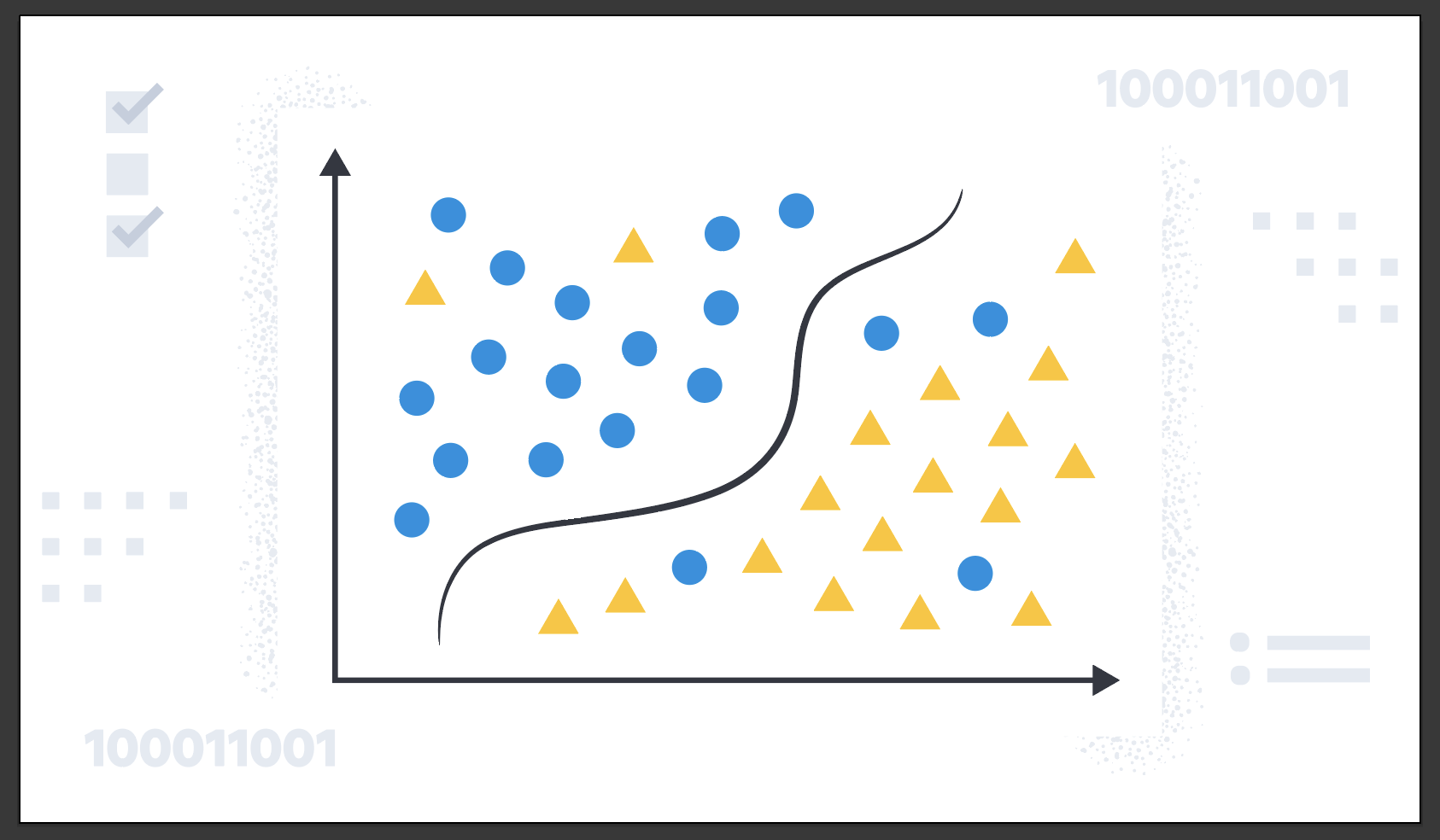

Predicting classes with classification
editPredicting classes with classification
editClassification is a machine learning process that predicts the class or category of a data point in a data set. For a simple example, consider how the shapes in the following graph can be differentiated and classified as "circles" and "triangles":
In reality, classification problems are more complex, such as classifying malicious and benign domains to detect DGA activities for security reasons or predicting customer churn based on customer calling data. Classification is for predicting discrete, categorical values.
When you create a classification job, you must specify which field contains the classes that you want to predict. This field is known as the dependent variable. It can contain maximum 100 classes. By default, all other supported fields are included in the analysis and are known as feature variables. You can optionally include or exclude fields. For more information about field selection, refer to the explain data frame analytics API.

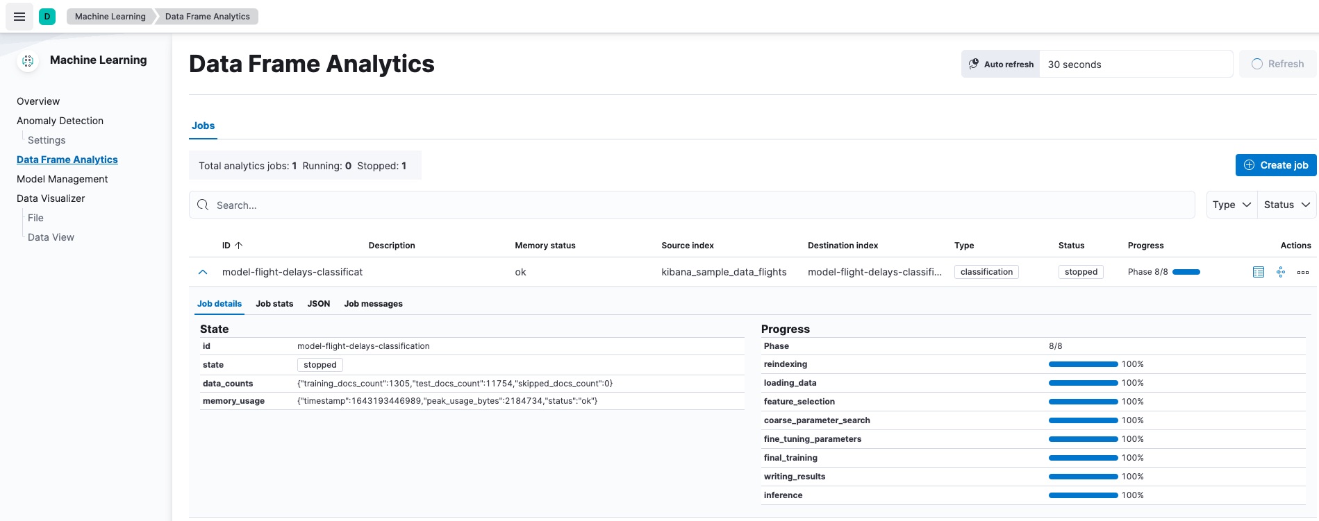

5. Start the job
editYou can start the job via Kibana or using the start data frame analytics jobs API. A classification job has the following phases:
reindexing: Documents are copied from the source index to the destination index. -
loading_data: The job fetches the necessary data from the destination index. -
feature_selection: The process identifies the most relevant analyzed fields for predicting the dependent variable. -
coarse_parameter_search: The process identifies initial values for undefined hyperparameters. -
fine_tuning_parameters: The process identifies final values for undefined hyperparameters. Refer to hyperparameter optimization. -
final_training: The model training occurs. -
writing_results: The job matches the results with the data rows in the destination index, merges them, and indexes them back to the destination index. -
inference: The job validates the trained model against the test split of the data set.

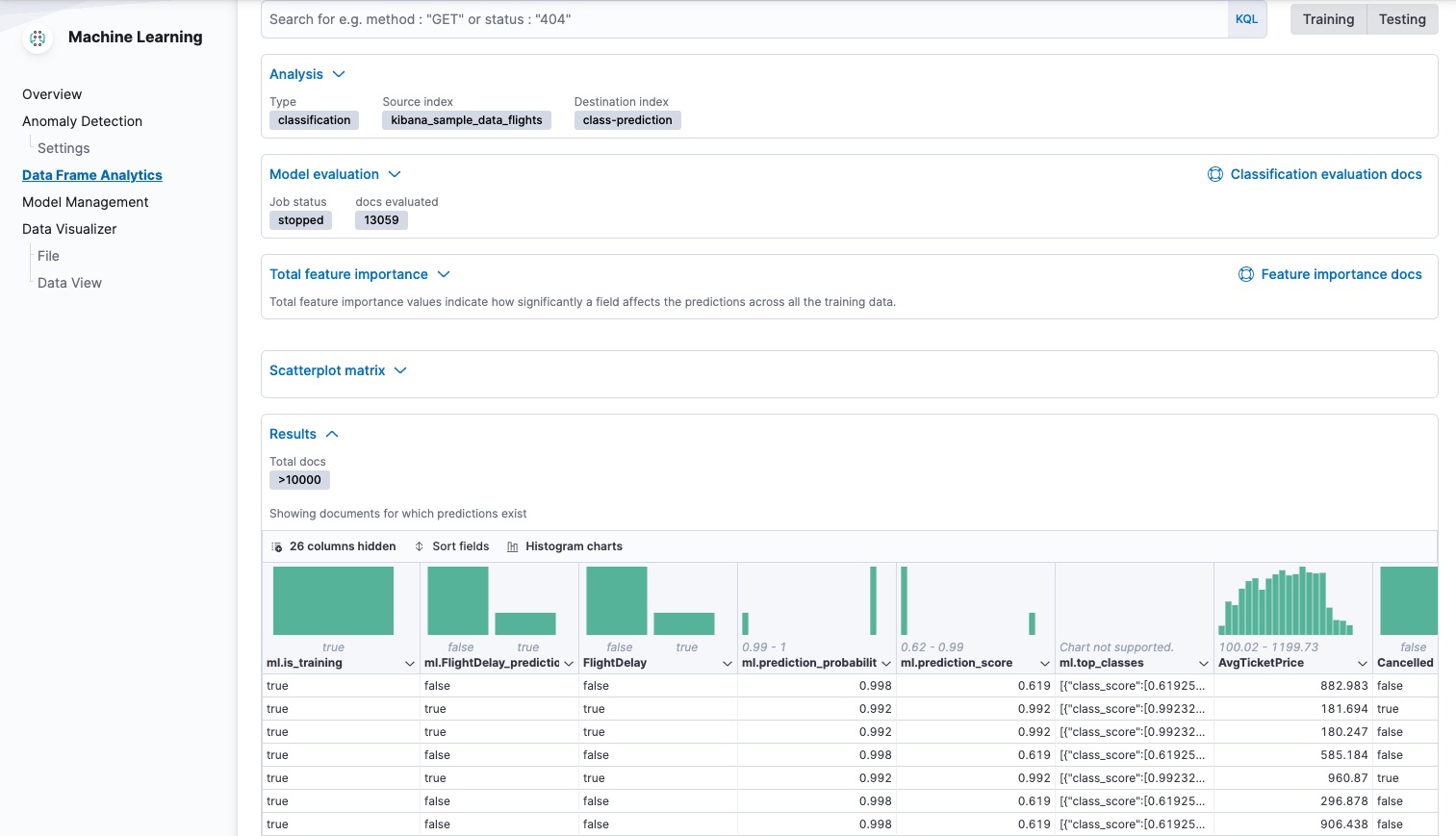

After the last phase is finished, the job stops and the results are ready for evaluation.
When you create a data frame analytics job, the inference step of the process might fail if the model is too large to fit into JVM. For a workaround, refer to this GitHub issue.

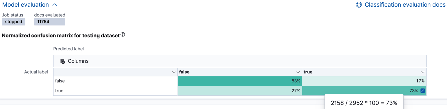

6. Evaluate and interpret the result
editUsing the data frame analytics features to gain insights from a data set is an iterative process. After you defined the problem you want to solve, and chose the analytics type that can help you to do so, you need to produce a high-quality data set and create the appropriate data frame analytics job. You might need to experiment with different configurations, parameters, and ways to transform data before you arrive at a result that satisfies your use case. A valuable companion to this process is the evaluate data frame analytics API, which enables you to evaluate the data frame analytics performance. It helps you understand error distributions and identifies the points where the data frame analytics model performs well or less trustworthily.
To evaluate the analysis with this API, you need to annotate your index that contains the results of the analysis with a field that marks each document with the ground truth. The evaluate data frame analytics API evaluates the performance of the data frame analytics against this manually provided ground truth.
You can measure how well the model has performed on your training data set by
using the classification evaluation type of the
evaluate data frame analytics API or by viewing the
job results in Kibana. The classification evaluation offers the following
metrics to evaluate the model performance:

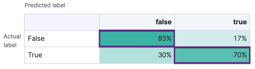

Multiclass confusion matrix

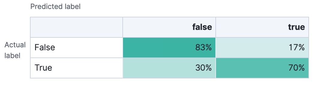

editThe multiclass confusion matrix provides a summary of the performance of the classification analysis. It contains the number of occurrences where the analysis classified data points correctly with their actual class as well as the number of occurrences where it misclassified them.
This is an example of a confusion matrix for a binary problem:
It is a two by two matrix because there are only two classes (true and
false). It shows the proportion of data points that is correctly identified as
members of a each class and the proportion that is misidentified.

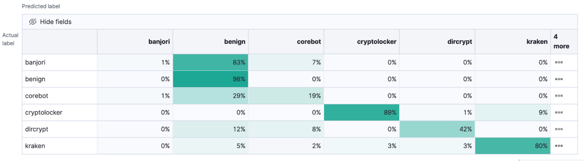

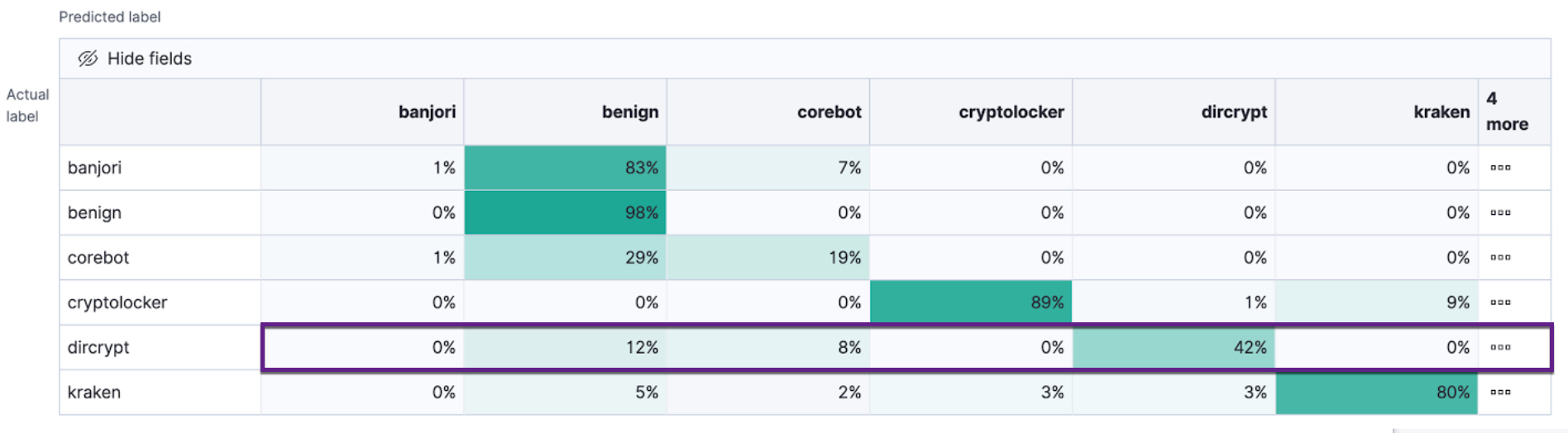

As the number of classes increases, the confusion matrix becomes more complex:
This matrix contains the actual labels on the left side while the predicted labels are on the top. The proportion of correct and incorrect predictions is broken down for each class. This enables you to examine how the classification analysis confused the different classes while it made its predictions.

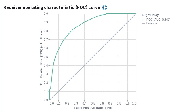

Area under the curve of receiver operating characteristic (AUC ROC)
editThe receiver operating characteristic (ROC) curve is a plot that represents the performance of the classification process at different predicted probability thresholds. It compares the true positive rate for a specific class against the rate of all the other classes combined ("one versus all" strategy) at the different threshold levels to create the curve.
For example, there are three classes: A, B, and C, and AUC ROC is
calculated for A. In this case, the number of correctly classified As
(true positives) are compared to the number of Bs and Cs that are
misclassified as As (false positives).
From this plot, you can compute the area under the curve (AUC) value, which is a
number between 0 and 1. The higher the AUC, the better the model is at
predicting As as As, in this case.
To use this evaluation method, you must set num_top_classes to -1
or a value greater than or equal to the total number of classes when you create
the data frame analytics job.

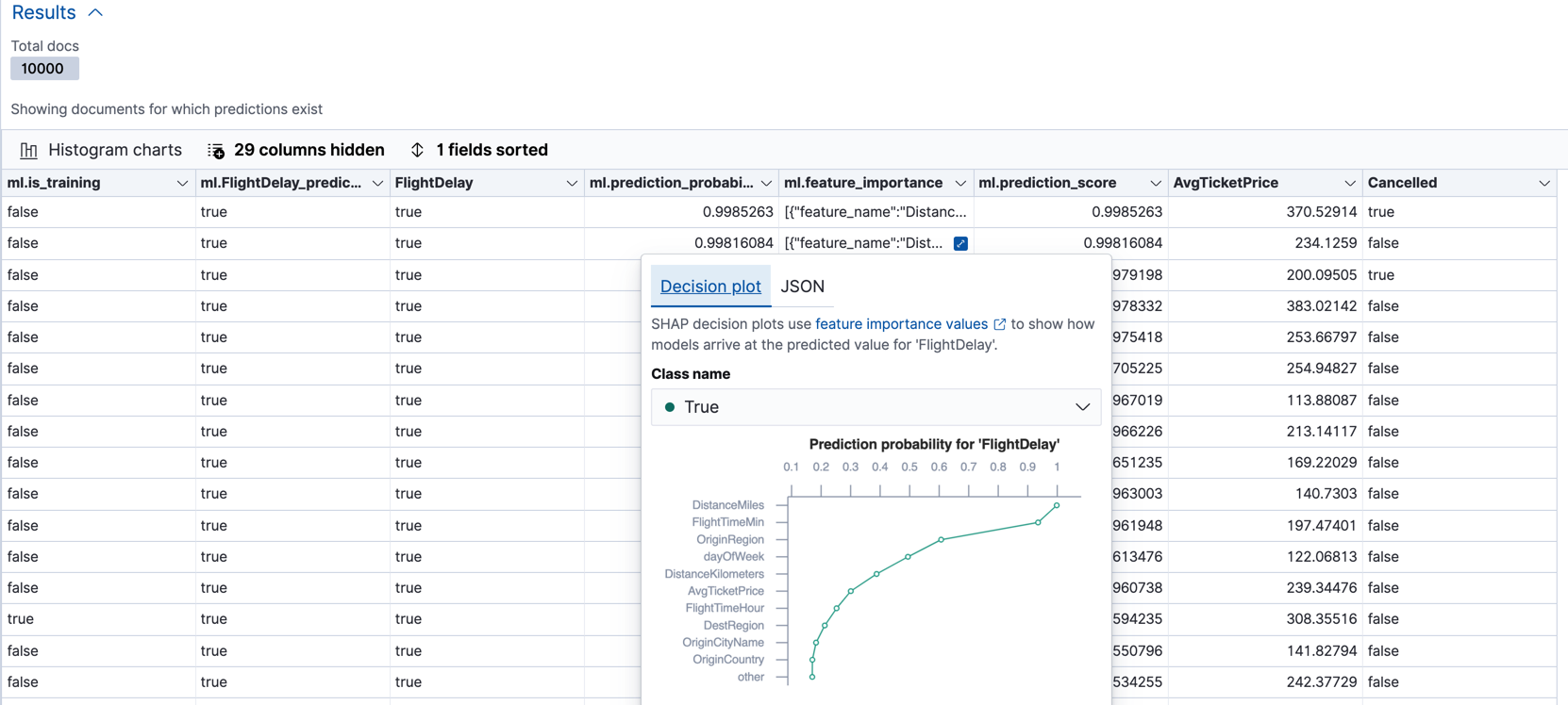

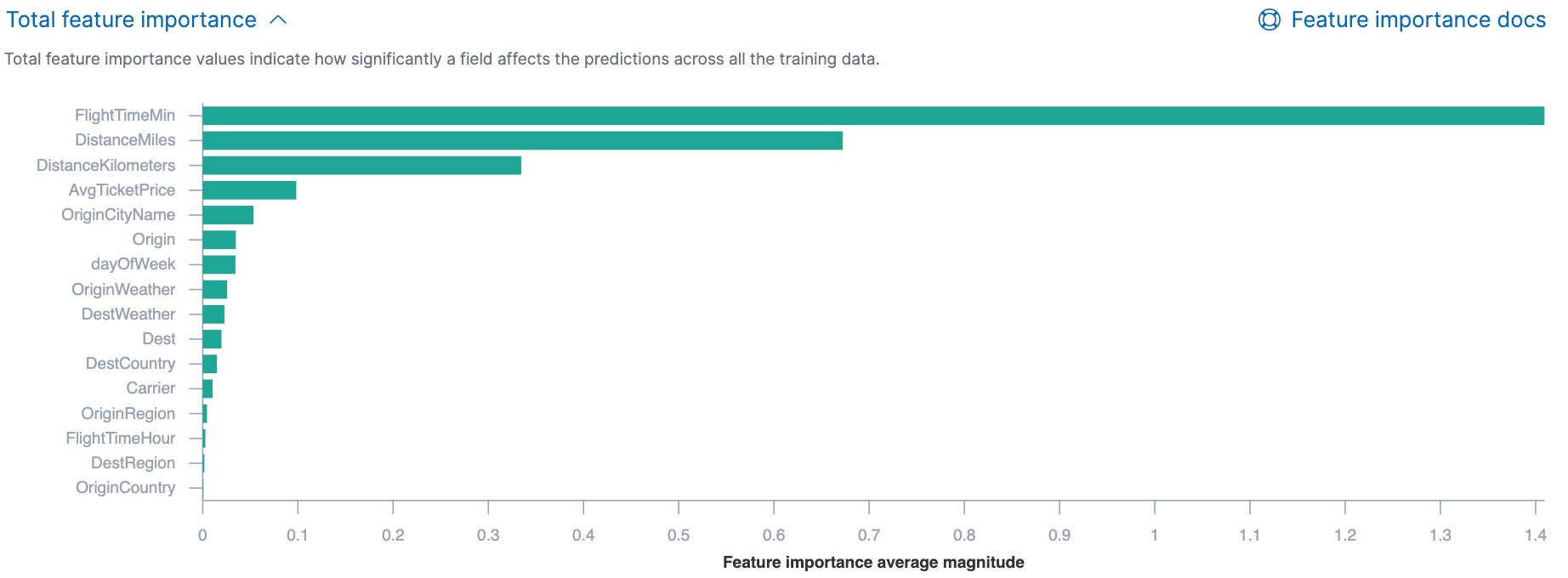

Feature importance
editFeature importance provides further information about the results of an analysis and helps to interpret the results in a more subtle way. If you want to learn more about feature importance, refer to Feature importance.

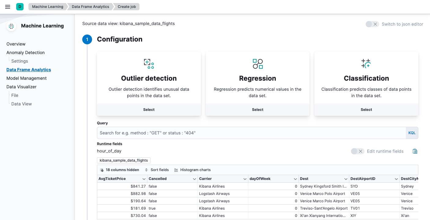

editTo predict whether a specific flight is delayed:
Create a data frame analytics job.
You can use the wizard on the Machine Learning > Data Frame Analytics tab in Kibana or the create data frame analytics jobs API.
Choose
kibana_sample_data_flightsas the source index. -
Choose
classificationas the job type. -
Choose
FlightDelayas the dependent variable, which is the field that we want to predict with the classification analysis. -

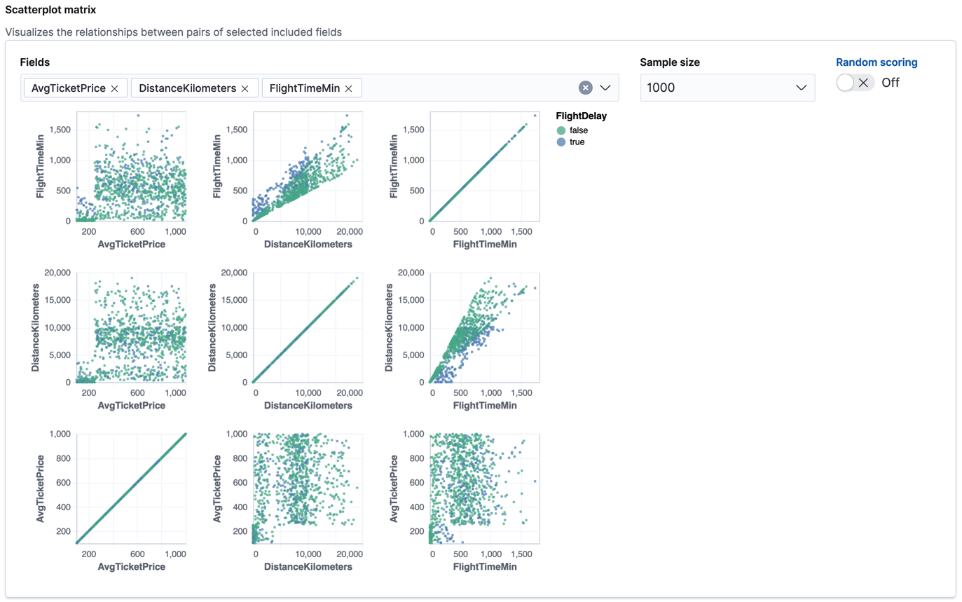

Add
Cancelled,FlightDelayMin, andFlightDelayTypeto the list of excluded fields. It is recommended to exclude fields that either contain erroneous data or describe thedependent_variable.The wizard includes a scatterplot matrix, which enables you to explore the relationships between the numeric fields. The color of each point is affected by the value of the dependent variable for that document, as shown in the legend. You can highlight an area in one of the charts and the corresponding area is also highlighted in the rest of the charts. You can use this matrix to help you decide which fields to include or exclude.
If you want these charts to represent data from a larger sample size or from a randomized selection of documents, you can change the default behavior. However, a larger sample size might slow down the performance of the matrix and a randomized selection might put more load on the cluster due to the more intensive query.
Choose a training percent of
10which means it randomly selects 10% of the source data for training. While that value is low for this example, for many large data sets using a small training sample greatly reduces runtime without impacting accuracy. - If you want to experiment with feature importance, specify a value in the advanced configuration options. In this example, a maximum of 10 feature importance values per document will return. This option affects the speed of the analysis, so by default it is disabled.
- Use the default memory limit for the job. If the job requires more than this amount of memory, it fails to start. If the available memory on the node is limited, this setting makes it possible to prevent job execution.

Start the job in Kibana or use the start data frame analytics jobs API.
The job takes a few minutes to run. Runtime depends on the local hardware and also on the number of documents and fields that are analyzed. The more fields and documents, the longer the job runs. It stops automatically when the analysis is complete.
API example
POST _ml/data_frame/analytics/model-flight-delays-classification/_start
Check the job stats to follow the progress in Kibana or use the get data frame analytics jobs statistics API.
When the job stops, the results are ready to view and evaluate. To learn more about the job phases, see How data frame analytics jobs work.

Viewing classification results
editNow you have a new index that contains a copy of your source data with predictions for your dependent variable.
When you view the classification results in Kibana, it shows the contents of the destination index in a tabular format. It also provides information about the analysis details, model evaluation metrics, total feature importance values, and a scatterplot matrix.
The table shows a column for the dependent variable (FlightDelay), which contains the
ground truth values that you are trying to predict. It also shows a column for
the predicted values (ml.FlightDelay_prediction), which were generated by the
classification analysis. The ml.is_training column indicates whether the document was
used in the training or testing data set. You can use the Training and
Testing filter options to refine the contents of the results table. You can
also enable histogram charts to get a better understanding of the distribution
of values.
If you want to understand how certain the model is about each prediction, you
can examine its probability and score (ml.prediction_probability and
ml.prediction_score). The higher these values are, the more confident the
model is that the data point belongs to the named class. If you examine the
destination index more closely in the Discover app in Kibana or use the
standard Elasticsearch search command, you can see that the analysis predicts the
probability of all possible classes for the dependent variable. The top_classes object
contains the predicted classes with the highest scores.
If you have a large number of classes, your destination index contains a

If you chose to calculate feature importance, the destination index also contains
ml.feature_importance objects. Every field that is included in the
analysis (known as a feature of the data point) is assigned a feature importance
value. It has both a magnitude and a direction (positive or negative), which
indicates how each field affects a particular prediction. Only the most
significant values (in this case, the top 10) are stored in the index. However,
the trained model metadata also contains the average magnitude of the feature importance
values for each field across all the training data. You can view this
summarized information in Kibana:
You can also see the feature importance values for each individual prediction in the form of a decision plot:
In Kibana, the decision path shows the relative impact of each feature on the probability of the prediction. The features with the most significant positive or negative impact appear at the top of the decision plot. Thus in this example, the features related to flight time and distance had the most significant influence on the probability value for this prediction. This type of information can help you to understand how models arrive at their predictions. It can also indicate which aspects of your data set are most influential or least useful when you are training and tuning your model.
If you do not use Kibana, you can see the summarized feature importance values by using the get trained model API and the individual values by searching the destination index.

Lastly, Kibana provides a scatterplot matrix in the results. It has the same functionality as the matrix that you saw in the job wizard. Its purpose is to help you visualize and explore the relationships between the numeric fields and the dependent variable.
Evaluating classification results
editThough you can look at individual results and compare the predicted value
(ml.FlightDelay_prediction) to the actual value (FlightDelay), you
typically need to evaluate the success of your classification model as a
whole.
Kibana provides a normalized confusion matrix that contains the percentage of occurrences where the analysis classified data points correctly with their actual class and the percentage of occurrences where it misclassified them.
As the sample data may change when it is loaded into Kibana, the results of the analysis can vary even if you use the same configuration as the example. Therefore, use this information as a guideline for interpreting your own results.
If you want to see the exact number of occurrences, select a quadrant in the
matrix. You can also use the Training and Testing filter options to refine
the contents of the matrix. Thus you can see how well the model performs on
previously unseen data. You can check how many documents are true in the
testing data, how many of them are identified correctly (true positives) and
how many of them are identified incorrectly as false (false negatives).
Likewise if you select other quadrants in the matrix, it shows the number of
documents that have the false class as their actual value in the testing data. The matrix shows the number of documents that are correctly identified as
false (true negatives) and the number of documents that are incorrectly
predicted as true (false positives). When you perform classification analysis on
your own data, it might take multiple iterations before you are satisfied with
the results and ready to deploy the model.
Kibana also provides the receiver operating characteristic (ROC) curve as part
of the model evaluation. The plot compares the true positive rate (y-axis) to
the false positive rate (x-axis) for each class; in this example, true and
false. From this plot, the area under the curve (AUC) value is computed. It
is a number between 0 and 1. The higher the AUC, the better the model is at
predicting the classes correctly.
