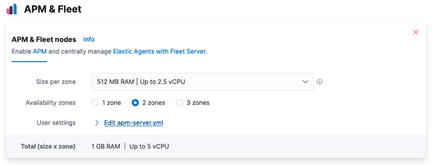

Elastic Cloud runs a hosted version of Fleet Server. No extra setup is required unless you want to scale your deployment.
To confirm that Fleet Server is available in your deployment:
- Log in to Kibana and go to Management > Fleet.
- Click the Agents tab.
- Under Agent policy, look for Elastic Cloud agent policy — Fleet Server is the agent enrolled in the Elastic Cloud agent policy. This policy is managed by Elastic Cloud. You cannot modify it. Confirm that the agent status is Healthy.
Don’t see the Fleet Server agent? Make sure your deployment includes an APM & Fleet node. This node is required to use Fleet Server.
When using our hosted Elasticsearch Service, it’s recommended that you use our hosted version of Fleet Server. However, you can choose to deploy and self-manage Fleet Servers.

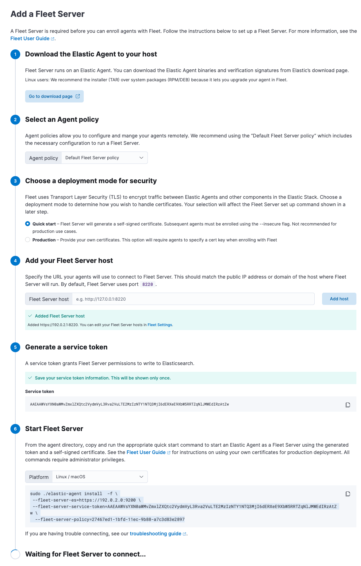

Click the Agents tab and follow the in-product instructions to add a Fleet server:
Notes:
- Make sure you download an x64 architecture installation package.
For the agent policy, choose one with a Fleet Server integration. If one doesn’t exist, create it.
- If you choose Production deployment mode, read Encrypt traffic in clusters with a self-managed Fleet Server to learn how to generate certs.
It’s recommended you generate a unique service token for each
Fleet Server. For other ways to generate service tokens, see
elasticsearch-service-tokens
The
install
command installs the Elastic Agent as a managed service and enrolls it in a Fleet Server policy. For example, the following command installs a Fleet Server and uses self-signed certs:sudo ./elastic-agent install -f \ --fleet-server-es=http://localhost:9200 \ --fleet-server-service-token=AAEbAWVsYXN0aWMvZmxlaXQtc2VydmVzL3Rva2VuLTE2MeIzNTY1NTQ3Mji6dERXeE9XbW5RRTZqNlJMWEdIRzAtZw \ --fleet-server-policy=27467ed1-1bfd-11ec-9b88-a7c3d83e2897
The following command installs a Fleet Server and uses certificates you provide. Make sure you replace the values in angle brackets.
sudo ./elastic-agent install --url=https://192.0.2.1:8220 \ -f \ --fleet-server-es=https://192.0.2.0:9200 \ --fleet-server-service-token=AAEAaWVsYXN0aWcvZmxlZXQtc2VydmVyL3rva2VuLTE2MzIzNTYcNTQ3MjI6dER1eE9XbW5RRTZqNlJMWEdIRzAtZw \ --fleet-server-policy=27467ed1-1bfd-11ec-9b88-a7c3d83e2897 \ --certificate-authorities=<PATH_TO_CA> \ --fleet-server-es-ca=<PATH_TO_ES_CERT> \ --fleet-server-cert=<PATH_TO_FLEET_SERVER_CERT> \ --fleet-server-cert-key=<PATH_TO_FLEET_SERVER_CERT_KEY>
For more Fleet Server commands, see Command reference.
If installation is successful, you’ll see the Fleet Server Elastic Agent on the Agents tab in Fleet. Notice that the Default Fleet Server Policy is assigned to the Elastic Agent. This policy is created when you run Fleet for the first time.

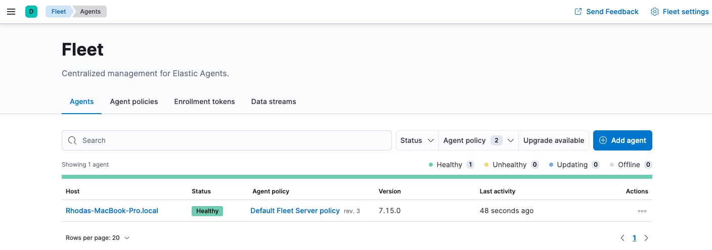

Step 2: Add an Elastic Agent to Fleetedit
Elastic Agent is a single, unified agent that you can deploy to hosts or containers to collect data and send it to the Elastic Stack. Behind the scenes, Elastic Agent runs the Beats shippers or Elastic Endpoint required for your configuration.
To send logs and metrics to the Elastic Stack:
- On the Agents tab in Fleet, click Add agent.
Under Enroll in Fleet, follow the in-product installation steps.
See the download page for other installation options.

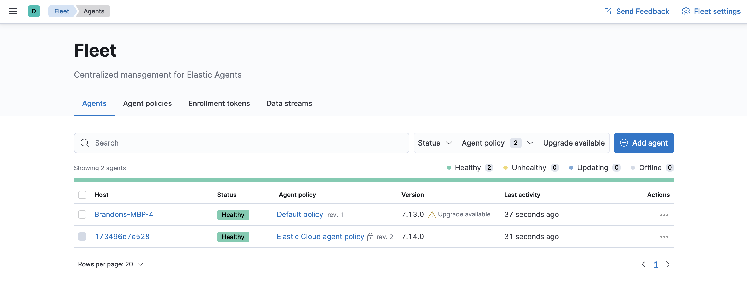

If installation is successful, you’ll see the agent on the Agents tab in Fleet. Notice that the Default policy is assigned to the agent.
If the status hangs at Enrolling, make sure the elastic-agent
process
is running.

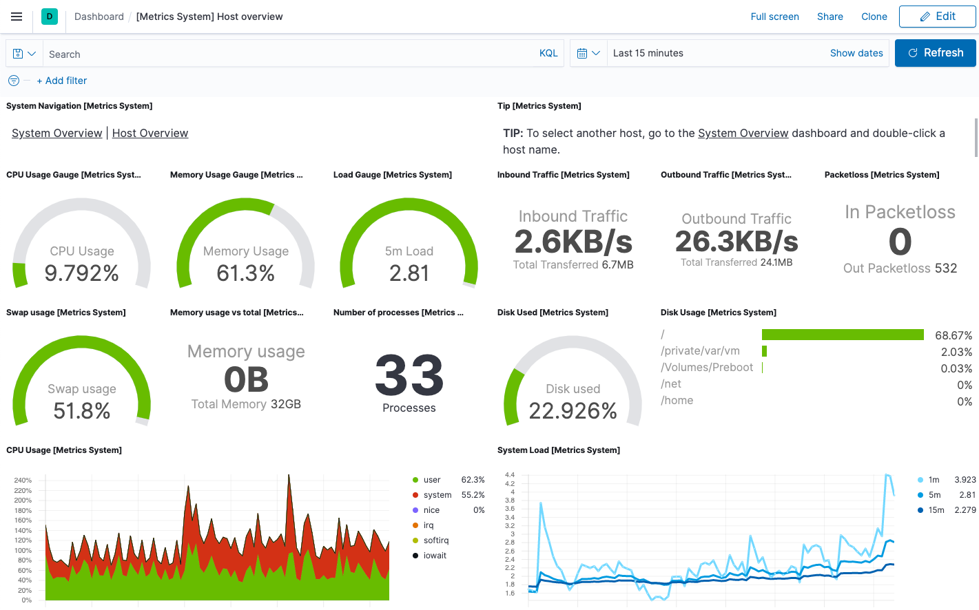

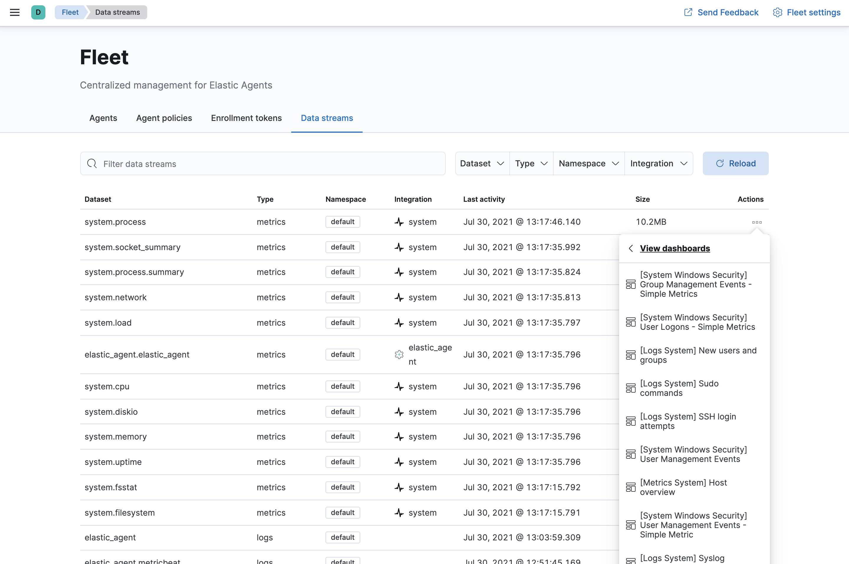

Step 3: Monitor host logs and metricsedit
Next, view the data sent by Elastic Agent. Right now, Elastic Agent is only sending data about the host system because you haven’t configured the agent to collect data from other sources yet.
To see host logs and metrics:
- In Fleet, click the Data streams tab.
In the Actions column, navigate to the dashboards corresponding to the data stream. For example, to see host metrics, select one of the system datasets:
Then navigate to the [Metrics System] Host overview dashboard:

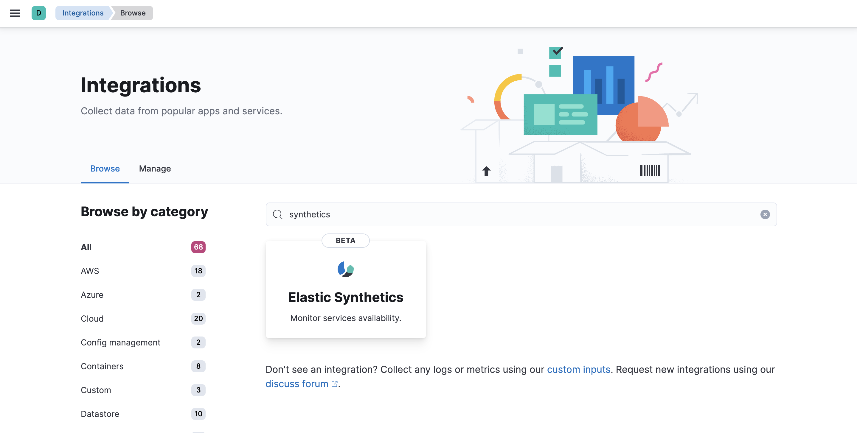

Step 4: Monitor services using real browsers and lightweight HTTP, TCP, and ICMP checksedit
[beta] This functionality is in beta and is subject to change. The design and code is less mature than official GA features and is being provided as-is with no warranties. Beta features are not subject to the support SLA of official GA features. Next, you’ll add the Elastic Synthetics integration, enabling you to monitor the status and response times of applications and services in real time. You can monitor the availability of network endpoints via HTTP, TCP, ICMP or Browser monitors.

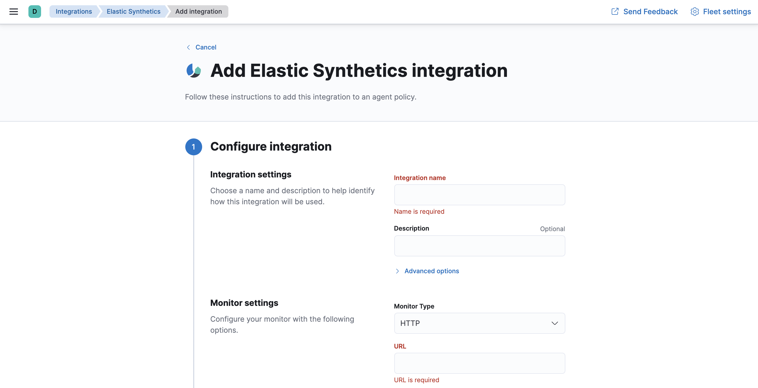

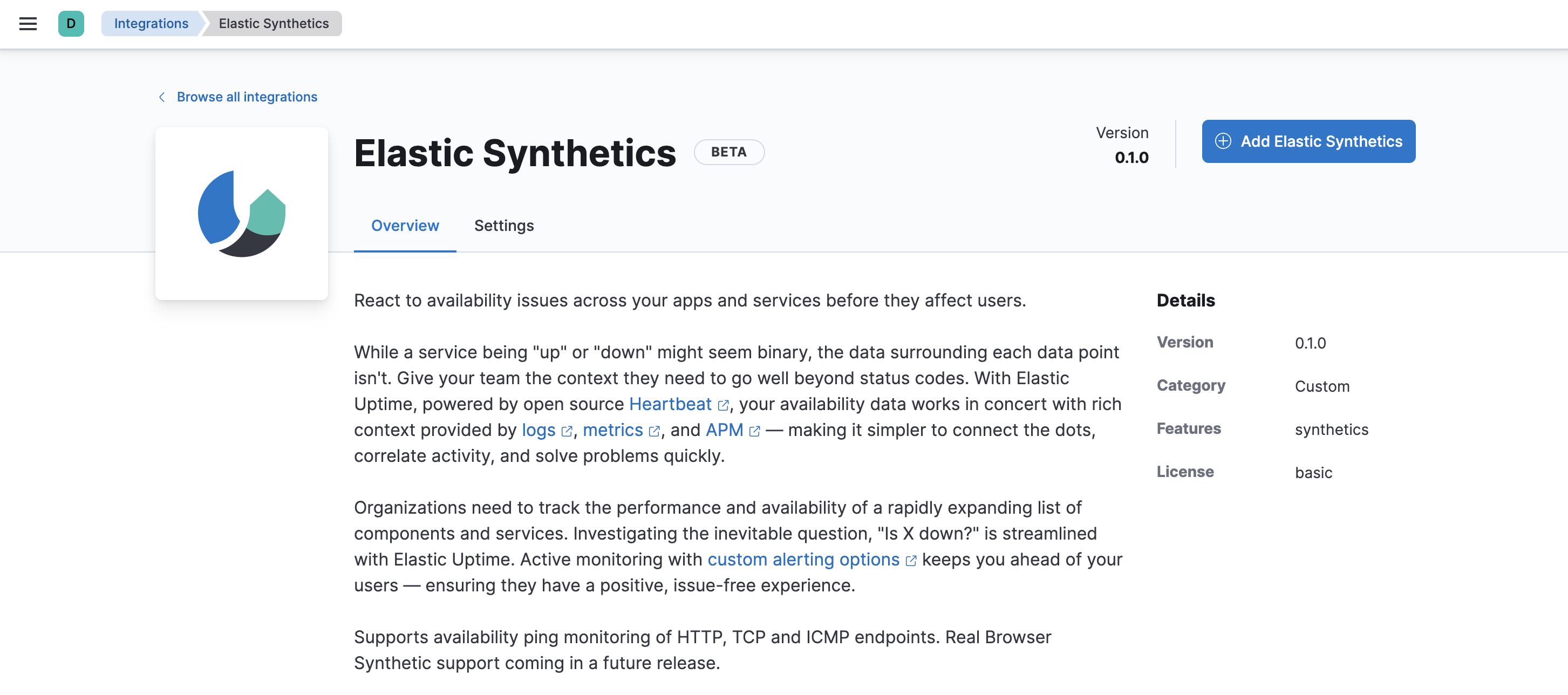

Add the Elastic Synthetics integration to the default policy used by your agent. You use policies to manage settings across a group of agents. An agent policy may contain any number of integrations for collecting observability data from the various services running on your host.
In Kibana, go to Management > Integrations, and search for the Elastic Synthetics integration.
Click the Elastic Synthetics integration to see more details about it, then click Add Elastic Synthetics.
On the Add Elastic Synthetics integration page, under Configure integration, enter the integration name and select your desired monitor type from the following monitor types:

- Enter the URL you want to monitor for availability and select a monitor interval in seconds or minutes. By default, a monitoring schedule of every 3 minutes is selected.
- The HTTP and TCP monitor types both support TLS. Under TLS settings, select Enable TLS configuration. Click the down arrow next to advanced HTTP or TCP options, and then enter your required settings.
Under Apply to agent policy, select the
default policy

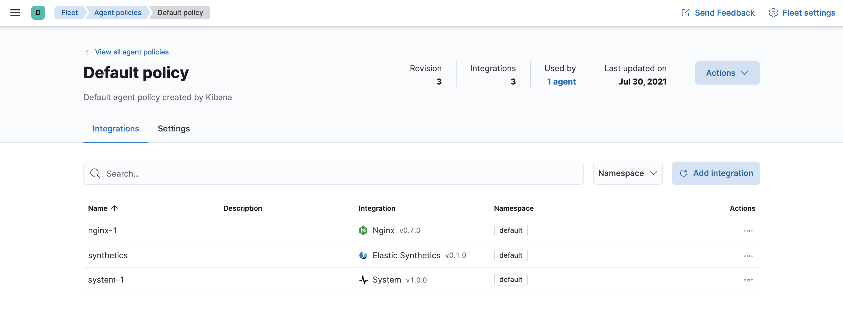

. - When you’re done, click Save integration, then Save and deploy changes.
To see the updated policy, click the Default policy link.
The newly added Elastic Synthetics integration should appear under Integrations in the default policy, along with the
system-1
integration.All Elastic Agents that use this policy will collect logs, metrics, and uptime data from the host.

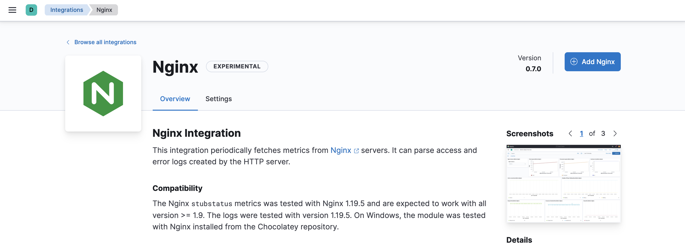

Step 5: Monitor Nginx logs and metricsedit
Next, you’ll browse a catalog of integrations, then add an Nginx integration to the default policy used by your agent.
For these steps, we assume that you have nginx
running on some of your
infrastructure, and want to collect logs and metrics from it.

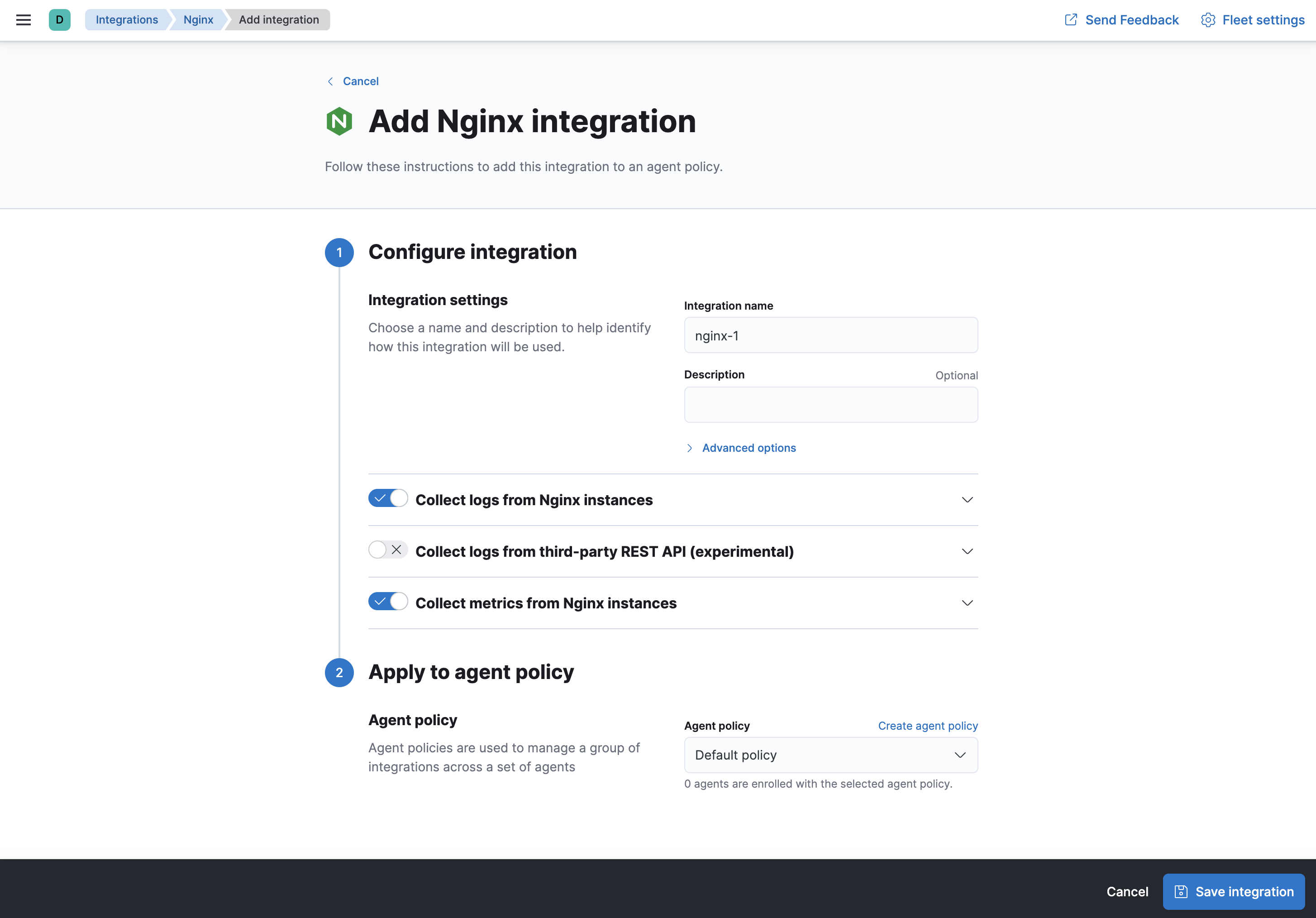

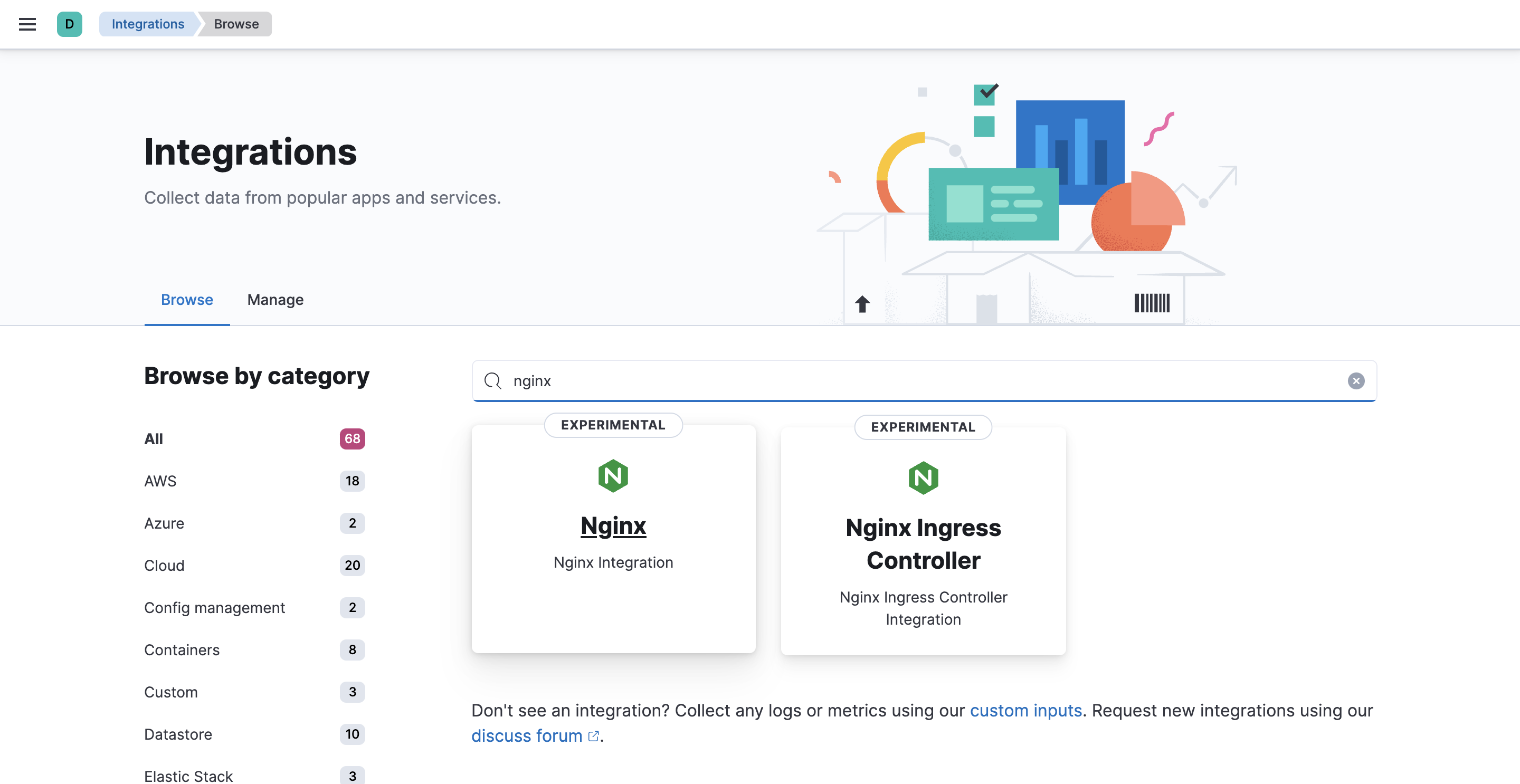

In Kibana, go back to Management > Integrations, and search for the Nginx integration.
Click the Nginx integration to see more details about it, then click Add Nginx.
On the Add Nginx integration page, select the default policy.
- Under Configure integration, click the down arrow next to enabled streams and make sure the Paths are correct for your host. Inspect or change other settings
- When you’re done, save and deploy the changes.
The newly added Nginx integration should appear under Integrations in the default policy, along with the
system-1
andsynthetics-1
integrations.All Elastic Agents that use this policy will collect logs and metrics from the Nginx server and the host, along with uptime data.
