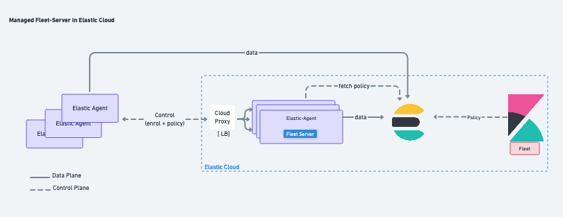

Deployed in Elastic Cloudedit
To simplify the deployment of Elastic Agent, the Fleet Server can be provisioned and hosted in the Elastic Cloud. In this case, when the deployment is created, a highly available set of Fleet Servers are automatically deployed.
Administrators can choose the resources allocated to the Fleet Server and whether they want the Fleet Server to be deployed in multiple availability zones.
Once deployed on Elastic Cloud as a service, the full life cycle of the Fleet Server is managed by Elastic. Fleet Server is scalable and highly available with traffic ingress load balanced across multiple instances to satisfy the scale requirements.

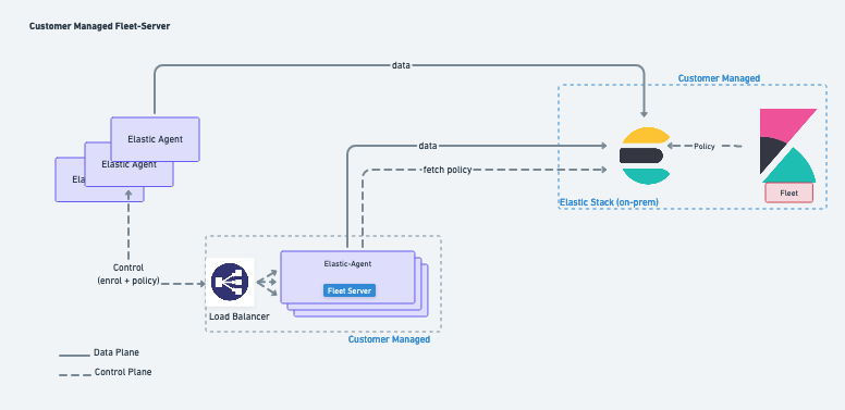

Deployed on-prem and self-managededit
Fleet Server can be deployed on-premises and managed by the user. In this deployment model, the administrator is responsible for Fleet Server deployment and lifecycle management. This mode of operation is predominantly chosen to satisfy data governance requirements or used in scenarios where the agents only have access to a private segmented network.
It’s recommended that the administrator provision multiple instances of the Fleet Server and use a load balancer to better scale the deployment.
Fleet Server High availability operationsedit
Fleet Server is stateless. Connections to the Fleet Server therefore can be load balanced as long as the Fleet Server has capacity to accept more connections. Load balancing is done on a round-robin basis.
In the Elastic Cloud deployment model, multiple Fleet Servers are automatically provisioned to satisfy the instance size chosen (instance sizes are modified to satisfy the scale requirement). In addition, if you choose multiple availability zones to address your fault-tolerance requirements, those instances are also utilized to balance the load.
In an on-prem deployment, high-availability, fault-tolerance, and lifecycle management of the Fleet Server are the responsibility of the administrator.

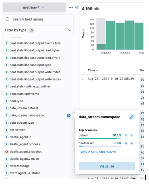

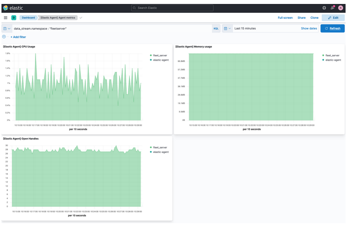

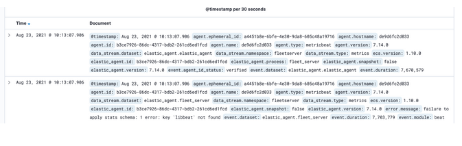

Fleet Server monitoringedit
Monitoring Fleet Server is key since the operation of the Fleet Server is paramount to the health of the deployed agents and the services they offer. When Fleet Server is not operating correctly, it may lead to delayed check-ins, status information, and updates for the agents it manages. The monitoring data will tell you when to add capacity for Fleet Server, and provide error logs and information to troubleshoot other issues.
To enable monitoring for Fleet Server, turn on agent monitoring in the agent policy. For self-managed clusters, monitoring is on by default when you create a new agent policy or use the existing Default Fleet Server agent policy. However, it is off by default in the Elastic Cloud agent policy because monitoring requires additional RAM.
To turn on Fleet Server monitoring in the agent policy:
In Fleet, go to Agent Policies and click on the Elastic Cloud agent policy.
- Click the Settings tab and notice that Agent monitoring is off by default.
Under Agent monitoring, select Collect agent logs and Collect agent metrics.
The agent will now be able to collect logs and metrics from the Fleet Server.
The Fleet Server is deployed as yet another agent in the system.

To see the metrics collected for Fleet Server, go to Analytics > Discover.
In the following example, fleetserver
was configured as the namespace, and
you can see the metrics collected:
In Kibana, go to Analytics > Dashboard and search for the predefined dashboard
called [Elastic Agent] Agent metrics. Choose this dashboard, and run a query
based on the fleetserver
namespace.
The following dashboard shows data for the query data_stream.namespace:
"fleetserver"
. In this example, you can observe CPU and memory usage as a
metric and then resize the Fleet Server, if necessary.
Note that as an alternative to running the query, you can hide all metrics
except fleet_server
in the dashboard.
