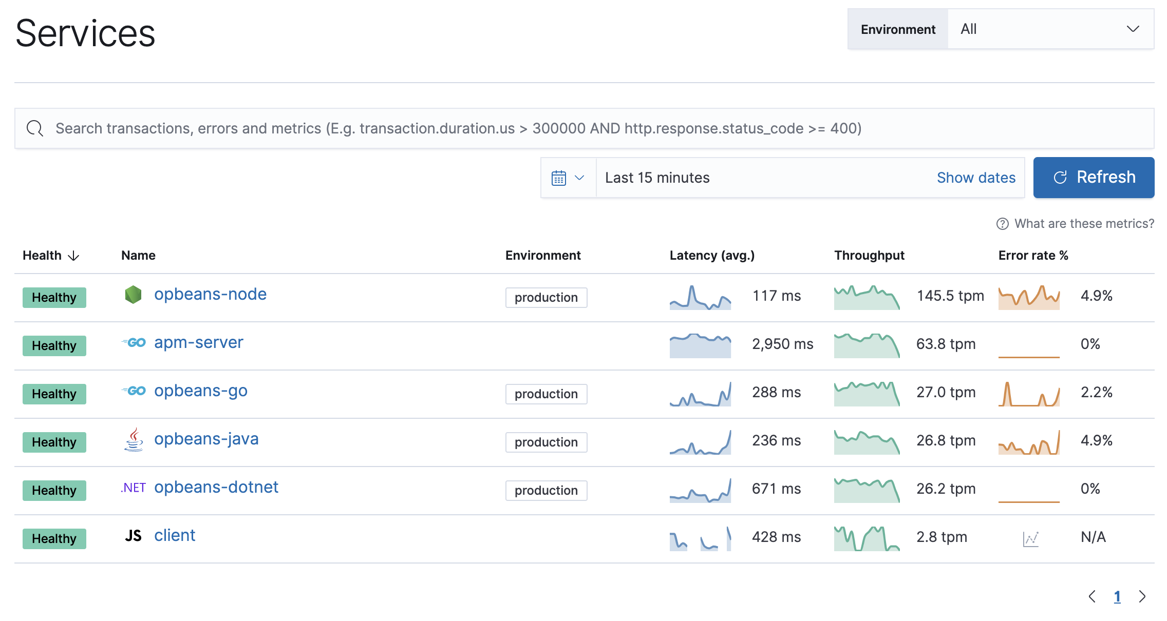

- Explore and visualize the data in real-time

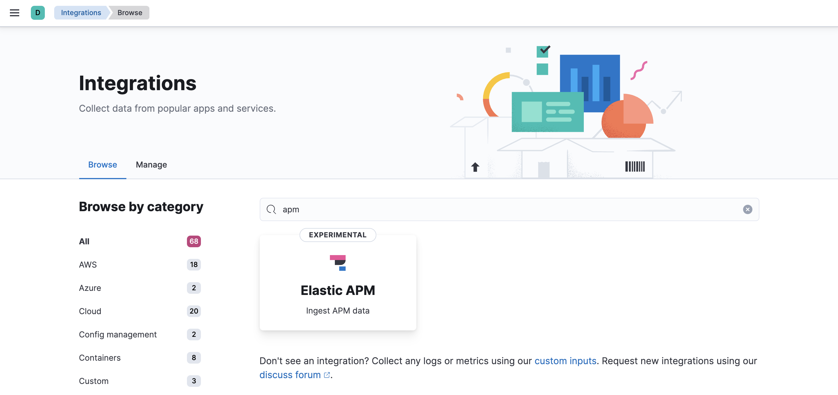

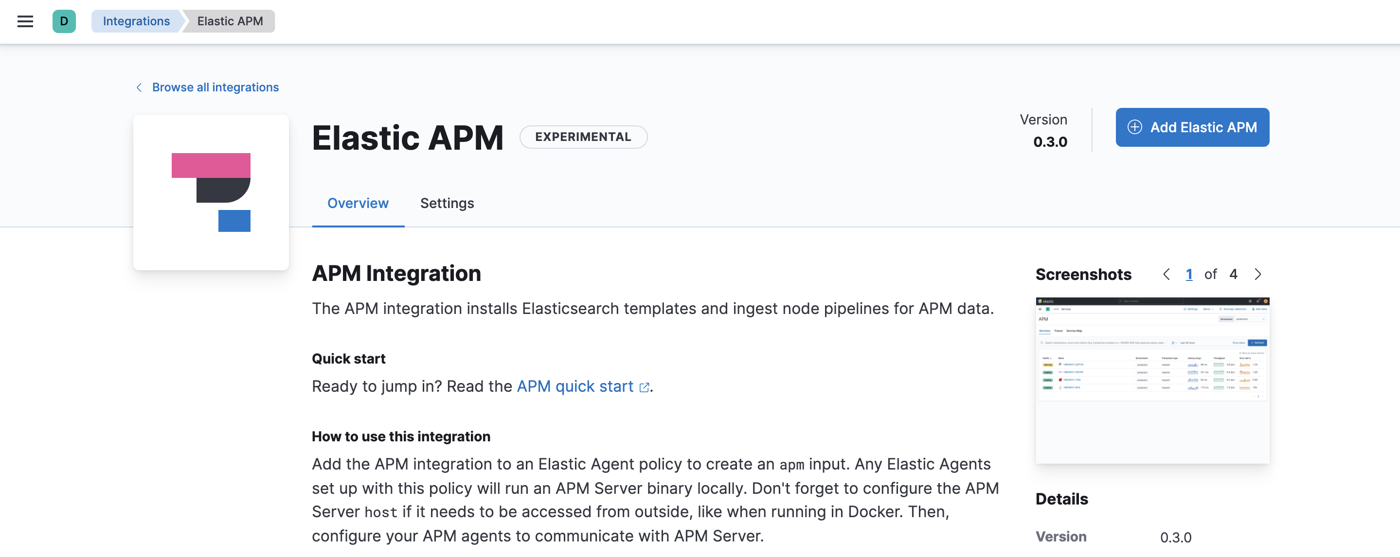

In Kibana, go to Management > Integrations, and search for the Elastic APM integration.

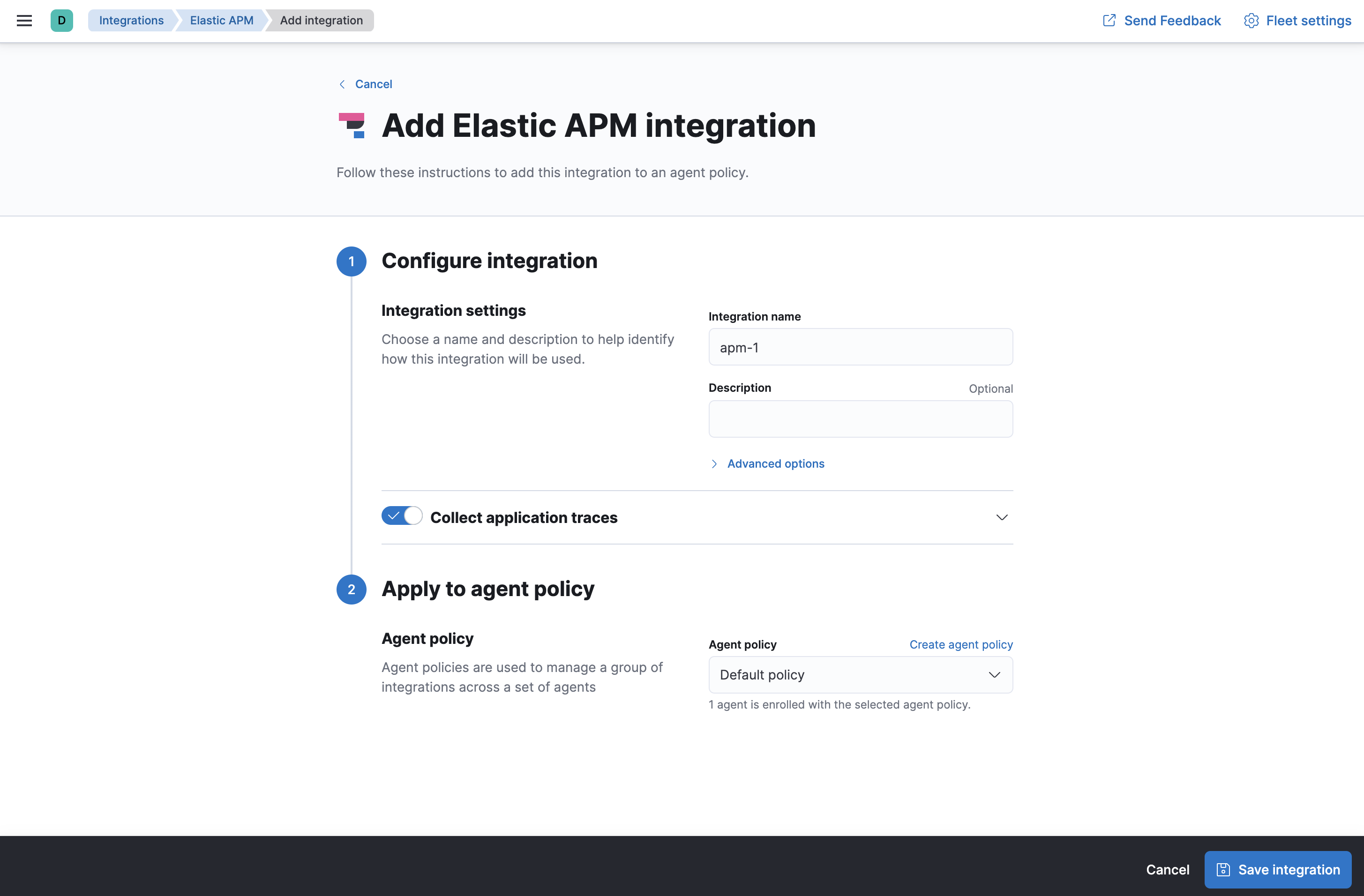

Click the APM integration to see more details about it, then click Add Elastic APM.
- On the Add APM integration page, click the down arrow next to Collect application traces. Under Host, define the host and port where APM Server will listen. Inspect or change other settings.

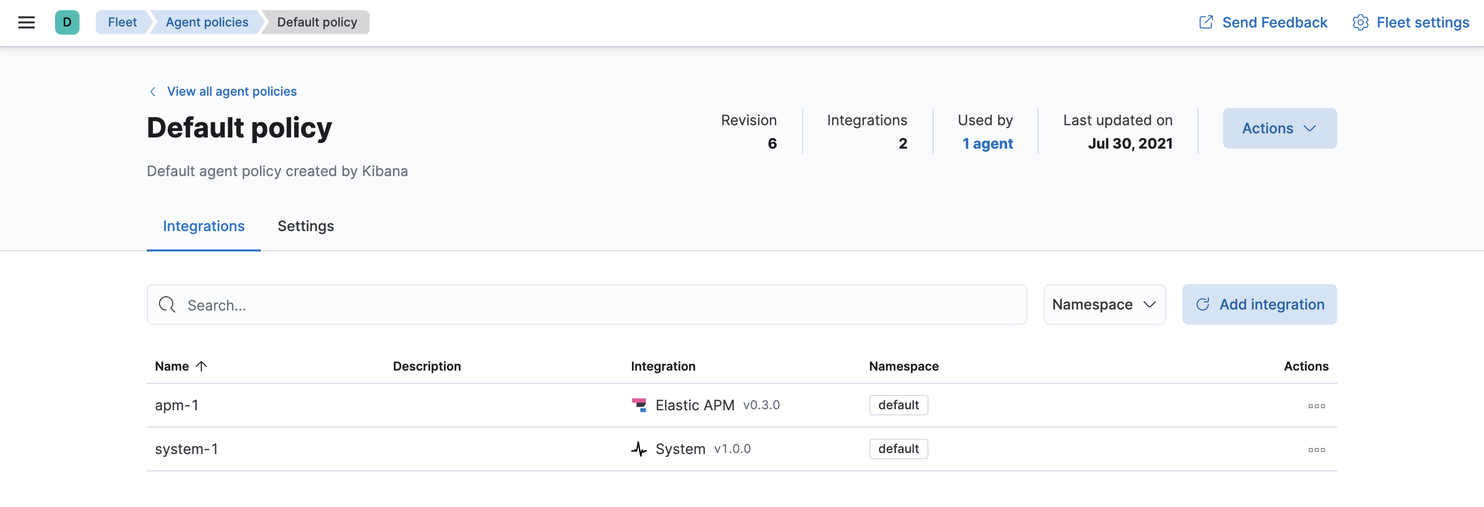

Under Apply to agent policy, select the default policy.
To see the updated policy, click the Default policy link.
The newly added APM integration should appear under Integrations in the default policy, along with the default
system-1integration.
All Elastic Agents that use this policy will collect APM data from your instrumented services.

Step 5: View your data
editBack in Kibana, under Observability, select APM. You should see application performance monitoring data flowing into the Elastic Stack!
