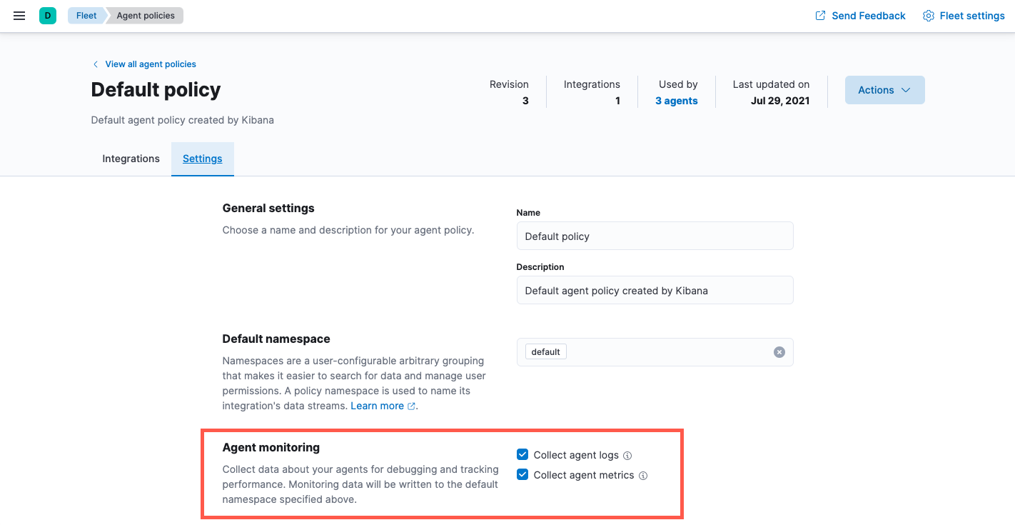

You configure the collection of agent metrics in the agent policy. If metrics collection is selected (the default), all Elastic Agents enrolled in the policy will send metrics data to Elasticsearch (the output is configured globally).
The following image shows the Agent monitoring settings for the default agent policy:
Screen capture of agent monitoring settings in the default agent policy

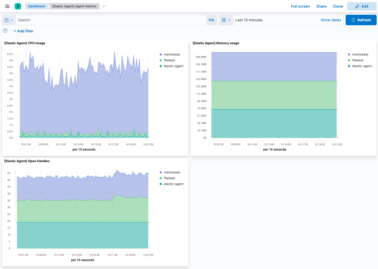

The [Elastic Agent] Agent metrics dashboard shows an aggregated view of agent metrics:
Screen capture showing Elastic Agent metrics
