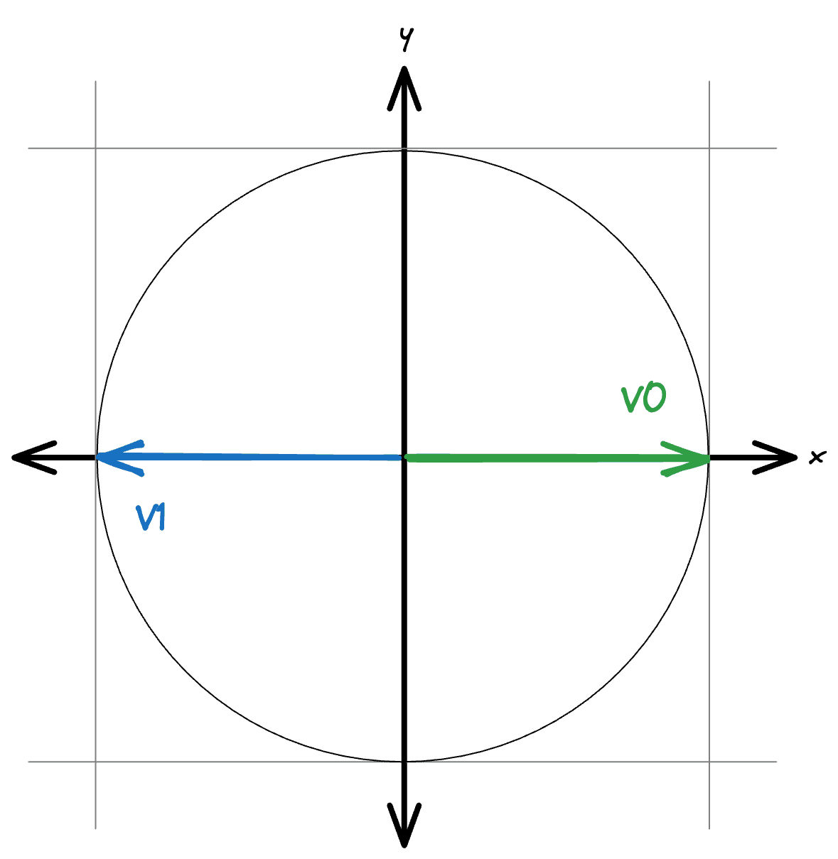

In the normalized case, all vectors are on a unit sphere. This allows handling negative scores to be simple scaling.
Figure 1: Two opposite, two dimensional vectors in a 2d unit sphere (e.g. a unit circle). When calculating the dot-product here, the worst it can be is -1 = [1, 0] * [-1, 0]. Lucene accounts for this by adding 1 to the result.

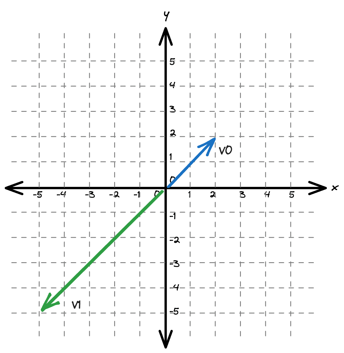

With vectors retaining their magnitude, the range of possible values is unknown.
Figure 2: When calculating the dot-product for these vectors [2, 2] \* [-5, -5] = -20
To allow Lucene to utilize blockMax WAND with non-normalized vectors, we must scale the scores. This is a fairly simple solution. Lucene will scale non-normalize vectors with a simple piecewise function:

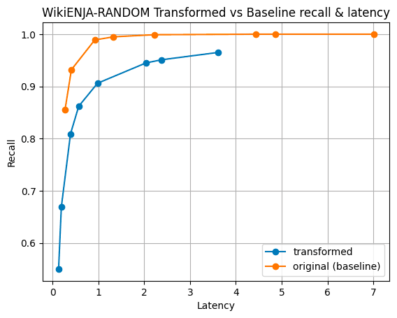

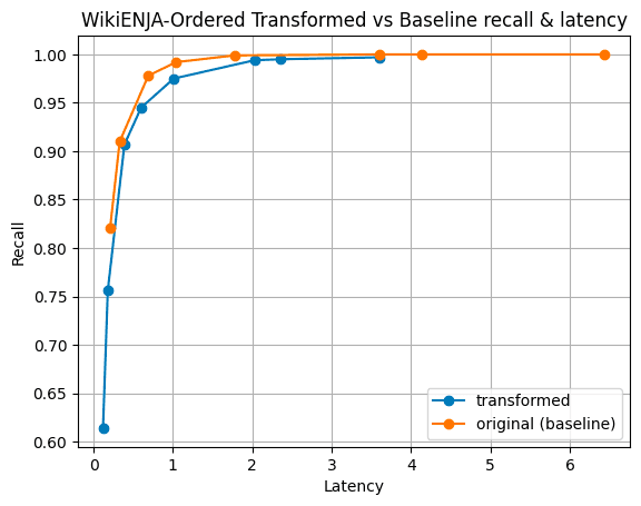

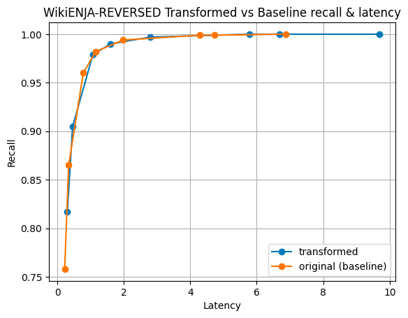

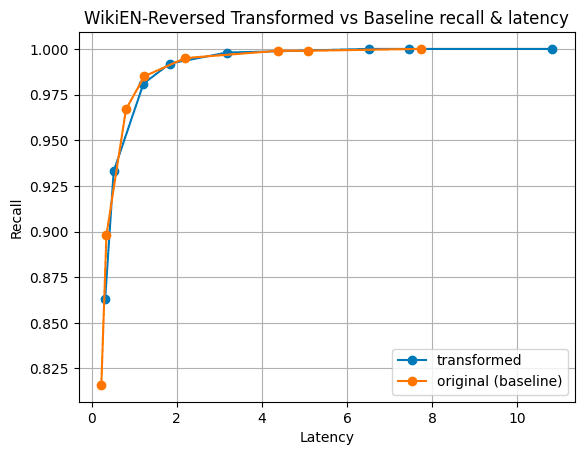

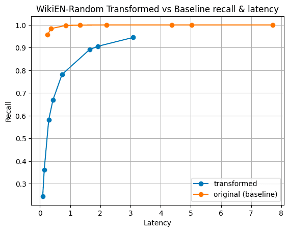

The experiments we ran were simple. All of the experiments are over real data sets or slightly modified real data sets. This is vital for benchmarking as modern neural networks create vectors that adhere to specific characteristics (see discussion in section 7.8 of this paper). We measured latency (in milliseconds) vs. recall over non-normalized vectors. Comparing the numbers with the same measurements but with a euclidean space transformation. In each case, the vectors were indexed into Lucene’s HNSW implementation and we measured for 1000 iterations of queries. Three individual cases were considered for each dataset: data inserted ordered by magnitude (lesser to greater), data inserted in a random order, and data inserted in reverse order (greater to lesser).
Here are some results from real datasets from Cohere:
Figure 3: Here are results for the Cohere’s Multilingual model embedding wikipedia articles. Available on HuggingFace. The first 100k documents were indexed and tested.
Figure 4: This is a mixture of Cohere’s English and Japanese embeddings over wikipedia. Both datasets are available on HuggingFace.

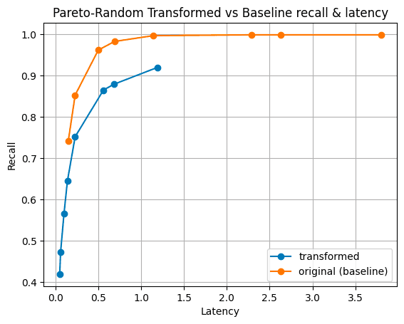

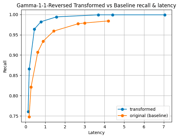

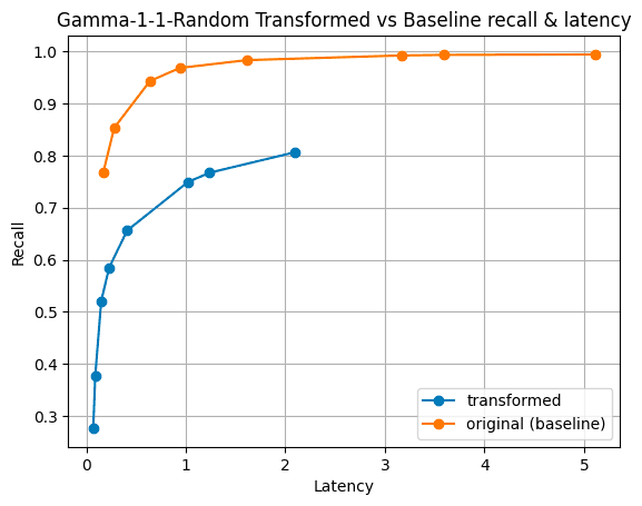

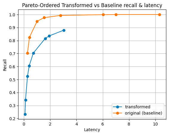

We also tested against some synthetic datasets to ensure our rigor. We created a data set with e5-small-v2 and scaled the vector's magnitudes by different statistical distributions. For brevity, I will only show two distributions.
Figure 5: Pareto distribution of magnitudes. A pareto distribution has a “fat tail” meaning there is a portion of the distribution with a much larger magnitude than others.

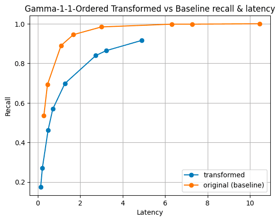

Figure 6: Gamma distribution of magnitudes. This distribution can have high variance and makes it unique in our experiments.
In all our experiments, the only time where the transformation seemed warranted was the synthetic dataset created with the gamma distribution. Even then, the vectors must be inserted in reverse order, largest magnitudes first, to justify the transformation. These are exceptional cases.
