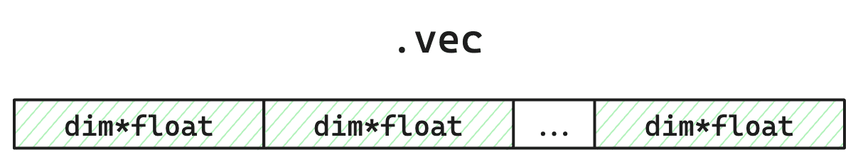

Figure 1: Simplified layout of raw vector storage file. Takes up [objectObject]4numVectors[object Object] * 4 * numVectors of disk space since floatfloat values are 4 bytes. Because we are quantizing, these will not get loaded during HNSW search. They are only used if specifically requested (e.g. brute-force secondary via rescore), or for re-quantization during segment merge.

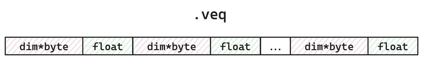

Figure 2: Simplified layout of the .veq.veq file. Takes up (dimension+4)numVectors(dimension + 4)*numVectors of space and will be loaded into memory during search. The +4+ 4 bytes is to account for the corrective multiplier float, used to adjust scoring for better accuracy and recall.

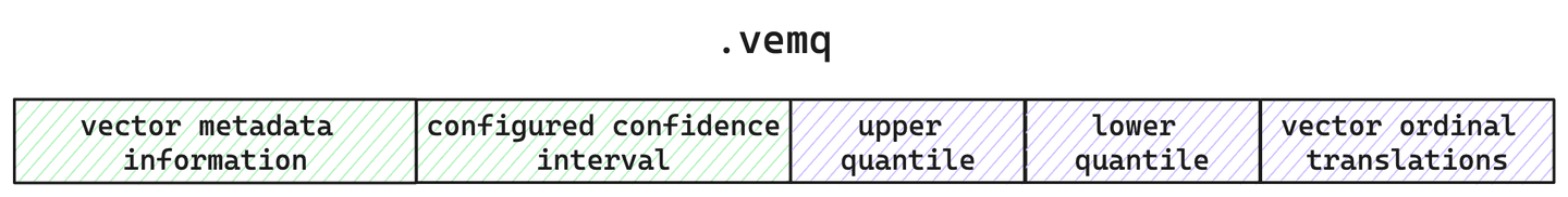

Figure 3: The simplified layout of the metadata file. Here is where we keep track of quantization and vector configuration along with the calculated quantiles for this segment.

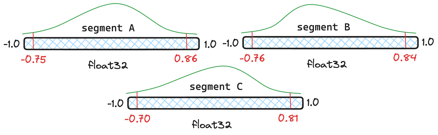

Figure 4: Three example segments with different quantiles.

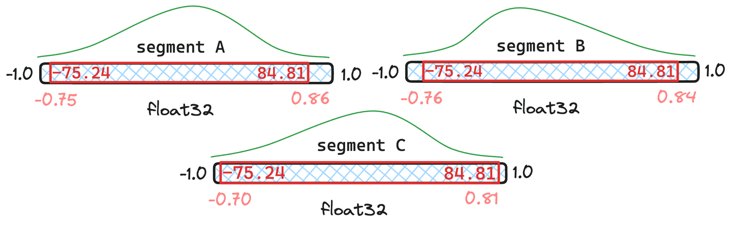

But isn't re-quantization expensive? It does have some overhead, but Lucene handles quantiles intelligently, and only fully-requantizes when necessary. Let's use the segments in Figure 4 as an example. Let's give segments AA and BB 1,0001,000 documents each and segment CC only 100100 documents. Lucene will take a weighted average of the quantiles and if that resulting merged quantile is near enough to the segments original quantiles, we don't have to re-quantize that segment and will utilize the newly merged quantiles.
Figure 5: Example of merged quantiles where segments AA and BB have 10001000 documents and CC only has 100100.
In the situation visualized in figure 5, we can see that the resulting merged quantiles are very similar to the original quantiles in AA and BB. Thus, they do not justify quantizing the vectors. Segment CC, seems to deviate too much. Consequently, the vectors in CC would get re-quantized with the newly merged quantile values.

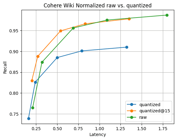

So, is it fast and does it still provide good recall? The following numbers were gathered running the experiment on a c3-standard-8 GCP instance. To ensure a fair comparison with float32float32 we used an instance large enough to hold raw vectors in memory. We indexed 400,000400,000 Cohere Wiki vectors using maximum-inner-product.
Figure 6: Recall@10 for quantized vectors vs raw vectors. The search performance of quantized vectors is significantly faster than raw, and recall is quickly recoverable by gathering just 5 more vectors; visible by quantized@15quantized@15.
Figure 6 shows the story. While there is a recall difference, as to be expected, it's not significant. And, the recall difference dissappears by gathering just 5 more vectors. All this with 2×2\times faster segment merges and 1/4 of the memory of float32float32 vectors.
