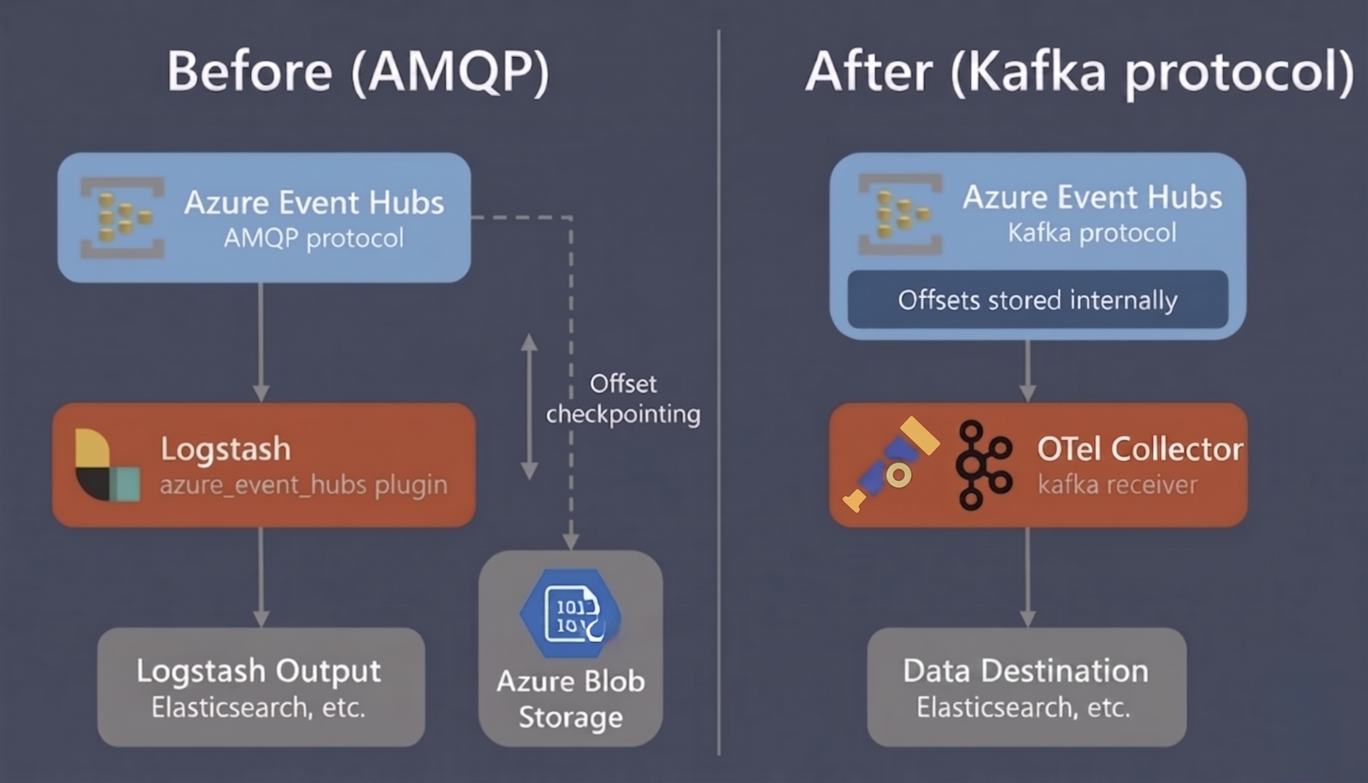

This article is a companion guide to the Logstash Azure Event Hubs to Kafka input plugin migration, covering an alternative path: replacing logstash-input-azure_event_hubs with the OpenTelemetry Collector kafka receiver to consume from the Azure Event Hubs Kafka endpoint. For the reasons to migrate, authentication considerations, and key behavior changes such as offset handling, refer to the original article.

    Note: Since the Kafka receiver can't read the old Blob Storage checkpoints, it treats the migration as a first-time connection. To avoid reprocessing data the legacy plugin already handled, set initial_offset: latest for the initial deployment.

Both migration paths eliminate the Blob Storage checkpoint dependency and improve throughput over the legacy azure_event_hubs plugin. The Logstash kafka plugin is the lower-friction option: the configuration change is minimal, the offset model carries over, and it delivers the highest throughput of the options tested. The OTel Collector kafka receiver is the better fit if you want to remove Logstash from the pipeline entirely and align with OpenTelemetry. It trades a lower peak throughput and no decorate_events equivalent for a vendor-neutral ingestion layer that can run alongside other OTel Collector pipelines in the same Collector.
