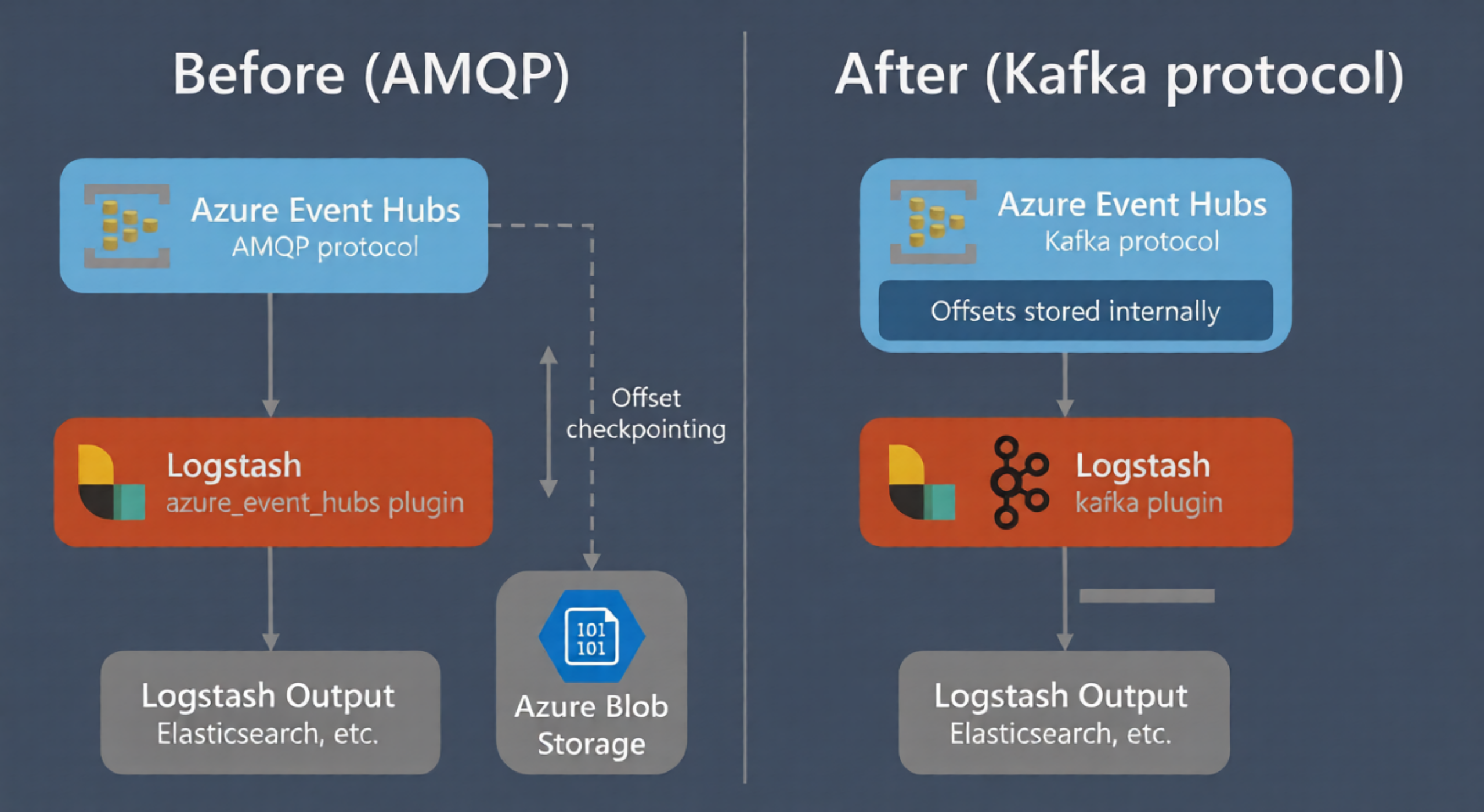

Azure Event Hubs natively supports the Apache Kafka protocol, which means you no longer need the logstash-input-azure_event_hubs plugin or an external Blob Storage account for offset checkpointing. Switching to logstash-input-kafka removes that storage dependency, reduces costs, and delivers up to 2.5x higher throughput.
This guide walks you through the migration: why it matters, how to convert your existing configuration, parameter mapping between the two plugins, and how to adapt proxy setups.
Why migrate?
The migration from the Azure Event Hubs plugin to the Kafka input plugin is motivated by several factors:
  1. Azure Event Hubs already speaks Kafka natively. Event Hubs exposes a built-in Apache Kafka endpoint on Standard, Premium, and Dedicated tiers. This means the logstash-input-azure_event_hubs plugin is no longer necessary. The standard logstash-integration-kafka (input) plugin connects directly to the same service with no extra Azure-side configuration.
  2. No more Blob Storage for offset checkpointing. The AMQP-based plugin requires an external Azure Blob Storage account to track consumer offsets. This means provisioning and maintaining a storage account, plus paying for every checkpoint write. With the Kafka protocol, offset tracking is handled internally by Azure Event Hubs at no extra cost, removing the need for external storage.

Key behavior changes
Before changing any configuration, be aware of two important differences:
  1. No more Blob Storage for offsets. The Kafka input plugin tracks offsets internally through the Azure Event Hubs service at no extra cost. The storage_connection and storage_container parameters have no equivalent. There is nothing to provision, maintain, or pay for.
  2. Consumer offsets don't carry over. AMQP consumer groups and Kafka consumer groups are completely separate, even if they share the same name. When the Kafka input plugin connects for the first time, Azure auto-creates the Kafka consumer group specified in group_id (default: logstash). It will not read the old Blob Storage checkpoints or resume from where the legacy plugin left off. It starts fresh.
Event Hubs (AMQP) consumer groupsKafka consumer groups
ProtocolAMQPKafka
Offset storageExternal Azure Blob StorageInternal to the Event Hubs service
CreationMust be created via portal, SDK, or ARMAuto-created on first connection
Namespace scopeScoped to a single Event HubSpan the entire namespace
Limit: A maximum of 1,000 simultaneous Kafka consumer groups per namespace is allowed. See the Event Hubs vs. Kafka Consumer Groups FAQ.
