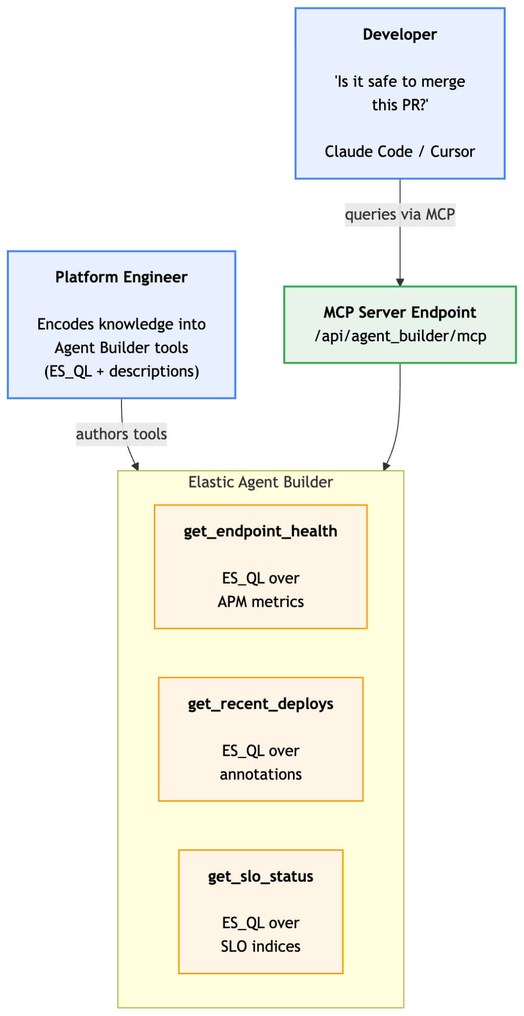

Here is the architecture:
The platform engineer authors the tools once. Every developer on the team benefits from their own editor, without needing to learn ES|QL or understand APM data models.

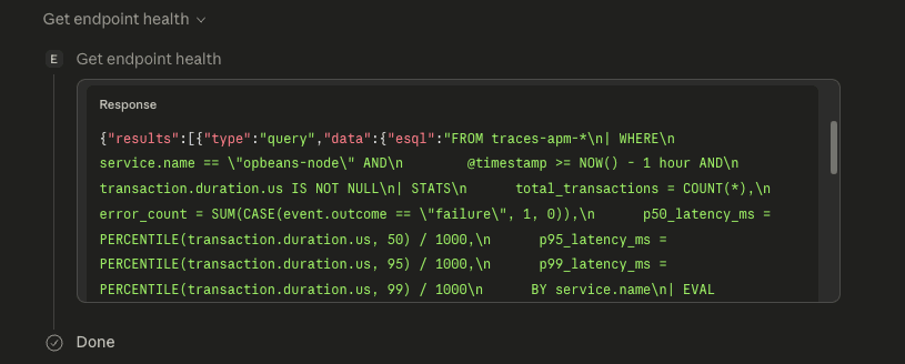

Building Tool 1: get_endpoint_health
This tool answers the question: "How is this endpoint performing right now?" It returns error rate, latency percentiles (p50, p95, p99), and throughput for a given service and endpoint within a time window.
Here is the full tool configuration as created in Agent Builder:
  "id": "get_endpoint_health",
  "type": "esql",
  "description": "Returns the current health of a service endpoint: error rate, latency percentiles (p50/p95/p99), and throughput. Use this tool to assess whether a service is healthy before making changes. Interpretation guide: error rate below 0.5% is healthy, 0.5-1% is elevated (check for recent deploys), above 1% indicates a problem. For latency, compare p99 against the service baseline: checkout is typically under 500ms, product-search under 200ms. A sudden p99 spike within 15 minutes of a deploy suggests the deploy caused a regression.",
  "tags": ["apm", "reliability", "health"],
  "configuration": {
    "query": "FROM traces-apm-* | WHERE service.name == ?serviceName AND @timestamp >= NOW() - ?timeWindow AND transaction.duration.us IS NOT NULL | STATS total_transactions = COUNT(*), error_count = SUM(CASE(event.outcome == \"failure\", 1, 0)), p50_latency_ms = PERCENTILE(transaction.duration.us, 50) / 1000, p95_latency_ms = PERCENTILE(transaction.duration.us, 95) / 1000, p99_latency_ms = PERCENTILE(transaction.duration.us, 99) / 1000 BY service.name | EVAL error_rate_pct = ROUND(error_count / total_transactions * 100, 2) | EVAL throughput_per_min = ROUND(total_transactions / ?windowMinutes, 1)",
    "params": {
      "serviceName": {
        "type": "keyword",
        "description": "The APM service name to check (e.g., opbeans-node)"
      "timeWindow": {
        "type": "keyword",
        "description": "Time window to analyze, in ES|QL duration format (e.g., 30 minutes, 1 hour, 6 hours)"
      "windowMinutes": {
        "type": "integer",
        "description": "Time window in minutes, used to calculate throughput per minute"
The query uses the traces-apm-* data stream, which contains raw transaction data. We filter with transaction.duration.us IS NOT NULL to select only transaction events (excluding spans). Using traces-apm-* is more portable than the pre-aggregated metrics-apm.transaction.1m-* stream, which only populates after sustained traffic.
Notice the description field. It is not just "returns health metrics." It includes interpretation rules: what error rate thresholds mean, what latency baselines look like, and how to correlate spikes with deploys. This is the runbook encoded in the tool.

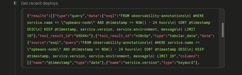

Building Tool 2: get_recent_deploys
This tool answers: "What has been deployed recently?" Deploy history is a critical context because most production issues correlate with code changes. The agent needs this to reason about whether current metrics are normal or reflect a recent deployment.
Deploy annotations are stored in the observability-annotations index. Here is the full tool configuration:
  "id": "get_recent_deploys",
  "type": "esql",
  "description": "Returns the deployment history for a service over the last 24 hours, including version numbers, timestamps, and deploy messages. Use this tool to understand the deployment timeline when assessing service health. Key patterns: if a deploy happened within the last 15 minutes, elevated error rates or latency may be expected (warm-up period). If metrics degraded immediately after a deploy, the deploy is the likely cause. Multiple deploys in a short window (under 2 hours) increase risk because it becomes harder to isolate which change caused an issue.",
  "tags": ["apm", "deploys", "change-tracking"],
  "configuration": {
    "query": "FROM observability-annotations | WHERE service.name == ?serviceName AND @timestamp >= NOW() - 24 hours | SORT @timestamp DESC | KEEP @timestamp, service.version, service.environment, message | LIMIT 10",
    "params": {
      "serviceName": {
        "type": "keyword",
        "description": "The APM service name to check deploy history for"
Again, the description encodes domain knowledge: the 15-minute warm-up window, the correlation between deploys and metric changes, and the risk of multiple rapid deploys. This is how a platform engineer transfers their intuition into something an AI agent can reason with.

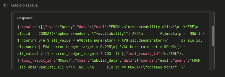

Building Tool 3: get_slo_status
This tool answers: "How much error budget do we have left?" SLO budget is the platform team's quantified way of expressing risk tolerance. If the budget is nearly spent, even a small change could cause a violation.
Unlike the previous tools that query APM data, this one queries the internal SLO indices where Elastic stores pre-computed SLI data. The query calculates the current burn rate, that is, how fast the service is consuming error budget relative to the allowed threshold:
  "id": "get_slo_status",
  "type": "esql",
  "description": "Returns the current SLO burn rate for a service over the last hour. The response includes: SLI value (current performance), error budget target, and burn rate percentage. The burn rate tells you how fast the service is consuming error budget relative to the allowed threshold. Interpretation: a burn rate below 100% means the service is consuming budget slower than the limit (sustainable). Between 100-200%, the service is burning budget faster than planned (proceed with caution). Above 200%, the service is burning budget at double the allowed rate (delay non-critical changes). Above 500%, investigate immediately. Note: this measures the current burn rate over the last hour, not cumulative budget consumption over the full SLO window. A temporarily high burn rate does not mean the overall budget is exhausted.",
  "tags": ["slo", "reliability", "budget"],
  "configuration": {
    "query": "FROM .slo-observability.sli-v* | WHERE slo.id == ?sloId AND @timestamp >= NOW() - 1 hour | STATS sli_value = AVG(slo.numerator) / AVG(slo.denominator) BY slo.id, slo.name | EVAL error_budget_target = 0.995 | EVAL burn_rate_pct = ROUND((1 - sli_value) / (1 - error_budget_target) * 100, 1)",
    "params": {
      "sloId": {
        "type": "keyword",
        "description": "The SLO identifier. Use the SLO ID for the service you are evaluating."
Note on the SLI index: the version suffix in .slo-observability.sli-v* depends on your Stack release (e.g., v3.6 in Stack 9.3). Verify with GET _cat/indices/.slo-observability.*?v and adjust the pattern if your cluster uses a different version.
The burn rate interpretation rules in the description are the most valuable part. A raw number like "burn rate 85%" means nothing to a developer without context. The tool description translates that into actionable guidance: "below 100% means sustainable, above 200% means delay non-critical changes."

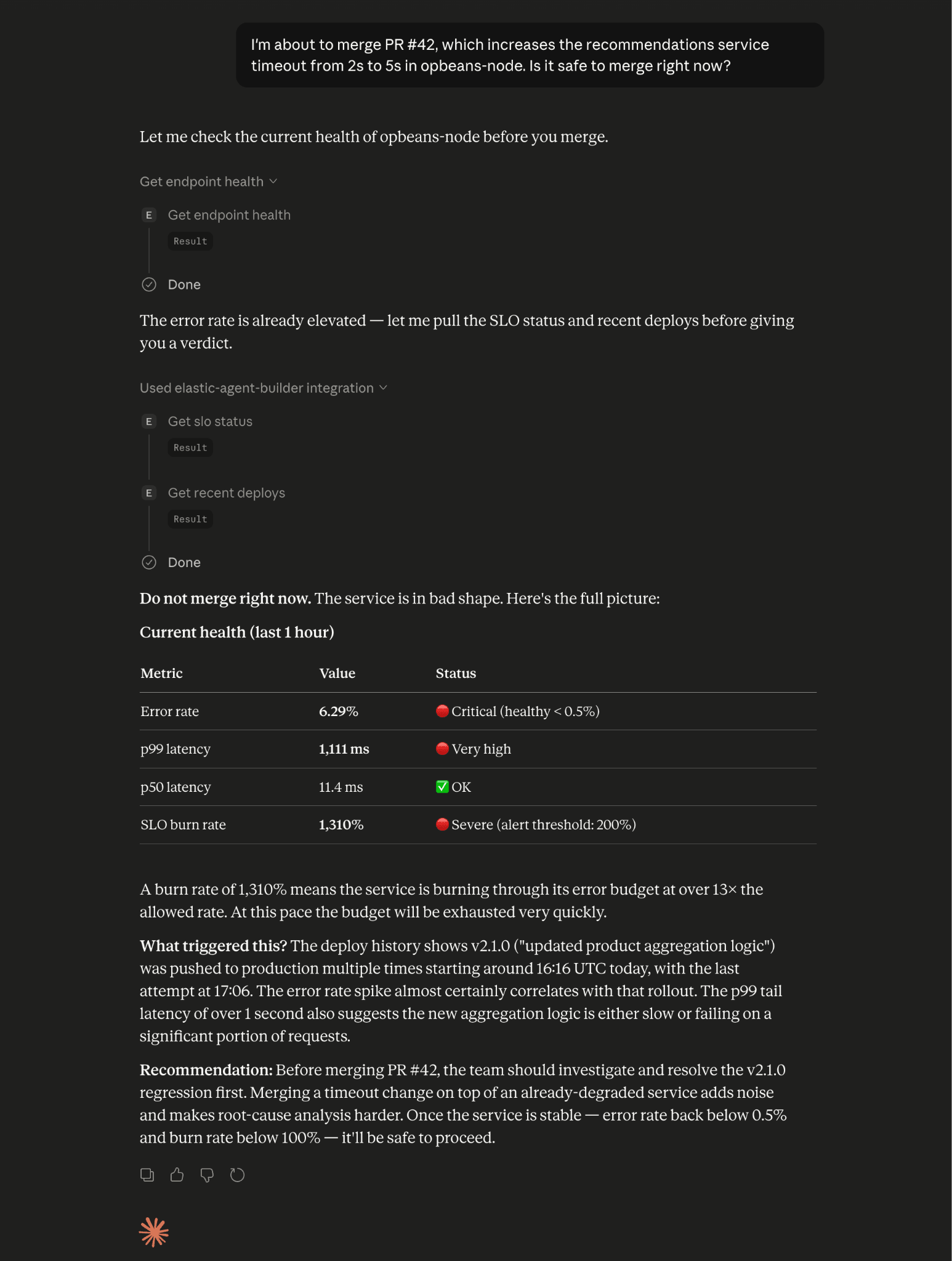

A developer on the team has a pull request that increases the timeout for the downstream recommendations service call from 2 seconds to 5 seconds in opbeans-node. Before merging, they ask the agent:
Developer: "I'm about to merge PR #42, which increases the recommendations service timeout from 2s to 5s in opbeans-node. Is it safe to merge right now?"
The agent begins its multi-signal reasoning chain. Here is what happens.
Step 1: the agent calls get_endpoint_health
The agent checks the current health of the service:
Step 2: the agent calls get_recent_deploys
Next, it checks for recent deployments:
Step 3: the agent calls get_slo_status
The agent's response
After correlating all three results, the agent produces a recommendation:
The agent pulled the current p99, checked recent deploys, and read the SLO burn rate. It combined those signals with the timeout change in the PR, flagged the merge as risky, and recommended next steps.
