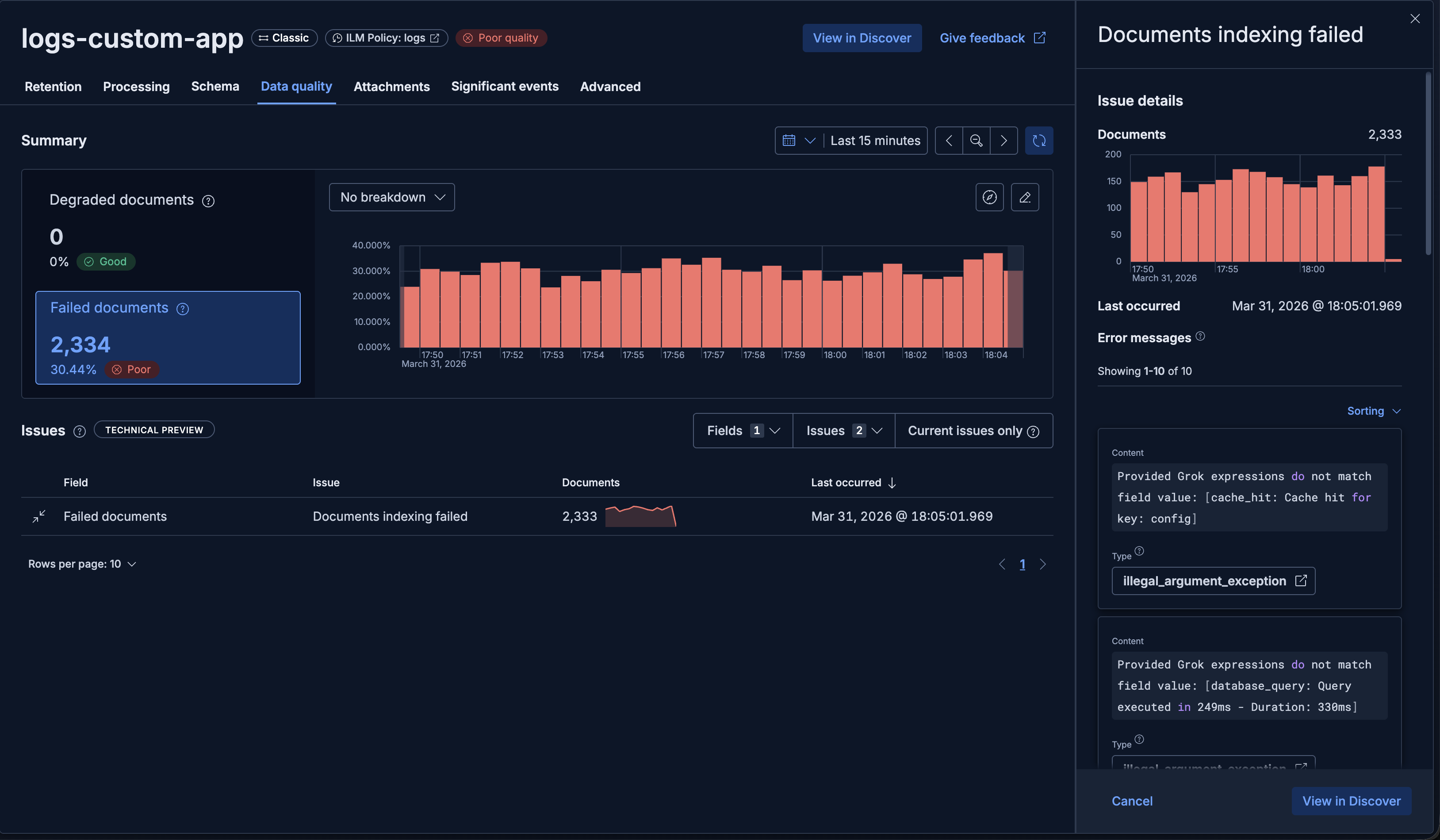

The Data quality tab gives you insights into the quality of your stream and into documents in the failure store. When failures are accumulating, you'll see a rising count of failed documents along with the error type and a sample of the messages that triggered it.
The Data quality tab showing a rising failure count, error type, and a sample of the documents that triggered it.
A Grok expression mismatch (illegal_argument_exception) is sending documents to the failure store. The raw log line doesn't match the expected pattern. The documents aren't dropped. They're in the failure store, ready to debug against.

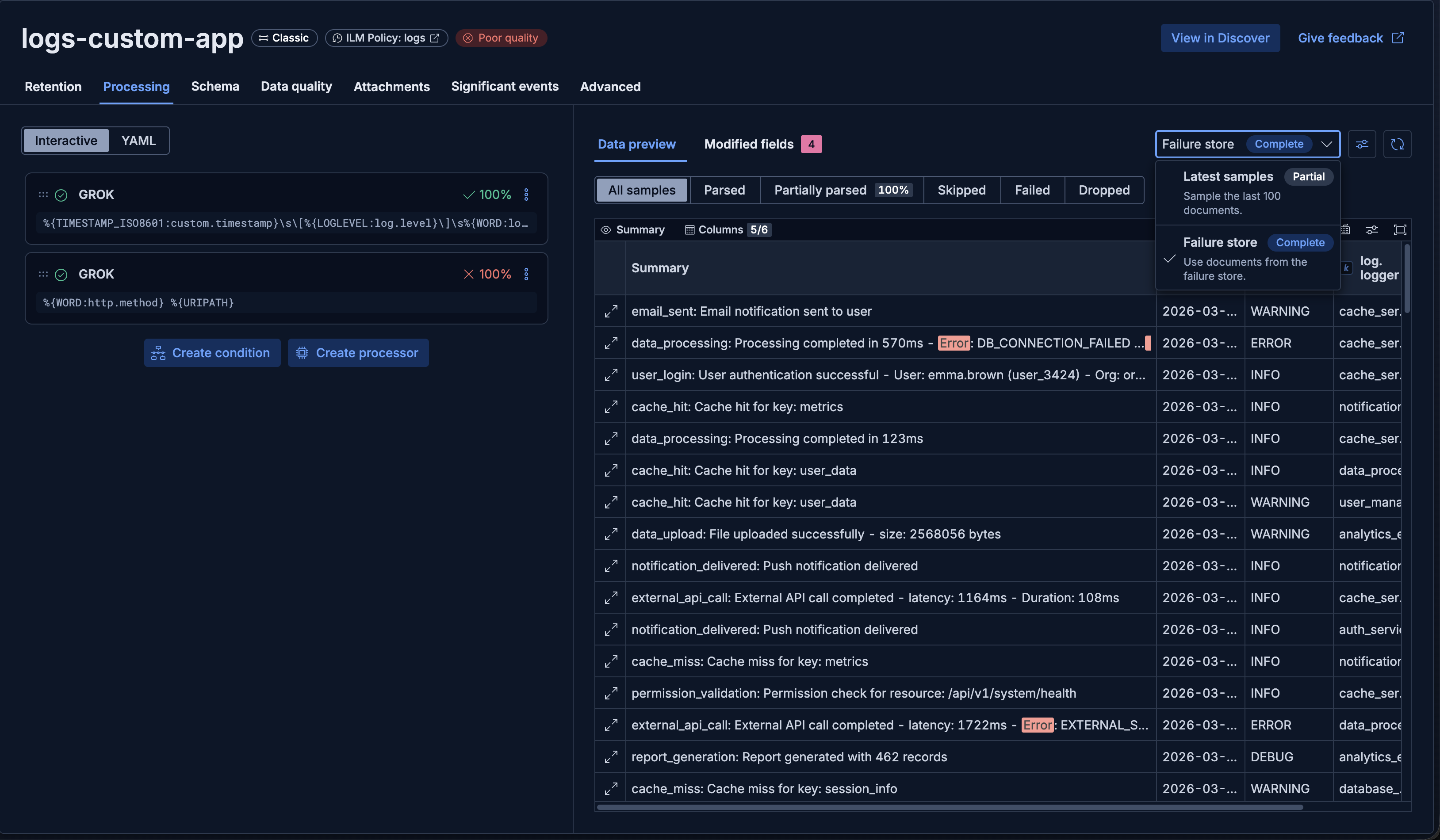

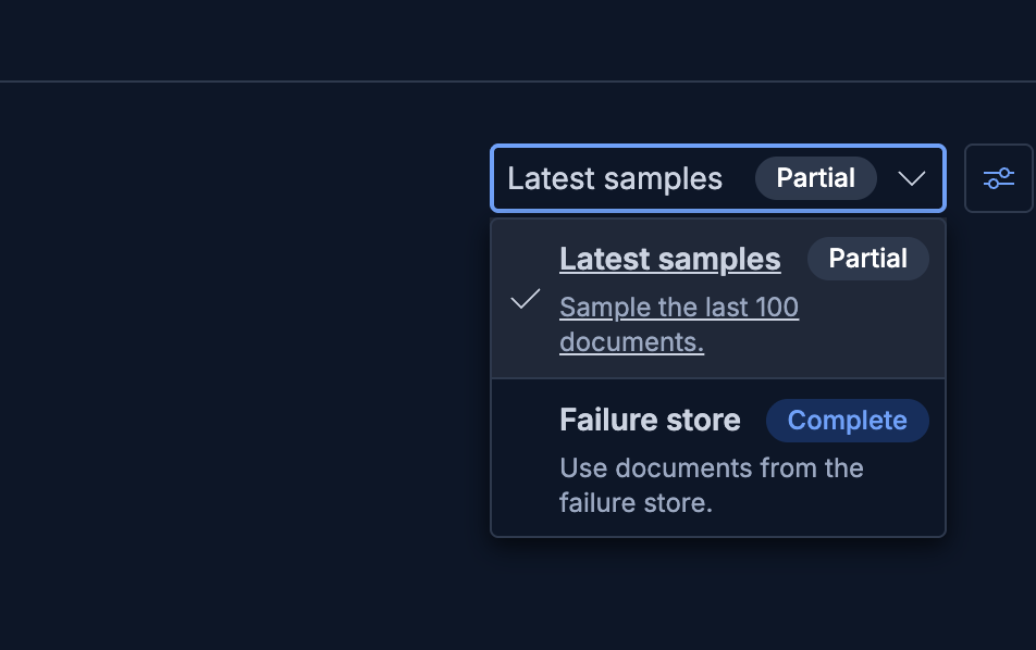

By default, the editor samples from recent live documents. Switch the sample source to Failure store instead: it loads the exact documents that failed, the unmodified originals before any Streams processing ran. You're iterating against the actual failures.
Change the sample source dropdown from the default to Failure store.
The sample source dropdown with the Failure store option selected.
The editor loads up to 100 documents from the failure store and runs them through the current pipeline. You can see exactly where parsing breaks down.
The pipeline editor loaded with documents from the failure store instead of recent live samples.

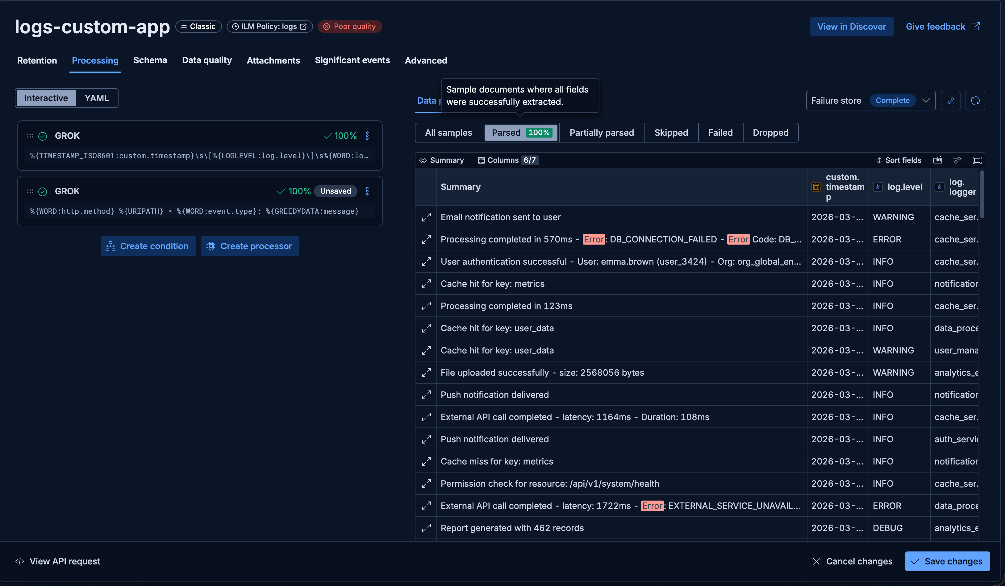

The fix is a second pattern to handle the new format:
%{WORD:event.type}: %{GREEDYDATA:message}
Add it to the processor, and the editor immediately shows both log types parsing correctly against the failure store samples.
When the sample view shows all fields extracting correctly and the parse rate hits 100%, the fix is ready.
Both log types parsing correctly after adding the second Grok pattern. Parse rate at 100%.
No guessing — the editor confirms the fix before you save.

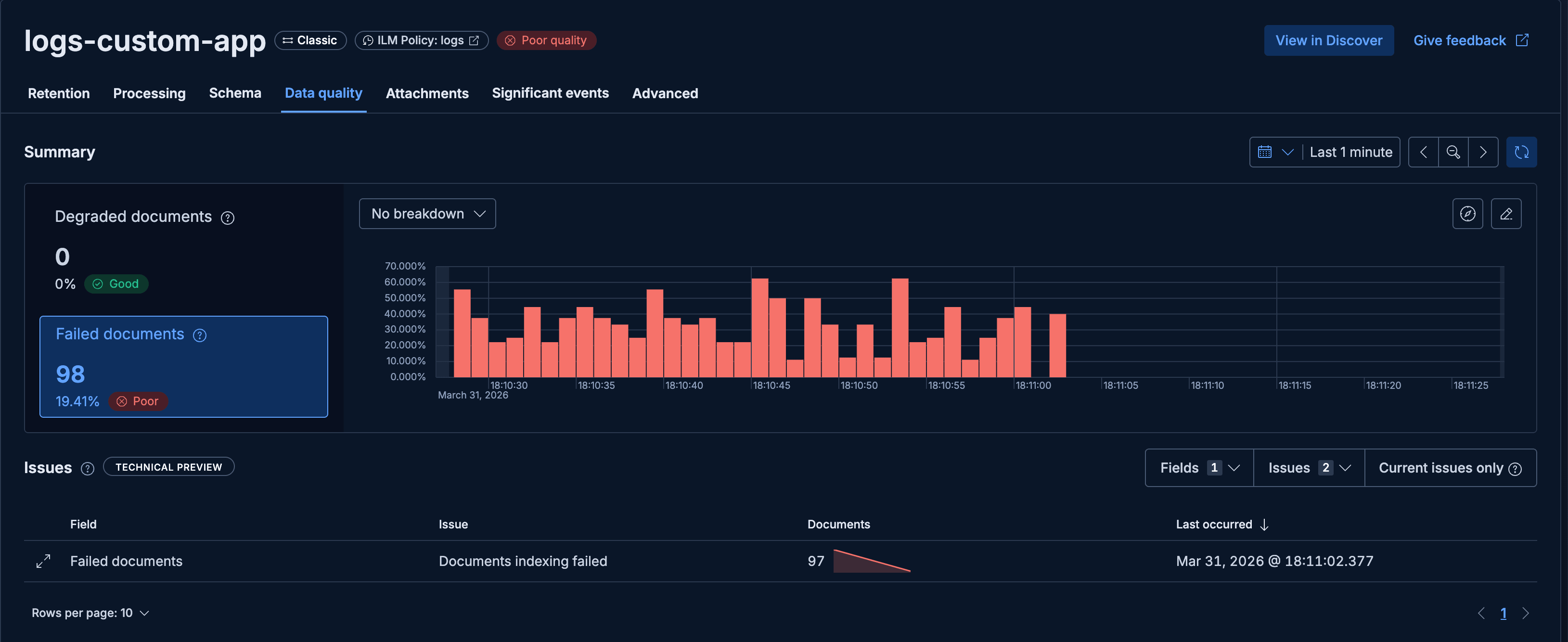

Watch the failure count drop
Save the updated pipeline. New documents are now processed with the corrected pipeline. Switch back to the Data quality tab and watch the failure count.
The failure count dropping as new documents are processed by the corrected pipeline.
The count drops as the fixed pipeline handles new incoming data correctly. The remaining documents in the failure store are the pre-fix failures. They'll clear out as retention ages them off.
