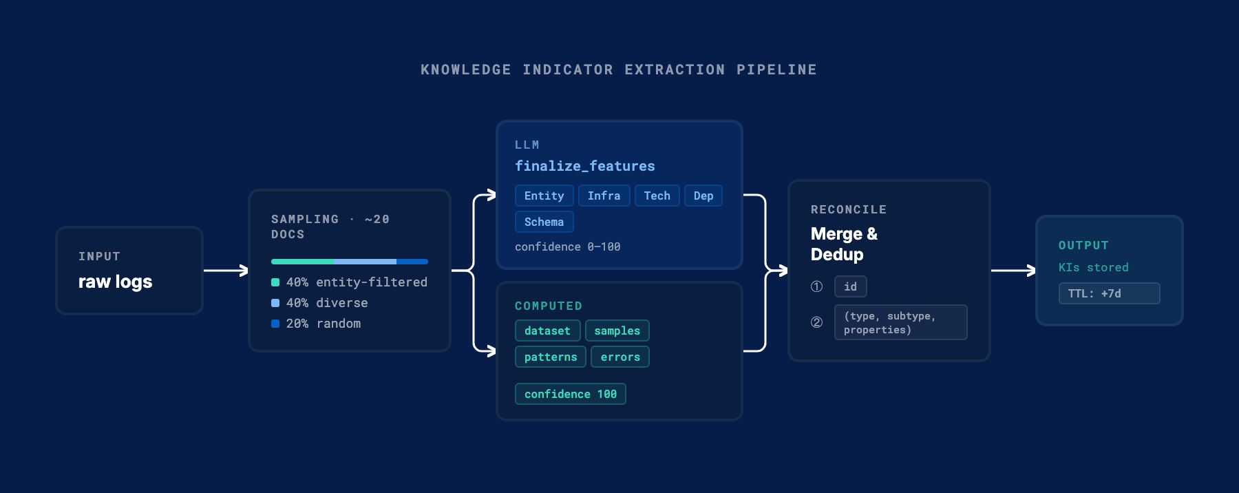

The pipeline itself runs multiple iterations, each time fetching a small sample of documents. We use a mix of random and already-excluded documents to ensure we discover the full scope of the system. KIs found in one iteration are fed back as exclusions into the next, so each round focuses on what the previous one missed—ensuring quieter, less-represented services aren't crowded out by noisier ones.
Extraction pipeline: biased document sampling feeds a parallel LLM pass and four deterministic generators. Results are merged and deduplicated before storage.
Once sampled, the documents are sent to an LLM. We use a system prompt that instructs the model to identify a few specific types of features, which we plan to extend over time:
TypeWhat it captures
EntityDistinct system components: services, applications, jobs
InfrastructureEnvironment context: Kubernetes, cloud provider, OS
TechnologyLanguages, frameworks, libraries, databases
DependencyRelationships between components
SchemaLog format conventions: ECS, OTel, custom
The LLM returns its findings, delivering newly identified traits alongside any intentionally ignored ones (like user-excluded false positives). To be accepted, every feature must include stable identifying properties and cite direct evidence from the sampled logs. The LLM also assigns a confidence score from 0–100 for each KI, so any downstream use of that KI knows how much to trust it.
In parallel, a set of deterministic code-based generators independently analyze the data to produce statistical summaries, log samples, pattern clusters, and error-specific features. Because these are computed rather than inferred, they always receive a confidence score of 100.
Finally, the LLM results and computed features are merged and deduplicated. Known KIs reuse their existing UUIDs, new discoveries get fresh ones, and any user-excluded features are quietly dropped server-side. Surviving KIs are saved with an active status and an expiration date set for seven days out.

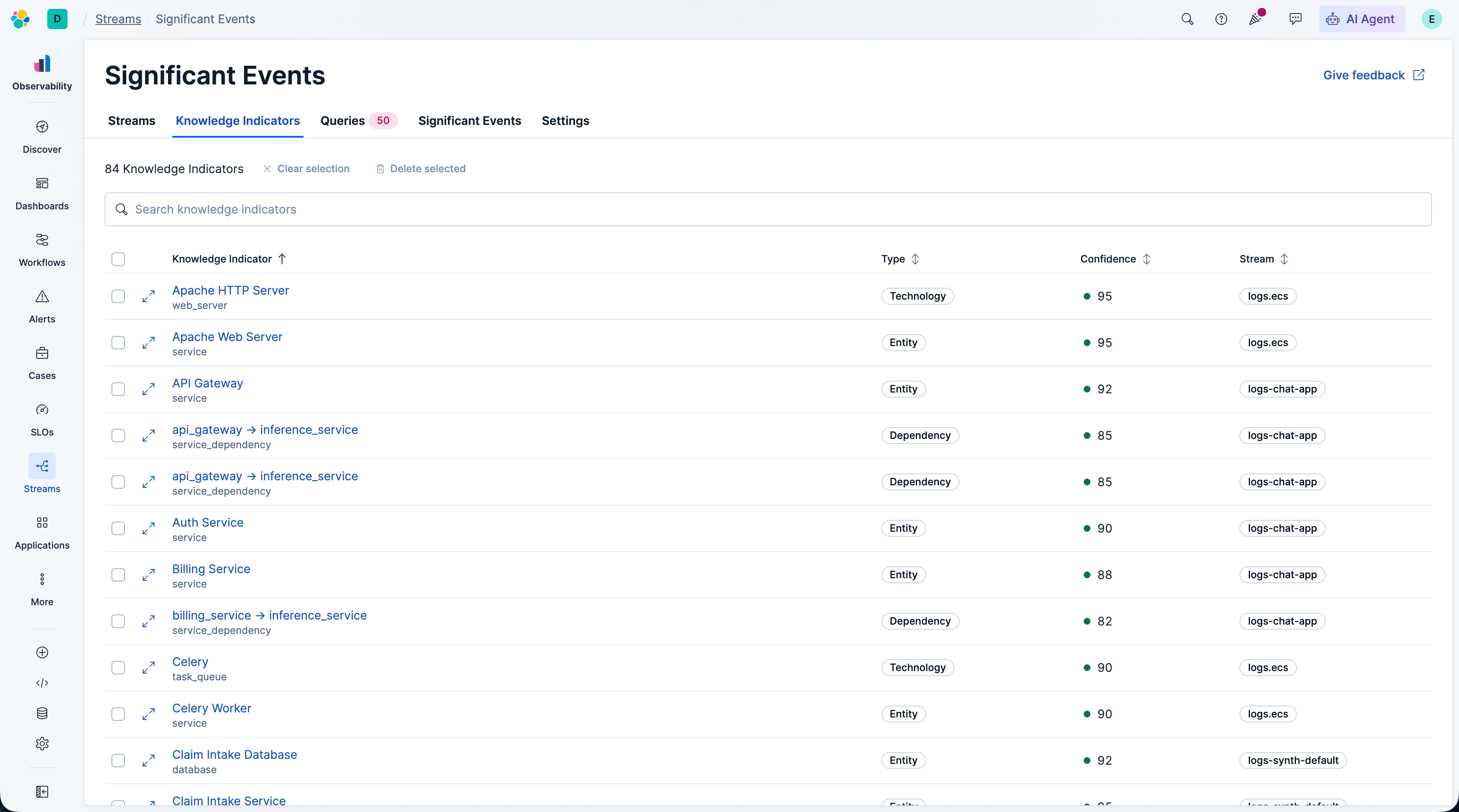

Knowledge Indicators tab showing 84 KIs across streams, with type, confidence (1–5 stars), and stream columns.

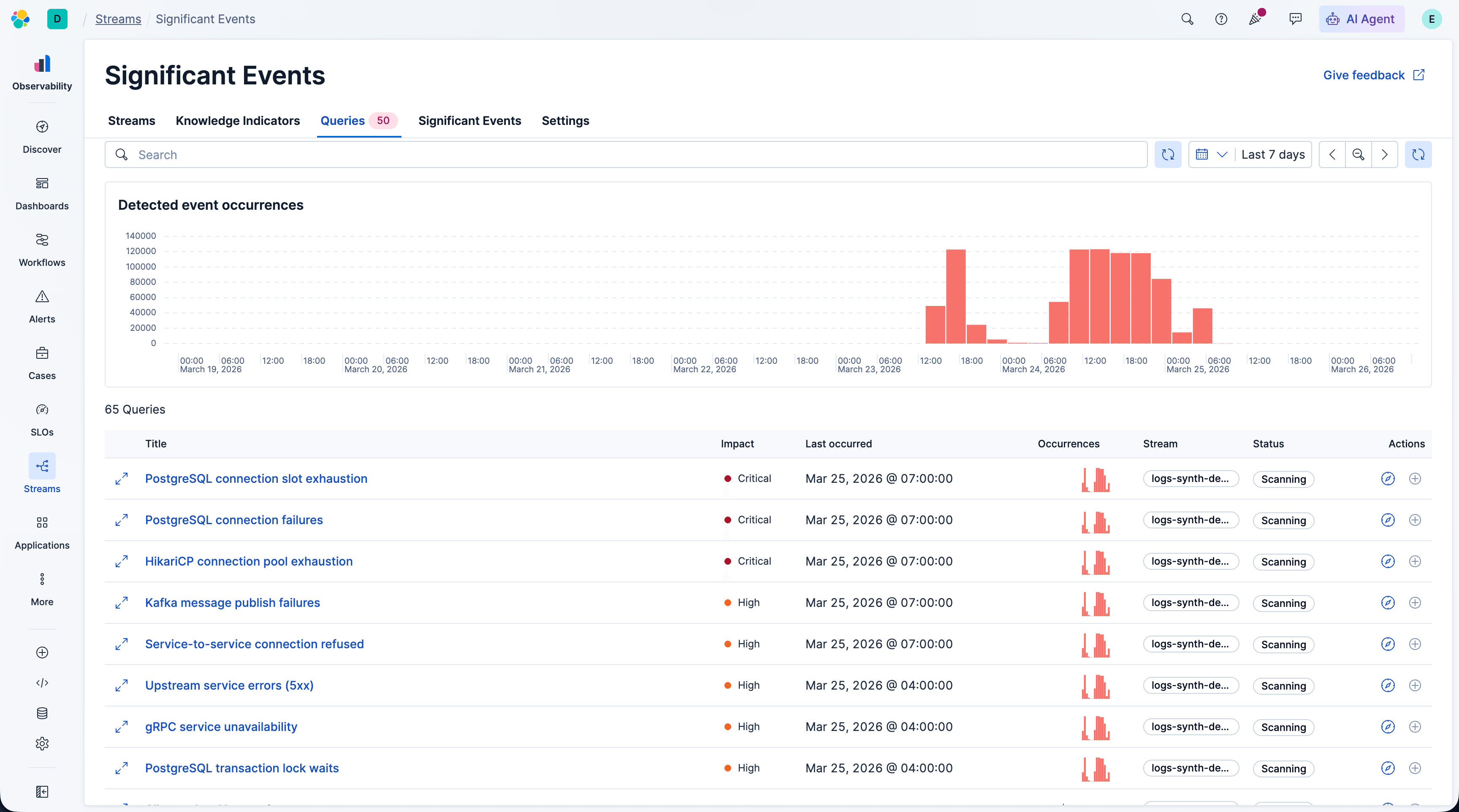

Query KIs are actionable. They are ready-to-run ES|QL queries targeting notable conditions like connection exhaustion, out-of-memory errors, or fatal exceptions. Each comes with a severity score from 0 to 100, and when promoted to Rules, they fire Events.

Query KIs take a simpler shape, focusing solely on the title, severity score, and the executable query:
  "kind": "query",
  "title": "PostgreSQL connection slot exhaustion",
  "description": "Fires when Postgres runs out of available connection slots",
  "severity_score": 90,
  "esql": {
    "query": "FROM logs-* | WHERE service.name == \"postgres\" AND message : \"remaining connection slots\""

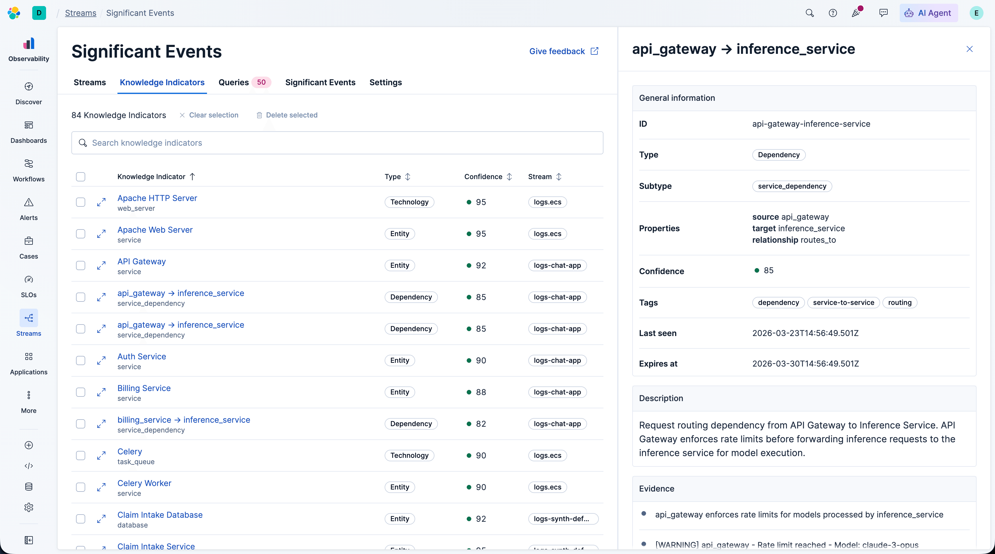

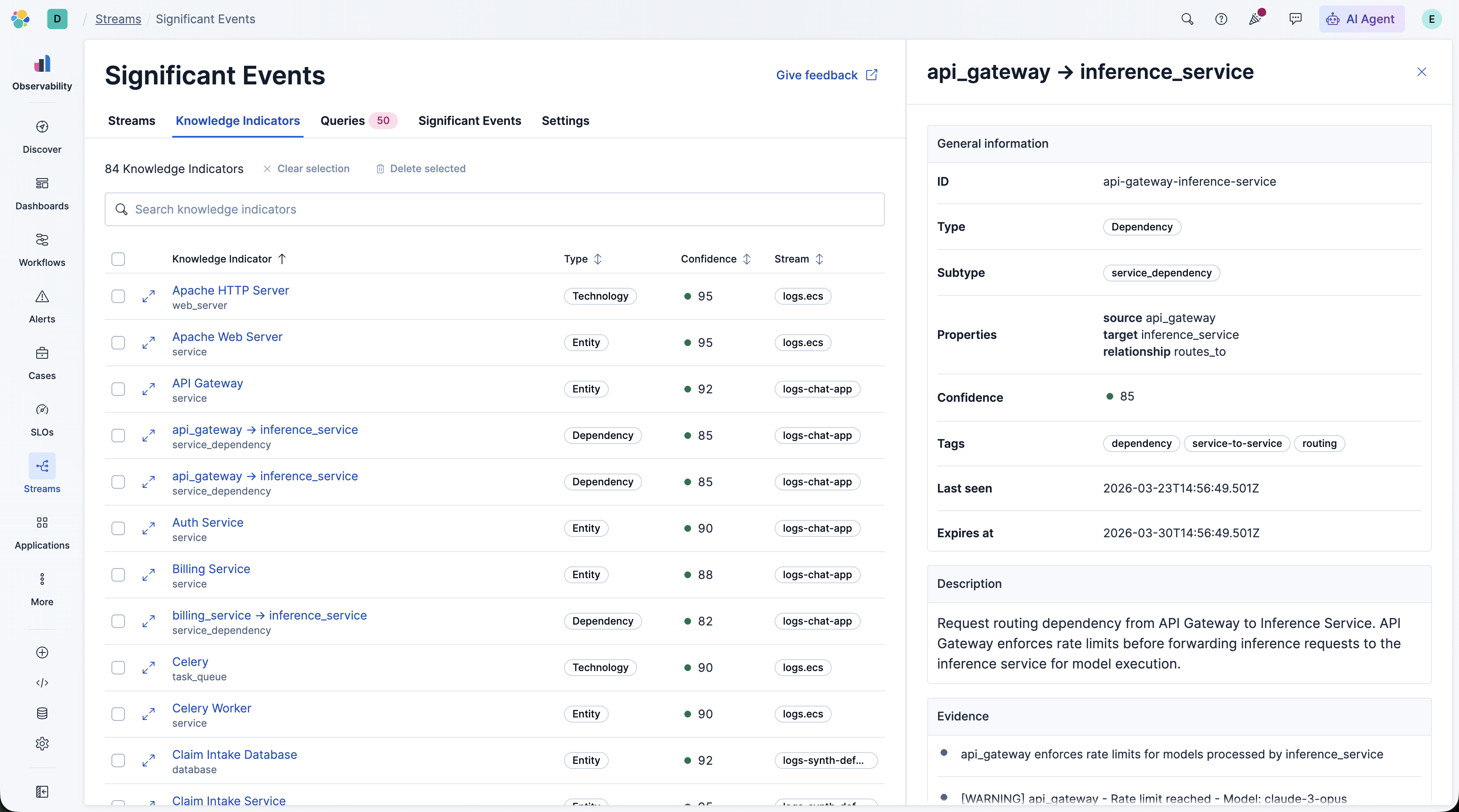

The properties field is what keeps Feature KIs stable across multiple pipeline runs. The dependency KI for api_gateway → inference_service records the source, target, and protocol as fixed pairs. The next time extraction runs, Elastic recognizes this existing relationship and updates the KI's last_seen timestamp rather than creating a duplicate.
KI detail panel showing type, subtype, properties, confidence, evidence, and expiry date for a service dependency.

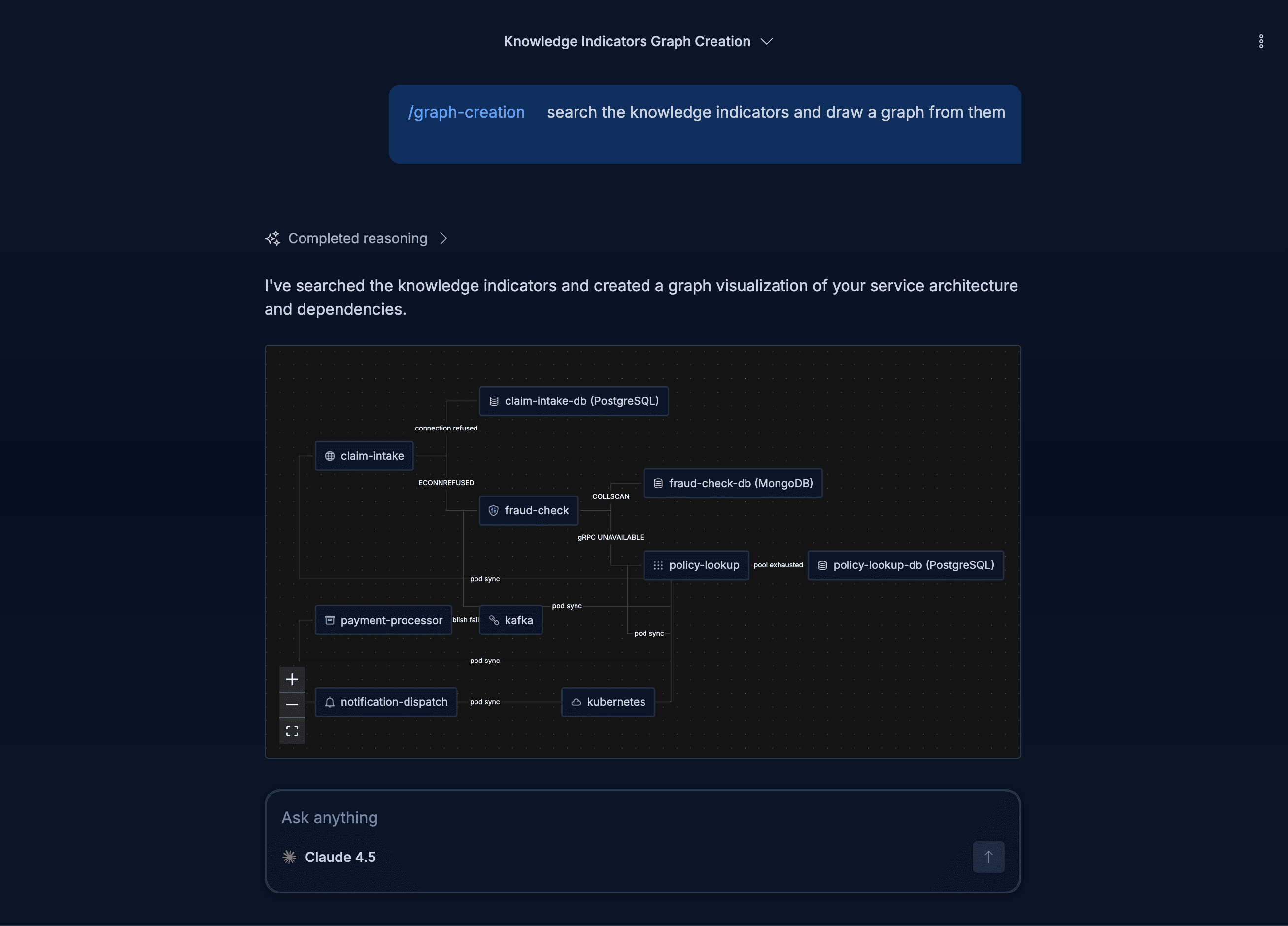

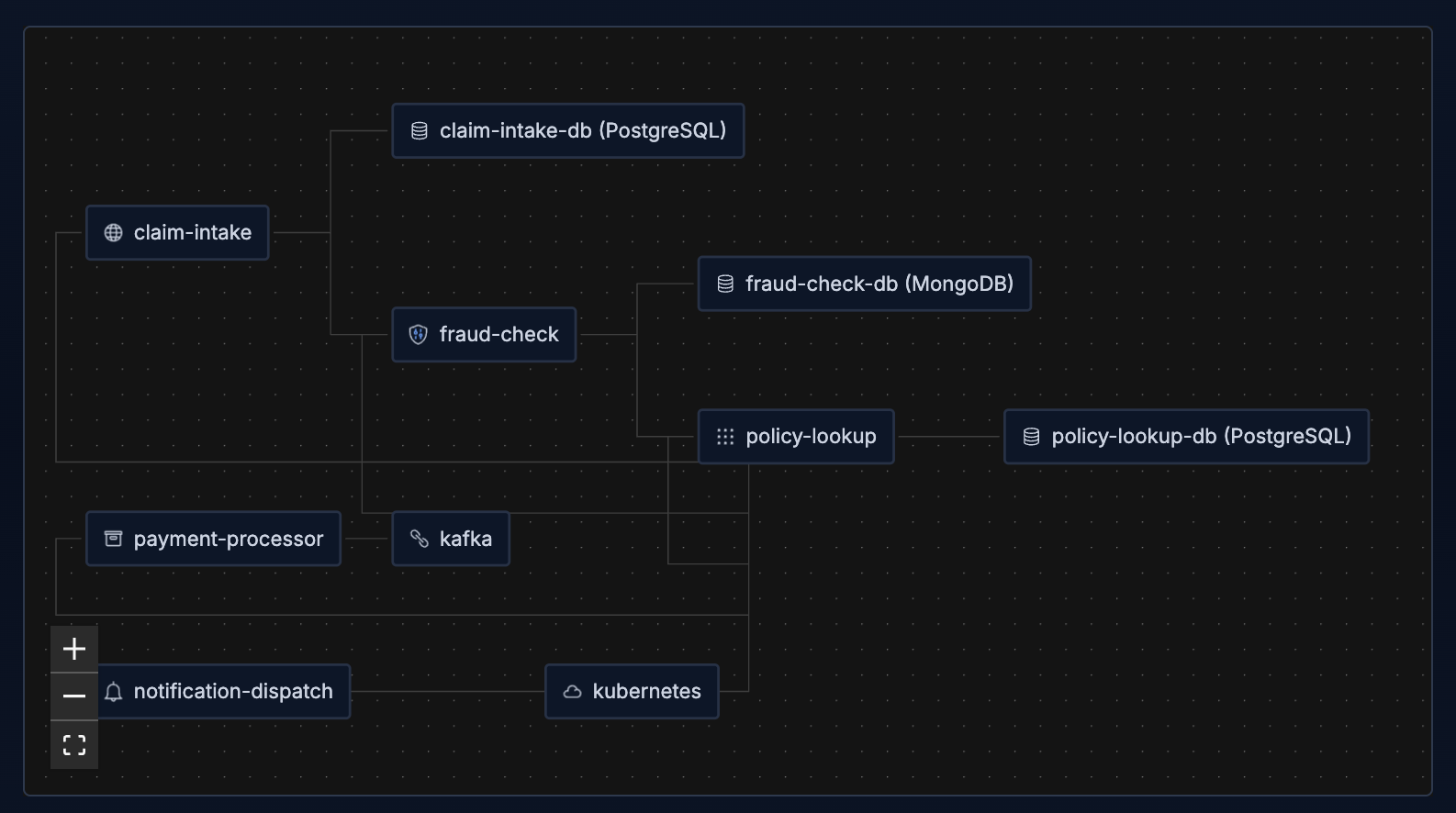

As a user or an agent, the dependency KIs automatically construct an infrastructure graph—inferred entirely from log data, not from distributed tracing or any manual configuration. During an incident, this graph is invaluable for assessing blast radius. If a specific database goes down, the topology map immediately shows you exactly which upstream services are about to fail, without maintaining a manual service catalog.
Service dependency graph extracted from KIs, showing services, databases, and infrastructure components.
This context changes how an AI agent handles an incident. Instead of starting from scratch, the agent initiates its investigation using your system's actual topology and known failure modes. Based on the KIs, it identifies the relevant streams, runs the applicable queries, and formulates a specific hypothesis. In our example, it already knows that api_gateway relies on inference_service, and it knows that connection slot exhaustion is a high-severity failure mode for your Postgres instance.
