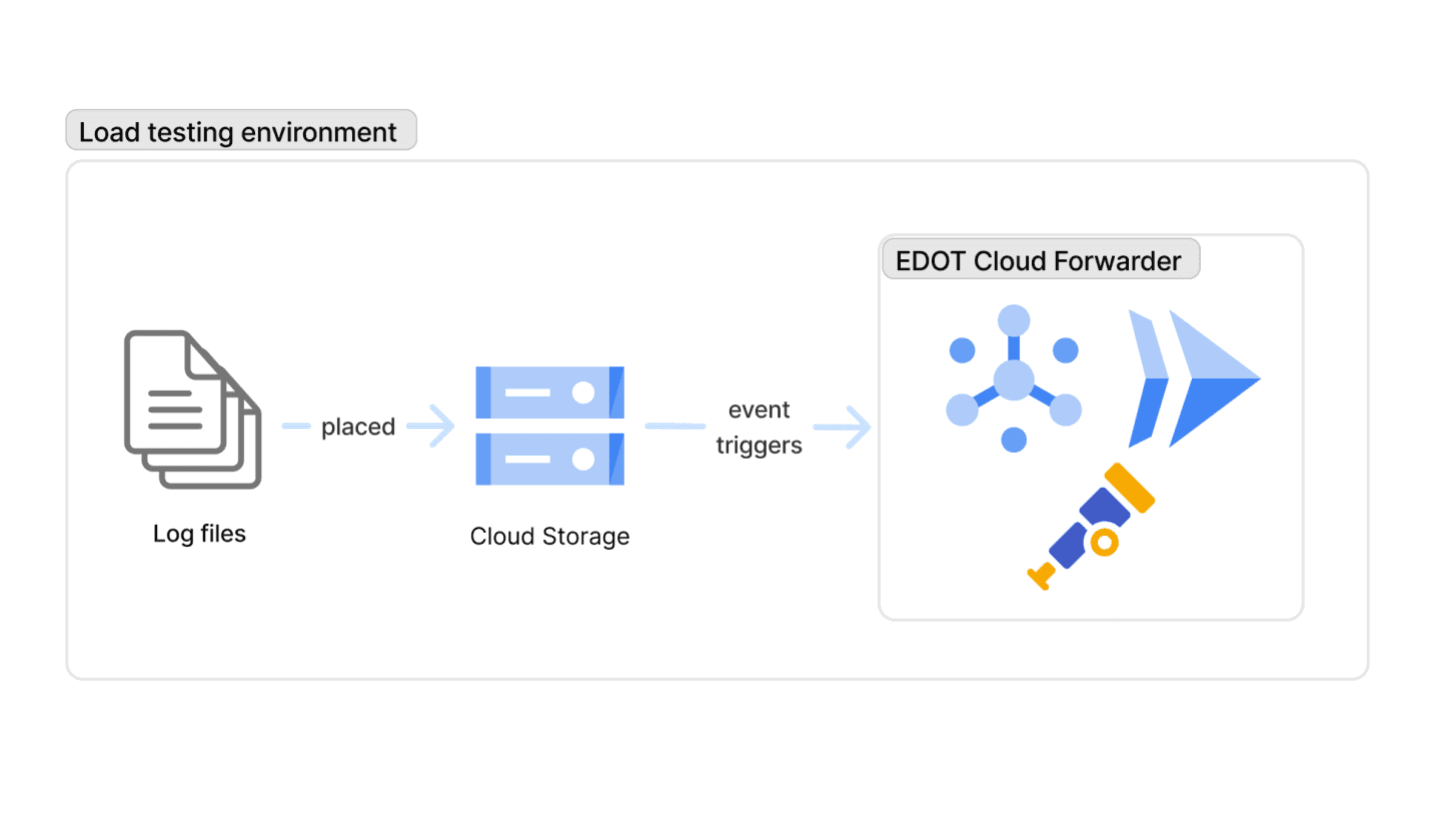

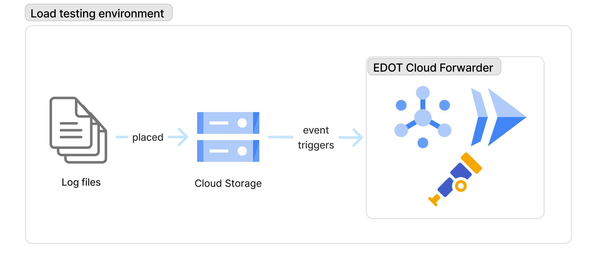

Architecture
The load testing architecture simulates a realistic, high-volume pipeline:
  1. We developed a load tester service that uploads generated log files to a GCS bucket as fast as possible.
  2. Each file creation in this Google Cloud Storage (GCS) bucket then triggers an event notification to Pub/Sub.
  3. Pub/Sub delivers push messages to a Cloud Run service where EDOT Cloud Forwarder fetches and processes these log files.

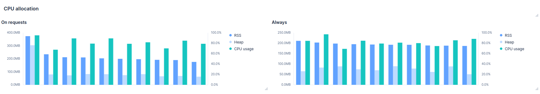

CPU allocation: Stop starving the garbage collector
Cloud Run offers two CPU allocation modes:
  • Request-based (throttled). Enabled with cpu_idle: true. CPU is available only while a request is actively being processed.
  • Instance-based (always on). Enabled with cpu_idle: false. CPU remains available when idle, allowing background work such as garbage collection to run.
The tests compared these modes under identical conditions:
ParameterValue
vCPU1
Memory4 GiB (high enough to remove OOM as a factor)
GOMEMLIMIT90% of memory
GOGCDefault (unset)
Concurrency10
What we observed
With CPU allocated only on requests (cpu_idle: true):
  • Memory variance was extreme (±71% RSS, ±213% heap).
  • Peak heap reached ~304 MB in the worst run.
  • We saw request refusals in the sample (90% success rate).
With CPU always allocated (cpu_idle: false):
  • Memory variance became tightly bounded (±8% RSS, ±32% heap).
  • Peak heap dropped to ~89 MB in the worst run.
  • We saw no refusals in the sample (100% success).
From these runs we saw:
  • When CPU is throttled, the Go garbage collector is effectively starved, leading to heap accumulation and large run-to-run variance.
  • When CPU is always available, garbage collection keeps pace with allocation, resulting in lower and more predictable memory usage.
Takeaway: for this set of tests, cpu_idle: false was the most stable baseline configuration. Request-based CPU throttling introduced artificial instability that makes capacity planning much harder.

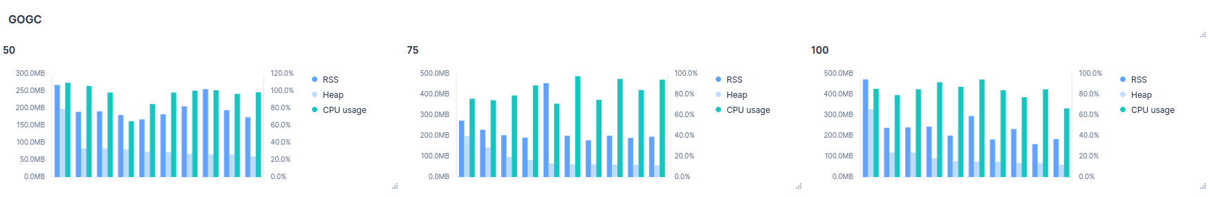

GOGC: memory savings vs. reliability
The GOGC parameter controls how much the heap can grow (in %) between GC cycles:
  • Lower values (e.g., GOGC=50): more frequent collections, lower memory, higher CPU.
  • Higher values (e.g., GOGC=100): fewer collections, higher memory, lower CPU.
The tests covered: (1) GOGC=50 (aggressive); (2) GOGC=75 (moderate); (3) GOGC=100 (default/unset).
Setup:
ParameterValue
Container memory4 GiB (high enough to remove OOM as a factor)
vCPU1
Concurrency10 (safe level)
cpu_idlefalse
What we observed
From the runs:
GOGCPeak RSS (sample)CPU behaviorFailure rateNotes
50~267 MBVery high; often saturating30%GC consumed cycles needed for ingestion
75~454 MB~83.5% avg10%GC consumed cycles needed for ingestion
100 (default)~472 MB~83.5% avg; leaves headroom for bursts0%
The conclusion from these runs is clear: pushing GOGC down trades memory for reliability, and the trade is not favorable for ECF.
Takeaway: for this workload, the default GOGC=100 provided the best balance. Attempts to optimize memory by lowering GOGC directly reduced reliability.

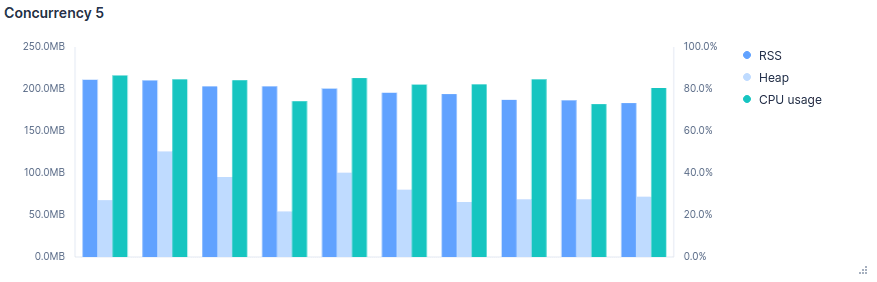

Concurrency 5: Stable baseline
At concurrency 5, the service was solid.
CaseMemory (RSS)CPU utilizationRequests refused
Baseline (lightest workload avg)99.89 MB
Worst run211.02 MB86.43%No
This proved that a single instance handles a moderate load comfortably, with memory usage staying well within safe limits.

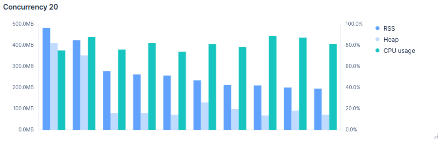

Concurrency 20: Unstable, systemic load shedding
At concurrency 20, the system consistently began shedding load.
Baseline (lightest workload avg)97.44 MB
Worst run482.42 MB88.90%Yes (every run)
Even though memory and CPU metrics don't look drastically worse than at concurrency 10, behavior changes qualitatively: the service begins to refuse requests consistently.
