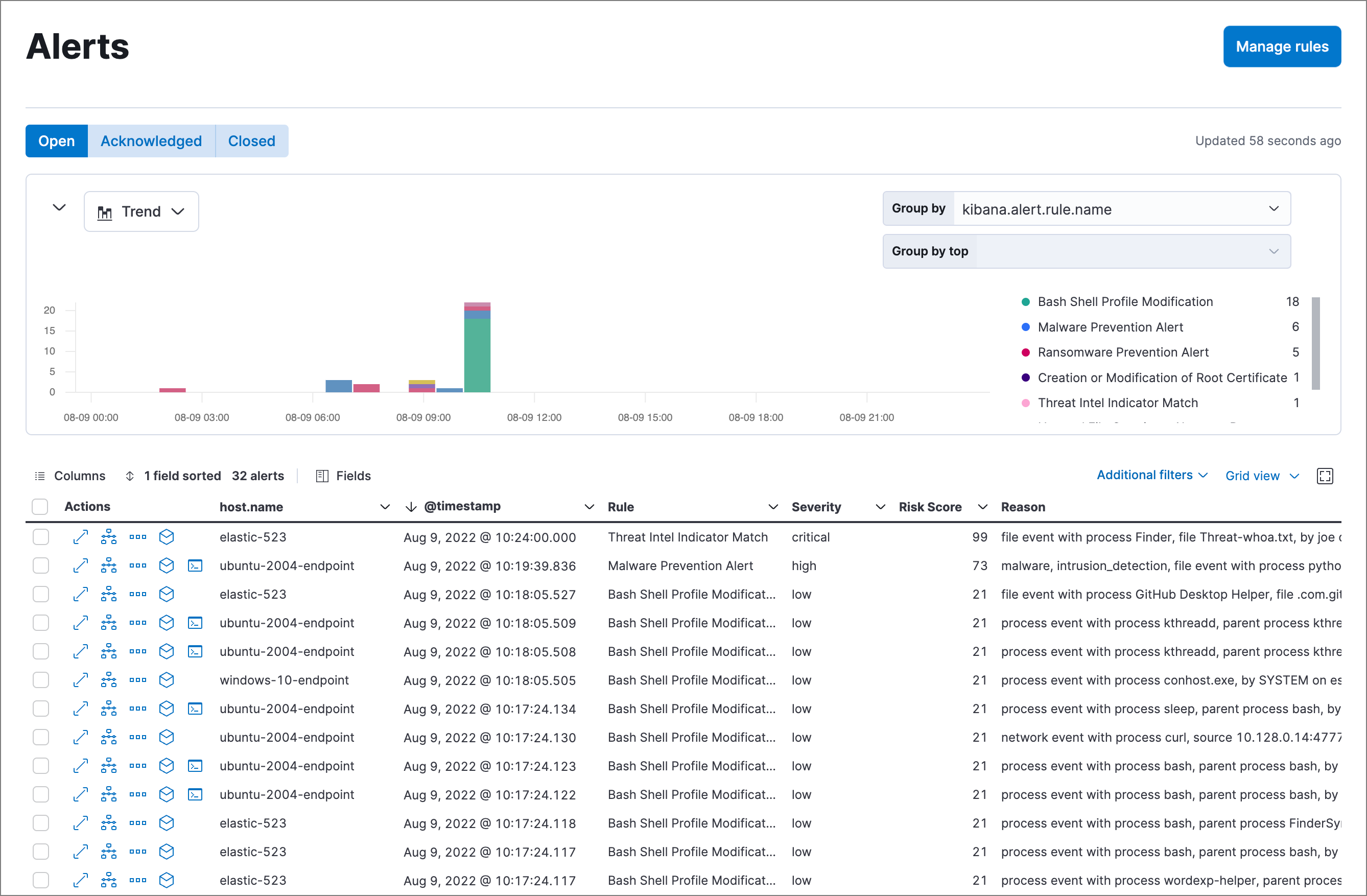

Detections and alertsedit
Use the detection engine to create and manage rules and view the alerts
these rules create. Rules periodically search indices (such as logs-*
and
filebeat-*
) for suspicious source events and create alerts when a rule’s
conditions are met. When an alert is created, its status is Open
. To help
track investigations, an alert’s status can be set as
Open
, Acknowledged
, or Closed
In addition to creating your own rules, enable Elastic prebuilt rules to immediately start detecting suspicious activity. For detailed information on all the prebuilt rules, see the Prebuilt rule reference section. Once the prebuilt rules are loaded and running, Tune detection rules and Add and manage exceptions explain how to modify the rules to reduce false positives and get a better set of actionable alerts. You can also use exceptions and value lists when creating or modifying your own rules.
