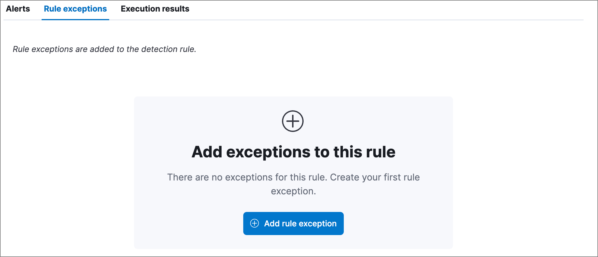

    • To add an exception from the rule details page:
      1. Go to the rule details page of the rule to which you want to add an exception (ManageRulesRule name).
      2. Scroll down the rule details page, select the Rule exceptions tab, then click Add rule exception.
        Detail of rule exceptions tab

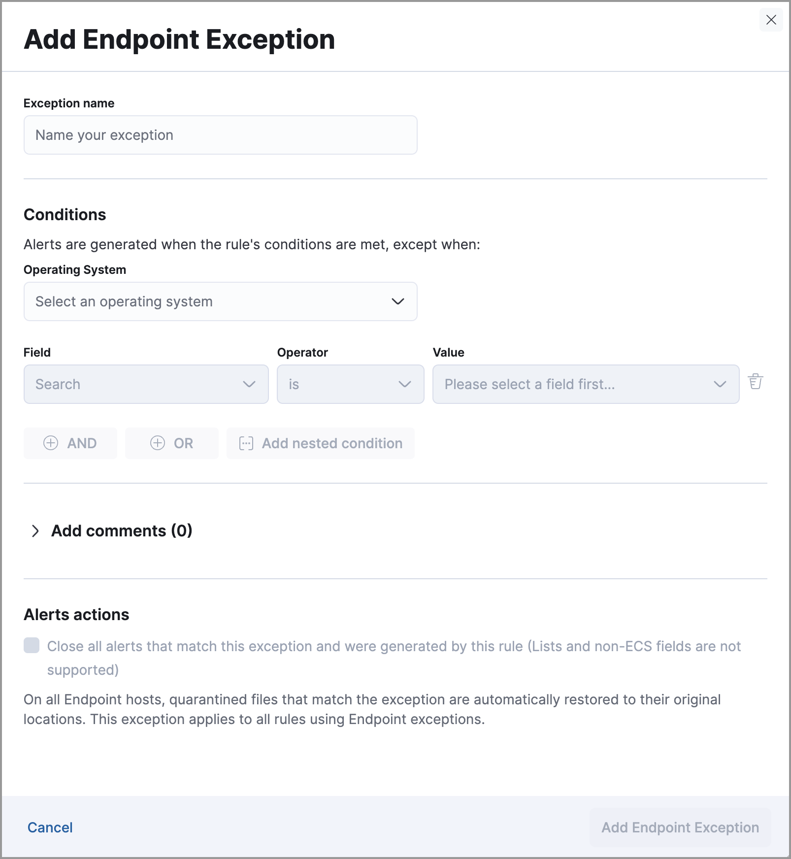

Add Elastic Endpoint exceptionsedit
Like detection rule exceptions, you can add Endpoint agent exceptions either by editing the Endpoint Security rule or by adding them as actions on alerts generated by the Endpoint Security rule. Elastic Endpoint alerts have the following fields:
  • kibana.alert.original_event.module determined:endpoint
  • kibana.alert.original_event.kind:alert
You can also add Endpoint exceptions to rules that are associated with Elastic Endpoint rule exceptions. To associate rules when creating or editing a rule, select the Elastic Endpoint exceptions option.
Endpoint exceptions are added to the Endpoint Security rule and the Elastic Endpoint on your hosts.
Exceptions added to the Endpoint Security rule affect all alerts sent from the Endpoint agent. Be careful not to unintentionally prevent useful Endpoint alerts.
Additionally, to add an Endpoint exception to the Endpoint Security rule, there must be at least one Endpoint Security alert generated in the system. For non-production use, if no alerts exist, you can trigger a test alert using malware emulation techniques or tools such as the Anti Malware Testfile from the European Institute for Computer Anti-Virus Research (EICAR).
Binary fields are not supported in detection rule exceptions.
  1. Do one of the following:
    • To add an Endpoint exception from the rule details page:
      1. Go to the rule details page (ManageRules), and then search for and select the Elastic Endpoint Security rule.
      2. Scroll down the rule details page, select the Endpoint exceptions tab, then click Add endpoint exception.
    • To add an Endpoint exception from the Alerts table:
      1. Go to Alerts.
      2. Scroll down to the Alerts table, and from an Elastic Endpoint alert, click the More actions menu (…​), then select Add Endpoint exception.
    • To add an Endpoint exception from Shared Exception Lists page:
      1. Go to ManageShared Exception Lists.
      2. Expand the Endpoint Security Exception List or click the list name to open the list’s details page. Next, click Add endpoint exception.
        The Endpoint Security Exception List is automatically created. By default, it’s associated with the Endpoint Security rule and any rules with the Elastic Endpoint exceptions option selected.
    The Add Endpoint Exception flyout opens.
    endpoint add exp
  2. If required, modify the conditions.
    Rule exceptions are case-sensitive, which means that any character that’s entered as an uppercase or lowercase letter will be treated as such. In the event you don’t want a field evaluated as case-sensitive, some ECS fields have a .caseless version that you can use.
    Refer to Exceptions with nested conditions for more information on when nested conditions are required.
  3. You can select any of the following:
    • Close this alert: Closes the alert when the exception is added. This option is only available when adding exceptions from the Alerts table.
    • Close all alerts that match this exception and were generated by this rule: Closes all alerts that match the exception’s conditions.
  4. Click Add Endpoint Exception. An exception is created for both the detection rule and the Elastic Endpoint.
    It might take longer for exceptions to be applied to hosts within larger deployments.

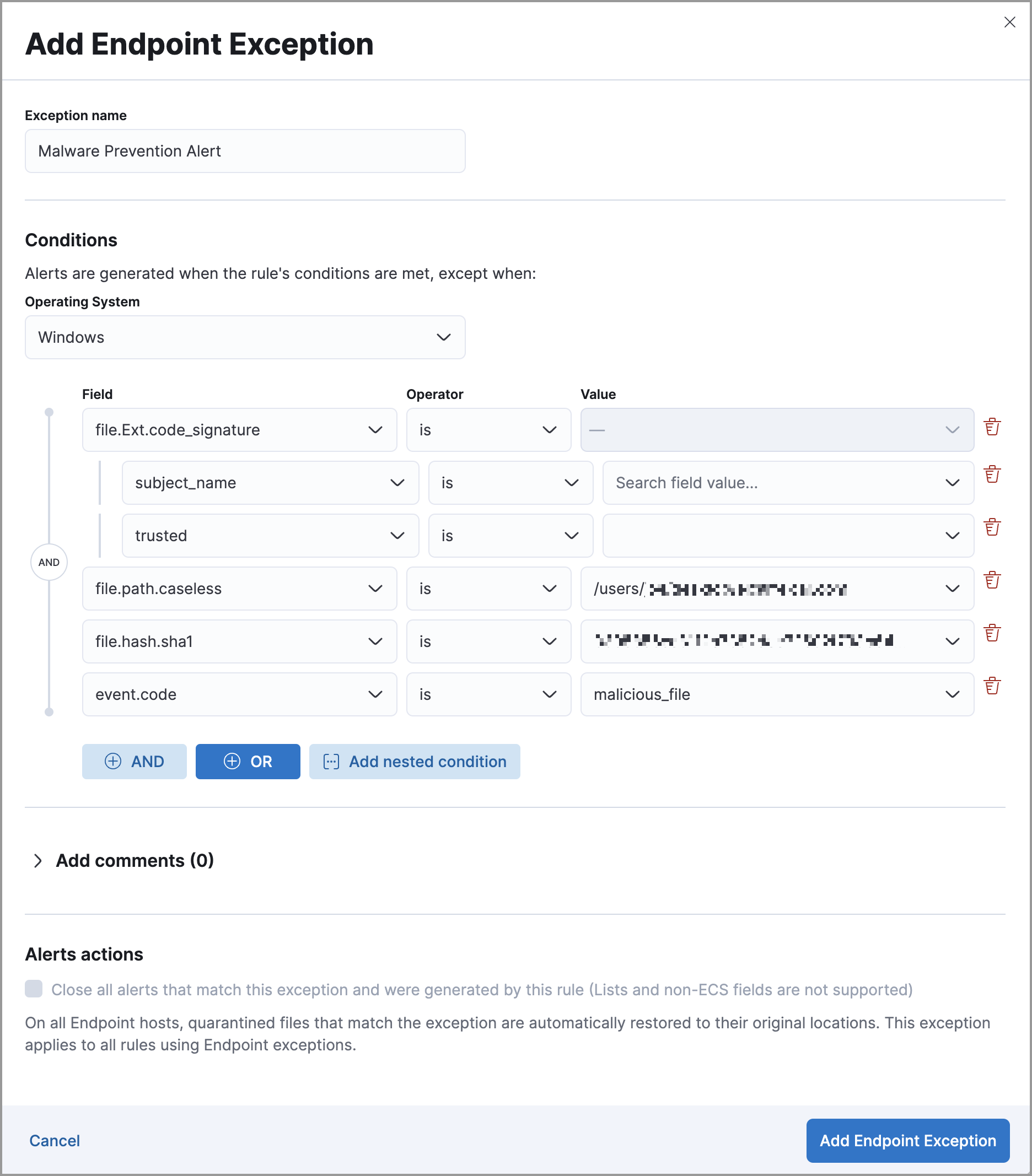

Exceptions with nested conditionsedit
Some Endpoint objects contain nested fields, and the only way to ensure you are excluding the correct fields is with nested conditions. One example is the process.Ext object:
  "ancestry": [],
  "code_signature": {
    "trusted": true,
    "subject_name": "LFC",
    "exists": true,
    "status": "trusted"
  "user": "WDAGUtilityAccount",
  "token": {
    "elevation": true,
    "integrity_level_name": "high",
    "domain": "27FB305D-3838-4",
    "elevation_type": "default",
    "sid": "S-1-5-21-2047949552-857980807-821054962-504"
Only these objects require nested conditions to ensure the exception functions correctly:
  • Endpoint.policy.applied.artifacts.global.identifiers
  • Endpoint.policy.applied.artifacts.user.identifiers
  • Target.dll.Ext.code_signature
  • Target.process.Ext.code_signature
  • Target.process.Ext.token.privileges
  • Target.process.parent.Ext.code_signature
  • Target.process.thread.Ext.token.privileges
  • dll.Ext.code_signature
  • file.Ext.code_signature
  • file.Ext.macro.errors
  • file.Ext.macro.stream
  • process.Ext.code_signature
  • process.Ext.token.privileges
  • process.parent.Ext.code_signature
  • process.thread.Ext.token.privileges
Nested condition exampleedit
Creates an exception that excludes all LFC-signed trusted processes:
nested exp

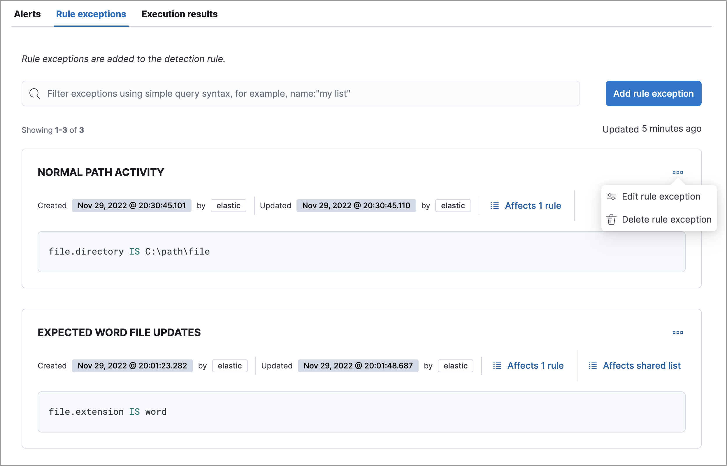

View and manage exceptionsedit
To view a rule’s exceptions, open the rule’s details page (ManageRulesRule name), then scroll down and select the Rule exceptions or Endpoint exceptions tab. The default rule list displays all the exceptions that belong to the rule. From the default rule list, you can filter, edit, and delete exceptions.
A default rule list

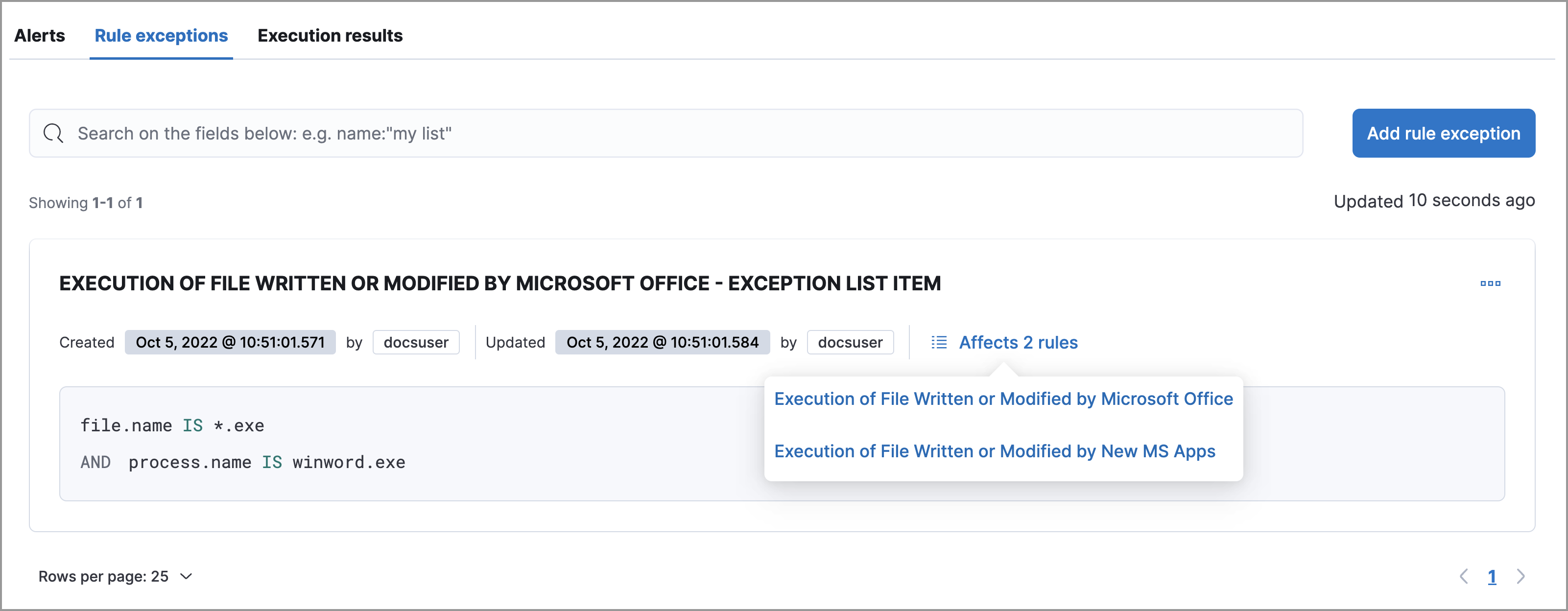

Find rules using the same exceptionsedit
To find out if an exception is used by other rules, select the Rule exceptions or Endpoint exceptions tab, navigate to an exception list item, then click Affects X rules.
Changes that you make to the exception also apply to other rules that use the exception.
Exception that affects multiple rules
