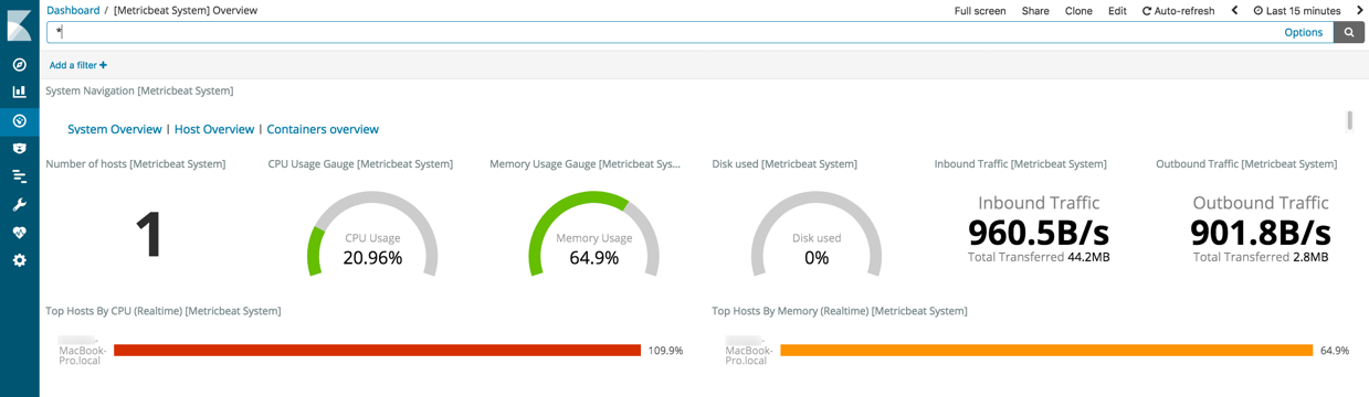

Visualize system metrics in Kibanaedit
To visualize system metrics, open your browser and navigate to the Metricbeat system overview dashboard: http://localhost:5601/app/kibana#/dashboard/Metricbeat-system-overview-ecs
Tip
If you don’t see data in Kibana, try changing the date range to a larger range. By default, Kibana shows the last 15 minutes. If you see errors, make sure Metricbeat is running, then refresh the page.

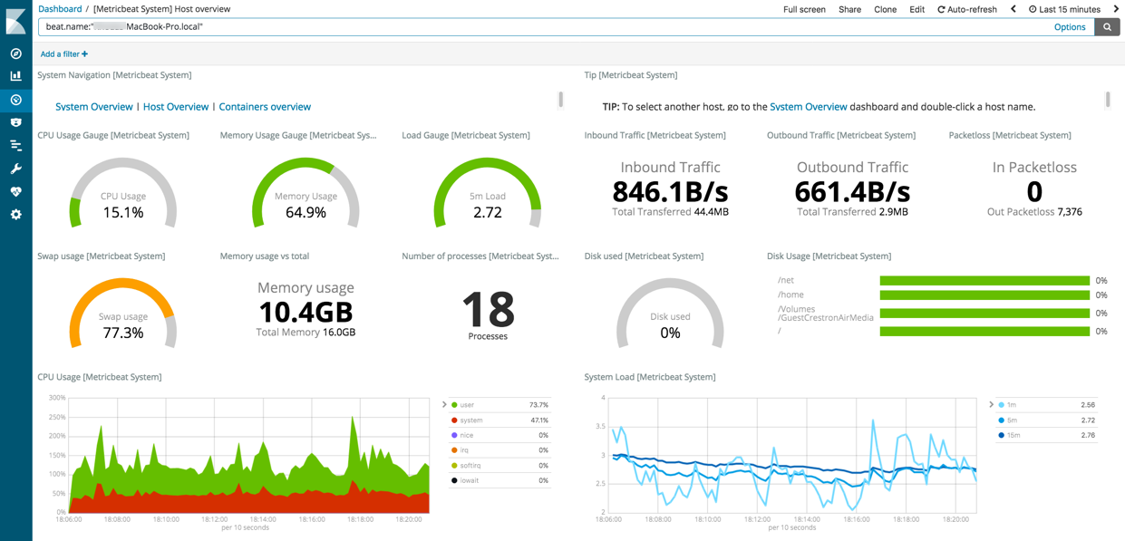

Click Host Overview to see detailed metrics about the selected host.
Metricbeat host overview
